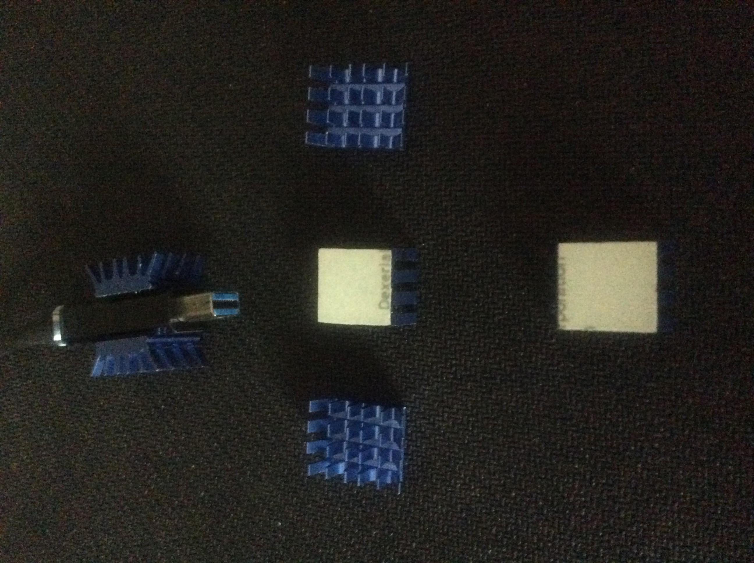

I think we are guilty of overkill in heatsink selection for R3. Doubt a heatsink is even needed for TO-220 or TO-247 package resistors.
But I am an overkill builder too. These are what I attach to R3 now. Have also stuck them to the top of LM3886. In this position they do get warm during use.
Also found other uses for them. The tape (film) is thermal conductive and seems set with use. Never have experienced one falling off.
Read an interesting theory recently on heatsink selection. Based on thermal memory. Thought was low mass aluminum with fins heats up and cools down faster. Quicker settling time.
This was in a commercial application, cost saving may play here also. In purchase price and shipping expense.

I was thinking to something like this:
Home - Fischerelektronik, Product: FK 245 MI 247 V
Copper, solder tabs to attach to ground and increase so heat dissipation...
Dario, those look efficient inexpensive and easy to use as well. I Googled the item number and Newark Electronics has them here to purchase in the USA, although they have to be shipped from their UK warehouse it seems.
Pete

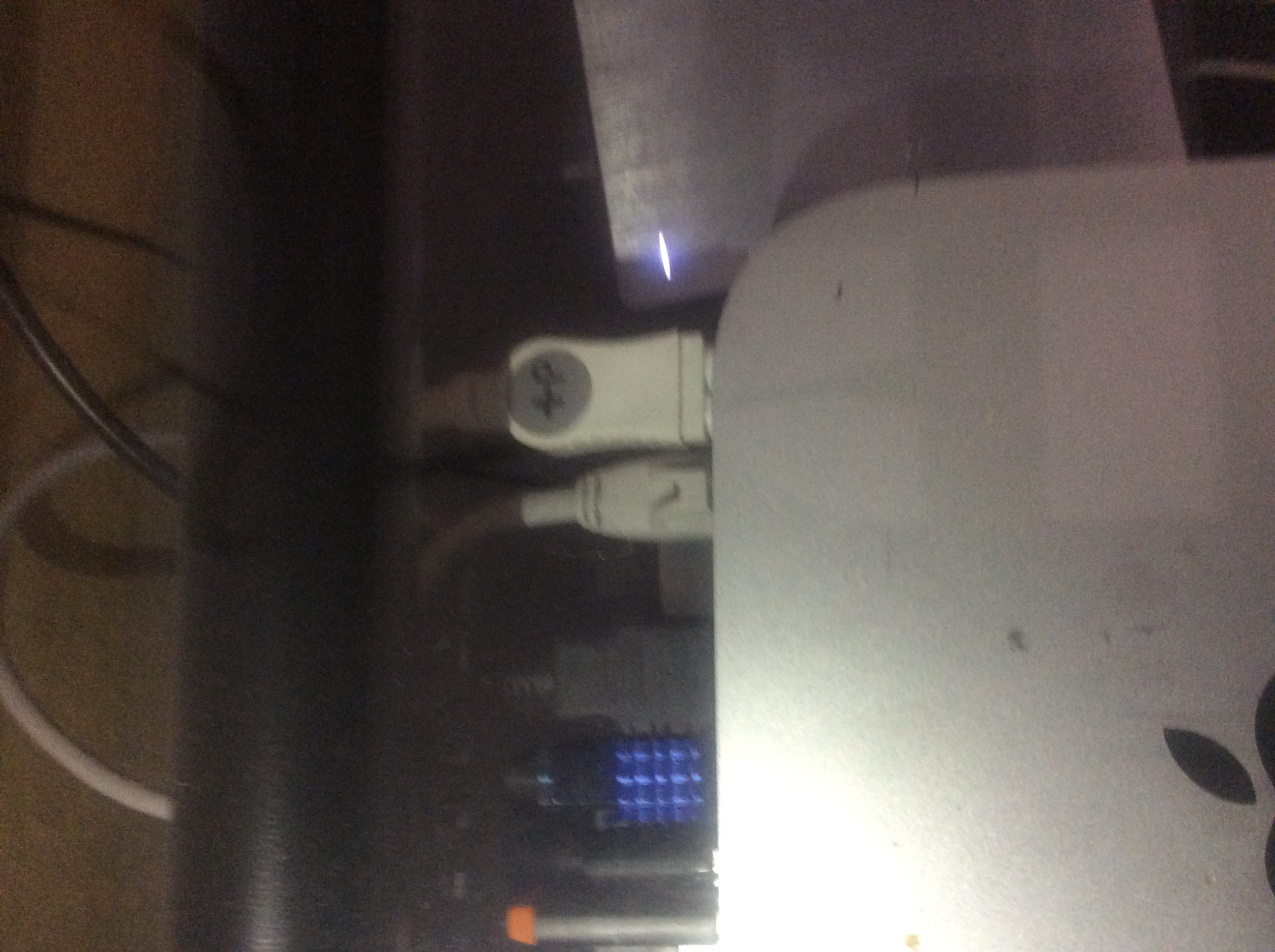

Well almost - do use Oyaide USB
Neo Oyaide USB?
I use Oyaide USB to connect external drives and an Oyaide power cord. Here is a picture I took earlier today other business end of the Mac Mini.
Do not use USB to connect computer to dac (professional interface). Went from FireWire to Thunderbolt dacs.
The heatsinked cable is a Corning optical TB. These draw 150 ma at 12 volts. The plastic ends get quite warm. May explain the high early failure rate of the Corning optical USB and TB cables.

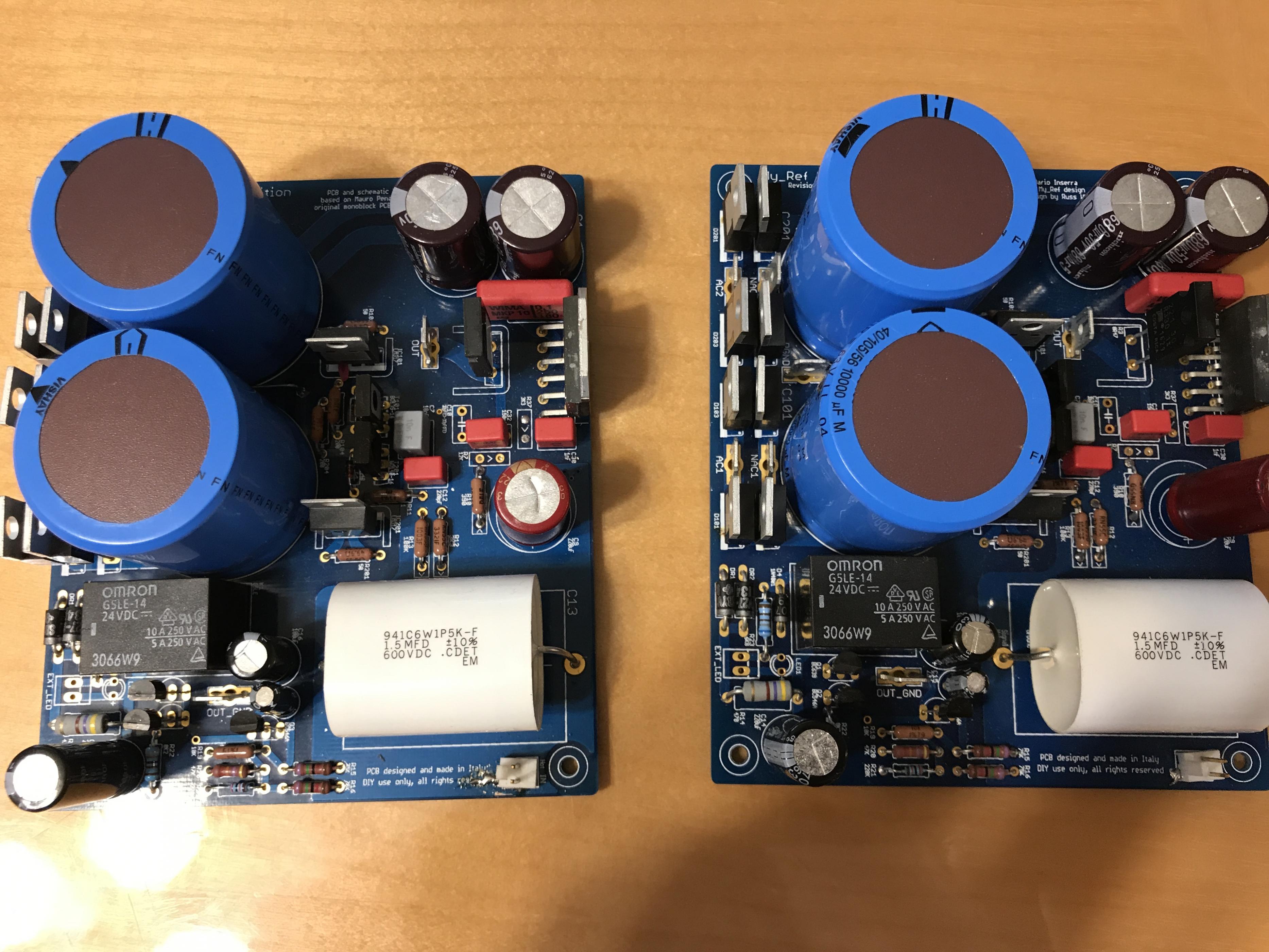

I built this amp a few years back , never installed heatsinks on the bd139/140 or lm317/337 or on the thick Film Resistors. With Antek as 3222 these components were barely warm to the touch. I had a suggestion, to move C1, C2 ( 16mm capacitors) 2-3 mm away from the LM3886 heatsink .
This is a great amp , probably the best lm3886 implementation .

Not so easy...
Well, things are going in an unexpected direction...
The Mundorf manganins seem to have a weird sound signature, colder and less rich than they should (like Russian polystirenes) but this could be due to wrong orientation or more burn-in needed.
But according bass sound the right orientation seems the straight one which is also colder and simplifed, though.... more listening and time needed.
On the contrary Dale RS-5 have spot-on timbre and richness, a nice improvement from the Caddocks that suffer from their peculiar, greyish, coloration.
And this with steel end caps...
Maybe boards could be modified for axial R3 instead of TO247...who knows? We'll see. 😉
Hi Dario, I think that if you modify the board to mount an R3 of the TO247 type (space between the external pins about 11 mm) it is also possible to mount an axial resistance (space between the leads about 22-25 mm), the opposite is practically impossible. I say this even if for my taste, given your descriptions of the sound of these two types of resistances, I might prefer an axial resistance.
