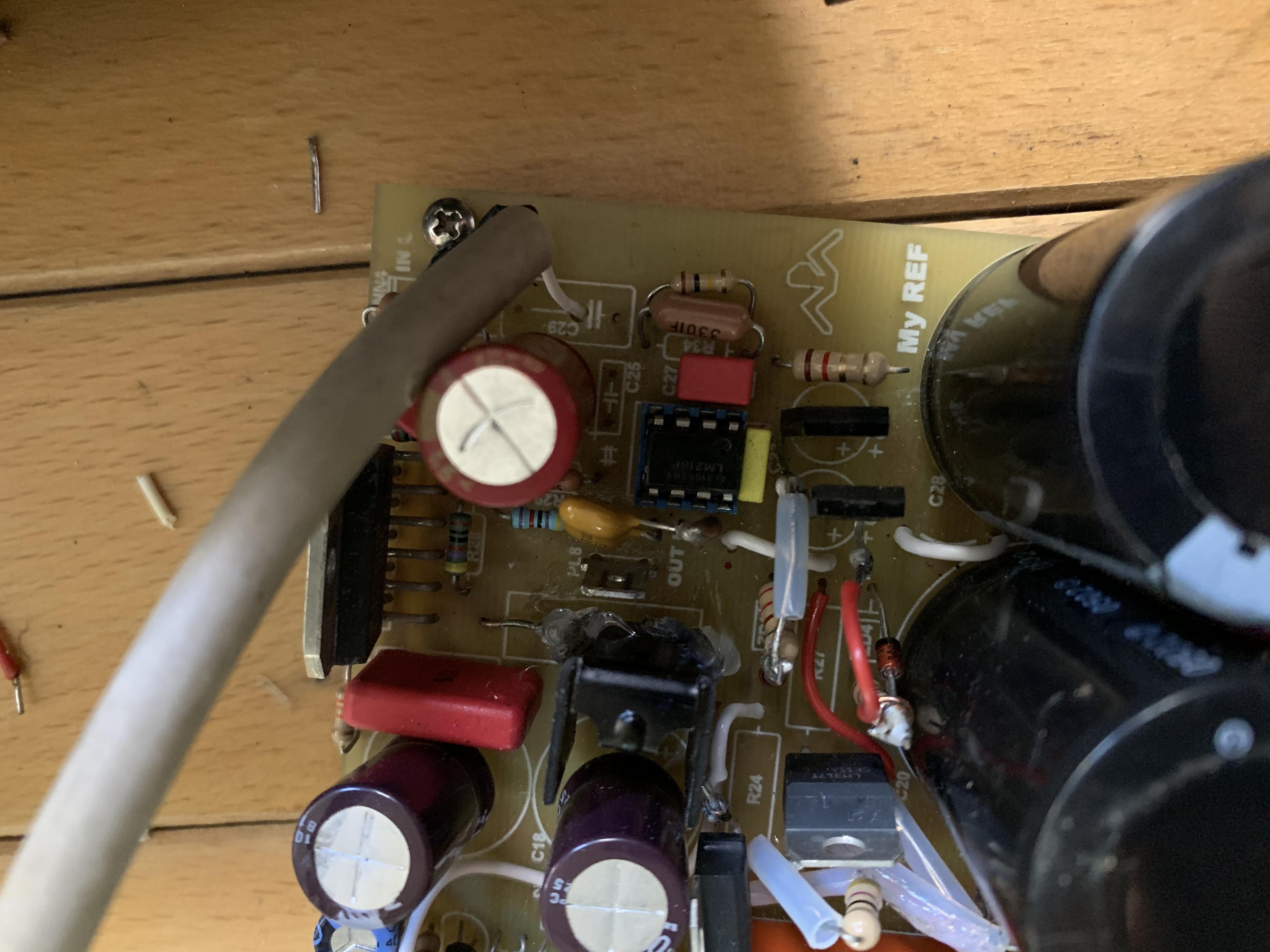

Check the 1 ohm resistor (R11 if I remembre correctly)
How about adding 2 diodes, back to back, on the next board revision to prevent this from happening.
Yes, it seems that R11 is broken. In the afternoon I will desolder it and check better.
So I have to replace lm3886, R11 and lm318?
is there a way to understand if lm318 or lm3886 are still good?
My fear is about lm318 because it is smd and I never solder smd...

No, just replace R11. It connects the input ground to the power/output ground.
So guys...
It seems that I'm very lucky man and the schematic is well done
Replacing R11 with equivalent res and with fly connection, everithing works fine and I'm able to hear the music
Now I have to order the right res...
I hope that next week I can post my impressions on both channels run 😀

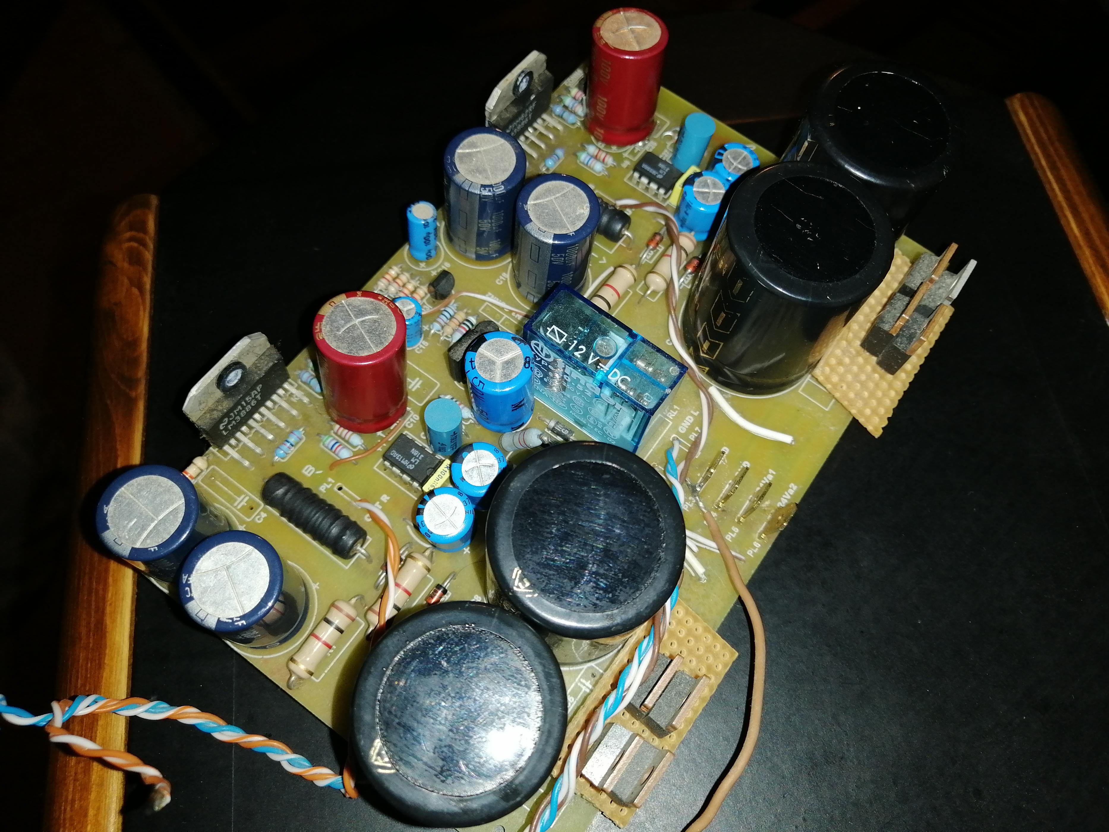

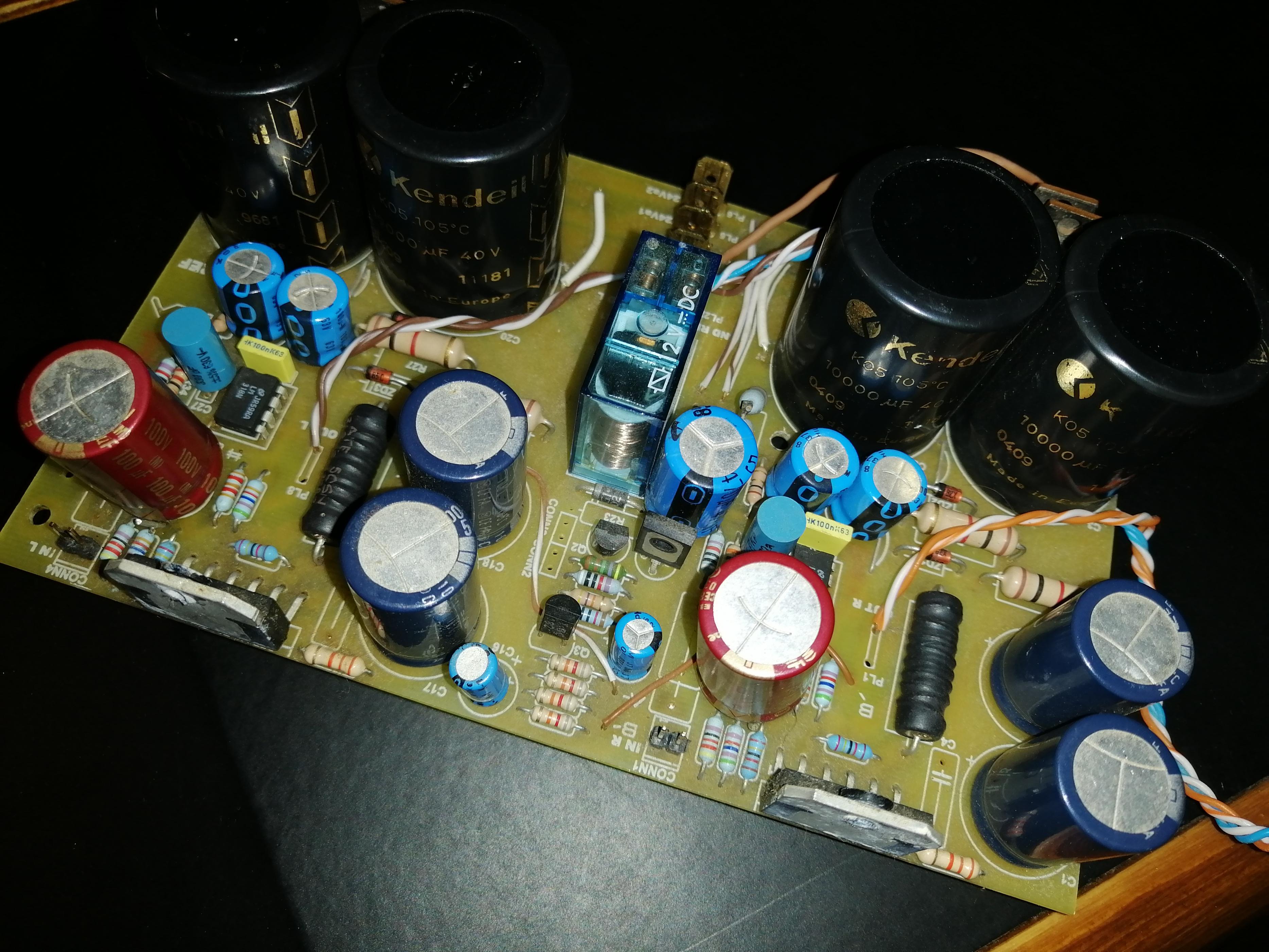

the first My_ref amplifier alive and well ,with almost all evolutions and your modifications in fifteen years!
Great sound with shunt power supply , but not so easy to upgrade in this old board
A way to keep your mind busy in this unhappy moment.
Pardon for trolling but here it is.
2006....
Ps: George might realize some 'features' - - and Mauro is rolling in his rest..
2006....
2006....
