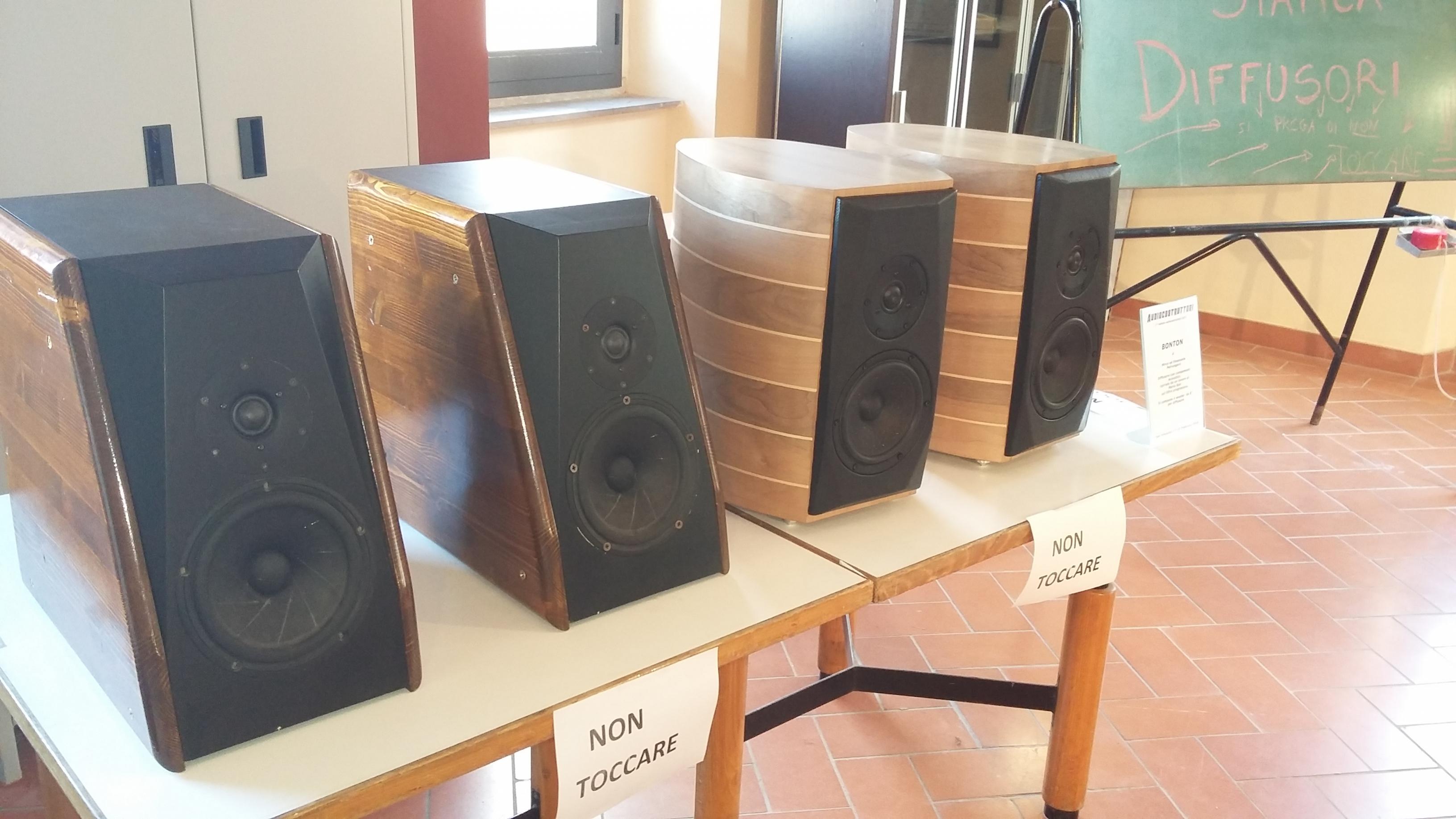

Very interesting information
Can i Ask you whats’ is your loudspeaker?
Antonino
