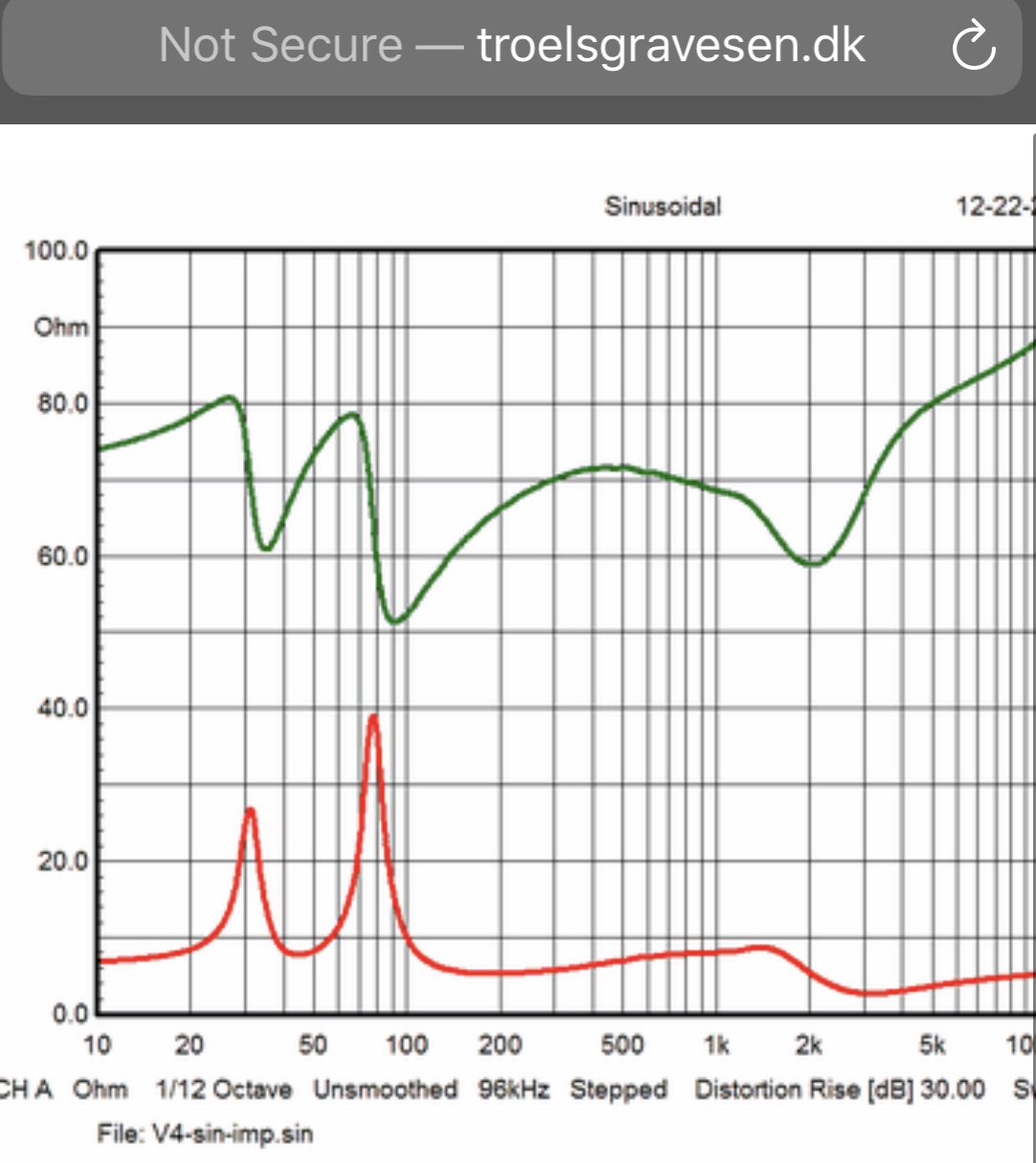

Discovery W18 project:
18W-8434G00
I choose this one because of affordable price (250-300 Eur).
I know this kit, from the impedance curve you posted seems you choose V4 crossover on stepped baffle. As Troels Gravesen explain, this crossover (V4) is a LR4 design, very good on paper, perfect for professional monitoring (like Yamaha NS10).
For Mr. Gravesen with the V3 crossover (LR2 design) "music started flowing and sense of depth and perspective improved vastly". He explain very well differences between LR2 and LR4 crossovers. He says "matter of taste in the end", but it's clear he prefer the sound from LR2 (V3) crossover.
V3 crossover has a better impedance curve (with higher minimum).
Anyway, I don't think FE amp will suffer from a minimun impedance in high frequency. With a simple FE evo I drive my second pair of loudspeaker, with a minimum of 3,6 ohm at 2-300 Hz, with no problem. But the same amps drive my first speaker (with RE of 6,2 Ohm) even better.
