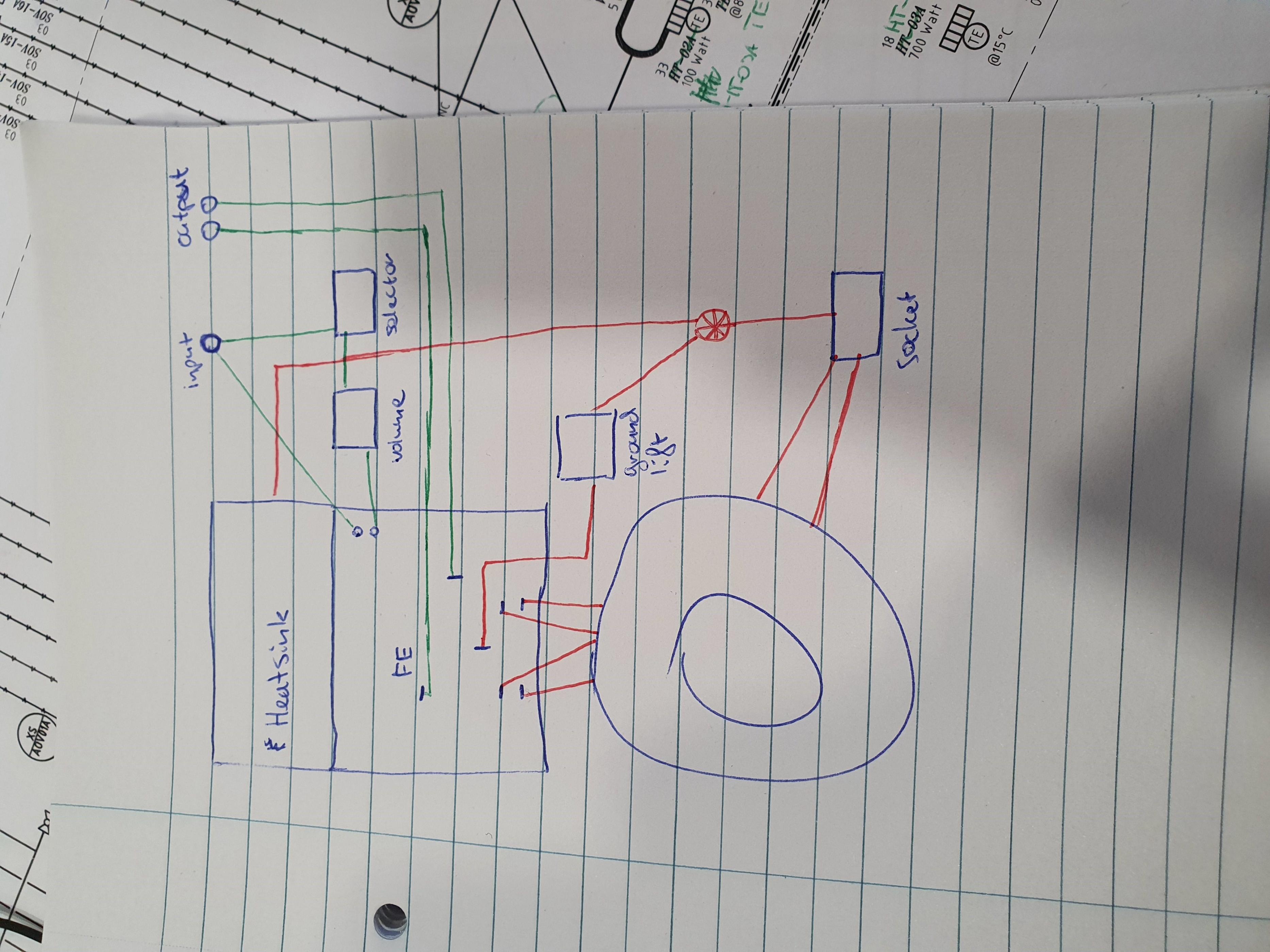

Hi all,
Back in 2016 I bought 2 myRef boards, and the time has finally come to actually make the amplifier. I have everything installed on the boards and I will do the first tests this weekend!
The only thing before i proceed is that I want to make sure that all the wiring is correct. I understand that in principle the board is designed to be floating however it does feel safer to me to have some sort of grounding and the ground lift should prevent any hum issues to my mind. I have attached a picture of the wiring scheme I intend to use (only a single channel for clarity), the green lines are signal wires and audio output and the red wires are the power side of things. The heatsink is not electrically connected ot the rest of the chassis so it connects into the star ground, and the socket contains a fuse and switch. Does anybody see anything which needs correcting?
Thanks Mauro and all others for making this design btw! up to now it has been a very nice project to work on. And once everything is finished up I will of course post some pictures!

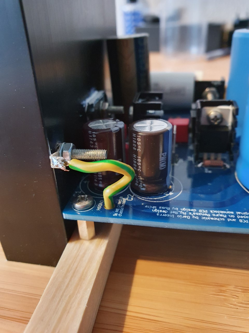

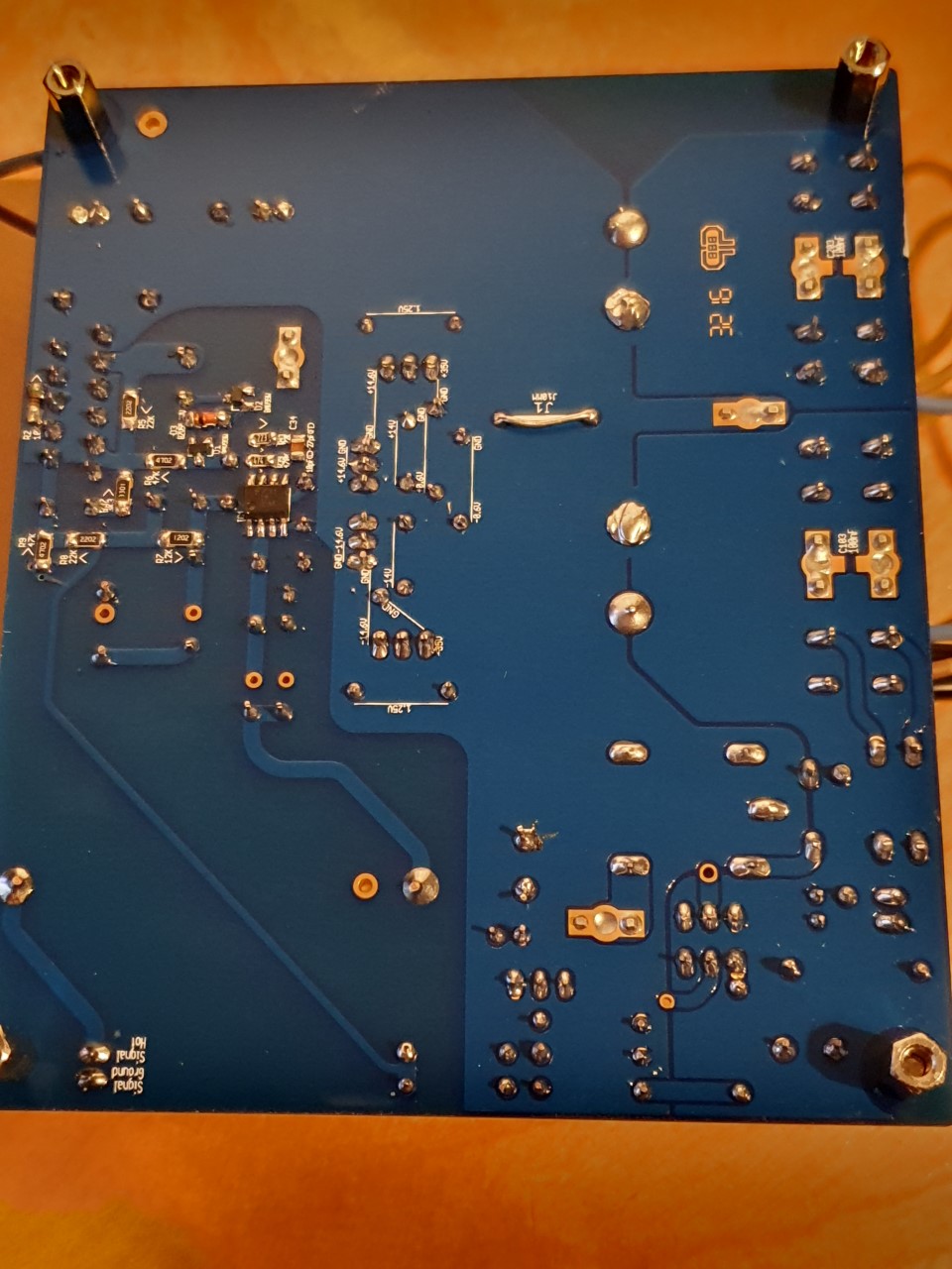

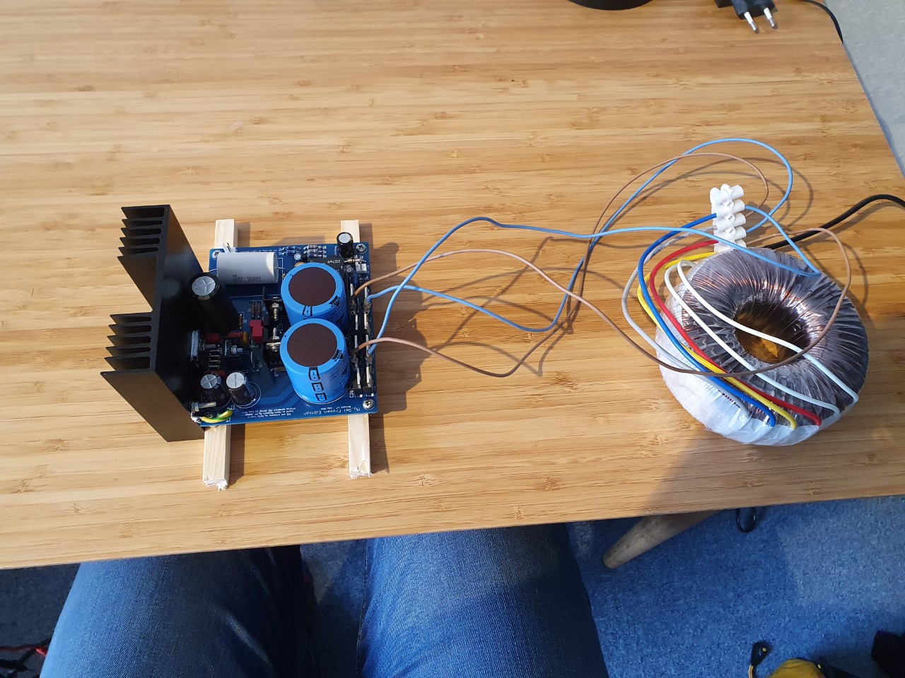

Hey everyone,
I tried firing up one channel tonight however something very strange is happening.
With no inputs or outputs connected i get the following behaviour
- on power up everything seems to work fine, the led turns on and i hear the relay click
- once i touch basically any component with the multimeter (for example the output), the relay immediately clicks and the board turns off
- when I remove the power after a short time the relay clicks again, the led turns on for a short time and then the relay clicks again and the led goes off again...
I'm quite puzzled by this behaviour i must say. I can post some pictures tomorrow, and as the multimeter sets of the relay I can't measure voltages i'm afraid.
Thanks in advance for any advice!

Did You connect as in your diagram?
Is that a ground breaker in your diagram?
Then I see problems
Then I see problems
Try to disconnect the groundbraker.
Connect PGND with a direct, short thick wire to the chassis. Be sure that the heatsinks are well connected to the chassis, too.
Or.
Do not connect ground breaker, and your red wires on diagram.
If the heatsinks are ~floating originally, (is it the reason for the red extra wire to them?) >> Then eliminate red extra wire and connect sinks to HSground on the boards. Very short direct piece of metal.
All this for now, one time temporary. See if it works that way, then we can proceed.
Again: I suspect oscillations, because of absolutely non-existent chassis connection for schielding.
Establish that, low inductance short wires.
Then in a second run we will think of the PE connections.
Ciao, george

Ah I should have been clearer. For now everything is just on a test bench, no case so no shielding whatsoever, and the heatsink is not grounded either. But in the final product I will definitely connect them to the board
Yes, i understood it after the first confusion. On my side.
Try to ground the heatsinks, even for this temporary testing.
I grounded the heatsink (see attached picture). And I still have the same problem, there was one time when it did not turn off immediately and then I measured a offset of 5.4 mV over the output tabs. I moved the setup over to another room where it is not right next to all kinds of noisy electronics (computer etc) but that did not help.
I also included some pictures of the board which I hope are clear enough! As you can probably see my soldering skills are not very good but I did check everything for continuity and everything does seem to be properly connected!
EDIT: the power wires are now twisted and this also does not help
Joost,
Ok.. The photos show a correct assembly and grounding now.
What happens if You short the input pins (a jumper on the connector) and do the same?
And again, what are You touching exactly? If You touch sensitive inner nodes, your description shows the correct "response"... Also valid for inputs..
What is not normal that it stays in that condition, until You turn off.
The described turn-off behaviour is again clear sign of an oscillating system.
Reassuming: after turn on, it's activating OK. If you do not touch patts, it remains ok, I guess?
I would say, it is not 'politically correct' to touch other than the output pin, in these conditions..
Correct work configuration is : a load connected to the output, (anything from 10ohm downwards), and some lowish impedance connected to input (like 1kohm).
Maybe try what happens that way.
Anyway, though it is ufficially not a correct modality, generally these units remain stable also 'everything open'.
Question: both modules are behaving the same?
Tentative suggestion: given that it shows signs of instability, are You sure about all the parts quality/ value in the compensation scheme? (capacitor values etc)
George
