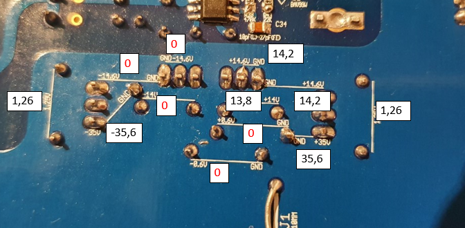

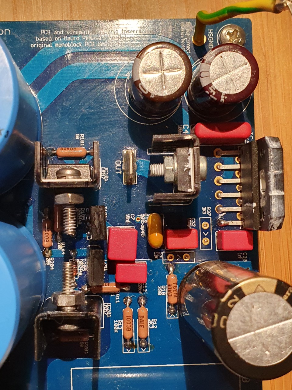

I have attached some better pictures of the board. I checked all the components, and all resistors have the right value, and all caps are at least operational. I'm not sure where to go from here

Could You confirm again, that R10 is a 390 ohm?
Somehow I don't get the reading on your top photo..
I mean I don't get what I see.. "439J"

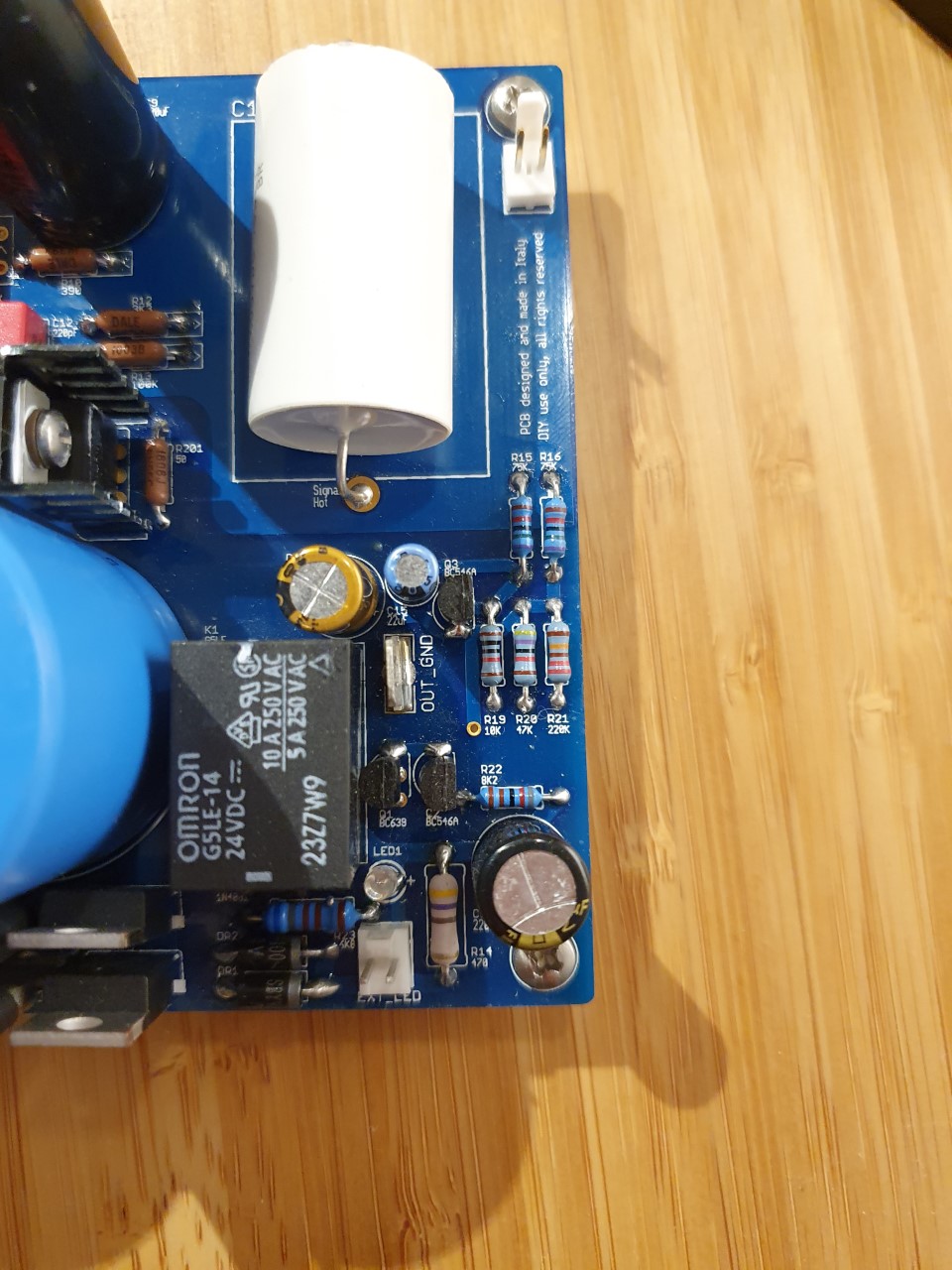

Ok! I had to ask.. 😅
Why do you say that You can not measure on the board?
The fact that the relay disconnect - do not block You to measure between PGND & output tab..
Measure DC and AC.
Also the power supply (on the LM318 pins) would be good to see.
Although it does look like a bit of mistery.
Measure DC and AC.
Haha please do ask, i totally see myself missing something like that...
And you are right ofcourse about the measuring 😛
see attached for the values, and the value between the output and PGND was 31.6 V.
I think the left lm317 is faulty. But would that explain the behaviour I have been seeing?
thanks for the help so far by the way George it is really appreciated!
EDIT: I just checked and it appears Mouser shippen an extra one so very lucky there!
EDIT 2: changed lm318 to lm317...
EDIT 3: last one I swear 😉 the +0.6V is present (as opposed to the picture I made), and there is indeed no voltage on pin 4 of the LM318

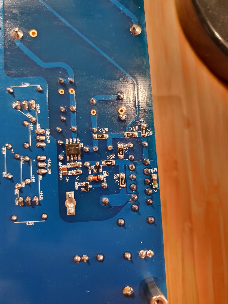

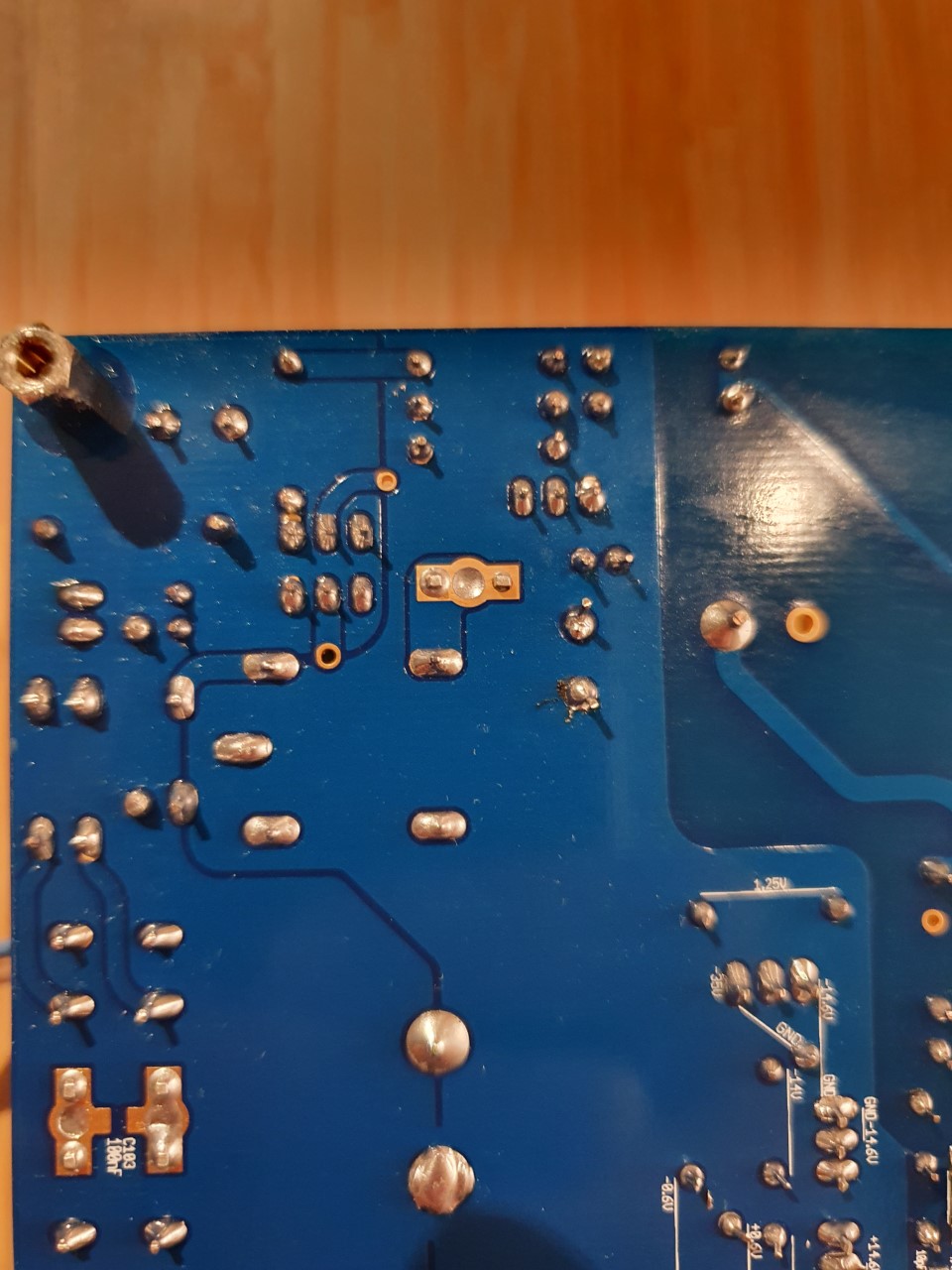

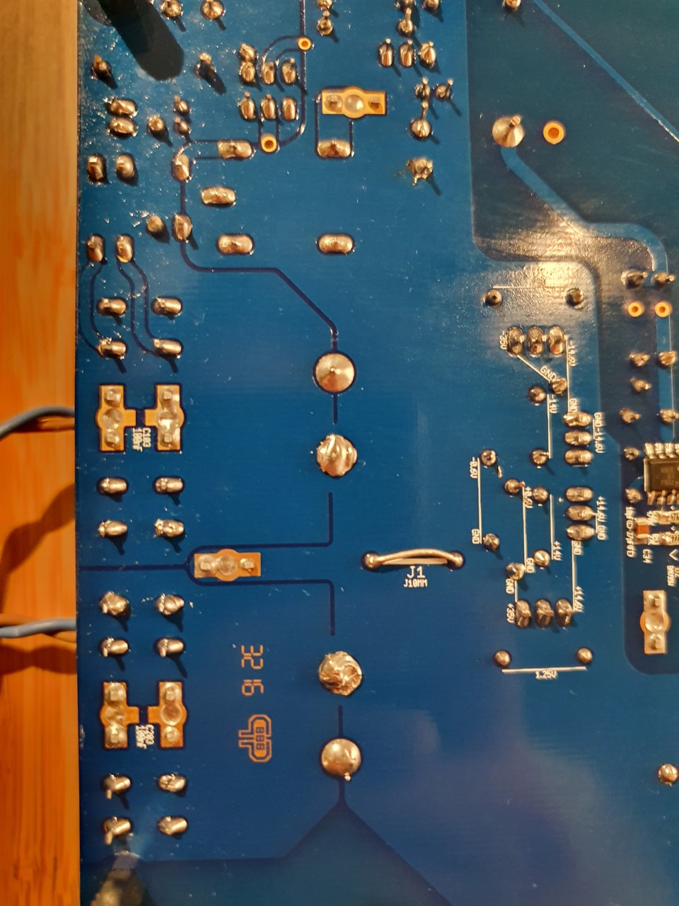

So I went through desoldering hell, and replaced the LM317, only to find out that that was not the issue
It looks like i have a solder bridge between the ground plane and the middle pin of T201 on the top side of the board... Only issue is that it is completely unreachable with a soldering iron... does anyone have any tips on how I would fix this? (preferably without desoldering any components)

I did manage to fix mine eventually after a lot of frustation. In the end i just completely desoldered the transistor and put it back afterwards.
Both boards are now operational and i have measured offsets of 3.2 mV, and 5,2 mV on the outputs (with unshorted inputs). And with some speaker wired up there is a slight hum.
