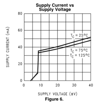

How many milliwatts of classA operation does the FE runs? My guess is about half a watt.
From what I can understand it depends entirely on the LM318.
No. It depends on the LM3886. Specifically, it depends on the quiescent current of the output stage, which is not called out as a data sheet spec specifically. You can get some idea from the information that is given about the total quiescent current/supply current of the chip.
The spec table in the LM3886 data sheet reveals that the quiescent current of the LM3886 is 50 mA (typical). Digging a little deeper (Figure 6) reveals that the supply current varies with supply voltage and device temperature. At ±10 V, the supply current is about 34 mA (70 ºC device temperature) and at the ±35 commonly used in the MyRef, it's 45 mA (70 ºC device temperature).
If we for a second assume that all of the supply current goes to the output stage (which it doesn't, but the majority probably does), we can figure out how much power the amp would be able to deliver in Class A. The LM3886 will enter Class AB (i.e. exit Class A) once its output current exceeds its bias/quiescent current.
At ±10 V: Iout_peak = Isupply = 34 mA
Pout = Iout_RMS2*R
--> Pout = (Iout_peak/sqrt(2))2*R = Iout_peak2*R/2
--> Pout = 0.0342*8/2 = 0.00462 = 4.62 mW
At ±35 V: Pout = 0.0502*8/2 = 0.010 = 10 mW
So not much power in Class A.
Note that this is for typical silicon, i.e. an average chip pulled off the assembly line. As the supply current spec indicates, the supply current does vary from device to device as part of normal device variation. The maximum supply current is specified (85 mA @ 25 ºC device temperature) but the relevant number for the output power calculation is the minimum supply current, which is not specified.
Tom

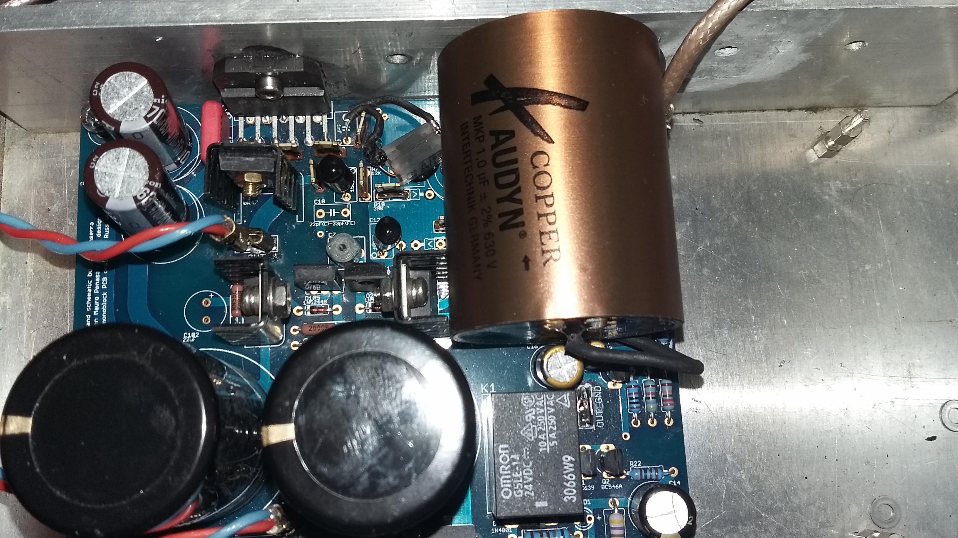

I can report my experience: i built a first my_ref 2 years ago, LM318 opamps onboard, but some z-foil here and there (as suggested by Dario). It was good, very good, for a chipamp (it was comparable with Modulus at that time).
Then i swapped LM318 for ADA4627 and.. believe me... it was like buying an amp twice the price level! Particularly when used as integrated with a pot.
Then i swapped ADA4627 for OPA827 and put in some other z-foil at the pump, some glass caps in selected positions and hexfred diodes (Joseph K suggestions, except hexfreds - you can use Cree sit and they should be even better).
Oh my god! Incredible! The SQ improvement is huge! Now my FE sounds like a true hiend amp! I say TRUE HIEND.
No harshness, believe me, neither a little bit!
Most important, there are plenty of components where you can act to adjust the sound to your taste and plenty of good people to give you suggestions in this projects. That cannot be said about more "closed" commercial projects.
So, if i was you, i wouldn't think twice about getting a pair of my_ref boards and doing what's needed to get the very best out of this project. The reward is exceptional!
