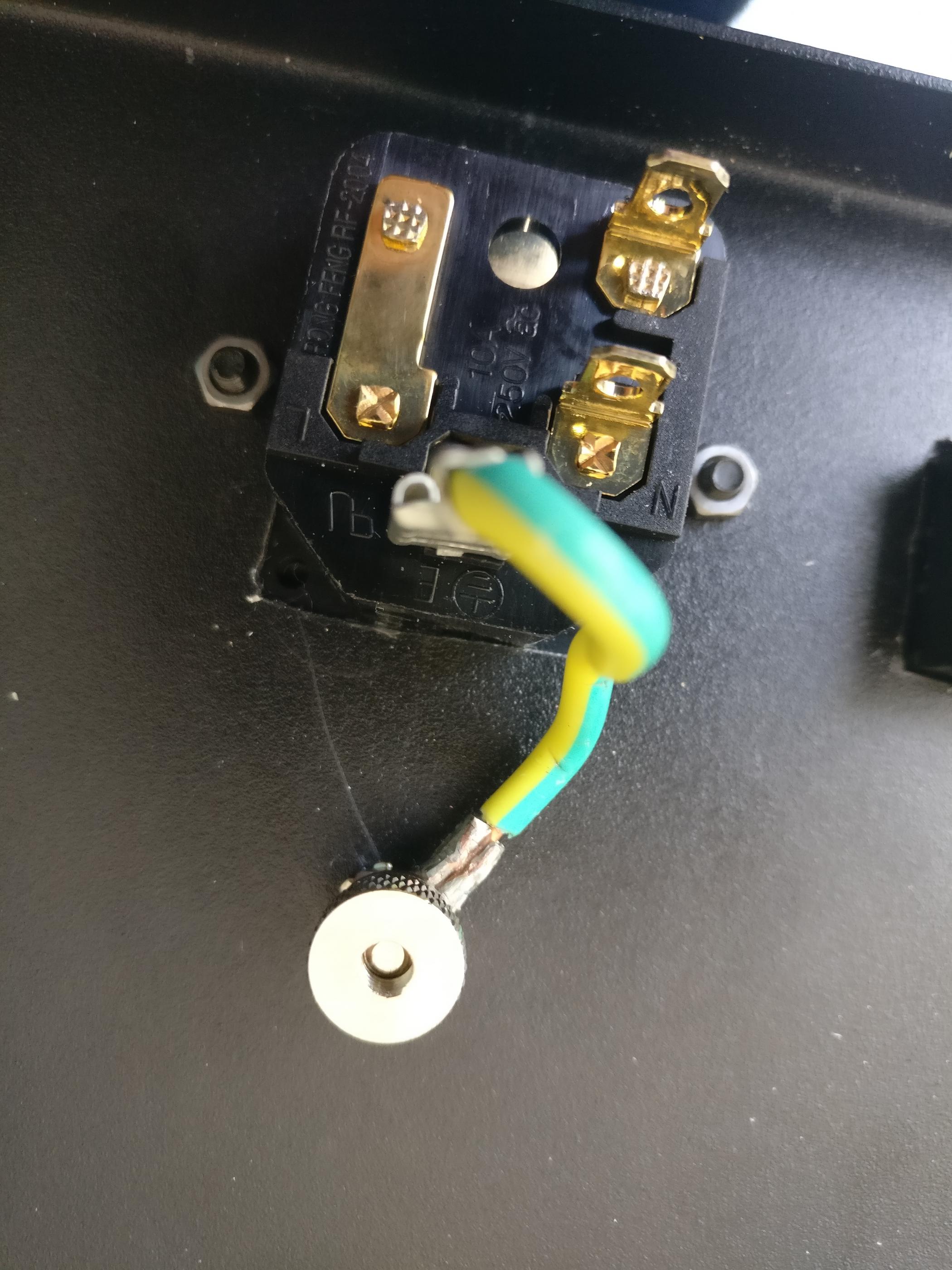

In fact, it might be that you connected PE wire to one live side?! I suspect from the looks..?
Not that I know, here's a close up. Furutech says upper tap is Earth. The lower two tabs go directly to the transformer.
1A is absolutely enough, for a transformer with zero load..
But Oleg is right, the same test You can do much better with the tester.
Pull out the line plug, so you have your socket free. Test continuity between the two extreme leads. (this is the primary, should be some ohm)
Then test for continuity between center plug in the socket (PE) and line pins (extremities)
All this with the PE wire in place.

You are right, this looks OK on this foto, indeed.
But the above test with multimeter would tell if there is a leakage at some other part..
Was also nothing wrong with continuity, tests were fine.
But.
Changed the screw terminal and put it in the air and everything worked fine. It was the only thing I changed. 23,8 volt on every pair.
So maybe the screw terminal leaked? It looked fine... Anybody any idea?

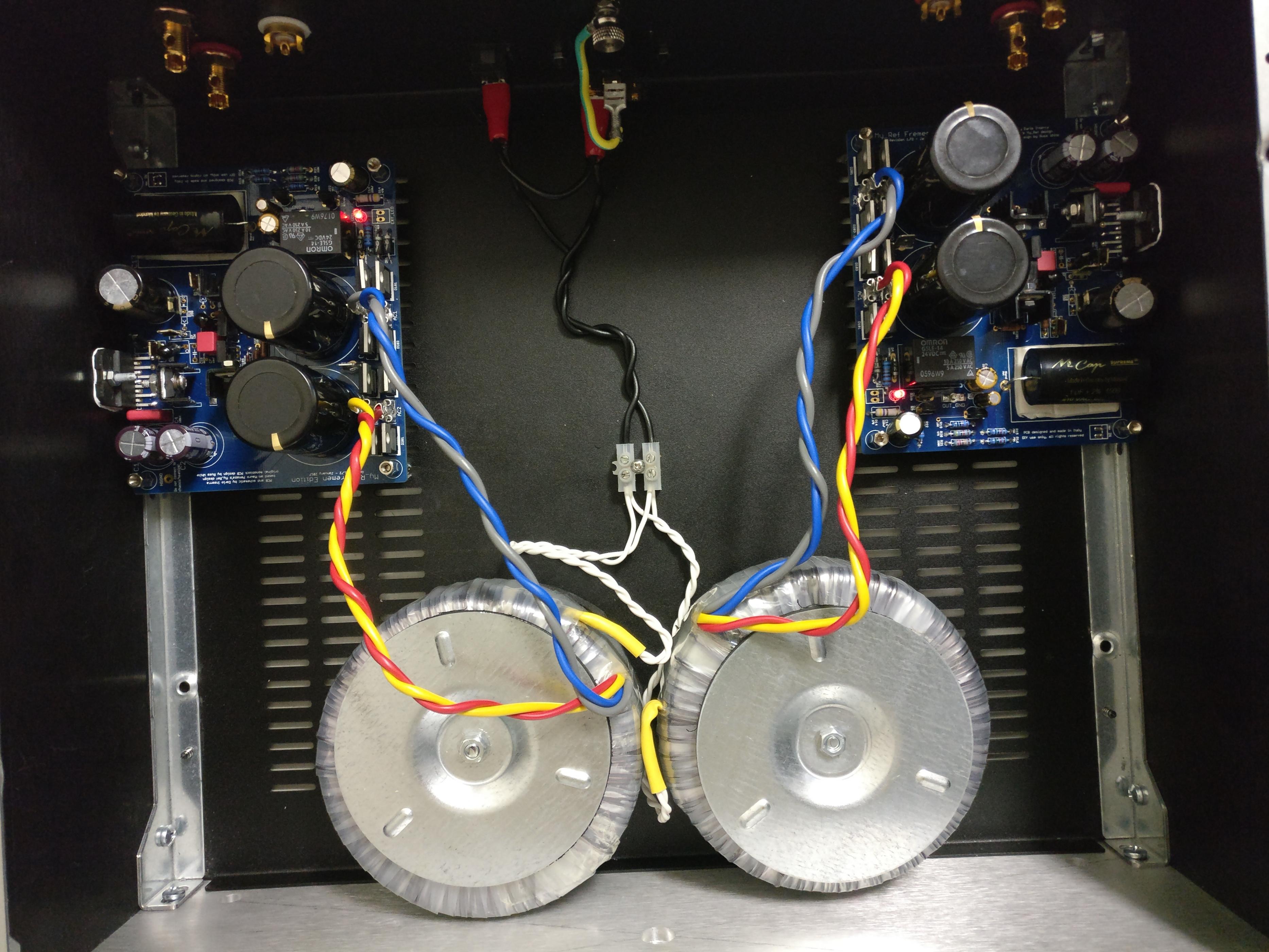

It is alive!!!
White smoke!
The relais popped/clicked, the red LEDs are burning and a soft buzzing of the transformers. No weird hotness around parts, so it should be ok!
Measurements and soldering of input and output will be a job for tomorrow. Thanks for all the help today
White smoke!

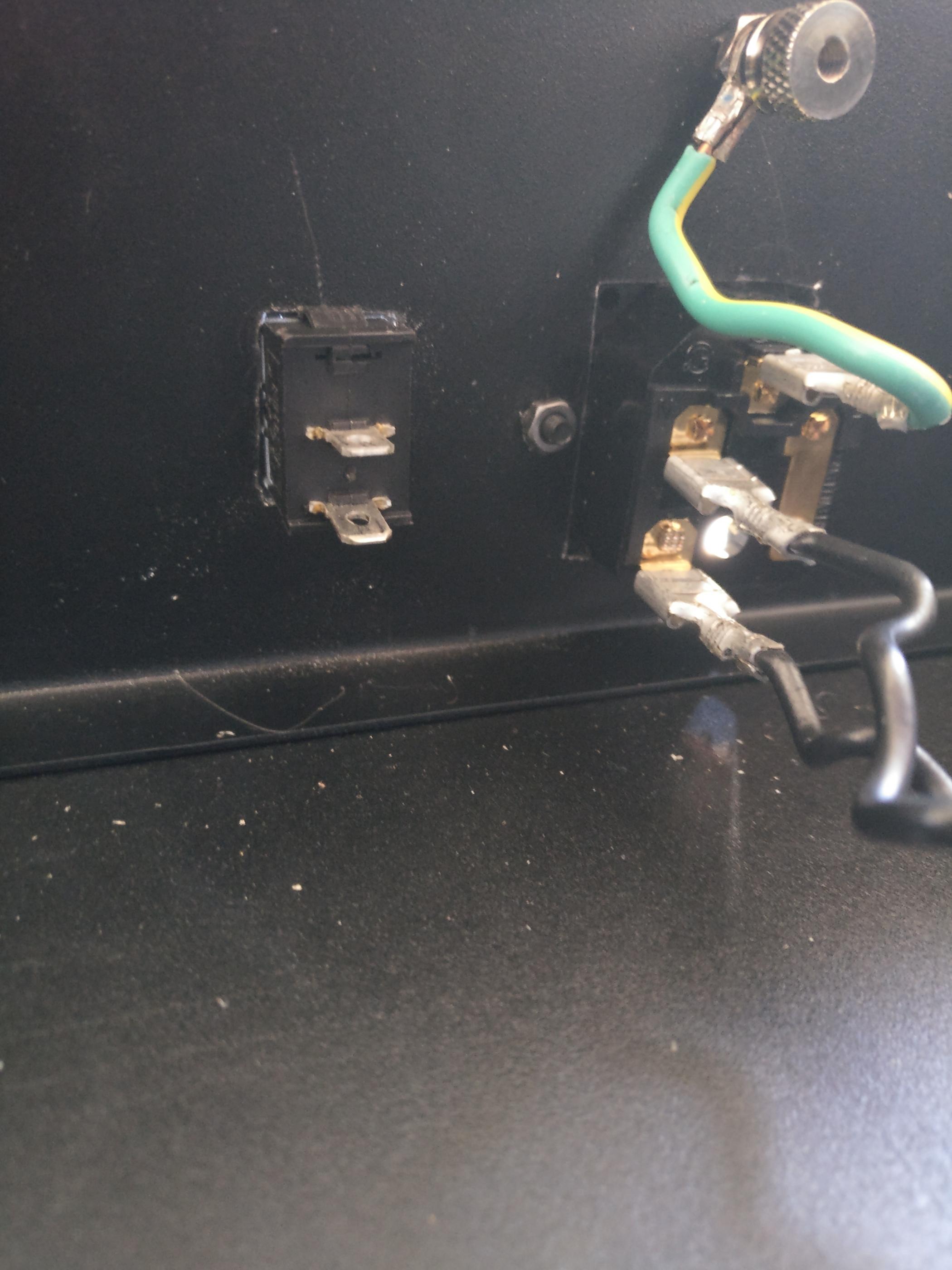

Hmm, not so happy anymore: nothing happened at first startup this morning. fuses keep blowing. Without anything connected everything is fine. With transformers connected it won't work. Any ideas?
Wiring is really basic now and straight to screwterminal, no on/off switch
You used naked fast-on connectors on the transformers secondaries. There is a chance that those connectors touch each other or the nearest rectifier diode and thus short the secondary. I would suggest to dress those connectors in shrink tube even if it is not what causes you trouble now.
Also if you now have only 1A fuse (you mentioned this is the only one which is left in your parts bin) it may be too little for the inrush current of two MyRefs PSU filter capacitors. Other than these two scenarios I am out of ideas on what can be wrong with your setup.
