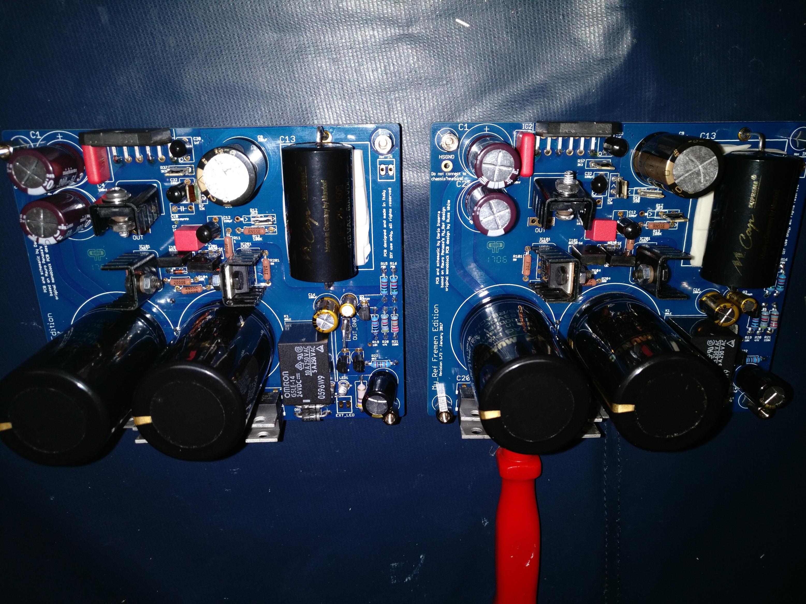

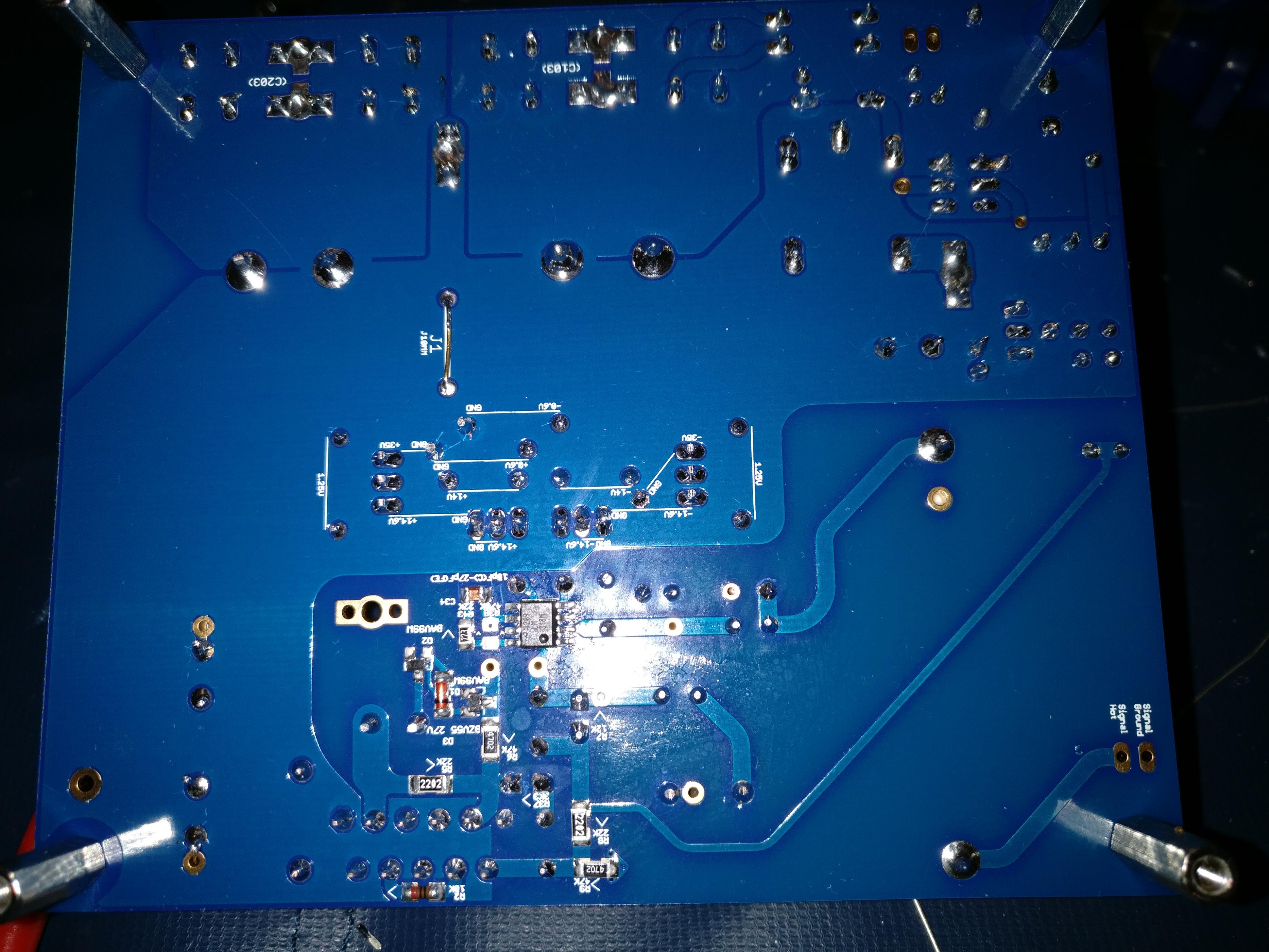

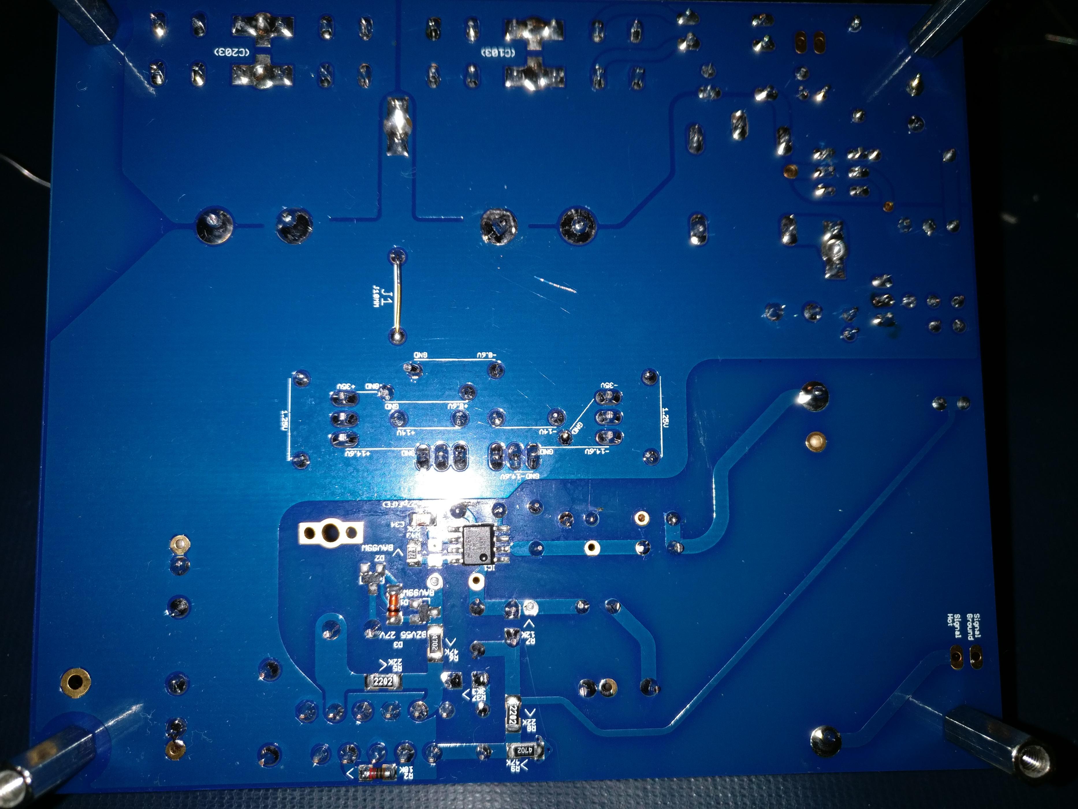

Finished the soldering part...
For all those with a trained eye, do you see any mistakes? Or bad solder joints, or...

Very nice build! I see You did not save on quality.. 🙂
And I'm sure You will get warmly rewarded for your efforts!
I see only a little bit of difficulty in connecting speakers to it,
but I think You will be able to manage also that (Joking!!)

Thanks! Hope it does... Connecting speakers should be possible, I will try to solder the wires directly on the board. But there isn't that much space
Seems a pretty good job 🙂
