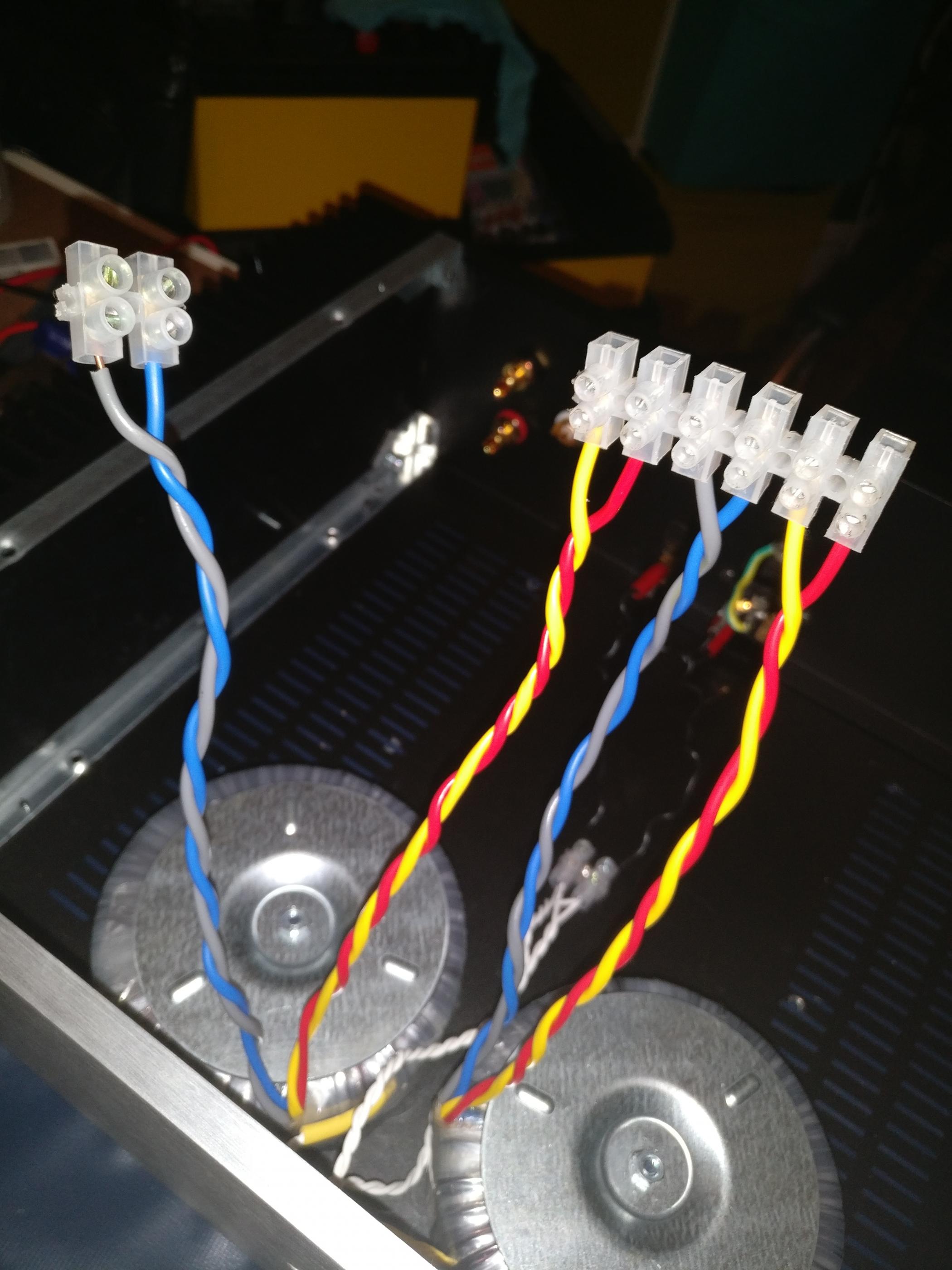

Also, are all secondaries (of both transformers) measure the same high output voltage?
Yes, they are all around 178/184v, all 8 wires (!) measure the same.
Looks ok to me. Can it be that you've got wrong transformers? Does the serial number printed on the transformers correspond to the datasheet?
Label is the same, will look up the serial nr in the morning... Time to go to sleep.
Thanks for all the quick help guys, much appreciated!
What does it mean, "all eight wires' !? Are you measuring with respect to the protection earth?
Should test, in AC setting of the meter, between wires in the secondary pairs. Should be nothing measurable if you miss the pair!
With respect to PE all bets are off.. you can measure anything, even 180v..

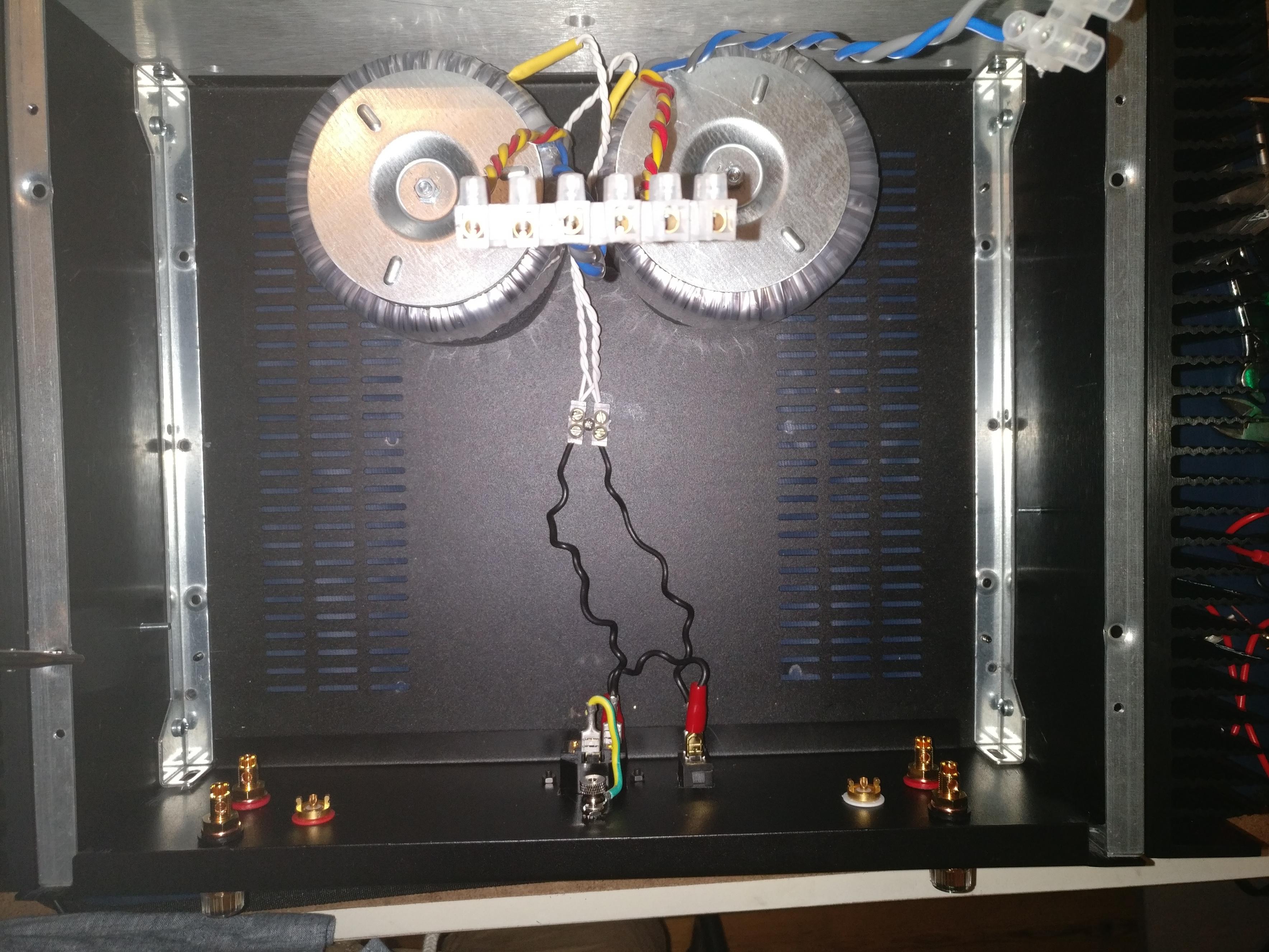

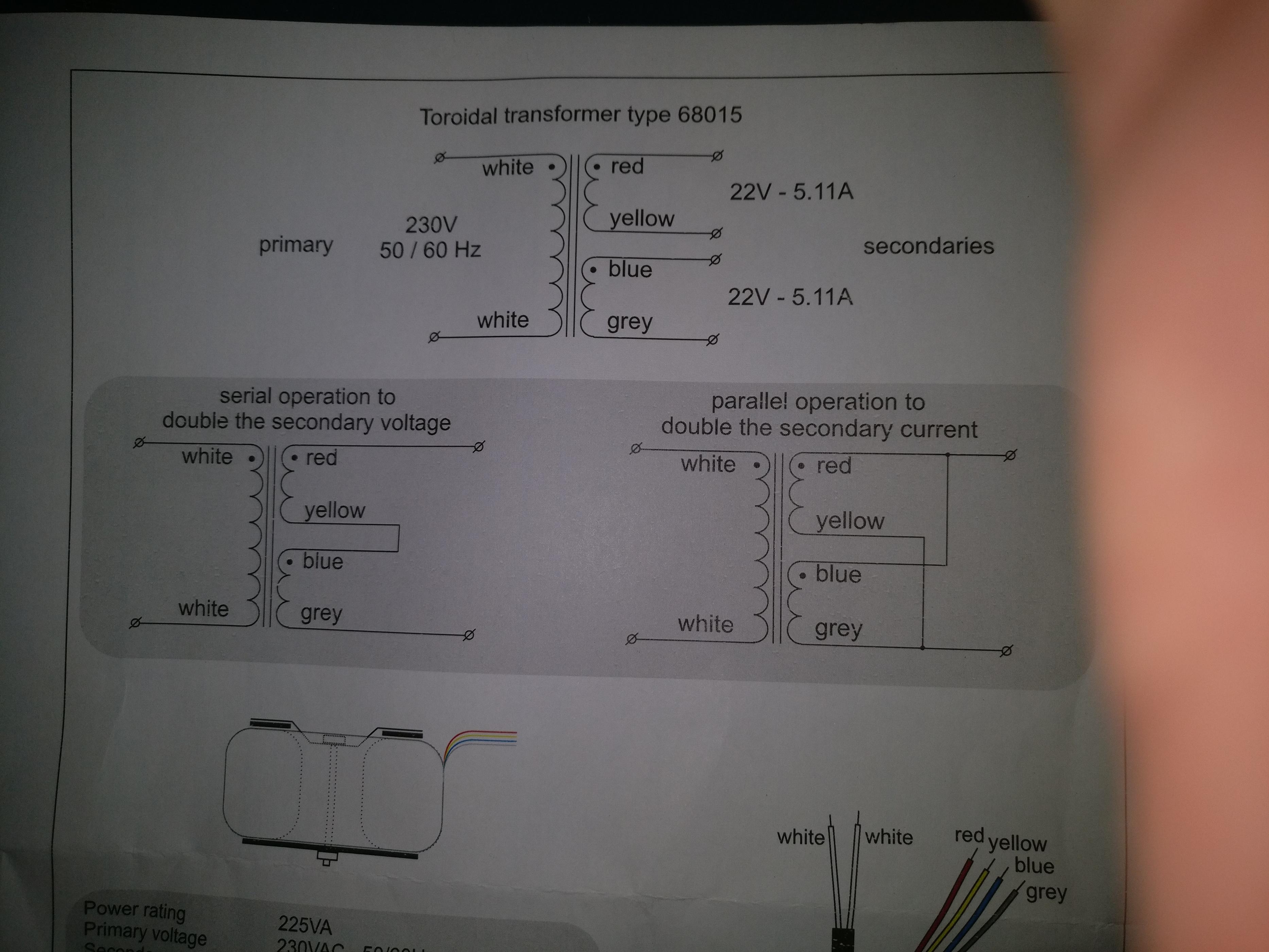

I identified the windings, all according to spec, as seen in the attachment of the transformer above. I don't have the chance to measure, fuses keep on popping as soon as I connect the transformers. Tried them apart, same thing.
I did not connect or put something on or over the secondaries, just bare wire. In my understanding, then you should be able to measure the transformer.
This should be the easy part...

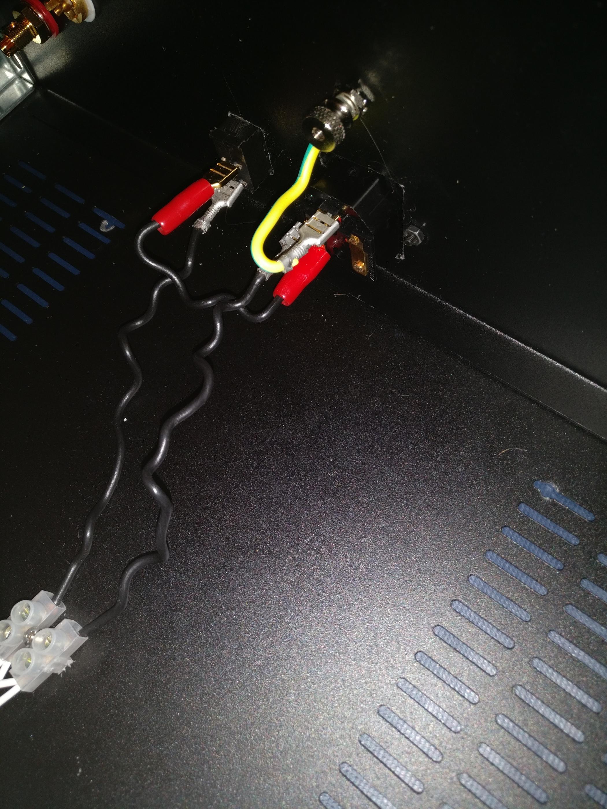

Do you have insulating rubber pads under the round metal transformer fixtures?
Yes, and on top under the metal thing.
And between transformer and metal case?
And what do you mean by bare wire: they are hanging in the air, like in the foto?
You confirm that you did not connect anything to anywhere?
Which fuse blow? the thermal/ overcurrent side or the differential leakage protection?
Another try, (but watch out, not touch the metal case You can try to turn on with PE wire (the green yellow ) removed. If it works (you can turn on, fuses don't blow) that way, then You have some serious leakage problem..

Wires are hanging in the air, not connected to anything, anywhere. I have one fuse only, in the furutech inlet.
Out of fuses now, only 1a left, think that's not enough. Will buy new ones tomorrow so I can test the transformers without PE...
