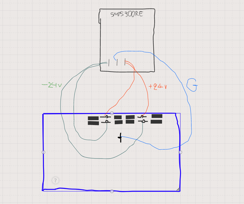

Just for clarity, run one secondary in parallel to AC1 of both boards and the other secondary in parallel to AC2 of both boards. Do I have that right?
Jac
This is what i have also understood. Thank you for your help. I have no idea about trafos. I use smps's wherever i can. After i stabilize everything i will try a couple of connexelectronic smps300re to the AC inputs just for fun. I know that it will work . I just want to see if there is any sonic benefit. But since the topic is still on , what will happen if i connect the only secondary of each trafo to the two inputs of one channel ( so each trafo serves one circuit)?
If I understand you correctly, you would connect one trafo secondary to, for example, AC1 on the pcb. AC2 would be left open. If that is your intention, it won't work. AC1 supplies the positive rail for both the unregulated V+ and the regulated plus voltage for the op amp. In this example, there would be zero voltage on the negative rails and the amp won't function.

Hi Andrew, thanks! What about the following image. This is for one channel. The power supplies are separated per channel:
https://picload.org/view/riiogpwl/diyaudio.png.html

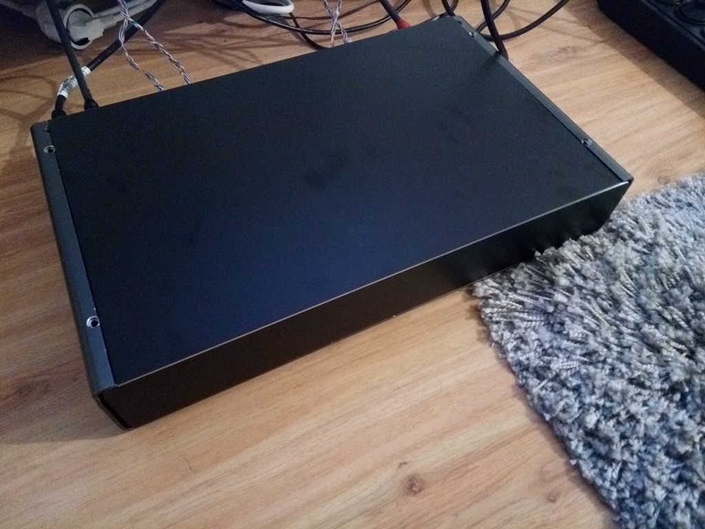

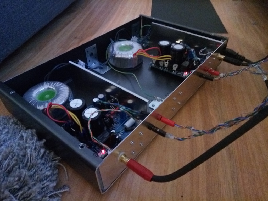

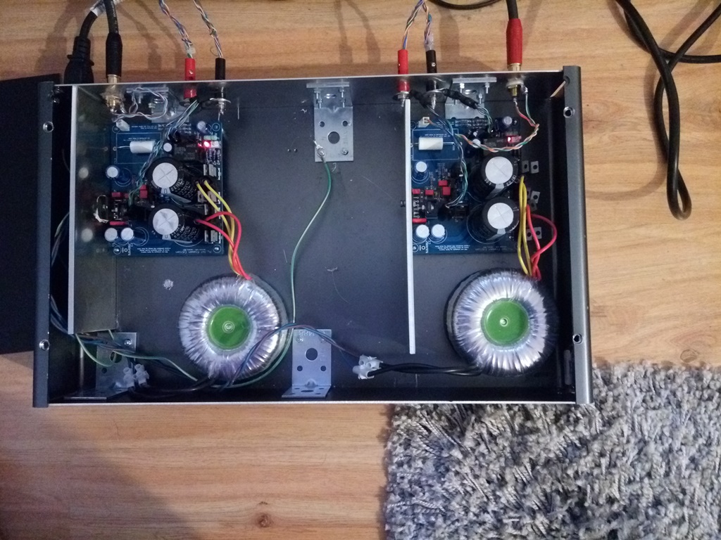

So I completed the amplifier and the case yesterday. It was straightforward. I just followed the build instructions from Mario and my amp is now working. I only regret that i did not buy a good input capacitor for the build. So i ordered one yesterday. There is zero hum noise. I will post some pictures once the network here in ofice is restored. For jazz and instrumental music this amp is perfect. I am impressed. Instruments sound realistic. Also the stage is indeed huge. No further judgments untill i replace the input caps.
The amp started well with the mains connected for the first time. Then I connected the cables and the amp went crazy. I remained calmed and did some troubleshooting. I found that the hot glue (used for case insulation) from one of the rca connectors did not allow the signal ground to make contact with the rca plug. So the left channel had no signal ground. I was suprised that this thing created such havoc. I almost blown up the speaker.

What is this hot glue? Do you mean 63/37 solder?................ I found that the hot glue
The input is a two wire connection. The input NEEDS two wires to complete the circuit. Break one or other of these two wirea and the circuit is broken.(used for case insulation) from one of the rca connectors did not allow the signal ground to make contact with the rca plug. So the left channel had no signal ground. I was suprised that this thing created such havoc. I almost blown up the speaker...............
If the Flow/Hot connection is broken, the amplifier usually goes silent.
If the Return/Cold wire gets broken, the other wire becomes an aerial picking up interference from every EMI source around the home and from your neighbours.
That aerial injects wideband noise into the amplifier input to become a disaster at the speaker.
