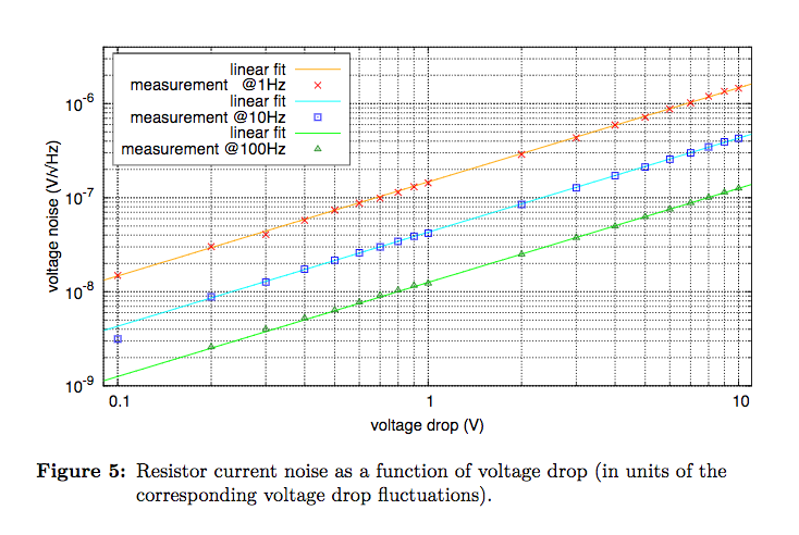

There was also a study in 2009 (LIGO-T0900200-v1) of resistor noise with a large number of resistors compared in a laboratory setting. Happily, resistors that you would recognize from the audio hobby were measured among the better resistors for noise. One resistor that came out of the study was the TT Electronics/Welwyn RC55Y. This is a precision, through hole resistor that measured with lower noise than the Dale CMF55 and even a little lower than the Susumu RG. It also had voltage coefficients that were lower than the CMF and current noise that was lower than most. That said, it was a factor of 10 worse than a bulk foil resistor. I find the RC55Y interesting and worth trying. No promise on timing, but I will let you know what I find.

That is an interesting paper and different from what I had been looking at. Here is the link to the LIGO paper if anyone is interested.
https://dcc.ligo.org/public/0002/T0900200/001/current_noise.pdf
A few interesting things from the distortion paper.
1. Resistor noise is proportional to the voltage drop across the resistor. The first two pictures are different because of different voltage. Note: That means that we may get the best use of "good" resistors by using them on high value resistors. For example, R7 and R13. The figure below is from the LIGO paper.
2. The last two resistors in the table match the lowest measured distortion at 0.0008%. They are Susumu RR which are the earlier SMD resistors and have higher noise and distortion than RG and the new RS according to Susumu.
3. In the LIGO paper, they agree that using a larger wattage resistor than is needed is helpful in getting low noise.

If you haven't already, I recommend you read the study that I linked in post #3269. There you will find laboratory measurements that show that all metal film resistors are not the same for noise and that many are above the level of Johnson noise.
You are welcome to your opinion that I am wasting my time. The reality is that things like current noise, voltage coefficient, inductance, and capacitance are not "shared" with the public on datasheets in most cases. I am not alone in feeling that design, materials, and manufacturing processes make differences in those measurements. Since I can't measure those things accurately myself and because those measurements may not be a complete description of what is a good audio resistor, and mostly because I am curious, I choose to waste my time trying to understand design differences and swapping a few resistors to see if I can hear a difference.
Thanks for your interest.
Jac
Can you make out which resistor matches which curve?............
If you haven't already, I recommend you read the study that I linked in post #3269. There you will find laboratory measurements that show that all metal film resistors are not the same for noise and that many are above the level of Johnson noise..............
Can you extract all the known noisy types (carbon and oxide) and examine what's left, the metals?
Can you see a correlation within a power rating for all the metal types?
excluding 1/f, all the quieter ones seem to be very close to the Johnson noise from 1kHz upwards.
I'm afraid I can't make out all the colours, can you?
