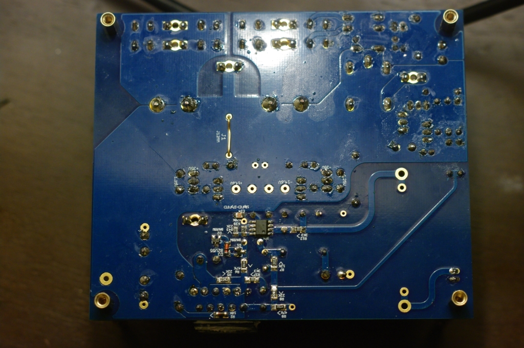

I ll check all joints again, resistors etc to confirm it is well soldered.
Plus it can be burnt component, if I applied too much heat..

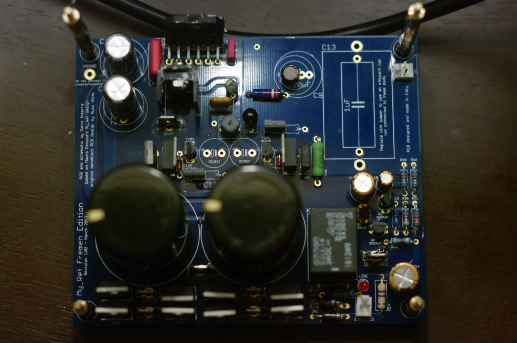

Connected boards.
One is working fine.
Second is not. No click and no led.
can you please tell me what to check.
The first thing to do is posting pics (possibly magnified)
Quite all problemes come from solder bridges, bad joits and similar.
BTW don't worry, most of the times if something broke it's LM318.

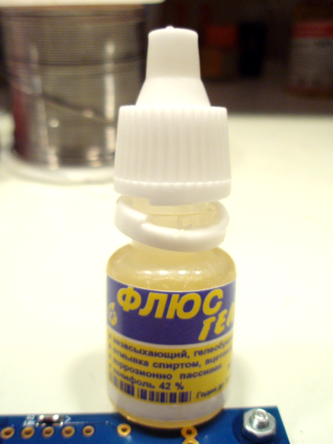

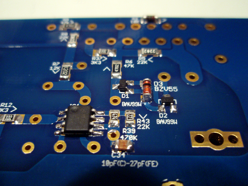

On June 7th I brought home the package with boards and parts from the post. Everything came in great order! Don't have enough words to thank Dario properly! Great work! So, as per 'tutorial', first came the SMD components. Flux used was Russian brand. Somewhat fluid 42% neutral rosin gel. For solder there was a choice between Asahi Sn60 Pb40 and Chemet Sn63 Pb37. It was my first adventure with SMD parts and with many issues too. I was cautious not to overheat the parts. The proper method from tutorial failed to work for me. The solder string just refused to melt. Even when temperature was raised to 300 C. This method certainly needs getting used to! I ended picking tiny balls of solder with iron tip and applying them to the parts. If the ball was too large, it was rejected by whiping the tip. Something like one of three attempts to pick the right ammount of solder turned out successful. Strangely enough the Asahi 60/40 solder proved easier to work with. The result is far from perfect, of course, but possibly acceptable. Hope to try out the boards in a week or so.
You're welcome 🙂
What counts is result, any method is good until it works 😉
Seems pretty good from pic. 🙂

Looks to me like you are shy of solder on almost all of the through hole spots. Know you don't want to burn anything, but I see a great need to reheat them and add some solder. The photo shows how easily one can miss a bad joint.
If you don't have quick access to a commercial cleaner right now, Finger Nail Polish Remover and an old toothbrush will do a good job.
I tried that, but it has got fragrance and leaves artefacts on board. Will get nail cleaner tomorrow or go to maplin, if they sell any of sprays...
Values on board seems to be ok (14 v and 32) .. I ll check it again to confirm. Plus 3886 gets warm while powered. Don't know if this say anything...
