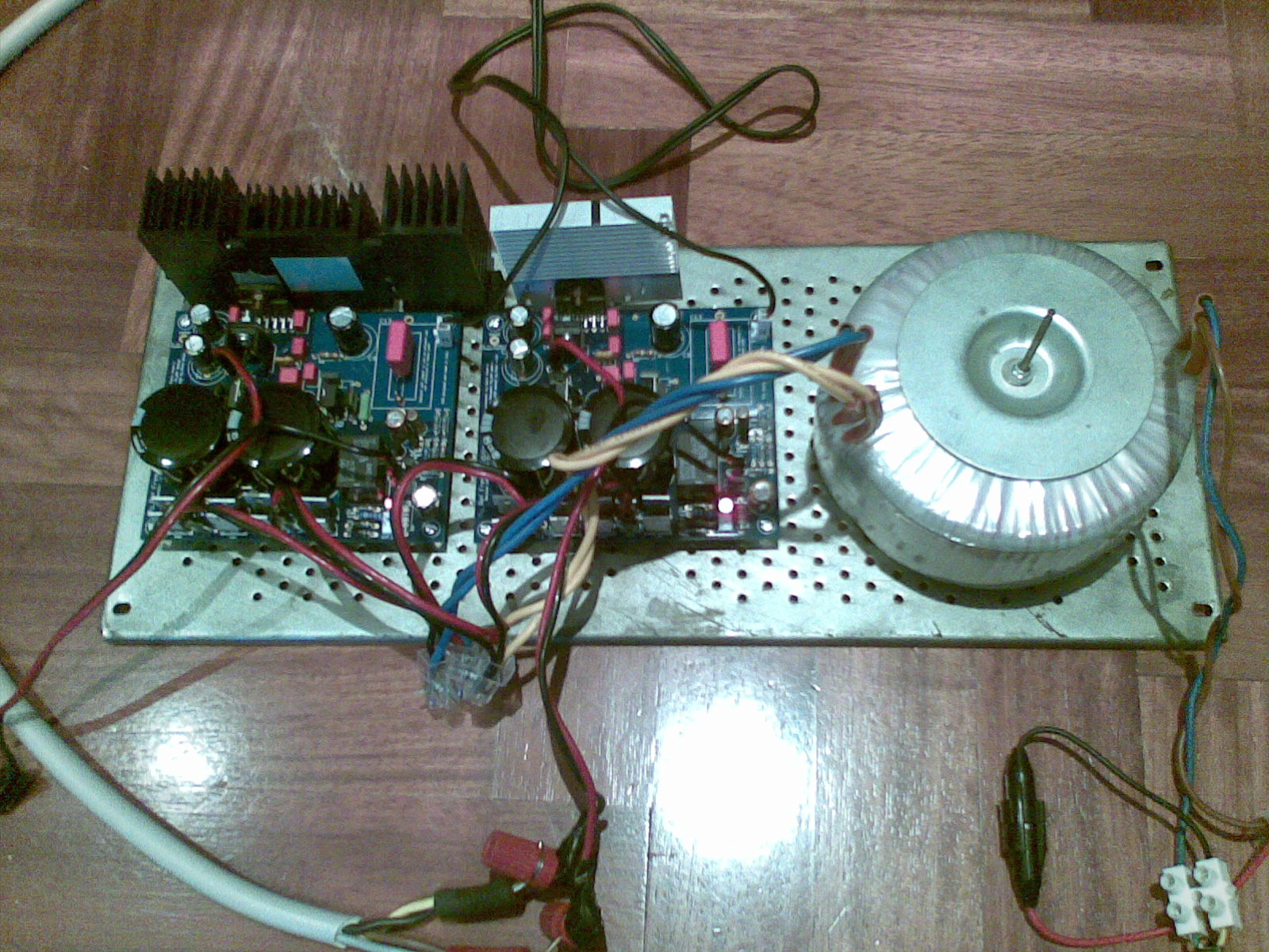

Hello,
this is just to thank Dario and all the people involved in the development of the board of such a wonderful ampli 🙂.
Yesterday I've mounted my boards (first group buy) with the mouser bom and both worked impeccably.
Some info:
- before mounting each component, it could be obvious, I checked it (measuring the resistance, checking diodes, reading types on transistors, etc) and, lucky me, I found no error at all from Mouser.
- I'm using one trafo (22V+22V, 350VA) from LSP transformers (Italy). My speakers are 4Ohm nominal (AR 312HO),
- the picture shows the boards and the trafo of the first "run". I'll put everything in the galaxy GX288 enclosure very soon.

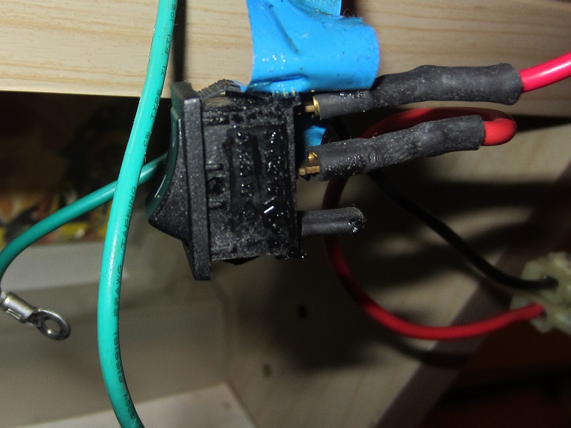

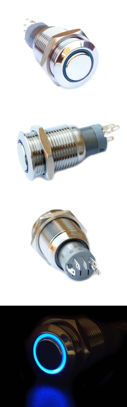

Gents, can you explain please how to connect switch to transformers?
It has NC (normally closed) NO (no voltage) and C - common.
Ordered new q1 , thanx again spinwell[/QUOT
I can pop some in the post if you haven't already ordered.
Are you using a two pole switch i.e switching live and neutral?
Hope this can help:
The switch was OFF at the moment of shooting
I have one push button latching switch.
Sorry never wired any ac in my life so want to understand.
Basically one wire in, one out and voltage connects then button pressed.. Easy !
3rd wire is common- aka ground I guess.
Thank you 🙂
Thank you 🙂
Common is usually the mains in with either of the others as out depending on the switch position.Do not connect ground to the switch under any circumstances.
OK. 🙂
Pardon my level of awareness .
Ok, I forgot it is OK to put switch after transformer. Or you prefer before ?
