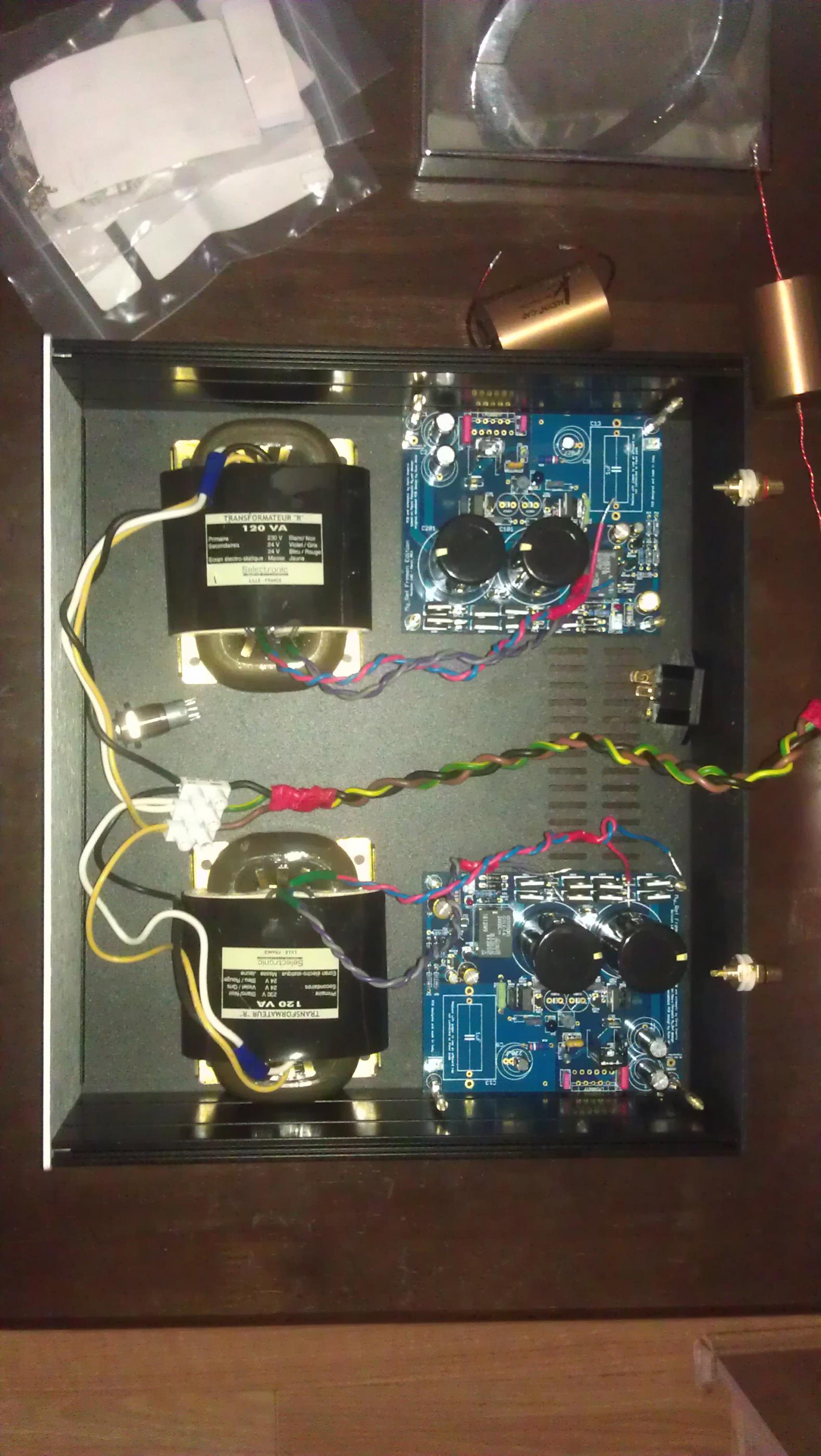

Hi all,another amp lives.Left offset 5.1mv.right offset 3.1mv.Im lucky,DEAD silent no hum.Amp worked perfect from start except for a crackling left channel due to faulty pot.I had to do a makeshift rewire on the spot and directly connected RCA to input.I couldn't wait for a new pot.😀Soundstage got bigger compared to my p2p chipamp.I will have to wait to play it loud on my bigger speakers as its late here🙁...On a side note,can anyone describe or explain what a "forward"sounding amp sounds like?

Way To Go bitoman !!!
Nice clean and substantial build. To me "Forward" sounds like a combination of clarity and front to back voice/instrument placement. Many amps sound like there is curtain between the performance and the listener. A good forward sounding amp gives the impression the listener has moved closer to the stage. A bad forward sounding amp has an aggressive presentation that eventually leads to ear fatigue. The trick is to maintain the "Live" nature and presence and eliminate the edginess, that at first listening, can seem inviting and impressive.

It seems I forgot to order the BC639-16 & Bc640-16 transistors am I ok to use ordinary ones like those in the DC & speaker protection circuit.tia.
It will work and sound fine but not as good as -16 versions...
The -16 are selected for higher Hfe and output impedance of the regulator depends on it.
If you can't find BC639-16 and BC640-16 locally you can replace them with BD139-16 and BD140-16, same parts in different packaging.

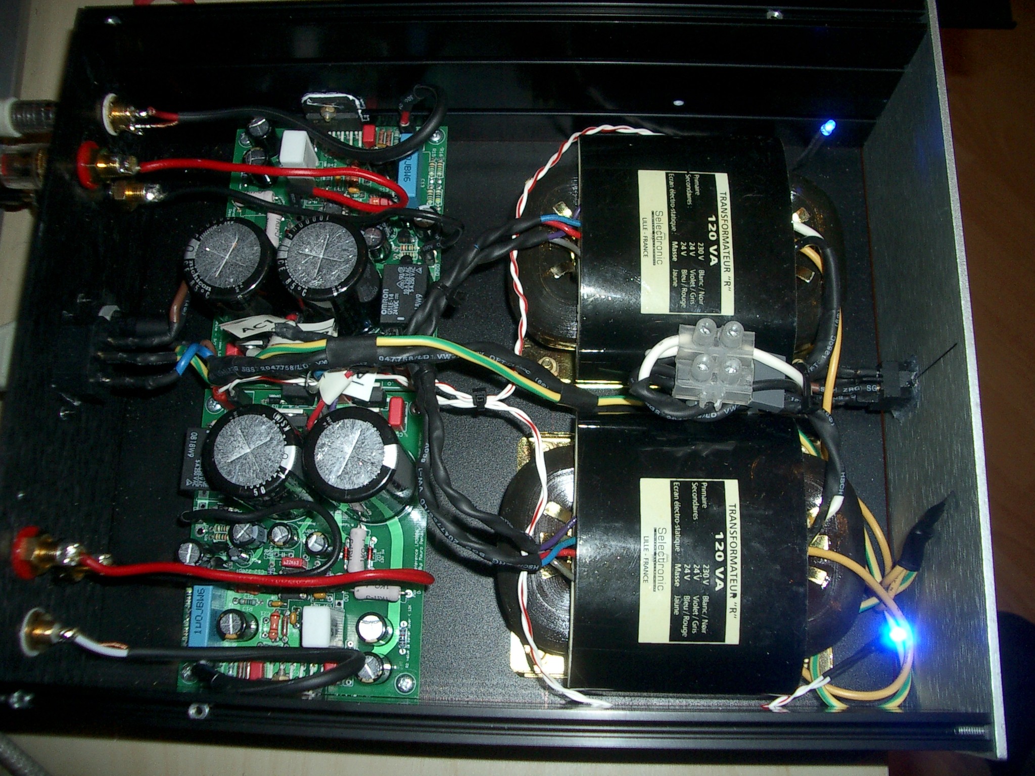

Ok, the size of aydyn true copper is huge ! Good question how am I going to fit them 🙂
I have enclosure - and it seems to be not too much space after all.
Tomorrow or sunday will figure out what and how 🙂

My layout will be like in this picture.
I ll have gap in the middle approx 2 inch, so it will be be more space for transformer wires.
Rcas in the corners, iec in the middle.
I think this is actually Dario's old build on a picture 🙂

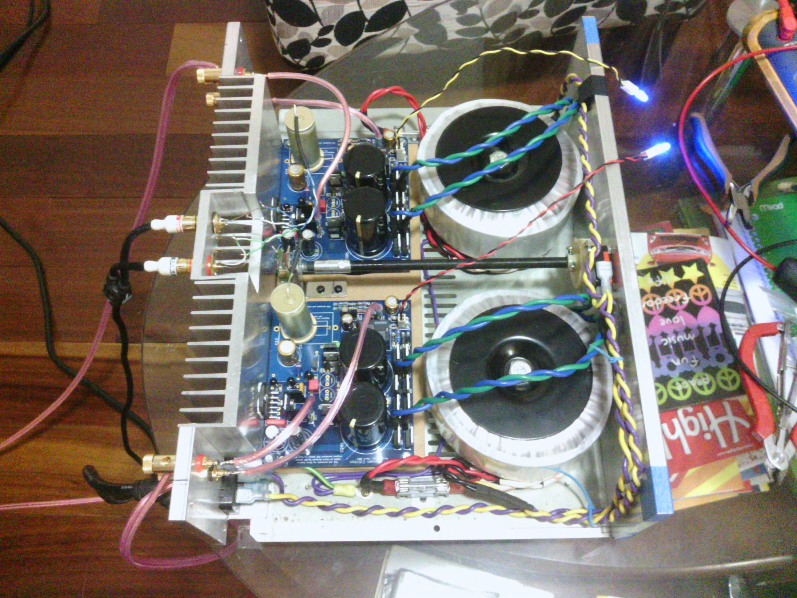

Wiring
Basically this is how I see it.
Only input caps not known location yet. I can put them outside, but caps will be too close AC wires.
All wires will be cut to length.
Binding posts coming too ...
