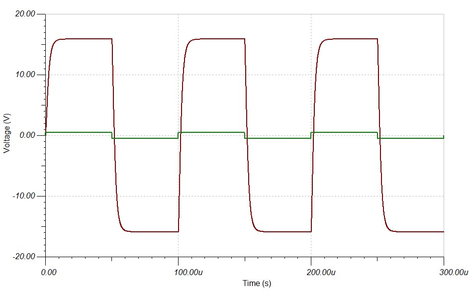

Hm, i've found a working lm3886 macro. Have installed, and got all-over oscillation like Dejan.
Now, got curious, had removed the control opamp (lm318, opa827), and had left only the bridge driven directly by the generator. Inthe case of the lm4780 macro, i got ~60kHz power response (on 8ohm, 10Vp-p)
With the lm3886 macro installed, the power response of the only bridge is ~210kHz..
I think I need to ask my hp3577, who is closer to reality.
But, as mentioned before, the real full circuit IS stable, and that brings it closer to the lm4780 macro..

Hi George,
I tried to replace LM3886 in my simulation with LM4780 and now I get a stable circuit, without oscillation.
I used LM3886 TINA-TI Spice Model instead of LM3886 PSpice Model that gave me same problems that you have described.
Based on your measurements, it seems there is some problem with LM3886 model and LM4780 model gives simulation results closer to real world measurements.
I will try to simulate with AD797 and ADA4898-1 models to see what happens. I hope you will get a stable circuit, and hopefully, a great sound.
