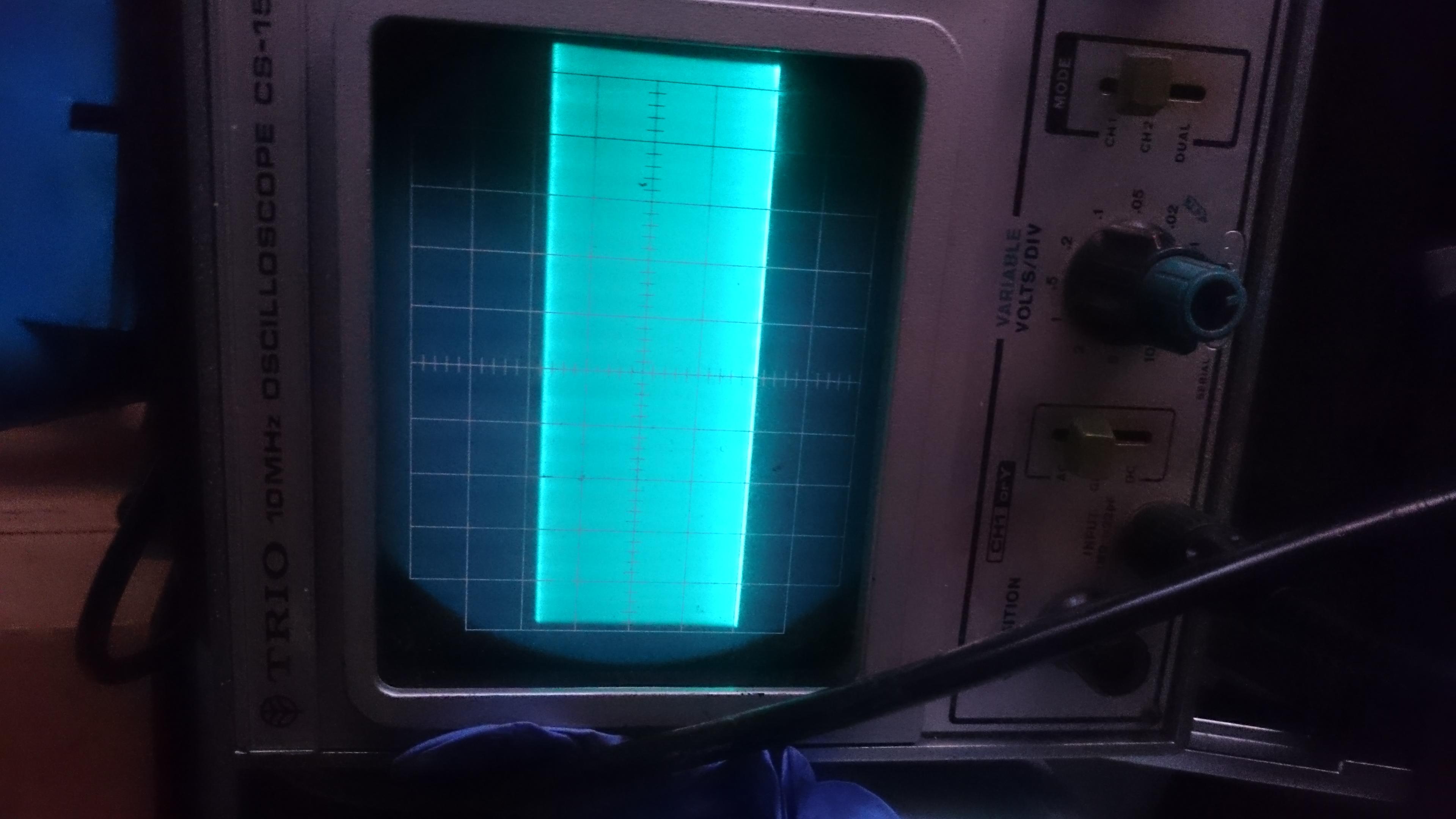

Just thought I'd share this as it might help others.
In the last week the amp has started to make some horrible sounds on start up which died down but you could still just hear buzzing on one channel.
Attached the scope, dummy load and shorted the inputs. The output on the bad channel (see pic) looked like it was oscillating at higher frequencies than my ancient scope could measure.
Seeing as this was a time induced fault I guessed was either a component failure or dry joint. I removed the board and started checking. Seems in my haste to install I didn't remove any of the flux from the soldier joints! Quick scribe around with a needle and then a scrub with solvent and brush it was all removed.
Assembled and checked again, no more noise!
Also attached a couple of case pics too.

Bc108,
I have difficulties to beleive that the resin residuals can cause this kind of problem..
The missing shielding around the LM3886 instead can lead to exactly this kind of oscillation..
What do I mean: the relatively high impedances in the bridge around the LM3886 renders that zone very sensitive, and the chip's velocity, essentially out to the Mhz range in the small signal region makes it a good receiver.
The unshielded metals around it instead act as a very good antenne for pickup;
So, for stability of the circuit it is essential a low impedance direct connection between the board's low impedance ground plane and the heatsink of the LM3886 chip.
Why did I enter this lengthy tirade: because I've been looking closely, but notice zero low impedance connection in your setup..
For this purpose you had only the PE connected to the chassis, which is a joke, RF and shielding wise.. (this was not directed to You, but the numerous PE advocates, on this forum..)
Ciao, George

Hi George,
I agree, It's not my contention that thorough cleaning effects the operation of a project. It simply allows one to spot things like cold joints and solder/wire bridges. Those can be tiny and easily hidden on a dirty board. 😉
To be clear, I'm not questioning the practice of cleaning the boards after assembly - very good and necessary practice, indeed.
Only that I consider the scope shot of bc108 a major fault, I doubt it could be the result of resin remnants, and I feel a bit of investigation is needed to clear up the situation..
And I think to have seen a clue in the photo of bc108's assembly..
Ciao, George

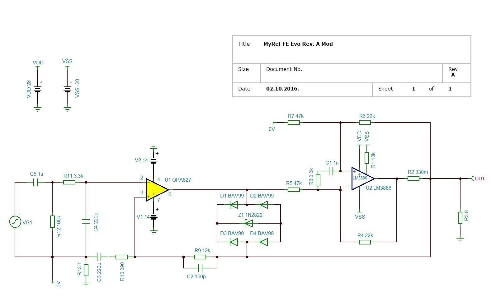

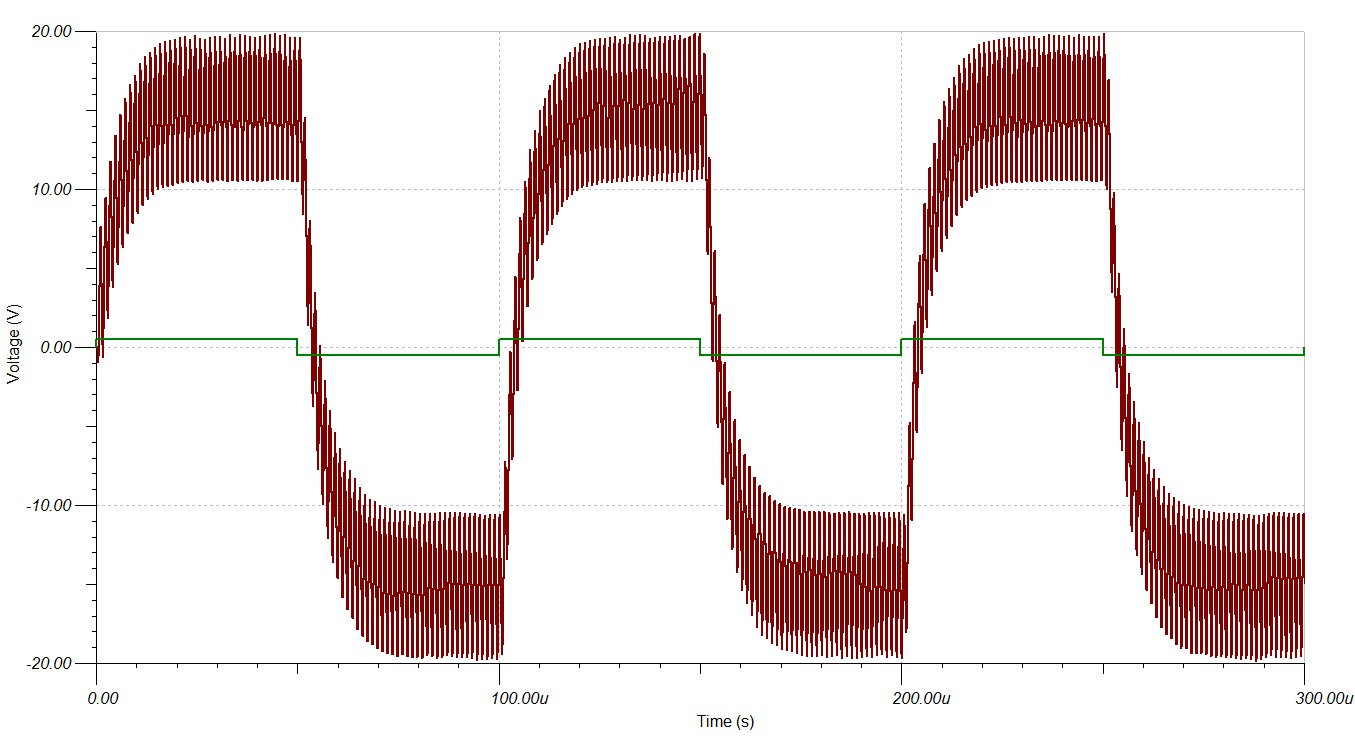

Hi George,
I tried to reproduce your simulation results of MyRef with different opamps, but without success. I keep getting oscillations on the output. What am I doing wrong? Are the component values right? Or something is missing?
Here are the circuit and the results.
Dejan
Dejan
Dear Dejan,
As far as I see, you have done everything as it should be.
The same schematic does oscillate much less for me..
The only difference that we have is that for me, the lm3886 macro did not work, gave a pin mismatch error - so I stepped over this problem by choosing the Lm4780 macro, which, in theory, should be the same circuit, but a different macro..
Then, in reality, I have observed a slight oscillation, and as told, had to decrease the Cf value from 150pF to 100pF to get it stable.
How did you render the lm3886 macro functional? I would be much interested, because if it's more 'stringent' than the 4780 macro that would be a great help..
Anyway, since the last time I did a bit more testing. I did implement in an again another MyEvo amp the OPA1688, and have been listening to it.
Had also stabilized the LME49990 in an FE modul, and had made more test. It is quite clearly different from the lm318. Still has to listen to it. What i do not like so much is the amount of efforts needed to reach stability. Not so easy-going like with the Fet opamps.
I have just received some AD797 and 4898-1 to try to stabilize...
So, if can exchange models, I would try the lm3886.. and we could go on and get stable your circuit with that model, too.
Even if in real life it IS stable, in ~agreement with my actual model..
Ciao, George

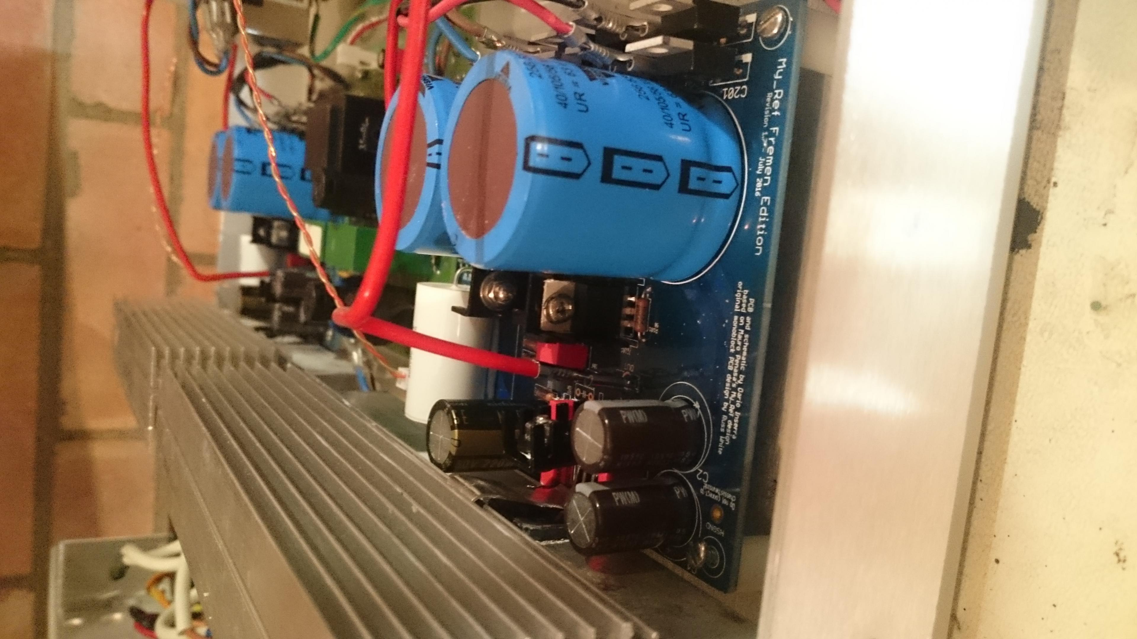

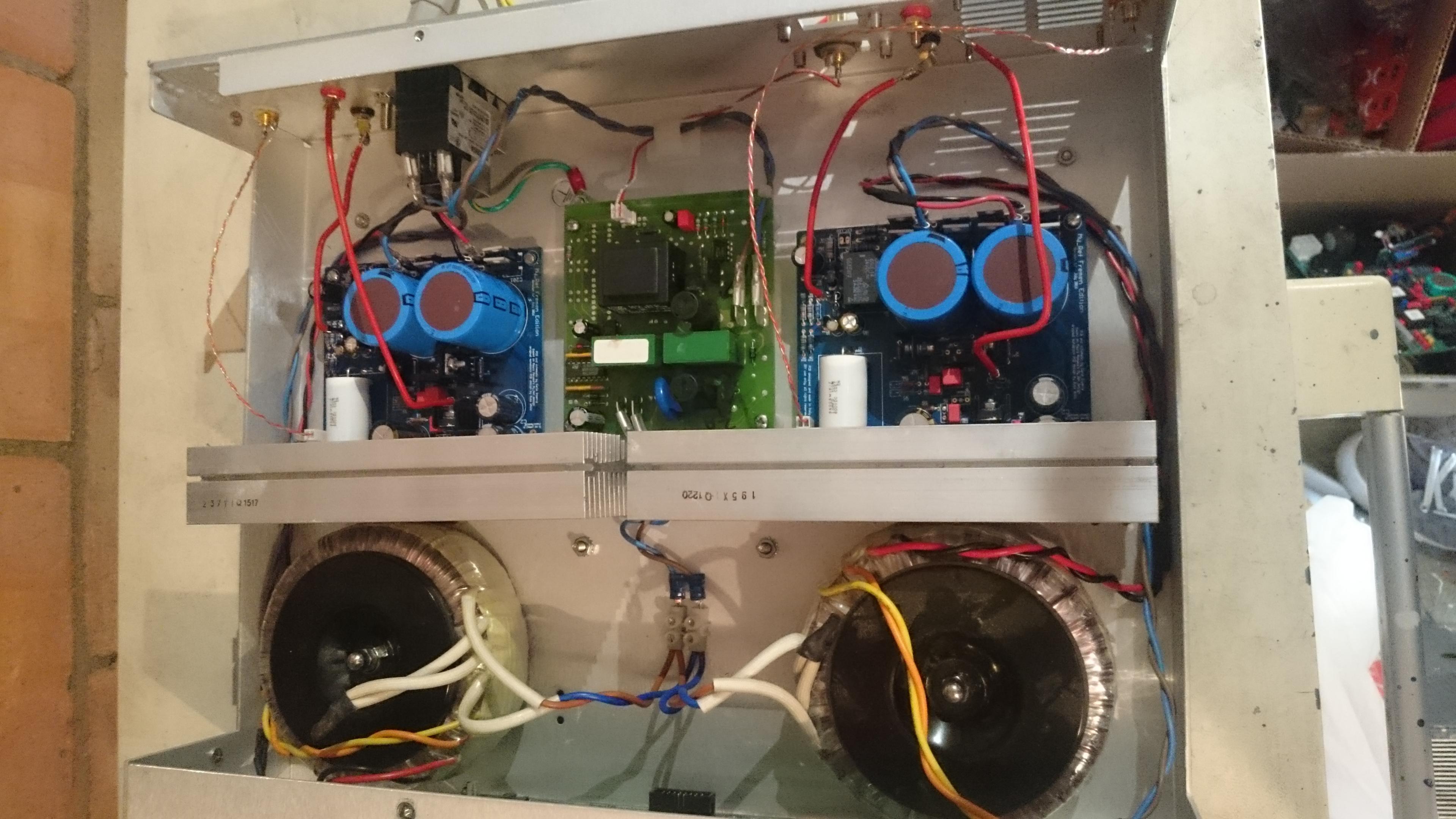

The other day I completed upgrades 1-6 per Dario's numbering and put about 12hrs on the system.
This involved replacing C9 KZ with Cerafine and replacing RN55 at R7, R12 with Z-foils. All the others upgrades I already had in place. C32 is still in the original orientation.
The overall build is shown in post #2405. It's now the current BOM but with PTF6 in two places and R11 still KOA.
The sound is good and the timbre is nice. But I find the bass a bit boomy and heavy-handed. I changed my room and setup a bit, so this is not an A-B comparison.
Would replacing R101, R201 and R11 with RN55 type help my situation?
What are the sonic differences with the My_Evo Rev. A compensation? Would that take me in the right direction?
Are ebay Cerafines from asia a safe bet?
BK
Today:
- Replaced R101, R201, R11 with RN55 (had PTF6 and KOA)
- Replaced C1, C2 with Nichicon 50V PW (had 63V)
- Converted to Evo (remove 2 things, change 1)
Now FULLY in line with current BOM and upgraded with all the "audiophile" parts for grins.
Sounding really good with nice authority. Still seems tilted to the low frequencies, but I will run for a few weeks and see where I end up.
BK
