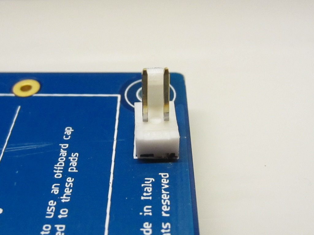

Has anyone assembled their v1.7 boards yet?
Forgive me if I'm being real stupid but I cannot get any continuity from signal GND to any component on the board.
This is the same for both boards that are fully populated.
Just de-soldiered the signal input connector and the IN pin (signal ground label under side) is floating, not attached to the ground plane that runs under C13.
Just checked on my yet to be completed 1.7 boards.
The signal ground on the input connector is unexpectedly floating as reported by BC108.
I'm really sorry, it seems that after redrawing the schematic for this last run the schematics' wires of the input connector, while apparently connected, they were not... 😡
This can be fixed with a perfect functional and aesthetic result, though.

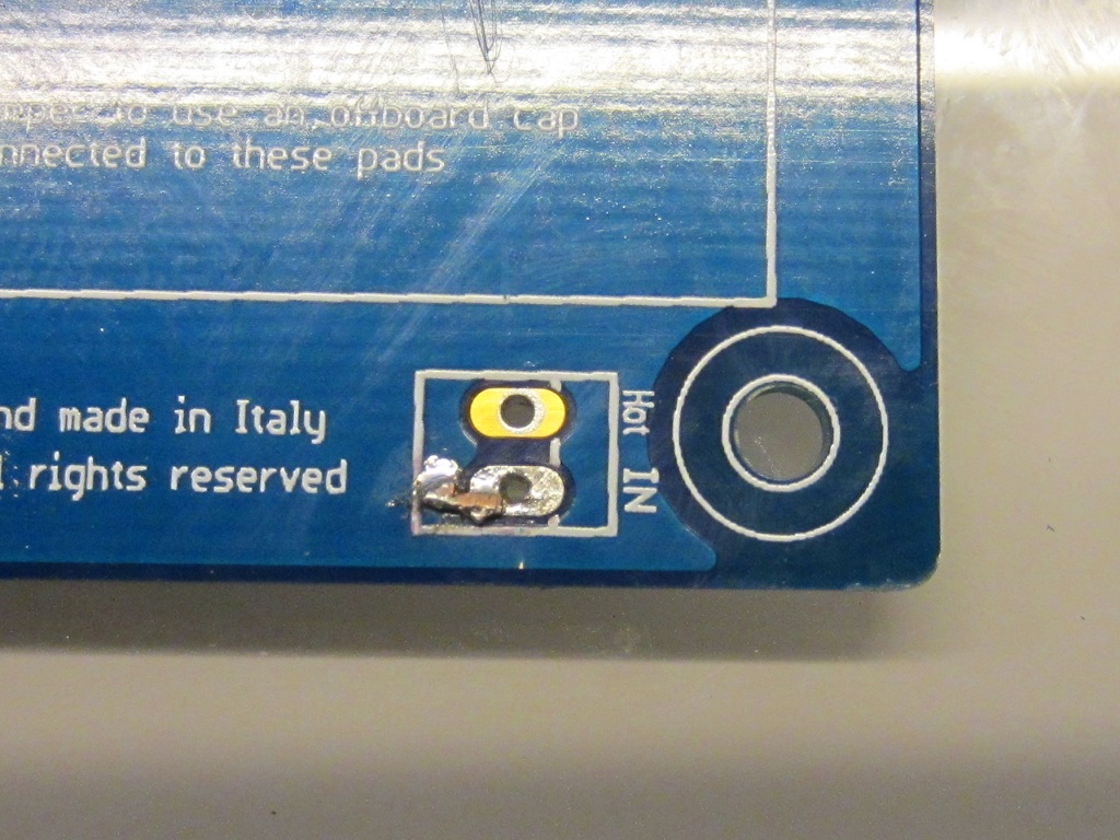

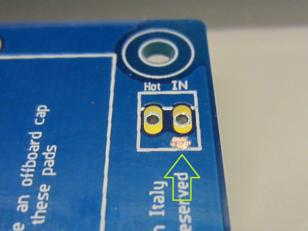

Scrape a bit of solder mask near the ground pad (remain in the connector frame):
Solder a 2mm piece of copper wire (can be a trimmed wire from a resistor):
Invisible:
I've updated the build tutorial accordingly (it includes some other small fixes).
