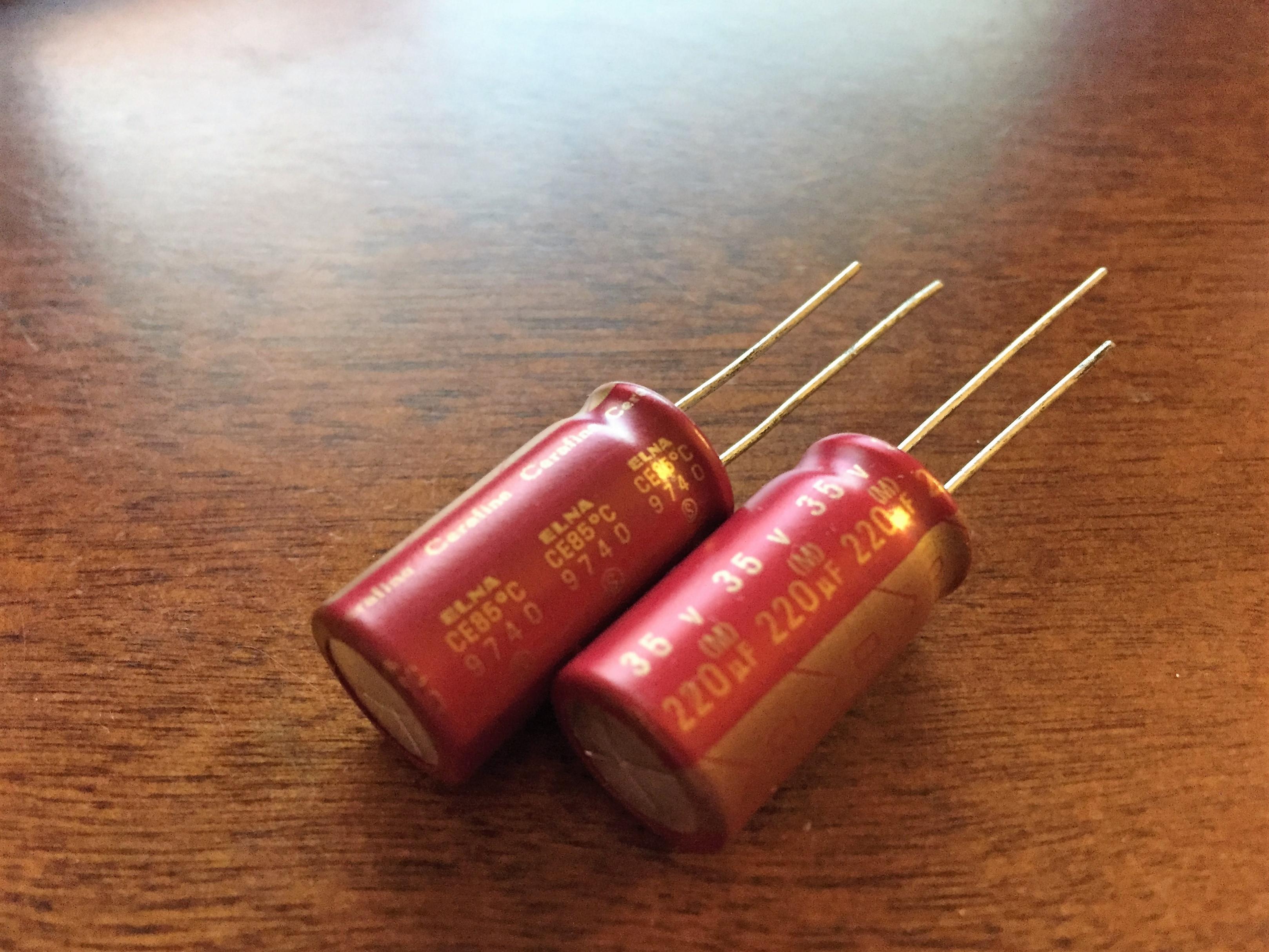

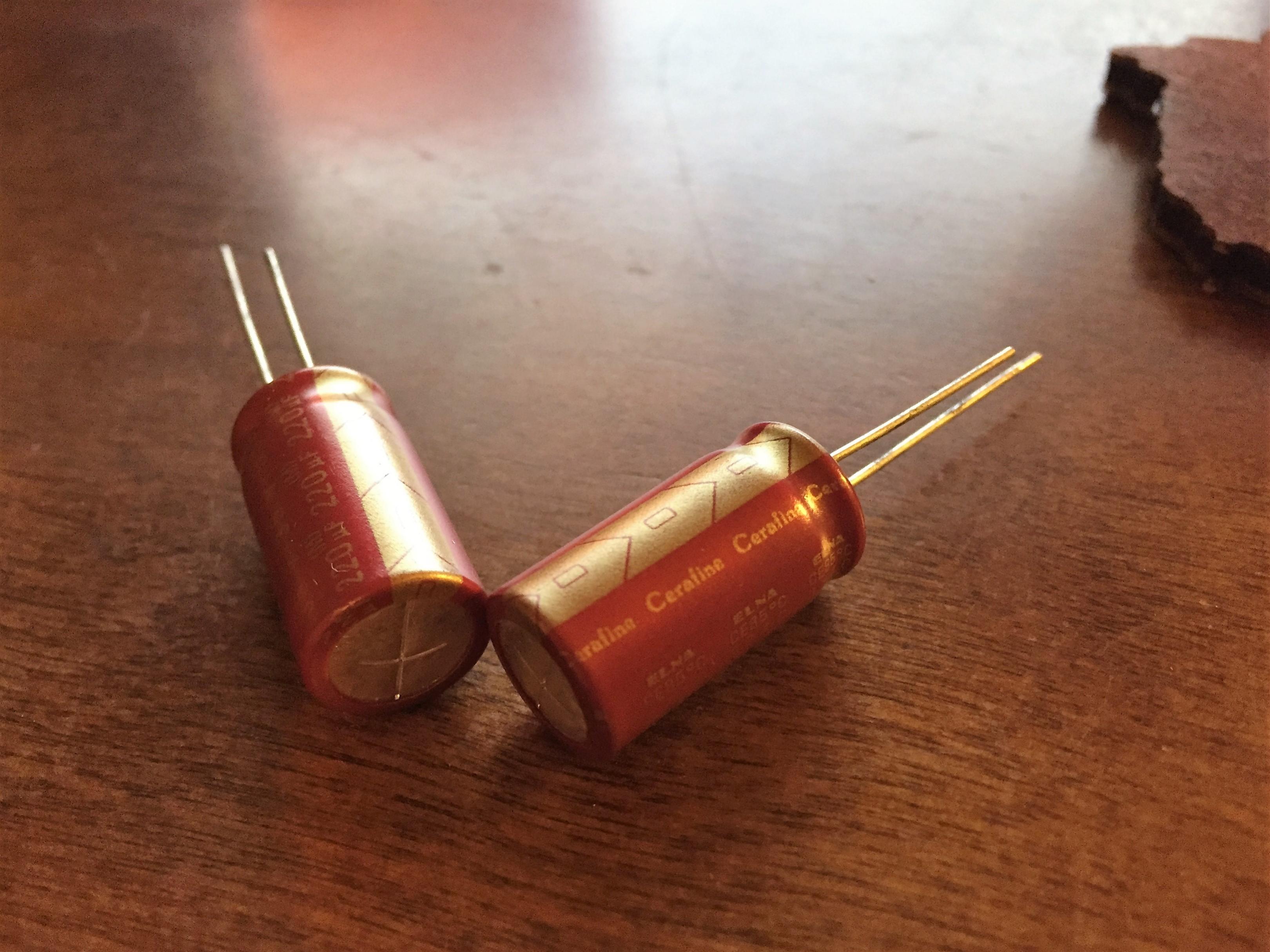

i was trying to get the best parts for this amplifier , c9 is a very tricky component , i hope i got the right cerafine . What do you guys think?
I used the 50V black version, fwiw. I might go back to the Nichicon KZ to see if it's a better overall match for my system.

Thanks BK, that means you are not 100% happy with the cerafines?
Not sure yet. Still chasing some weird bass. Not 100% certain my ebay cerafines were legit - just random concern and I have no reason to believe they are not authentic. Changed a few things at once a while back, so can't say for sure what the cause was.
Anyway, note that Dario's BOM footnotes indicate >50V for the cerafine part and your red ones are 35V. Try them and let us know what you think!

you are right about the recommendations, but Dario said:"C9 usually see at best 2V so a much smaller rating than 50V can be used.
The theoretical maximum is 36V but just in case of fault.
So, in the past, we considered acceptable that C9 could fail in case of fault (the DC protection kicks in before anything bad could happen) to be able to use a really good sounding cap as a BlackGate PK.
Now using Cerafines rated at 50V we could have both, really good sound and circuit resiliency."

Yes but for Cerafines the 50V rating is very important also for the perceived sound quality.
Lower voltage ones don't sound as good.
Red Cerafines are the previous (older) generation ones and they sound a bit different, a bit bolder/fuller.
They will do fine but in general prefer black ones which are more fresh.
