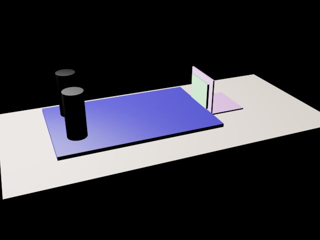

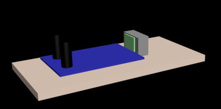

By parallel I assume you mean rotating the LM3886 90 degrees. That appears to require either a whole bunch of lead bending or an adapter which might introduce an unknown factor to the FE design. Dario can comment on that. The addition of an "L" bracket or transfer block does sound like an interesting possibility. I might try that myself.😉
I have built a couple sets that are alternative arrangements based on the lower heat dissipation requirements of the LM3886. Many PC CPU heat sinks are adequate as used in my Mini Build, and a single small piece of stock from Heatsinks USA can handle one or two modules as used in the Monoblocks. So I feel the single module format and low heat properties allow many imaginative mountings.:scratch1: 😀

......... Admittedly I have grown tired o f case making.
Your idea has me hooked again :cheerful: and am now pondering a simple five piece (HS, bottom/front, cover, 2 brackets) stereo chassis based on my monoblocks. I'll post the design and cost in a couple days. It will require just two bends on inexpensive 1/16" aluminum from my local shop. If you like it - could save you some effort. Stay tuned ....
[/url][/IMG]
This is the monoblock. For a stereo build the height will be at minimum equal to the width of the FE modules. The depth will have be set to allow mounting up to a 300VA (D=4.8") toroid trani. Power switch and LED mountable on front or back. The width could be expanded to the 17" standard to match other system components.
