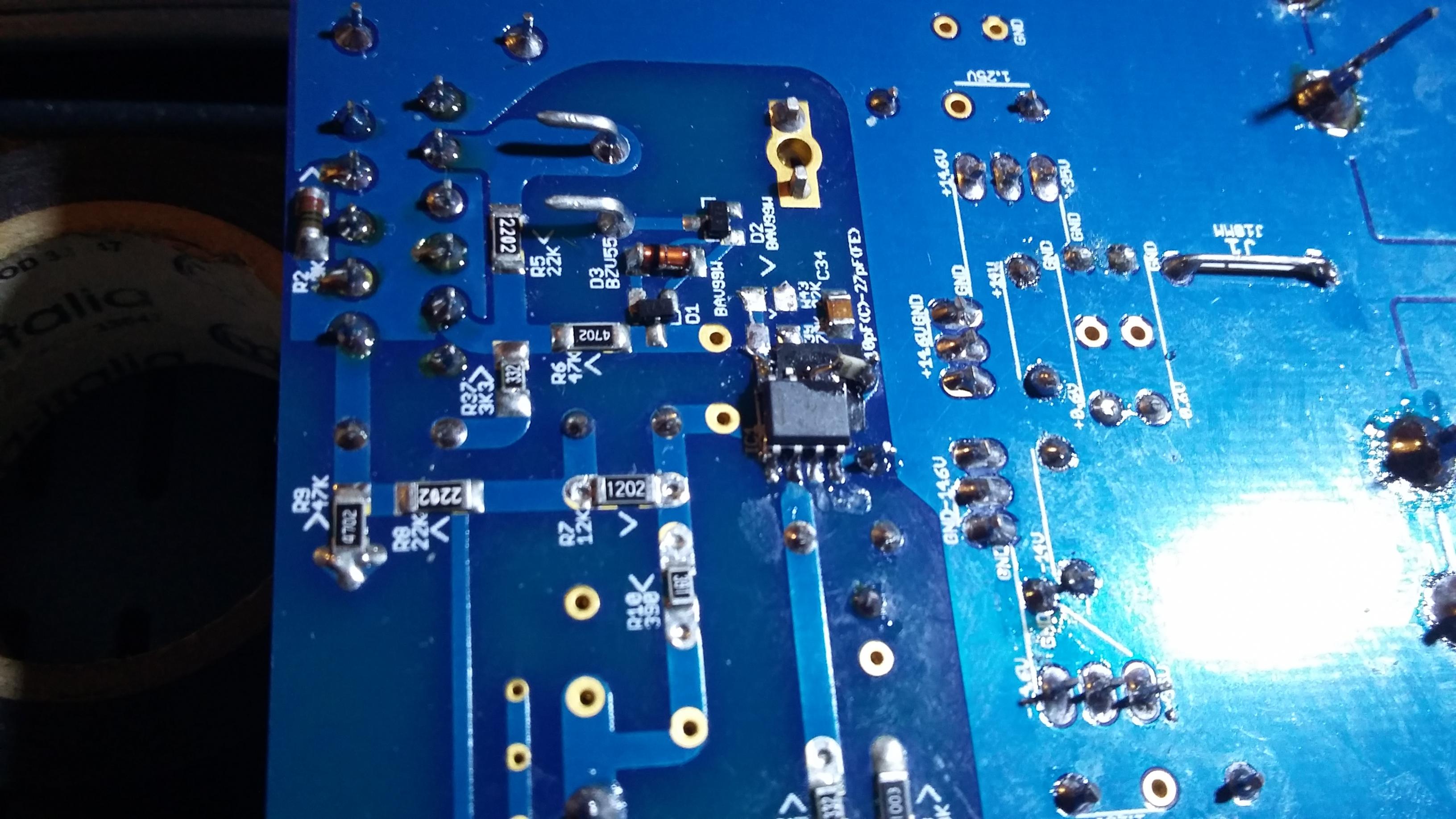

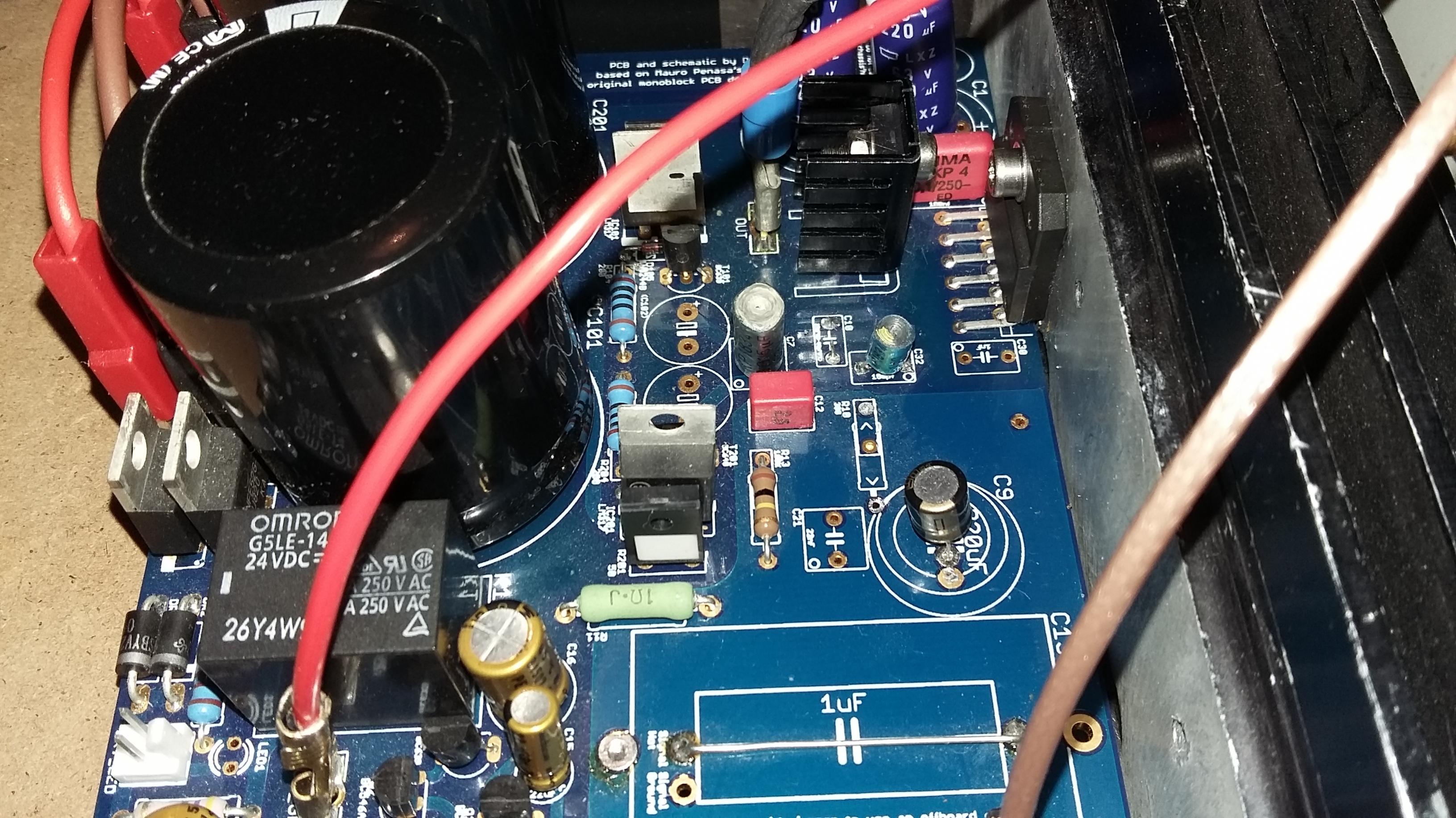

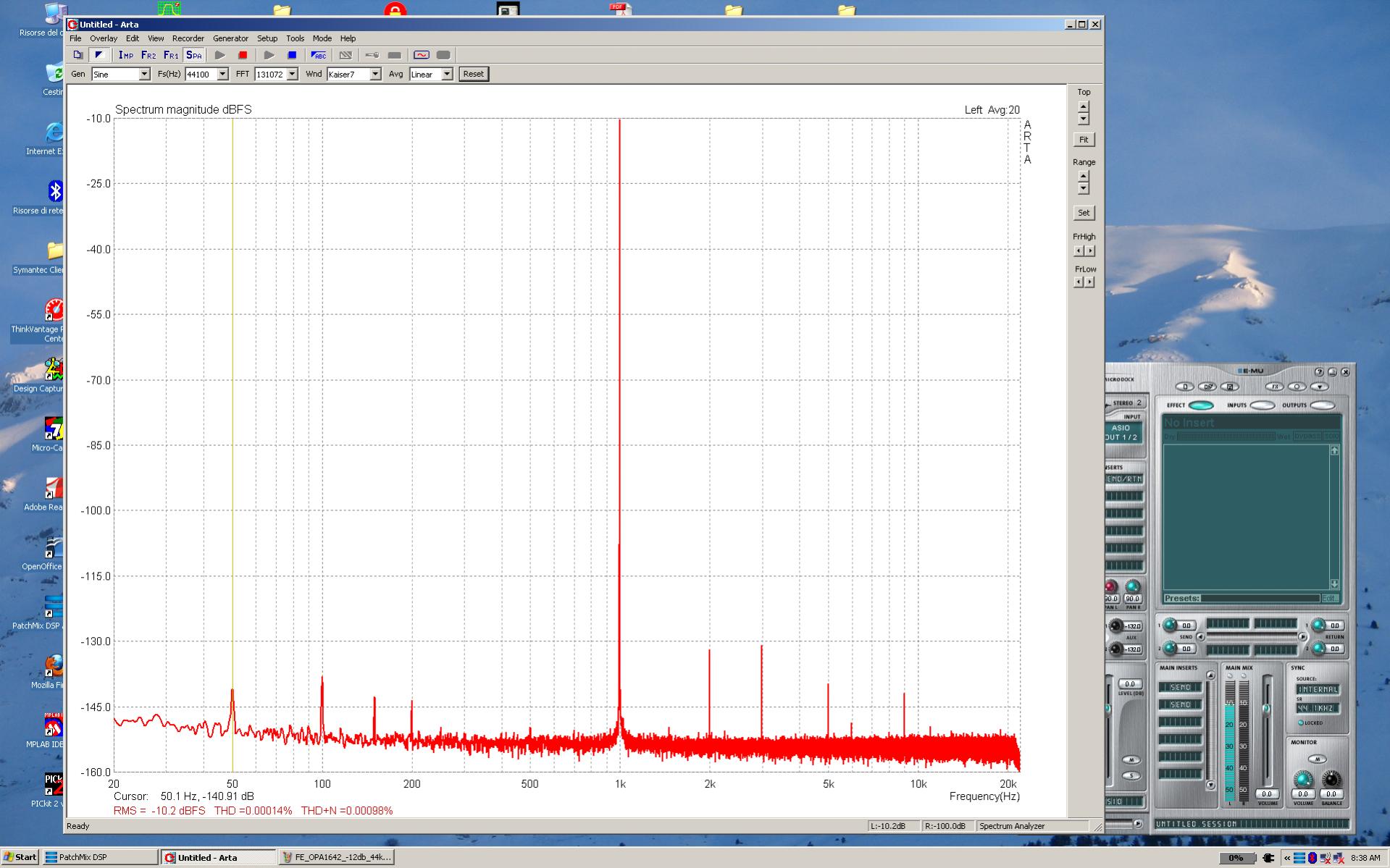

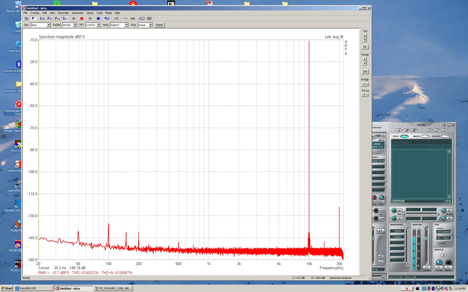

Here below is the OPA1642 in the FE board.
I hoped - hope in this chip (that is precisely the 1641, for the direct easy placement in the FE - Evo structure) because of the good sound that I found when trying it out as Dac output stage i a 4490 design.
FE_OPA1642_-12db_44k_5W_high_multitone_kulsotap_10mF_1_aug.jpg286.3 KB · Views: 302
FE_OPA1642_-12db_44k_5W_IMD_13-14kHz_kulsotap_10mF_1_aug.jpg263.8 KB · Views: 291

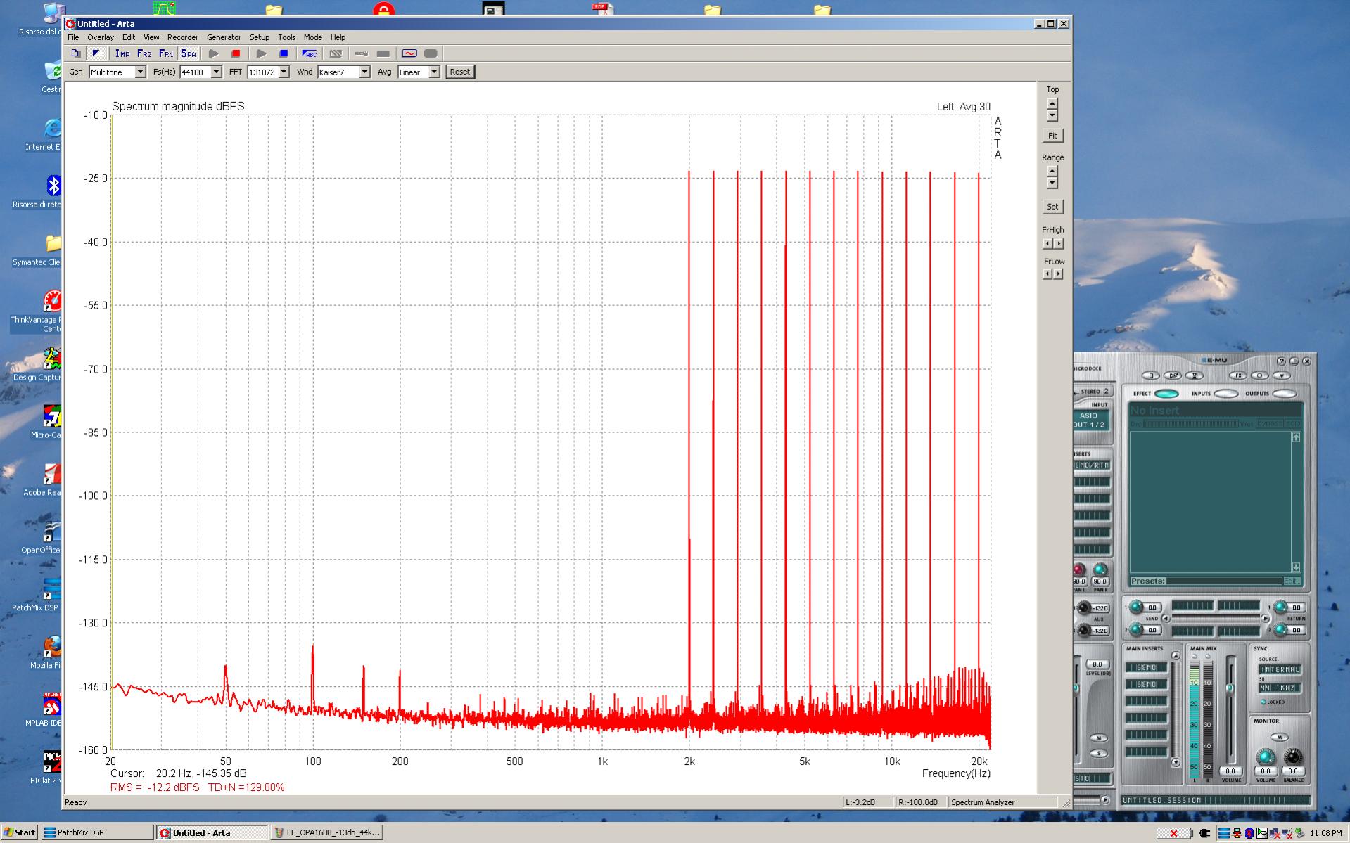

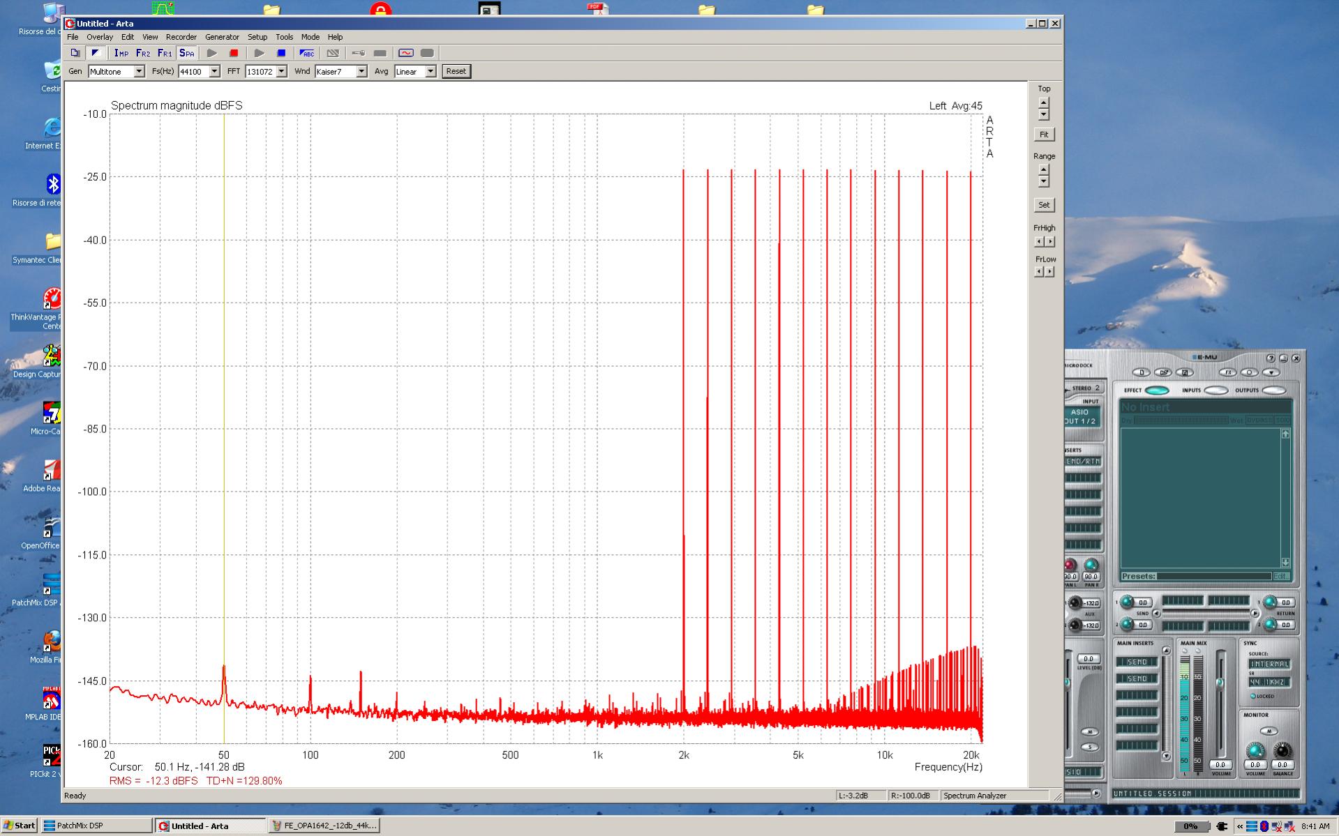

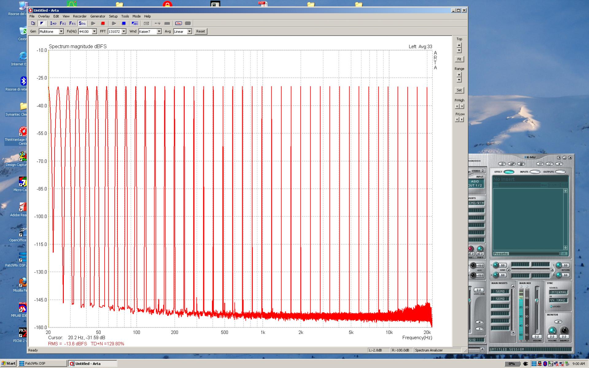

And here I would ike to stop for a second and 'meditate' about measurement methods..
In some other places in this forum one can see multitone testing applied (ok, it's childish, I'm talking about Tom's testing)
He likes it, discovered it ~recently, and boasts (rightfully) with his full spectra multitone test results..
http://www.diyaudio.com/forums/vend...r-achieving-0-0004-thd-n-212.html#post4682725
Now, why do I not like it? That is more precisely, I retain it to be not the most useful test, while certainly good for showing (nice) results?
Have a look at these to shots here below:
First is the same full scale multitone test signal what Tom is using;
Second is the short form of this, what I call high-multitone test signal, containing only the components above 2kHz.
Indeed. There are surely some little advantages, but also some drawbacks. Not convincing at all.[...][OPA827]
Had I started with this replacement in the FE, maybe I would not have ended up here, talking about it..
On the other end, the ADA is simply another league... with it the FE made such a GIANT leap that it become a different, way much better sounding amp. Under every aspect.
I would not install the OPA827 on my own Evo... while I will definitely install the ADAs (well, unless the 1688 or some other suitable chip will prove to be at least as good in there).

Ok, I would jump back to the multitone testing for a a second:
In the second case, the one with the restricted bandwith, all the energy of the test signal is concentrated in the high frequency components;
Given that the test signal amplitude (rms) and so energy is given, limited, in my opinion the second, shorter test signal stresses much better the high frequency behaviour of the Dut, making the distortion components rise above the noise floor.

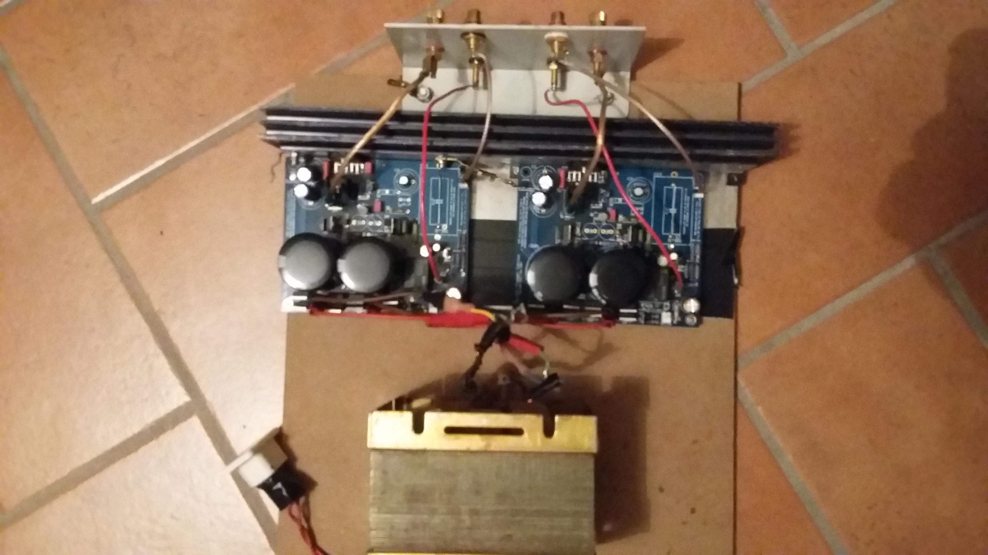

Dear Oleg,
but also Spartacus;
Do not trust me too much with the power harmonics present in the testing;
It is not an easy task to arrive to these ~moderately clean looking shots, especially that I'm using single ended testing, and using the outputs/input of the same 'instrument', EMU1616m sound card.
So a big, unavoidable ground lop is formed in the test setup.
Without isolation transformers, or differential signalling one has to be extra careful about the exact topology in testing. Use of a shield for the DUT is obligatory. The way that the grounding of this shield is executed is important. Also, I'm using tricks for breaking the ground loop - but the effects are to be tested always.
Also the EMI radiation fields are incisive; the presence of the big transformers directly beside the DUT does not make it easier, to obtain a clean signal.
In the meantime if care is not taken, at 'this low' level of the distortion components injected / or not by these amplifiers it would be impossible to understand the results.
So, forgive me for some noise leaks, sometimes.
Would like to clarify though, that all these tests were executed in a very consistent way; the graphs to be compared were taken in the same setup configuration as much as possible, even if in the meantime I was also tweaking for less noise possible.
In the same time, what I can confirm is that the 'real' signal harmonics level and the noise floor are real different for the different DUTs.

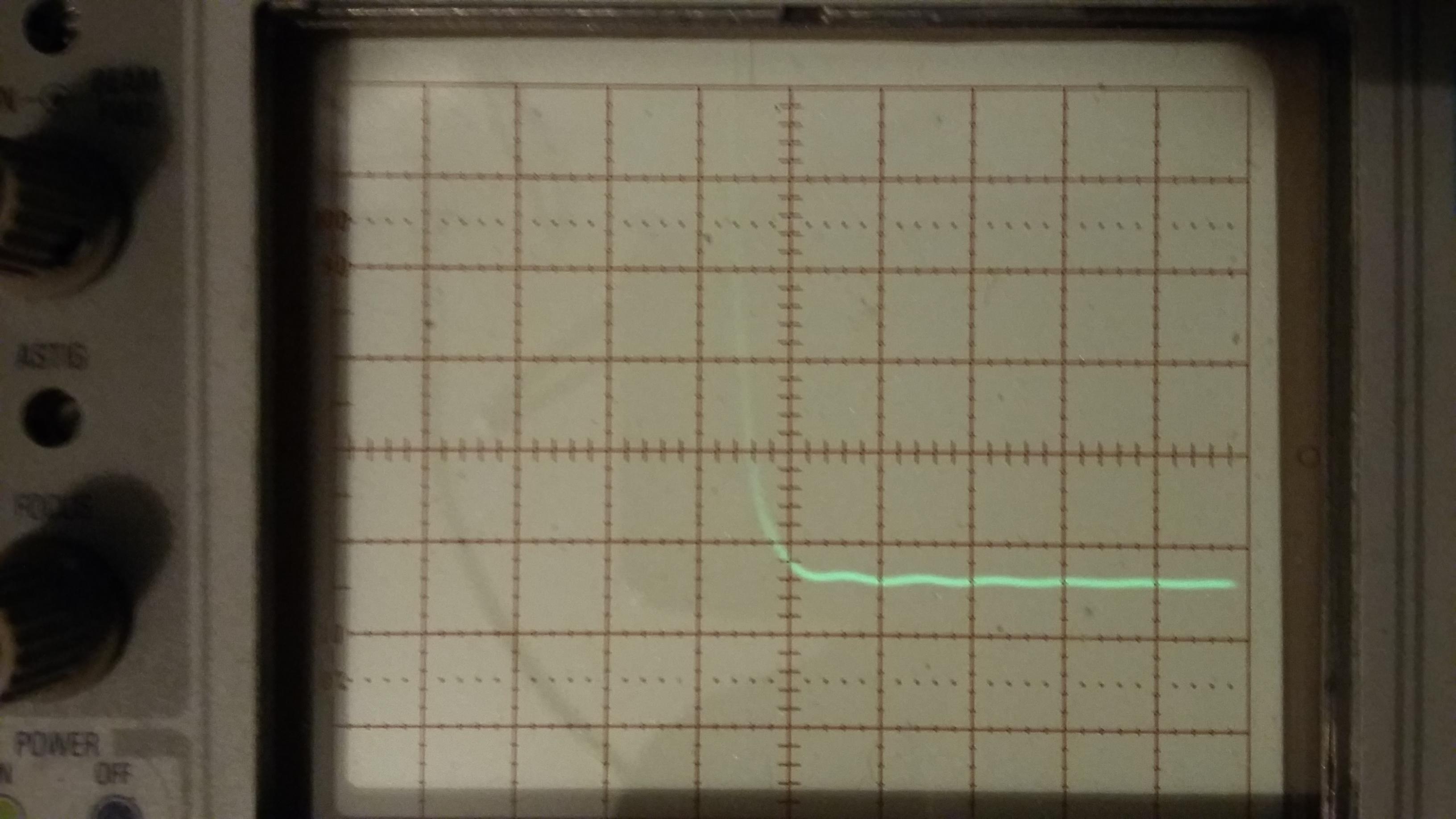

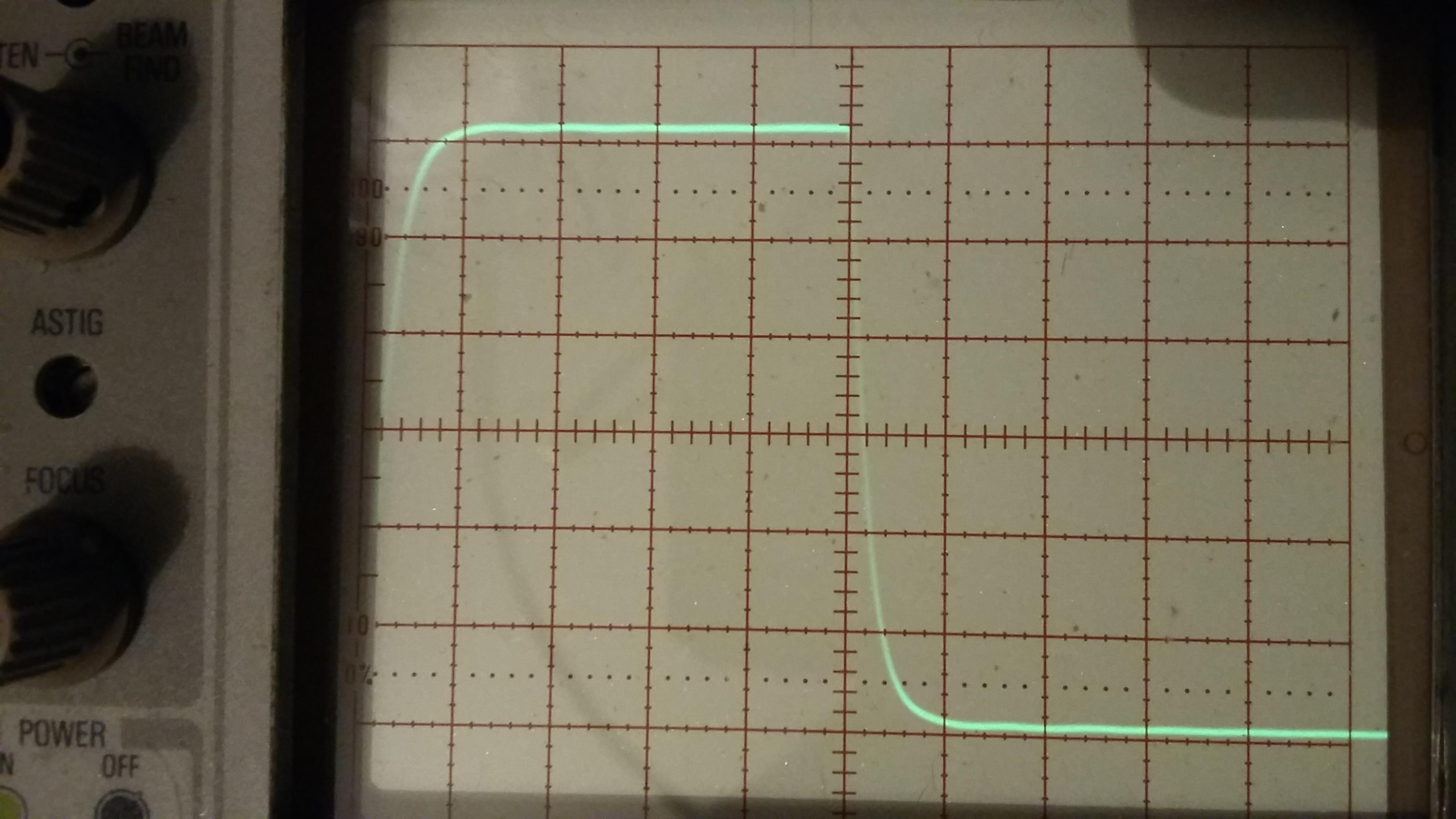

So, the previous little note wanted to be the introduction to the final step, for me, in this testing:
Here it is the step response to the OPA1688.
Some work is needed, yet.. Which is a surprise, the simulation did not show it.

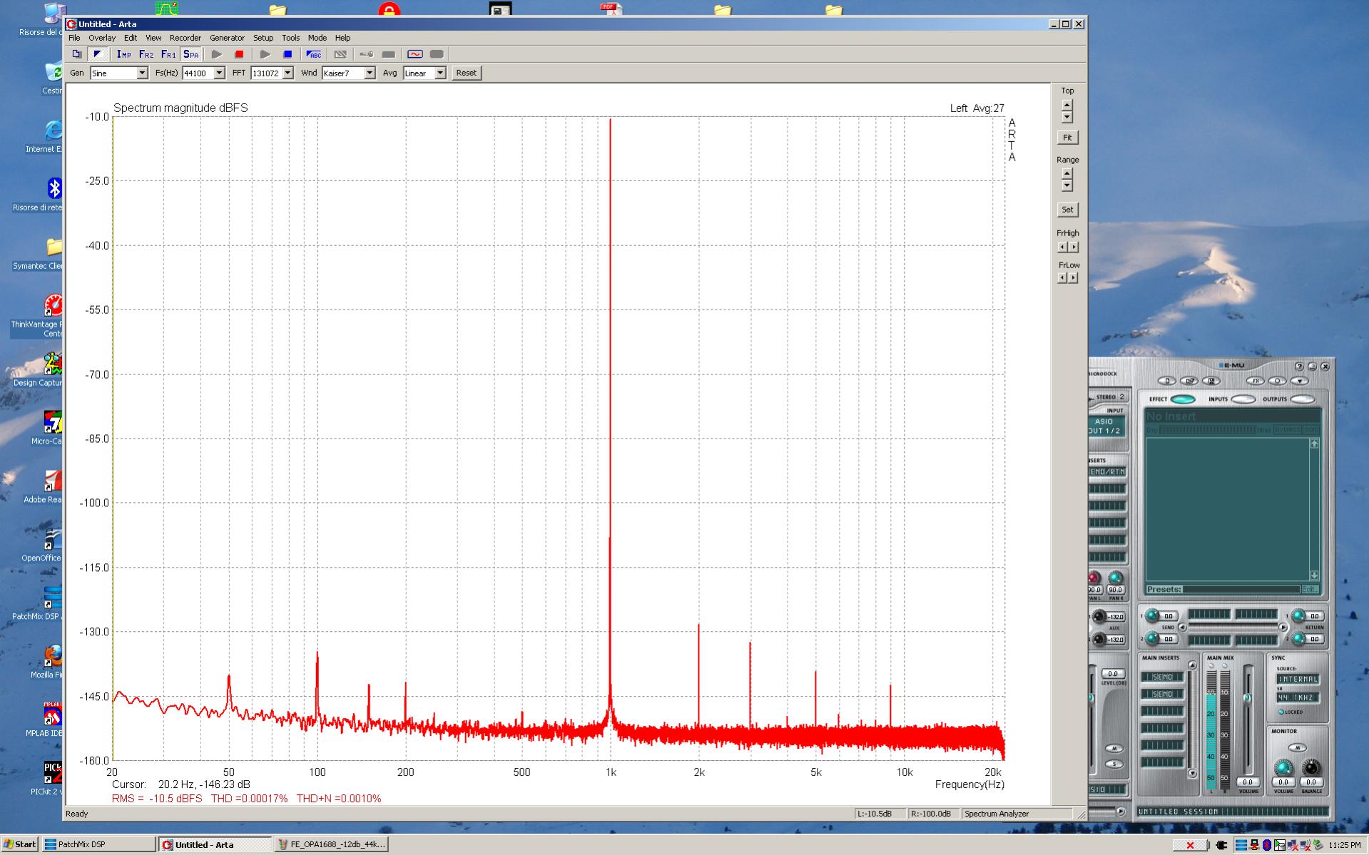

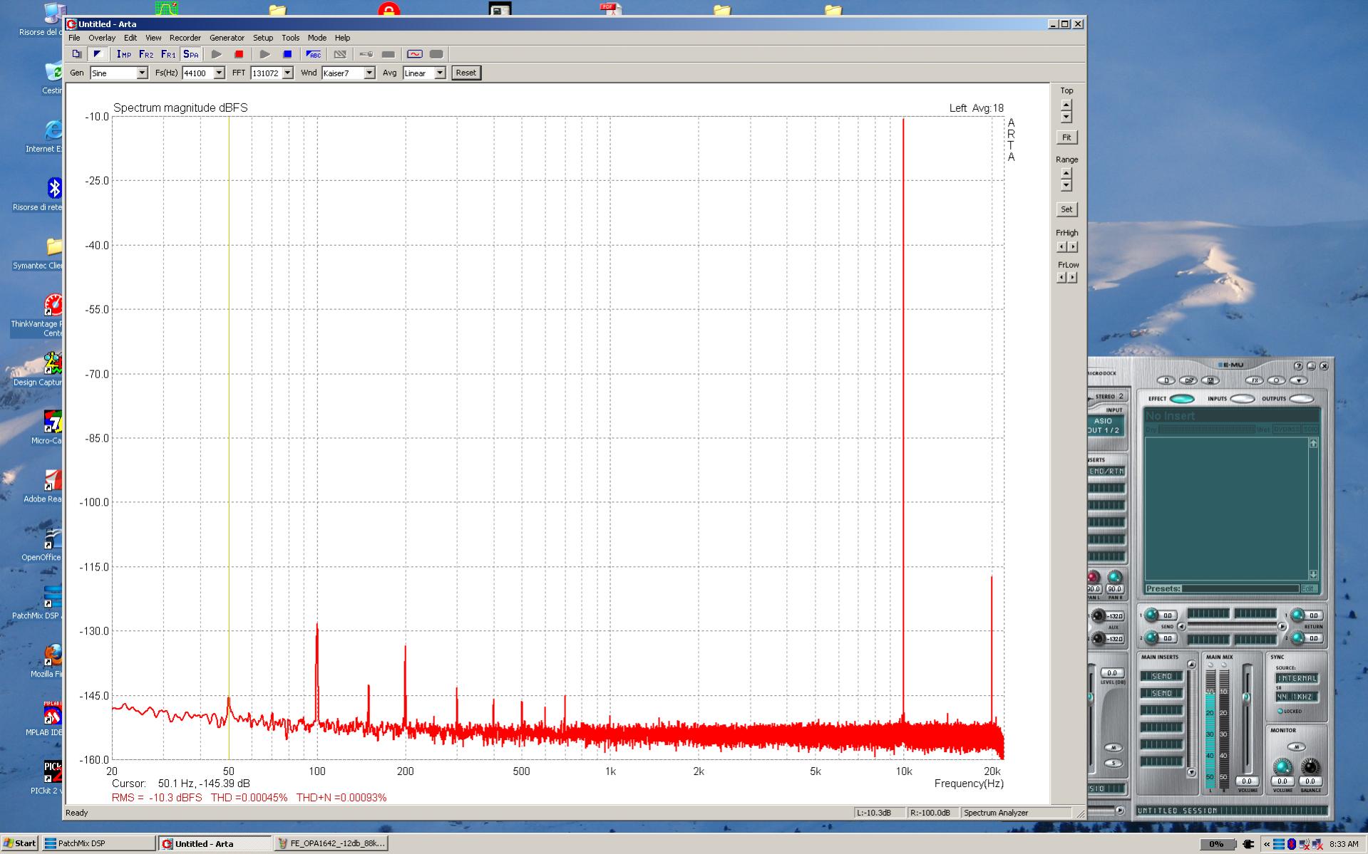

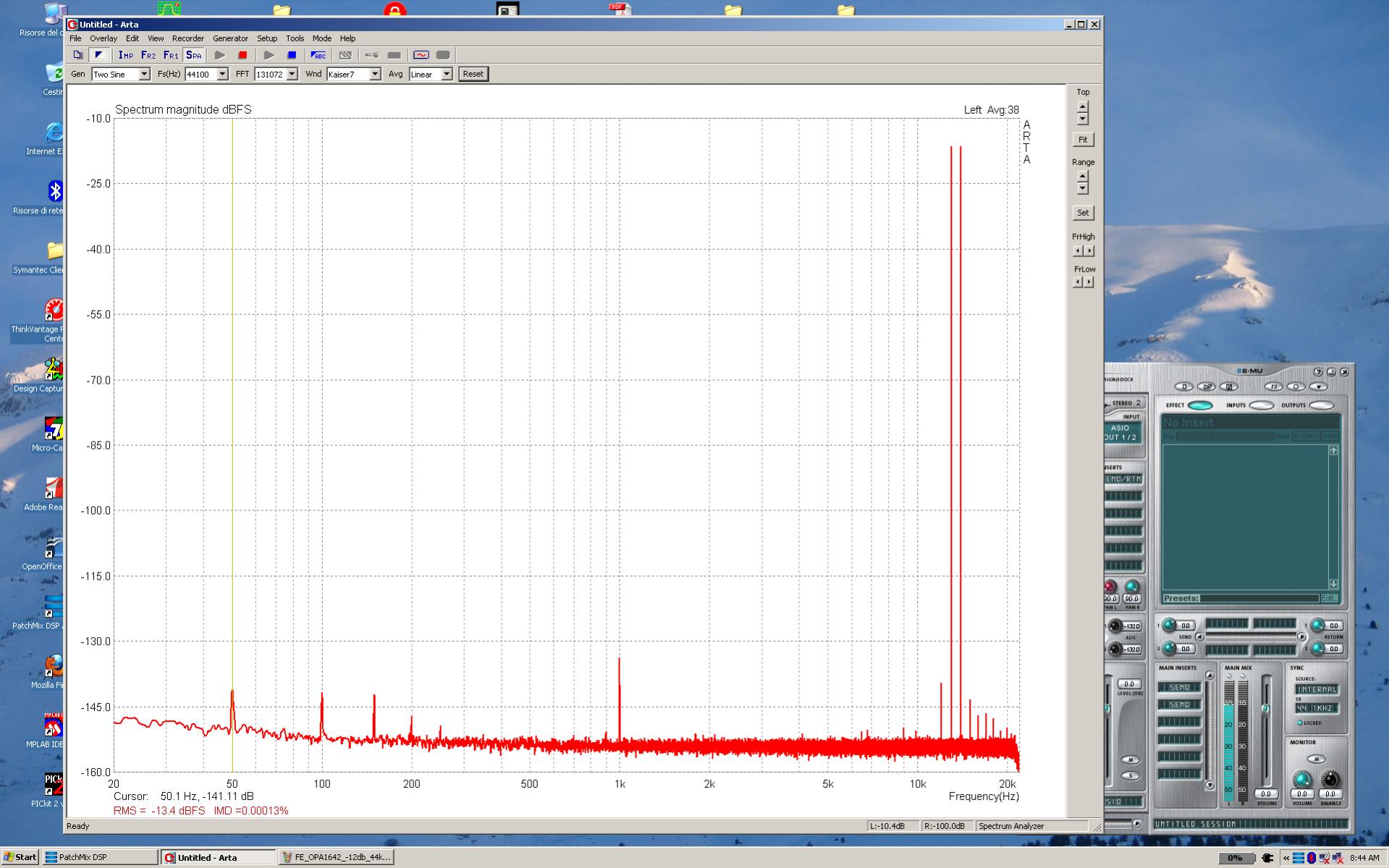

And here are the distortion tests.
OPA1688 in the FE module.
Comments: some surprises here..
As it was told before, the apparent noise levels in the graphs are pointing much more to me than to the devices.. still, especially in the multitone testing, the amount of fight to minimase the spuries presence in the ~ midrange/higher midrange frequencies -- is an experience which could be added to the tests like a 'parameter'
And while in case of the ADA4627 it was easy & almost first shot, in this case with this chip -- no way.
Also, one can notice the generally higher distortion figures. (1kHz tone, IMD test)
In the same time, the high frequency testing gave the lowest level ever seen up to now?! (10kHz)
And also in the multitone testing it is consequently low, the high frequency harmonics 'bush'..
It looks like if it were a chip with moderate open loop gain but with a high frequency corner..
Except for the fact that from the data sheets it is not.. Open loop gain has a 100Hz corner, at best?
