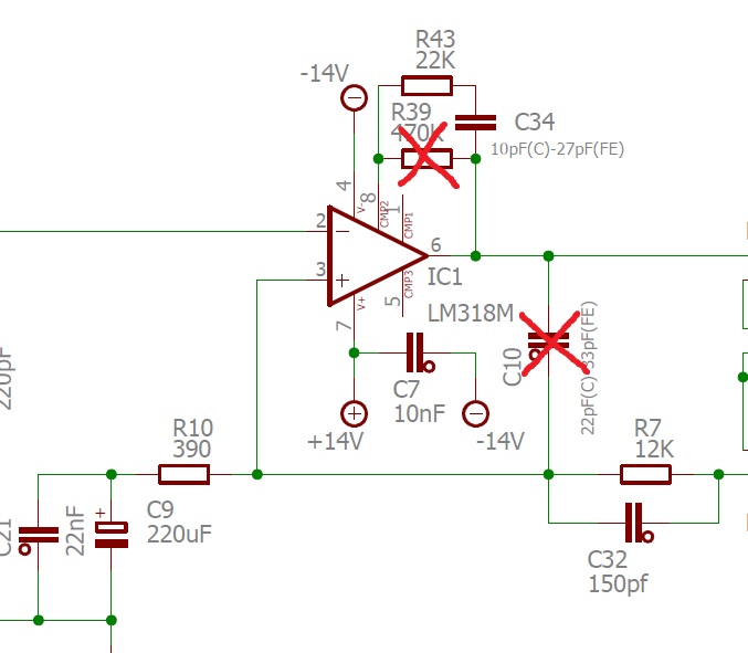

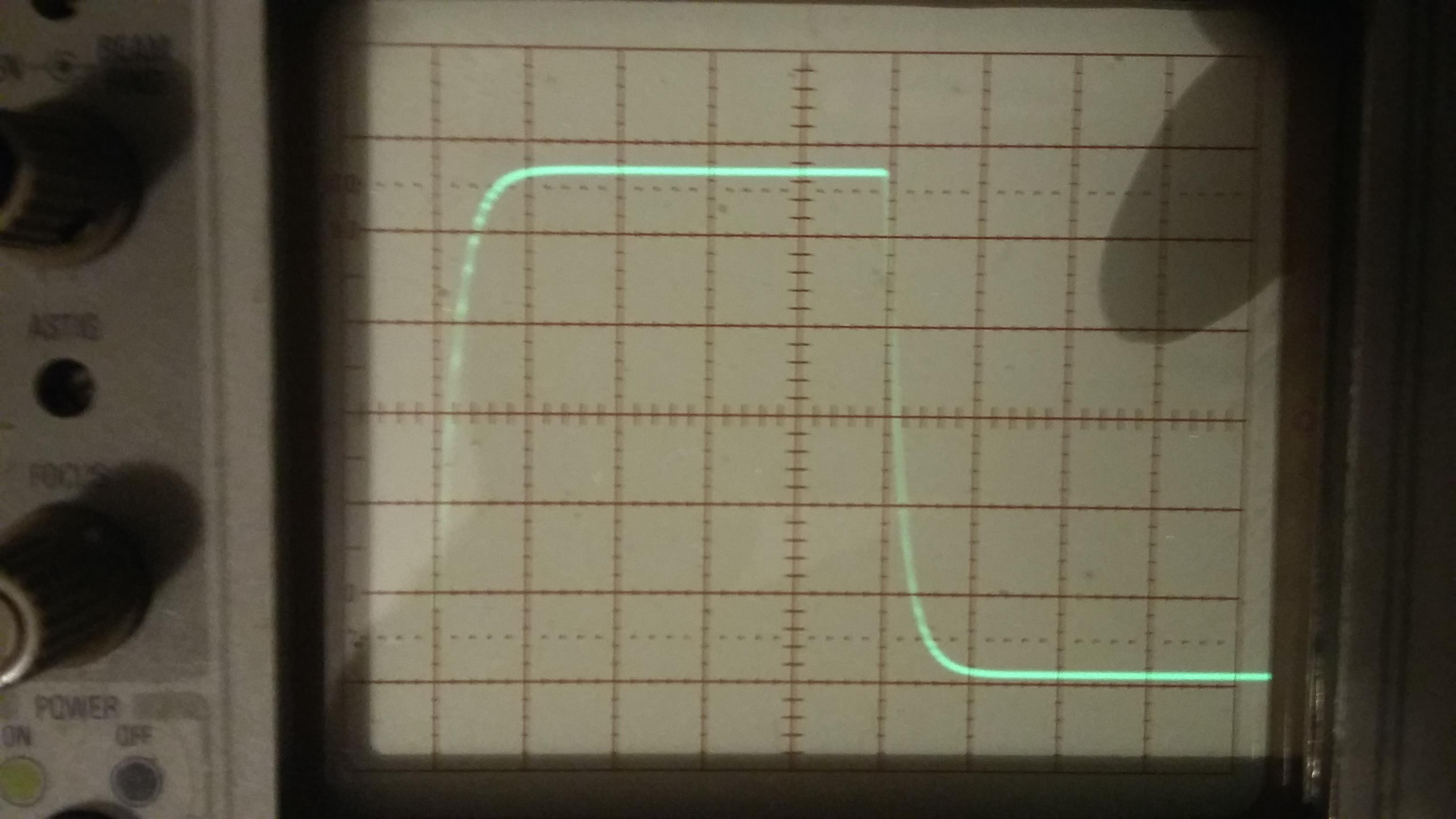

So I took the risk and put ADA4627-1 BRZ in the circuit.
It works, too.. results in an all stable response to the impulse test, like the one above.

Have a look at the "rev.A" mod. With it, the FF comp. via pin 8 is no longer required. That's what made it possible the use of different OpAmp (beware, not anyone!!).George,
How is the compensation network connected with ADA4627-1 opamp? ADA has no compensation pin like LM318 (pin 8).
Inviato dal mio GT-I9100 utilizzando Tapatalk
I still don't get it... With rev.A mod there is still R43 and C34 between pin 8 and output.

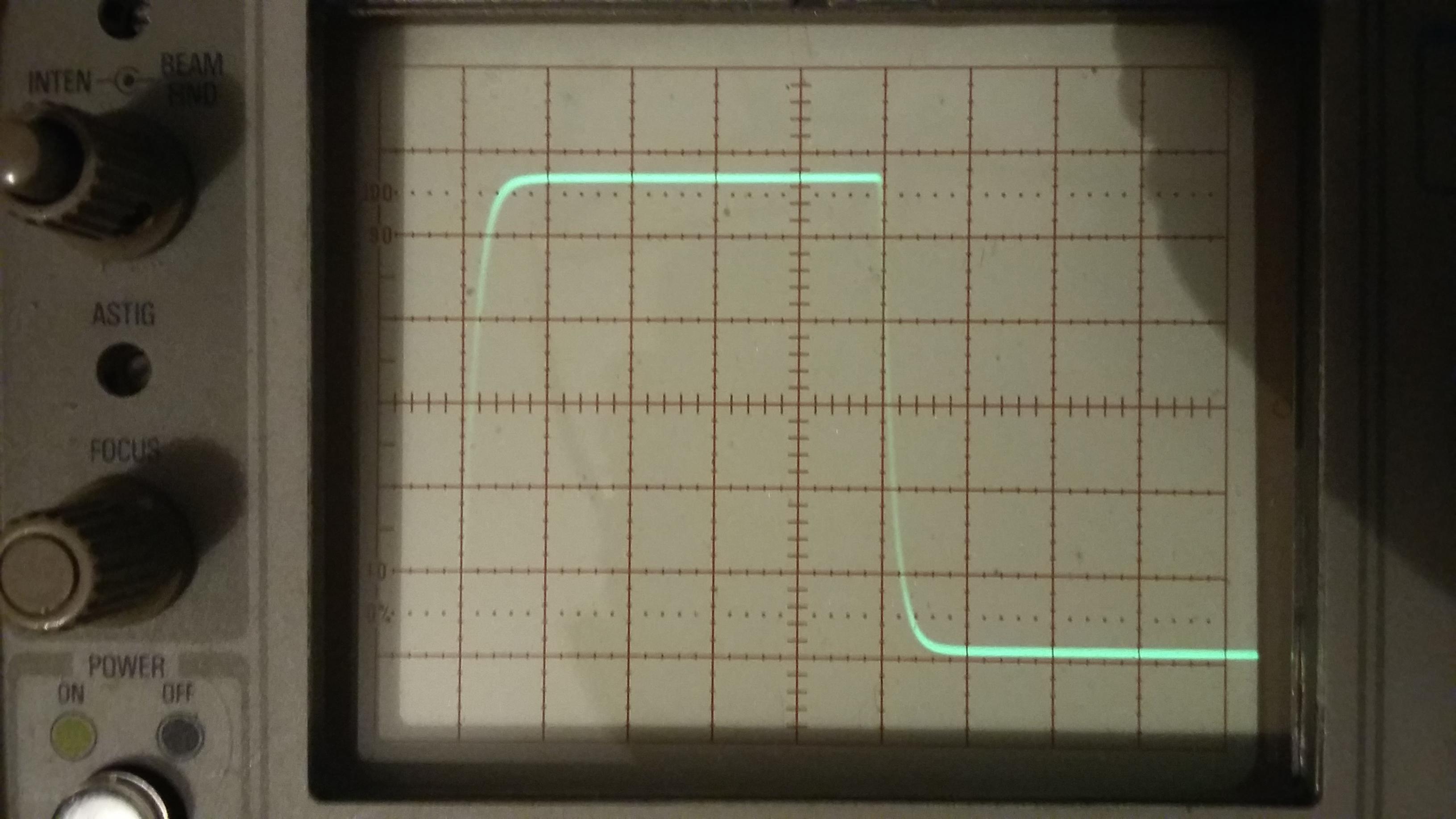

Oh, and it is a chip which do oscillate in the direct replacement. Slightly, but still. Had to change a bit the compensation.
Had I started with this replacement in the FE, maybe I would not have ended up here, talking about it..

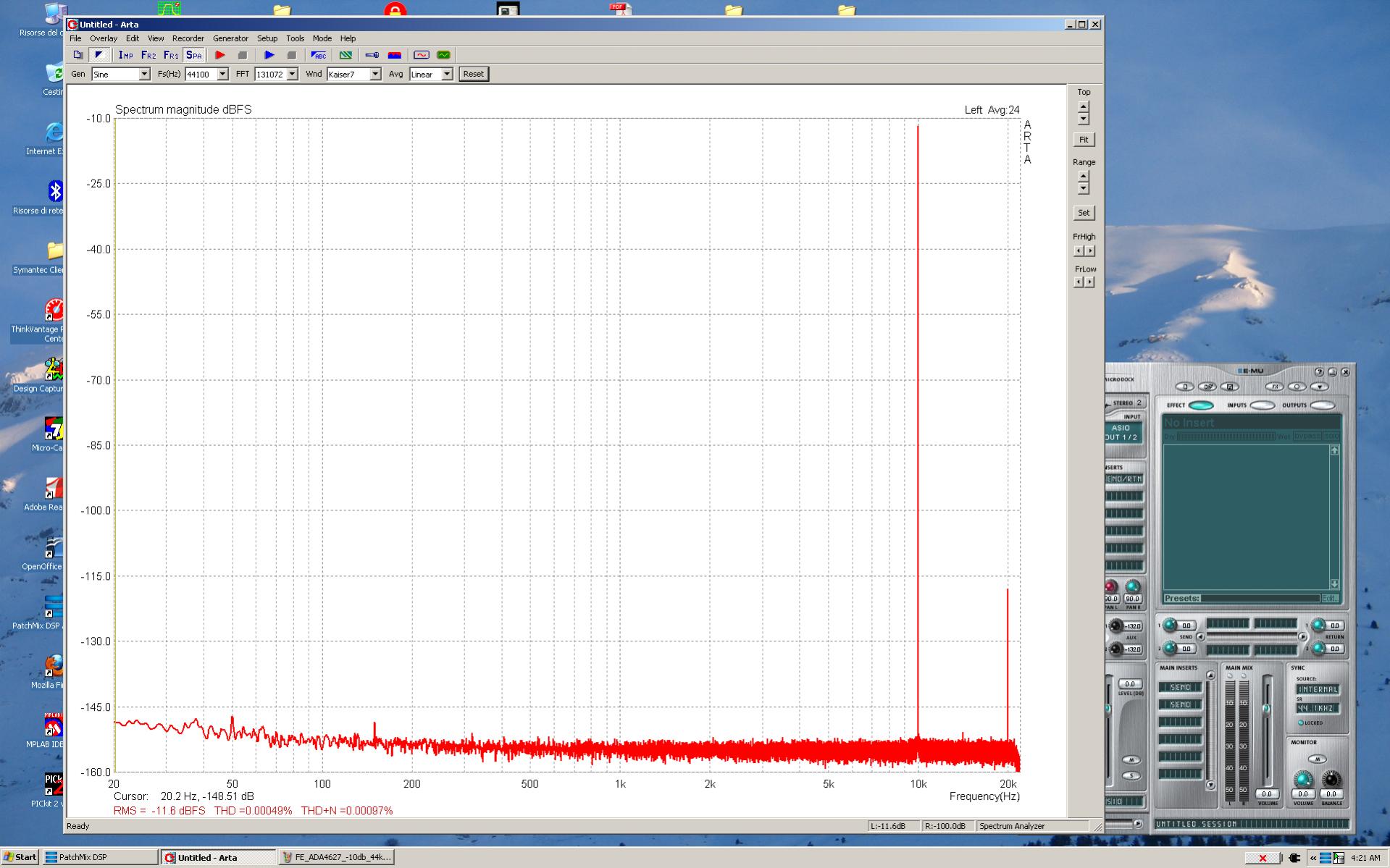

Below it is the square wave response with OPA827, direct;
second shot is after that the comp. cap adjusted (to 100pF)

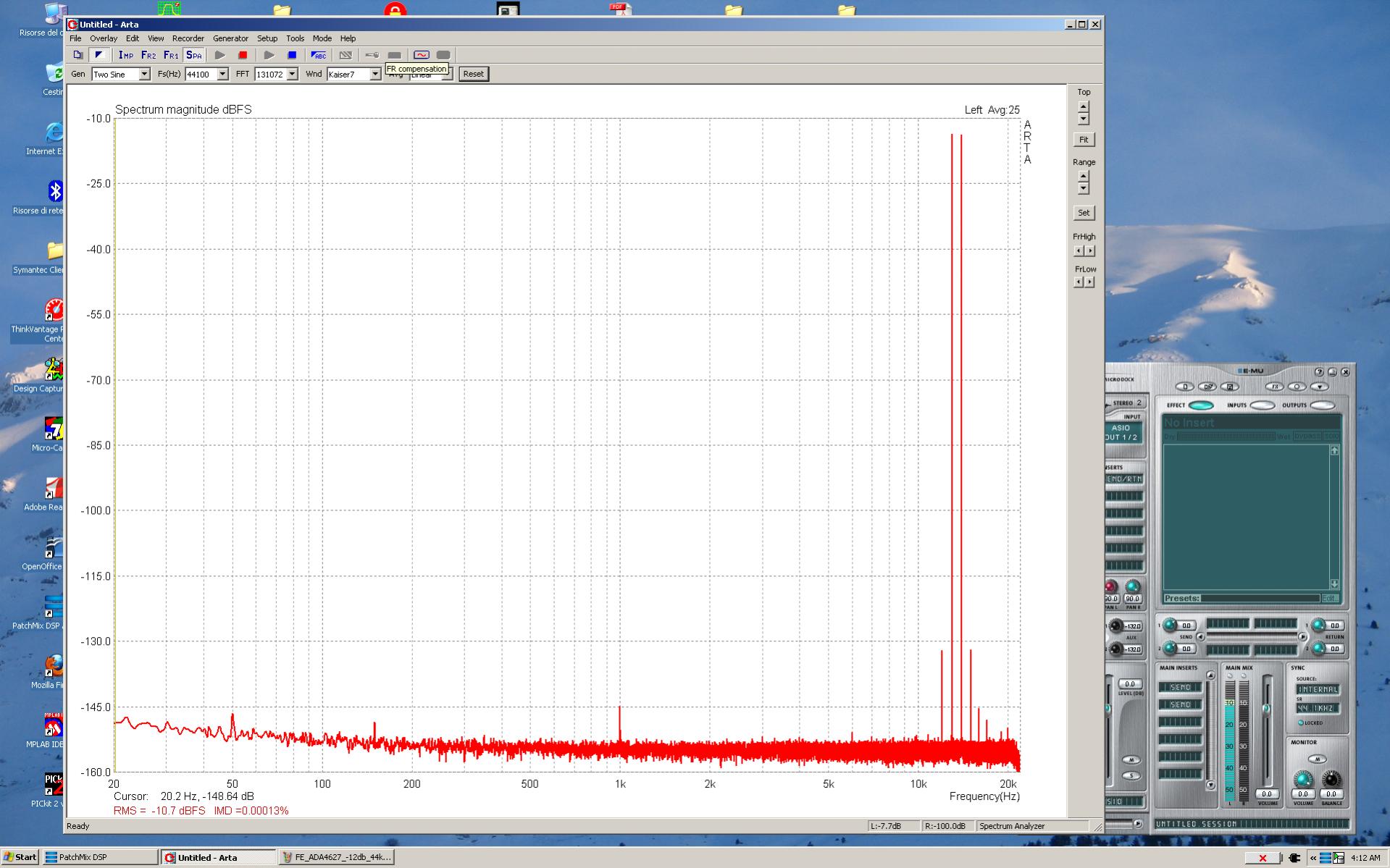

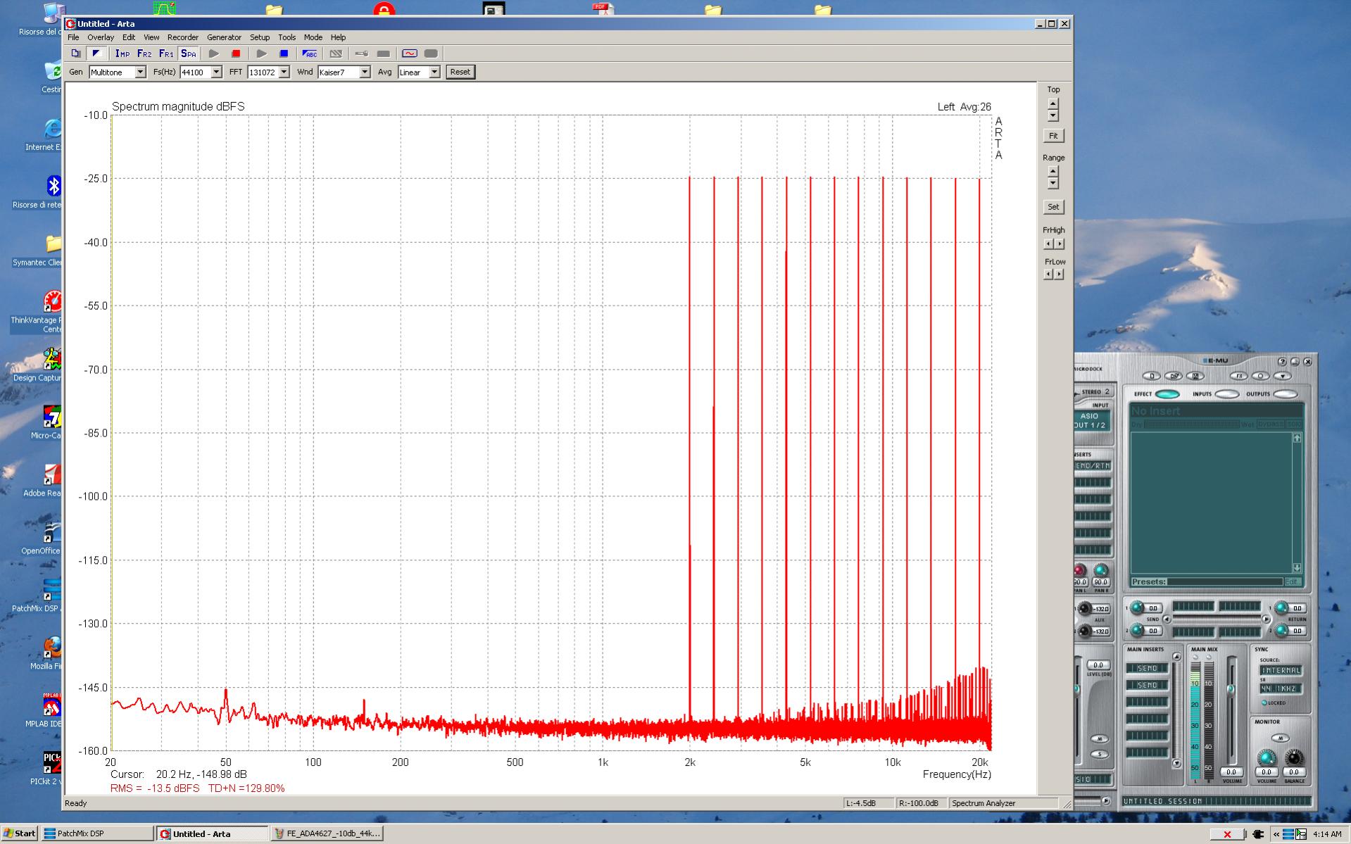

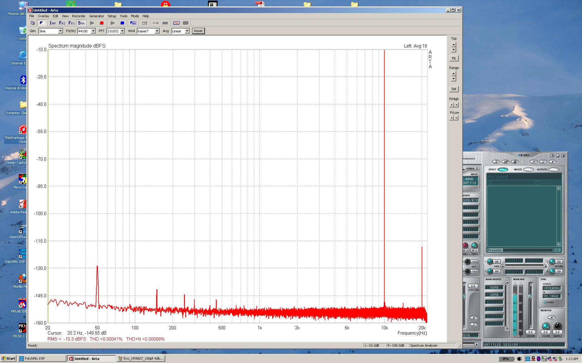

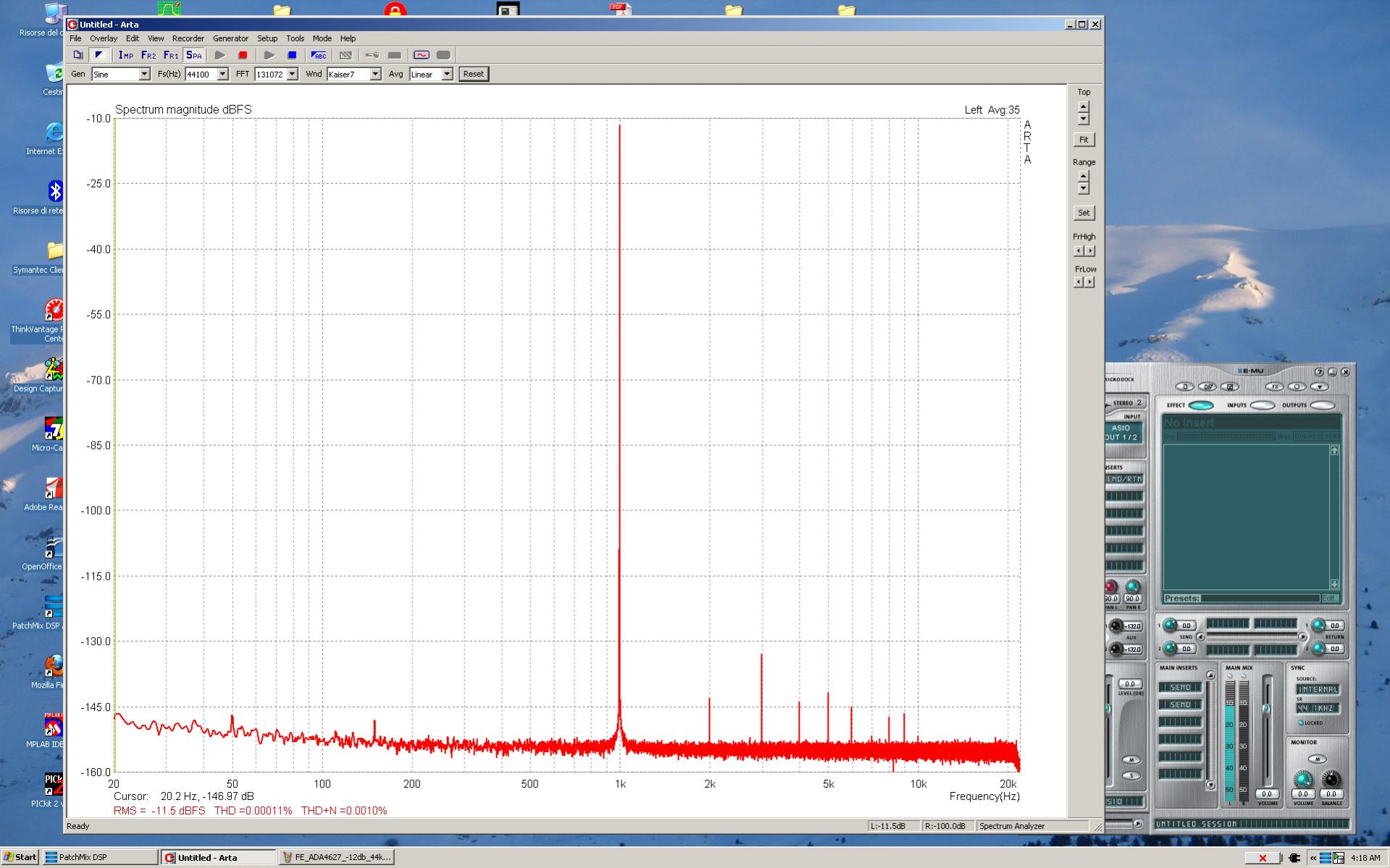

The same with ADA4627 in the FE board: (I did not link these measurements yet)
FE_ADA4627_-10db_44k_5W_1kHz_kulstap_10mF_28_jul_massa.jpg262.1 KB · Views: 111
FE_ADA4627_-10db_44k_5W_10kHz_kulstap_10mF_28_jul_massa.jpg262.6 KB · Views: 108
FE_ADA4627_-12db_44k_5W_high_multitone_kulsotap_10mF_26_jul_massa.jpg286.5 KB · Views: 109
FE_ADA4627_-10db_44k_5W_13-14kHz_IMD_kulstap_10mF_28_jul_massa.jpg266.3 KB · Views: 109
sure. But, with the chips we are talking about, the amp is stable and works well also without them (that is, they can be omitted).I still don't get it... With rev.A mod there is still R43 and C34 between pin 8 and output.
Yet again, as already remarked by George, do not try to do the same without the "rev.A" mod!
George,
R43, C34, R39 and C10 are all omitted when using ADA4627 on FE board?
