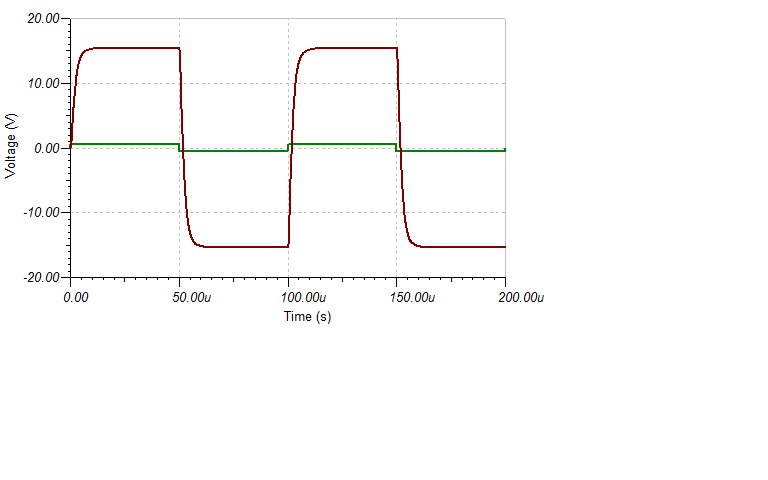

Now I took a deep breath, took out my older version of the FE panel, a generator, scope, and a bench power supply with current limits applicable..
Ripped out the LM318 and replaced an OPA140 for it.
The first is the simulation result, for a 10kHz 30Vpp output signal.

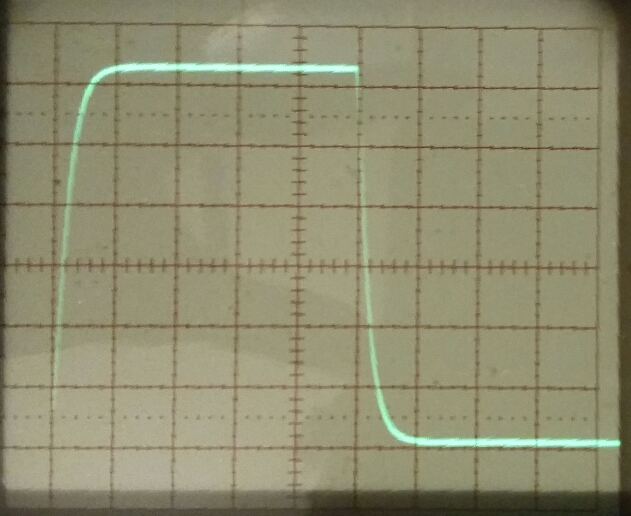

The real setup is driven in a pulsed mode, a half cycle 50ussec wide pulse, (so as to avoid stress in the bench test setup), ~13V amplitude.

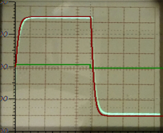

The last shot is the fit of the simulation graph over the screenshot from the scope.
As it is visible, it gives quite a nice fit. The small deviation visible is real: the circuit was calculated with 140pF feedback compensation cap, the real cicuit is 150pF. So the simulation is able to return a very close-to-reality result in phase margin and stability.

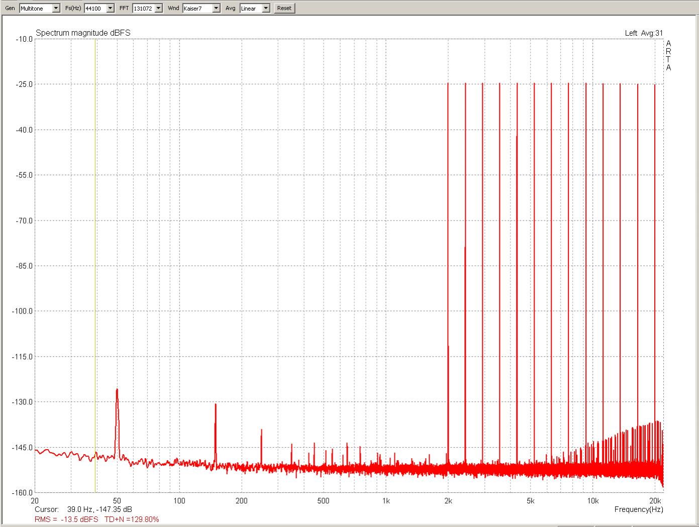

OK, but how does it change the distortion figures? Does it change at all?
Below is a comparison done with a multitone test signal, between the original FE circuit with LM318 and the very same with ADA4627 in place.
Again, Evo related Rev A compensation applied!
The noise floor is changed -- the effect of ~no input bias current & and current noise with a FET input opamp. And watch the high frequency intermodulation components..
