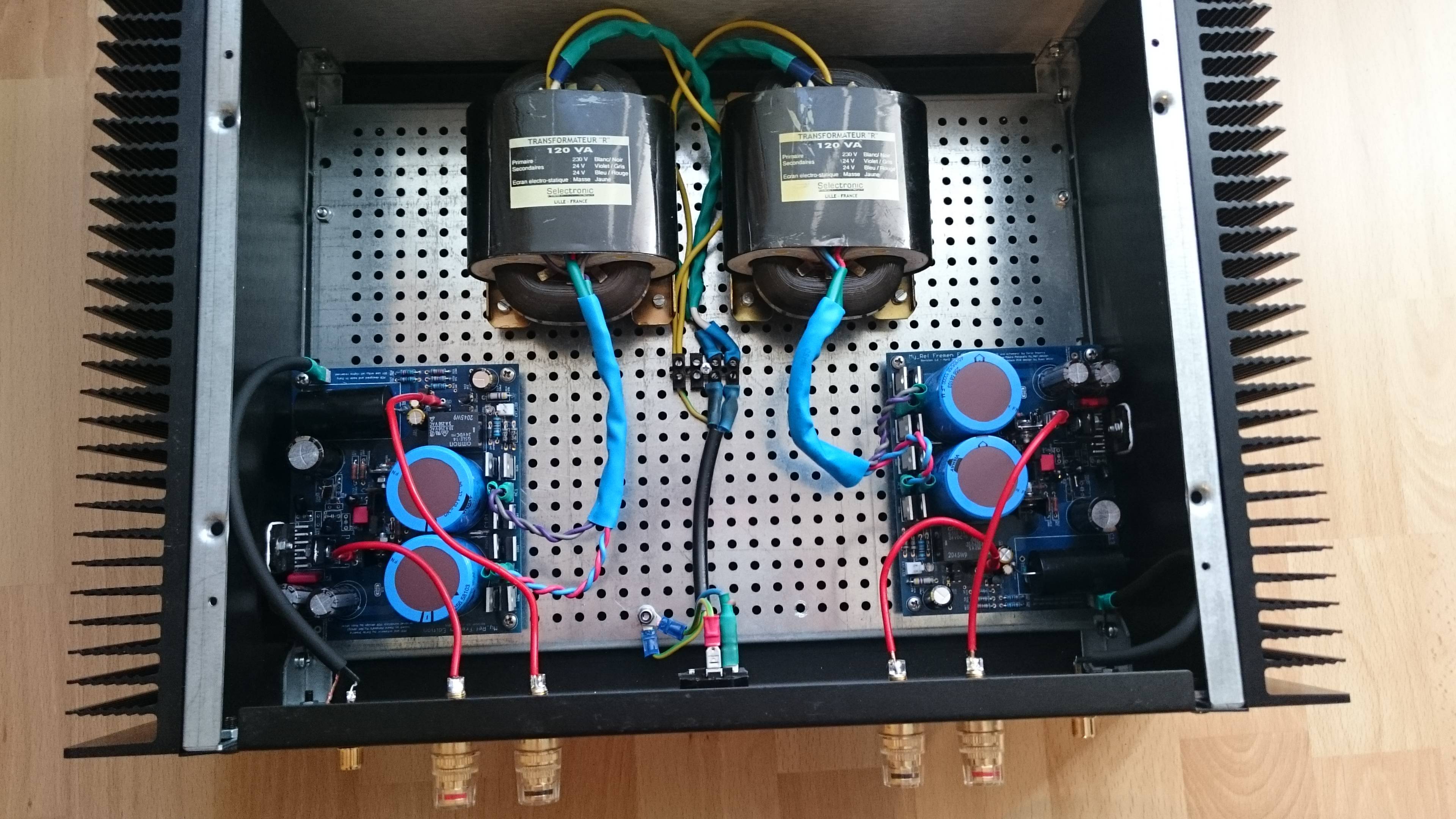

pic of my finished build 🙂
It was quite a ride for me because this was pretty much my first time building something like this. Especially the SMD was quite a learning experience, but after getting used to it, it was a lot of fun. I used cerafines, amtrans and mcap supreme. Only R10 with a Z-foil (error in ordering). I am thinking about replacing R12, but not sure because I am very happy with the sound already. Hard to imagine what else could improve.

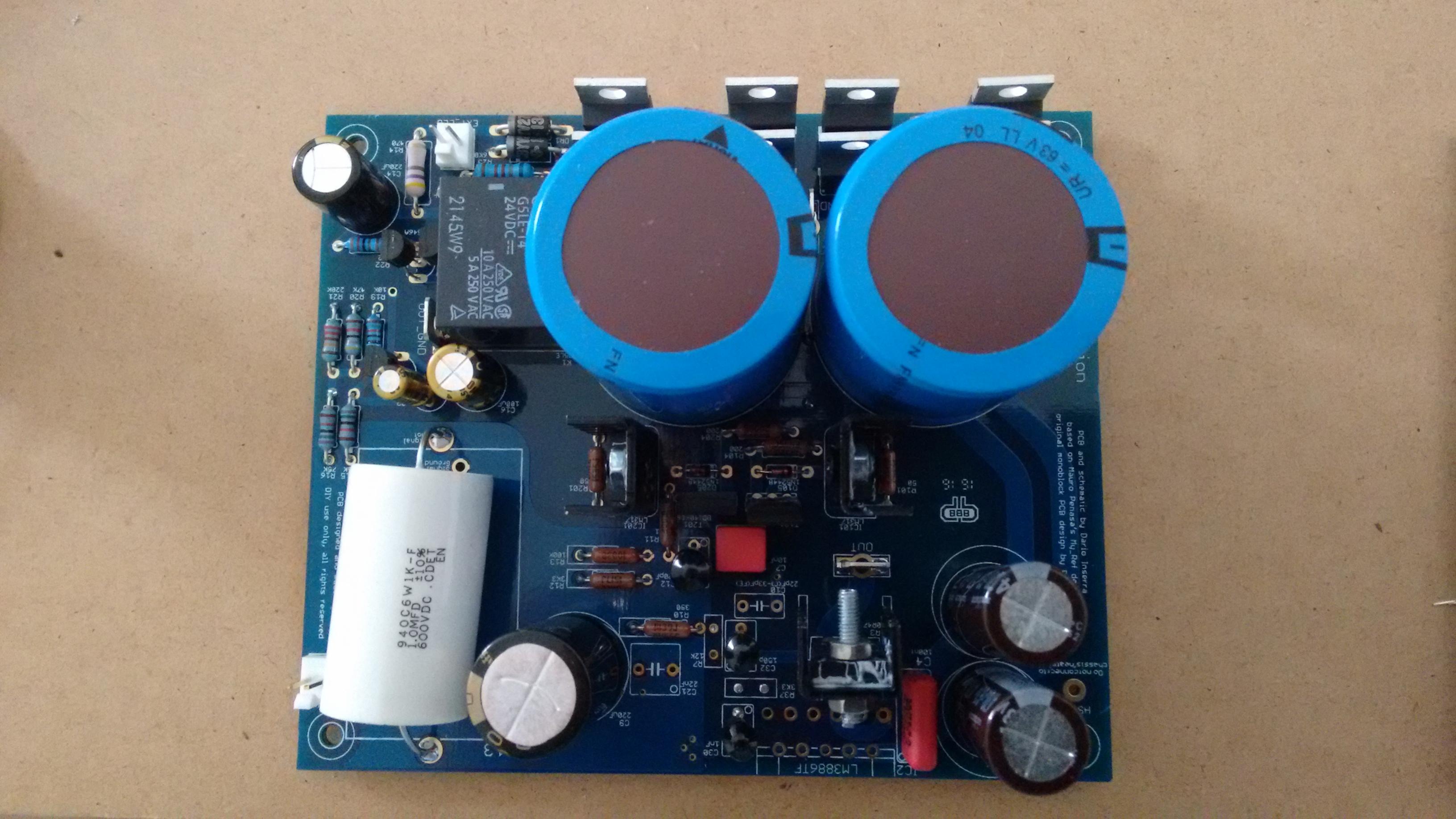

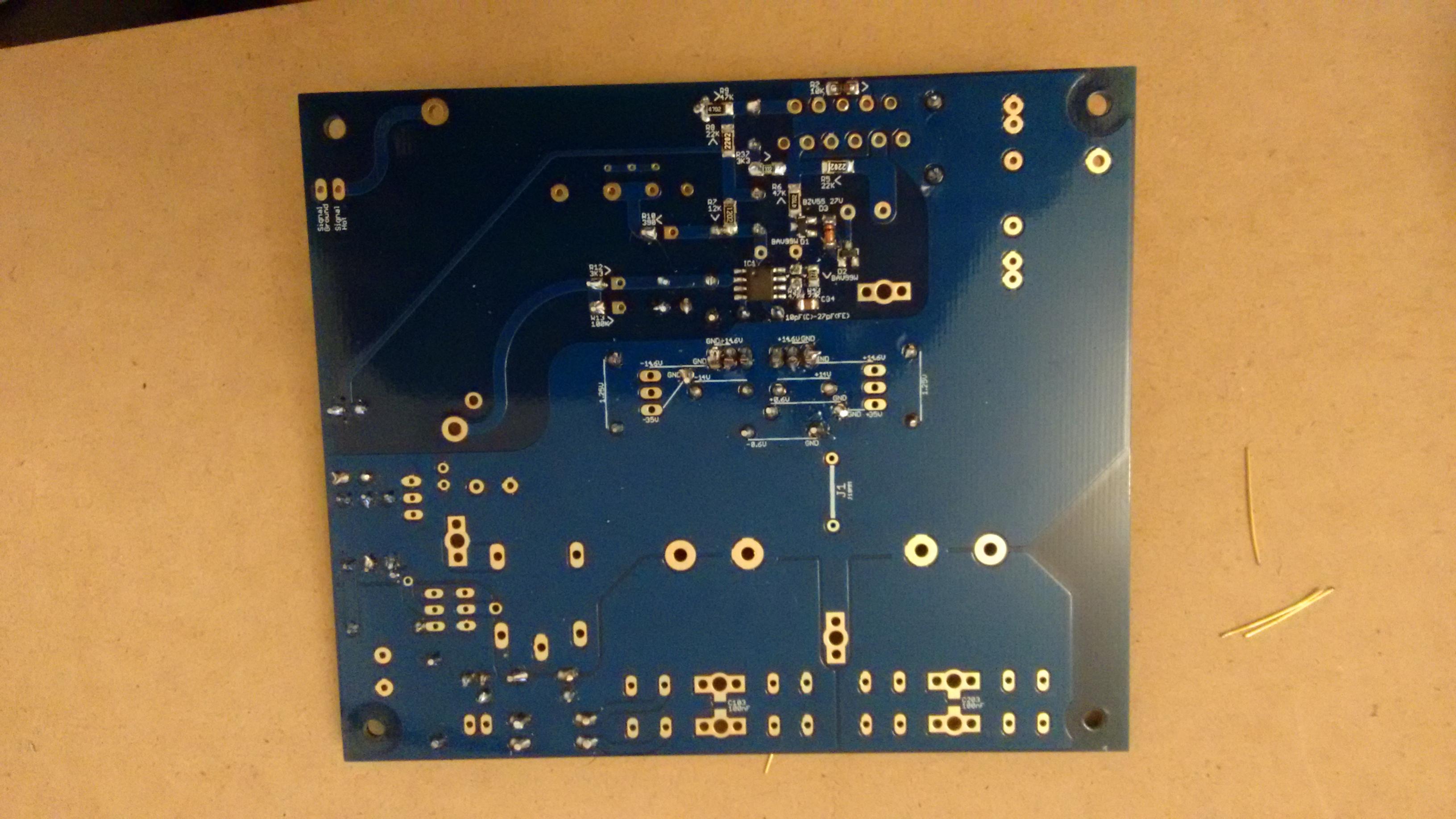

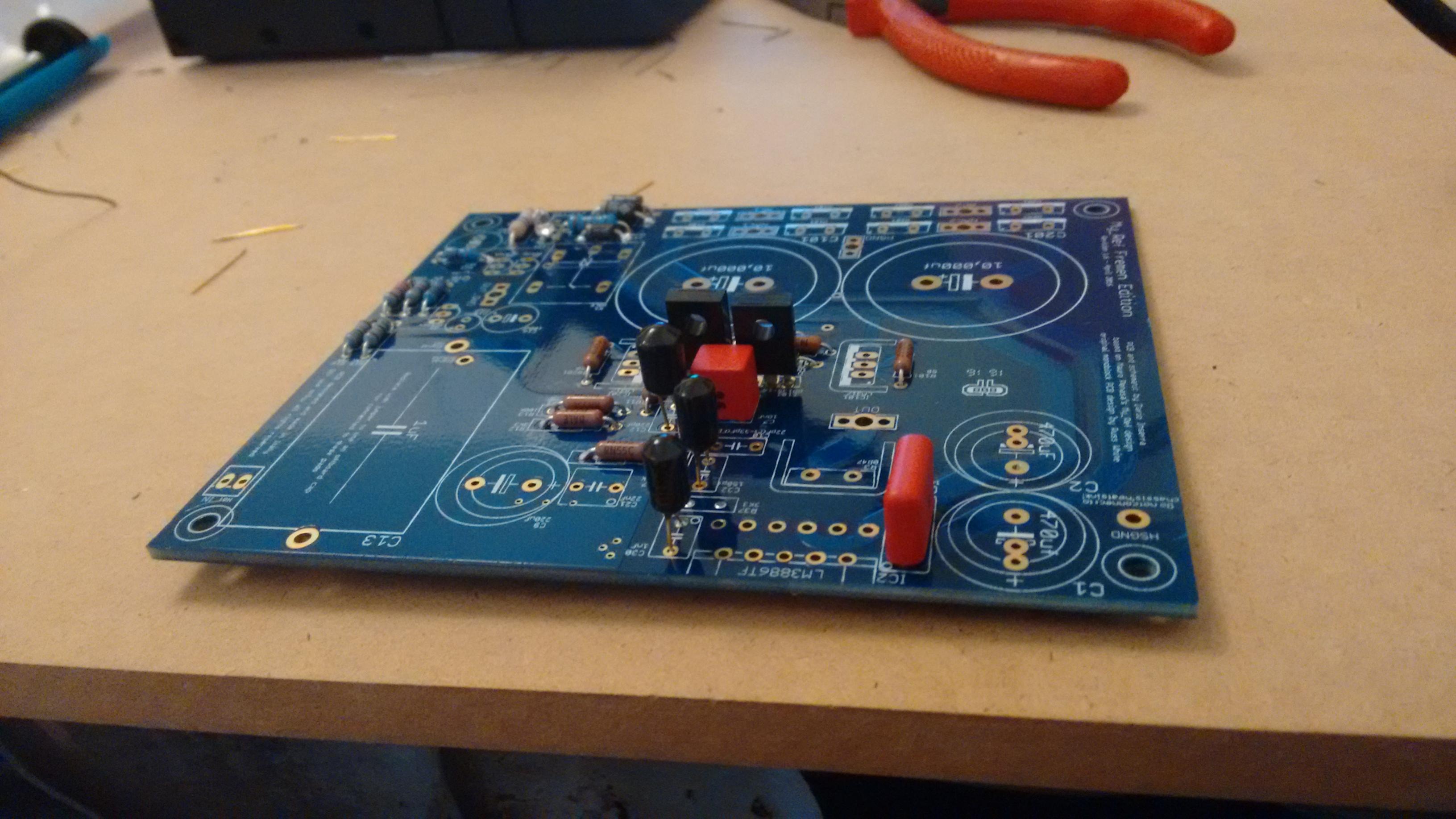

I finished to solder all components... now I have to cable and run...
In attach some images.
Looks good 🙂
Remember to solder LM3886s before powering up...

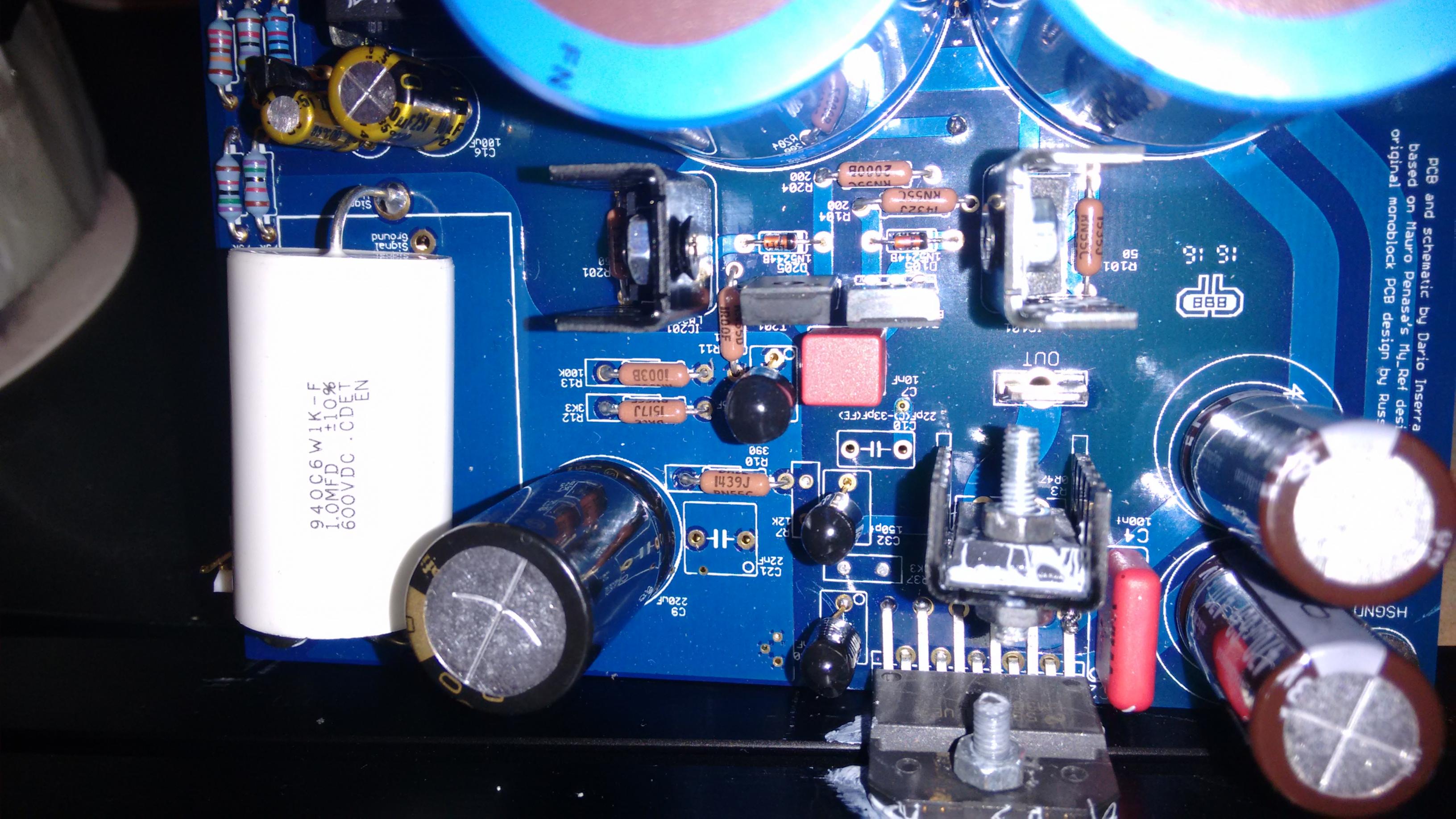

Problem with one channel
Hi all
this evening I try to do some test on my new build with wave generator and oscilloscope.
One channel seems ok. Put 200mV at 1KHz and obtain 2V. There is a lot of noise but problably depends on connection...
The second channel doesn't work. If I put some wave in input I have a distorted output and often the led goes off. Probably he go in protection mode.
I welded both channel in parallel...
Can you help me?

It seems that there is a signal to high frequency with gigh voltage (more that 2V) at input of lm3886 (pin 10).
I'm not able to understand where this signal is genearted because when I put the probe on one pin (R12, C34, lm3886 pin 10) protection go on.

Post some good quality pictures, please.
Let's see if there's something wrong.
Did you clean boards?
Did you take the indicated measures?

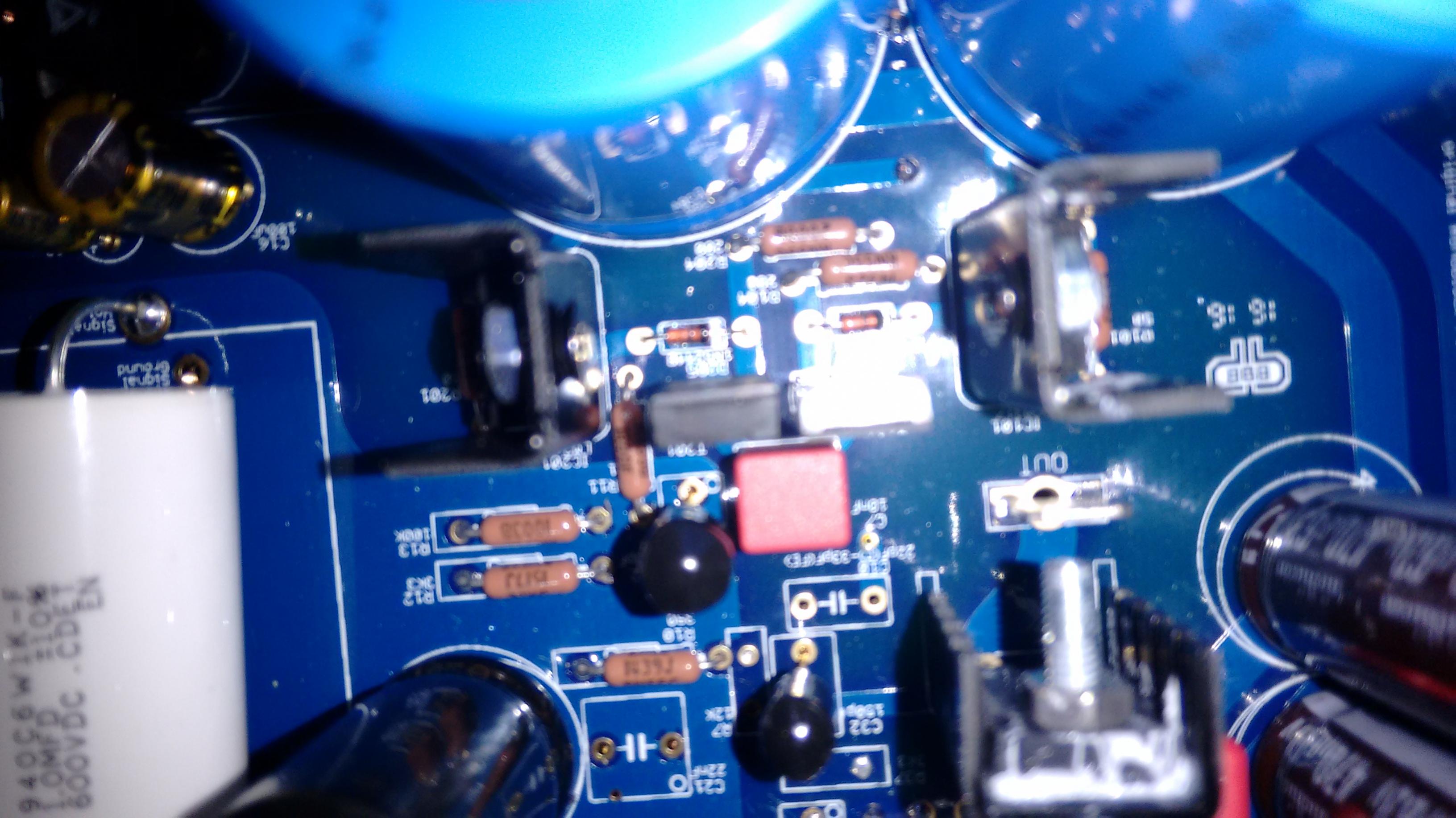

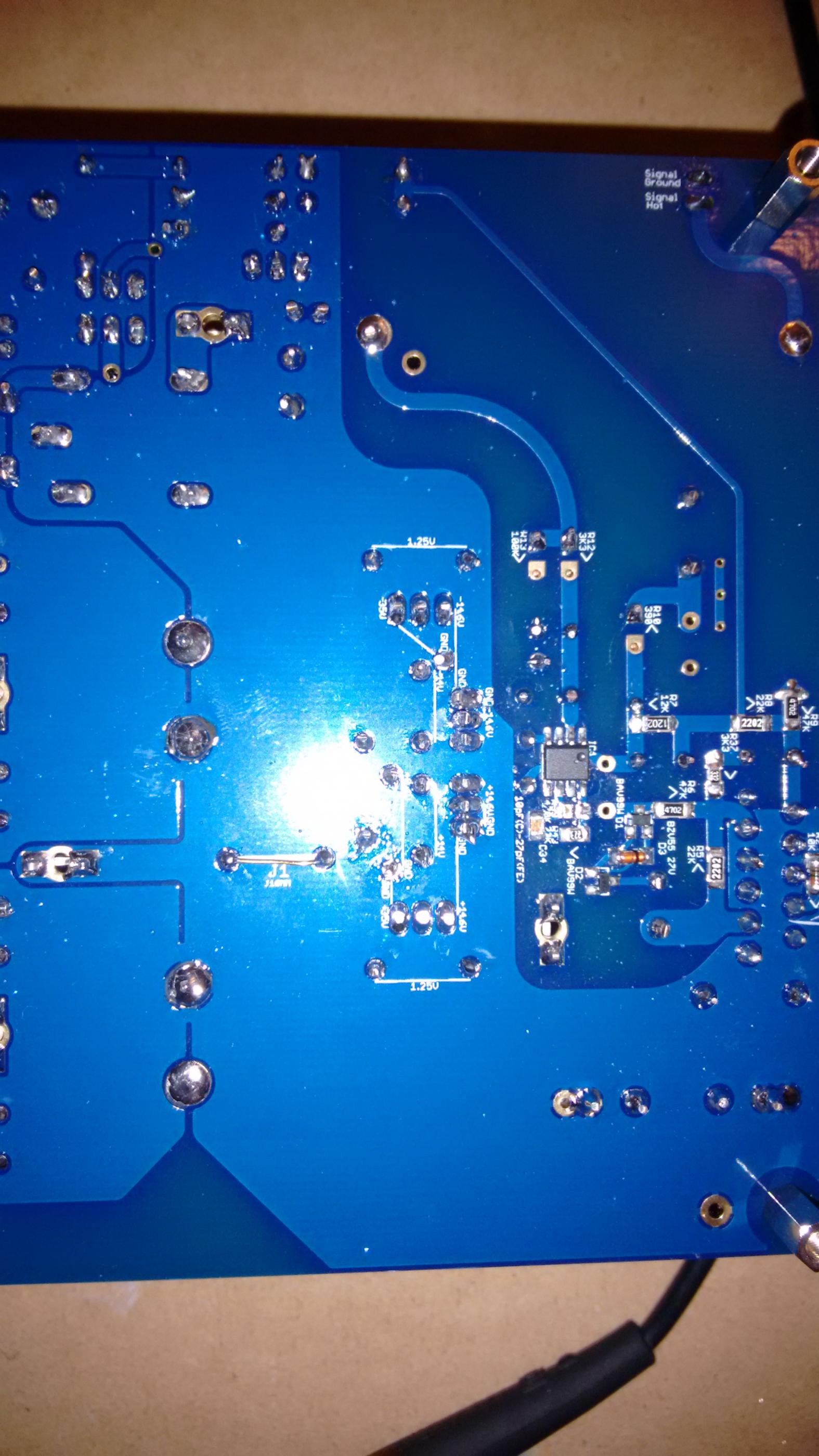

In attach photo. Let me know if it is enough...
OK
probably I found the problem I have inverted db139 and bd 140...
I'm happy that you found the problem. 🙂
Replace also both zeners and it's not a bad idea to replace also the LM317s.
LM318 and LM3886 should not be affected.

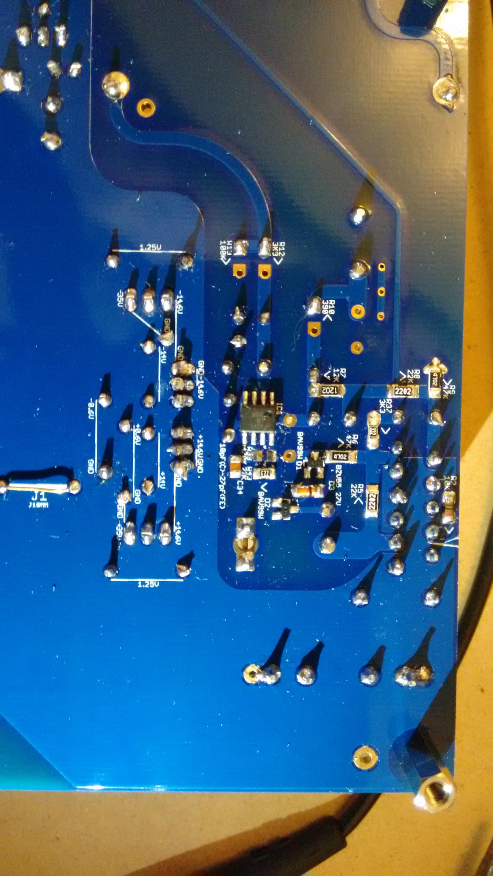

My build will stop again, I'm being in Milan and Turin till next Wednesday. I managed to solder Amtrans on one side - too late for asking, but if C32 goes reversed, printed side of Amtrans' goes on same side, right? Wish I'd have taken a picture...
My soldering struggle is still on, seems my iron suffers working at high temperature and sometimes it "misses it", while the wire I'm using needs it really. Hope I haven't burnt the Amtrans...!
