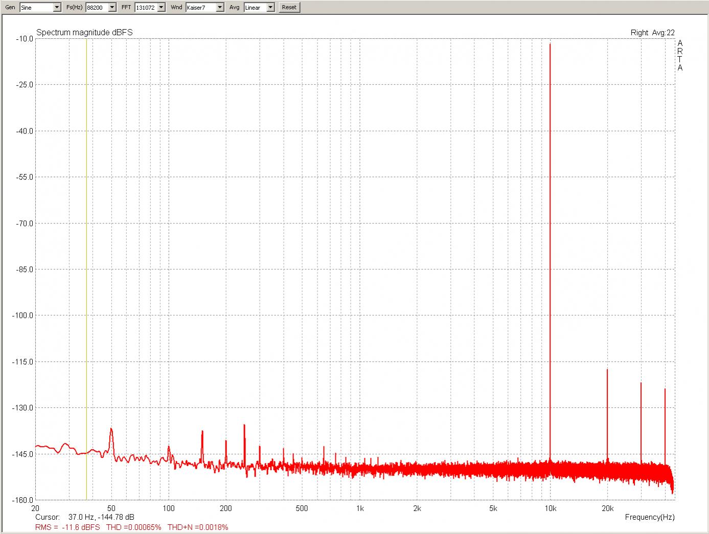

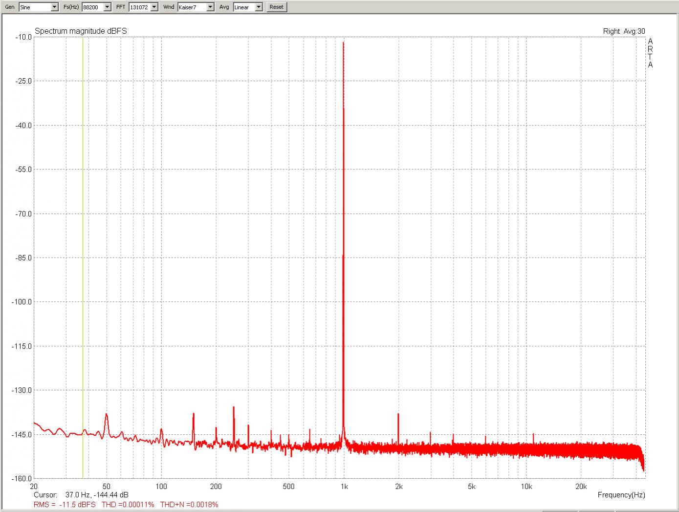

Hi everybody,
Finally I have finished the FE V7 board assembly (Thanks again Dario for the complete service 🙂 )
I have made tests on the board, and the results are very nice and clean. This version of the FE board measures very close to what I had seen testing my original Penasa Myref-Evolution units.
Bravo, Dario!
In the pics there is the output at 5W, at 1kHz and 10kHz.
In the PDF there a lot more additional tests.
Enjoy

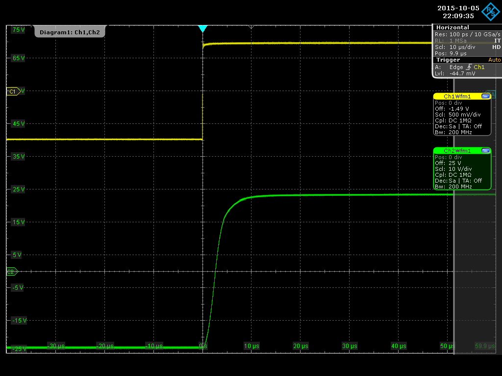

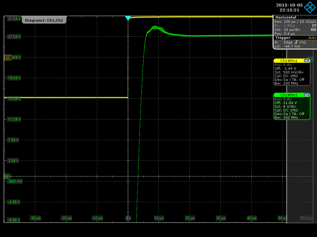

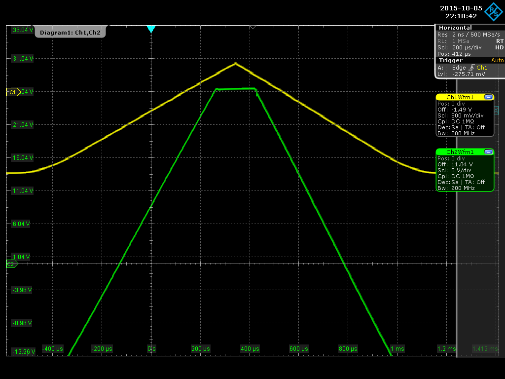

Additionally, here are some time domain tests, showing square wave response on 6.8ohm load, -yellow trace always the generator, -green is output
-1. 1kHz square at close but below to 50Vp-p output
-2. close-in zoom of the same
-3. clipping at 27V peak, 54Vp-p
-4. showing the behaviour when getting out of clipping, almost zero sticking, as visible
To note that during these tests the dissipated power was such that at a certain point my poor test resistor had just dis-soldered itself with a soft plop sound..
(I used to just hang it in the air below the setup)
Ciao, George

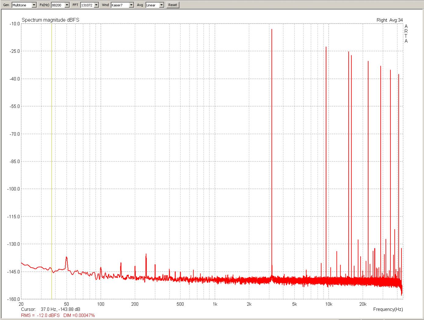

For fun, this is the Dynamic InterModulation test waveform, the one which the amplifier had managed to follow (at 5W output power) with
DIM=0.00047% fidelity
(3,18kHz square + 15kHz pure sine, 4:1 ratio)

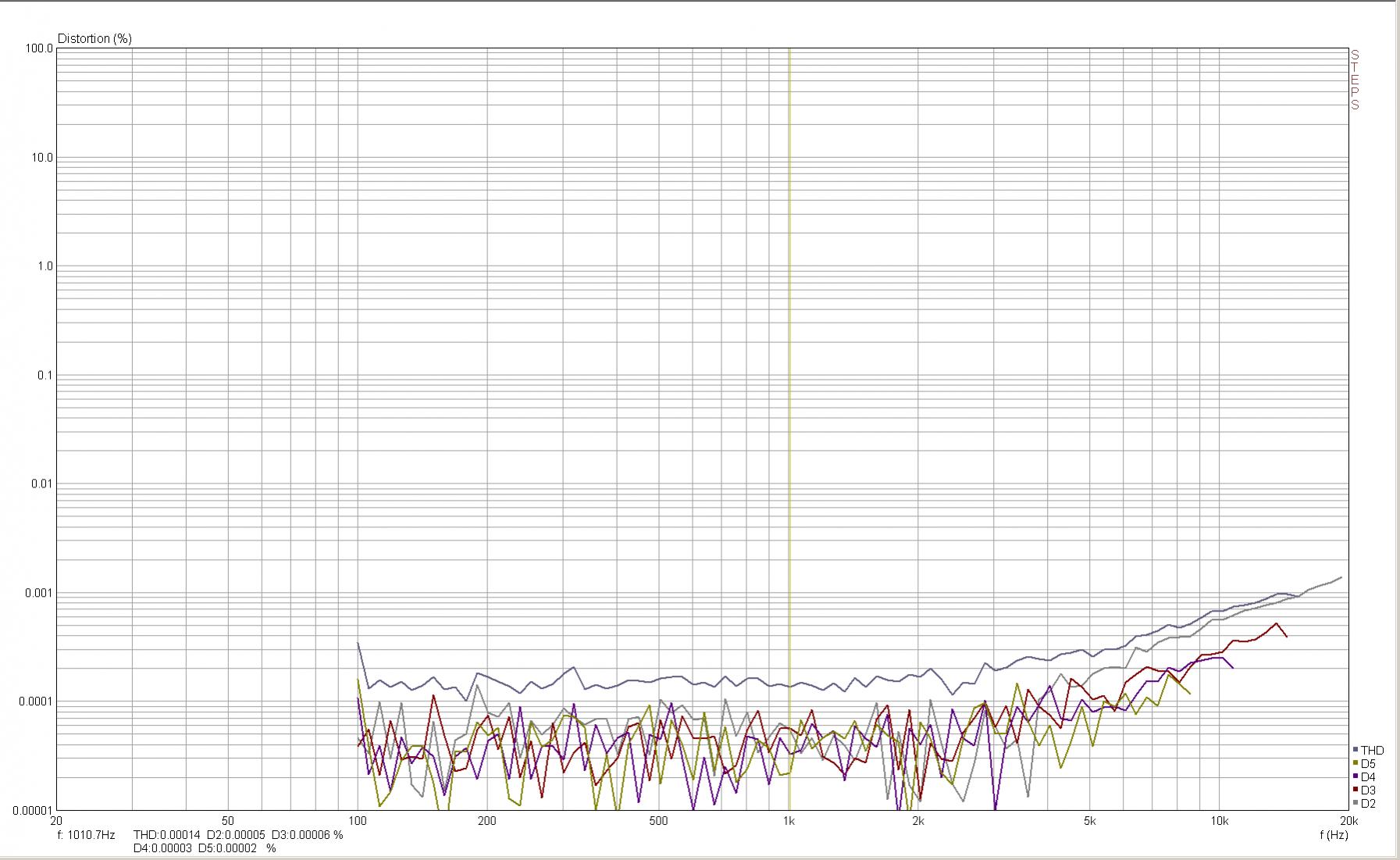

Another 'quote' from the pdf measurement file above:
The distortion vs. frequency sweep.
Measurement setup / sound card bottom line is flat around THD=0.00015%, ~up to 20kHz.
As visible, the amplifier distortion at low frequencies is dissolving in the measurement background, but at 10kHz it is very cearly standing out.

First of all, Pardon me, Jac, obviously I meant to answer to You!!
Then, the slew rate: let's have a better look at slide 2 in post #2304 :
(the zoomed in ~full swing output)
It is visible that the signal swings from -~20V to +15V in about 3 useconds; (this is the slew-limited fast part)
That is 35V swing/3useconds = 11.6V/useconds. ~~, to be precise.. 🙂
