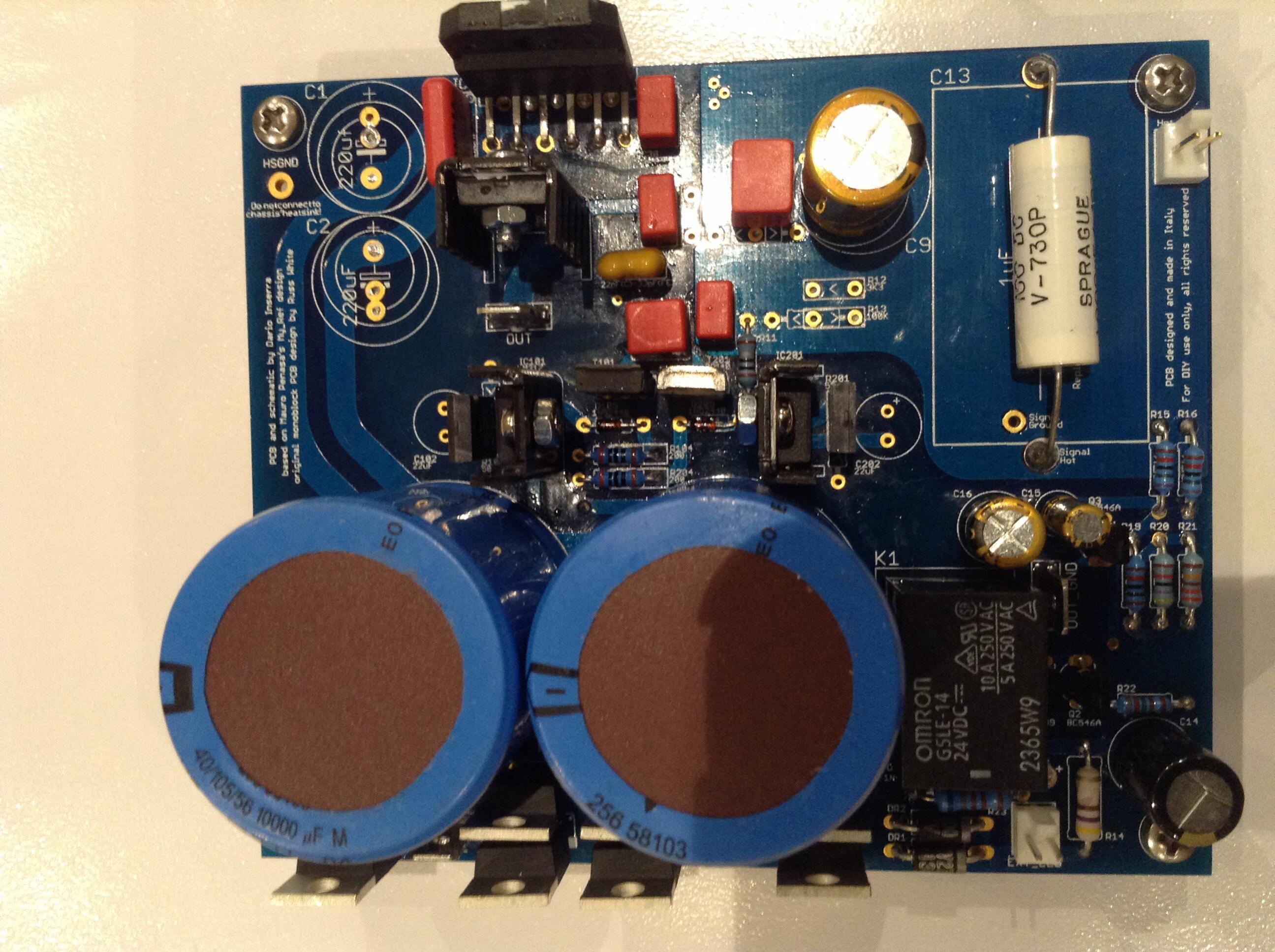

At long last I got round to stuffing the boards, cleaned them up and checked for any obvious errors and shorts. All looked ok and time to power up using a light bulb tester to measure the dc offsets.
The first board powered up ok. The open circuit dc offset was initially 23mV falling to 10mV after a while. Similarly, with the input shorted, the dc offset was initially 16mV and fell to 6mV.
Powered up the second board and measured the open circuit dc offset at 10mV straight away and was happy with that. Left the board powered up whilst I was doing something else and was sure the bulb was getting brighter so powered off and checked to see if anything was getting hot and did another visual check. All seemed ok so I powered up again but stuck on a power meter so I could be sure I wasn't imagining the bulb was getting brighter.
Again, all seemed ok - dc offset was 10mV and I had a power reading of 10W. I didn't know what power reading I was going to get but the bulb was dim and it was steady. After a minute or so the power reading went up - 11W, 12W, 13W and then a little pop. It was very quickly obvious the problem was C1 - the top had expand and there was oil covering the surface of most of the board.
I've removed C1 and C2 and as far as I can tell I haven't got any shorts. Any suggestions what I need to check and what to do to fix it?
All help gratefully received. Thanks.
An electrolytic inserted the wrong way around will blow up.
I'm sure that wasn't the case - I paid particular attention to the electrolytics and comparing the two boards side by side the the error would have jumped out.
Is there any value in powering up the board minus C1 and C2 and measuring dc offsets and voltages around the LM317s/BD139/BD140?
I would have suspected a cap reversal like Andrew suggested.
Usually electrolytics do that sort of things when reversed or injured with higher voltage than the specified one...

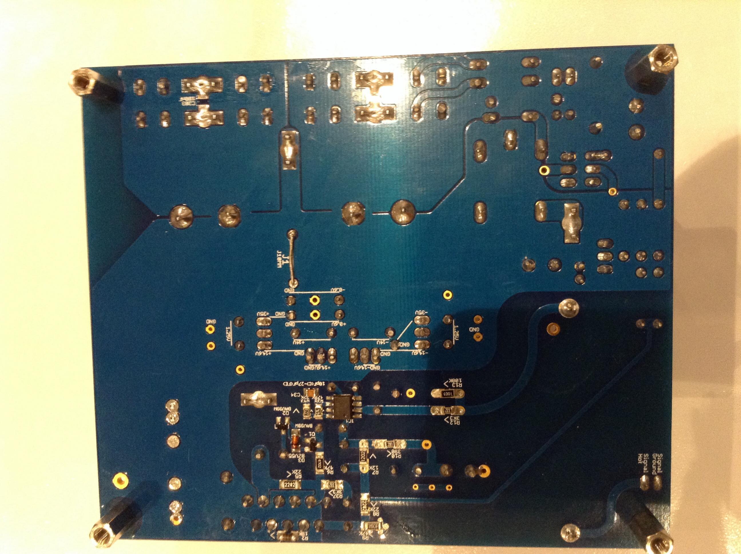

Can you post good quality pics of the troublesome PCB (top and bottom side)?
Mario, is a Panasonic FC in the same package size a worthy substitute? It's got the same electrical spec according to the spec sheet but I realise that might not be the whole story.
It's perfect for troubleshooting and will work perfectly.
But having a single different cap will lead to a different sound signature among channels, at the end of the troubleshooting you should replace it with one identical to the other 3.
Don't mount it yet, though, we should at least try to identify the problem first or it will blow too.
