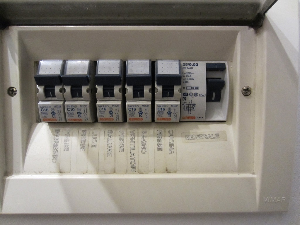

In any case in whole Europe each home has at least two magnethermic switches which cuts off when you reach a certain threshold for each circuit (10A and 16A usually) and at least a residual-current circuit breaker which cuts off when the difference from neutral and safety ground is bigger than 30mA.
This is my switchgear:
With such safety devices it's not so easy to be electrocuted, nevertheless we MUST take maximum care when dealing with AC, protections can fail... or be insufficent.

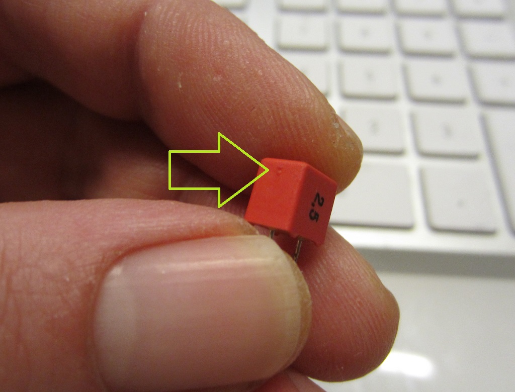

And regarding (non electrolytic) capacitor orientation - the writing on the cap ends at the o ? Did i interpret that right?
I ordered the fremen fe and decided last minute to order the evo mod instead of the normal bom. So just to verify - C10 and R39 are left unpopulated?
Yes
It's usually so but for Wimas pay attention, some of them have markings on the 'wrong' side.
All Wimas have a small sign, the small ones on one side, the bigger on front/back:
That sign should be on the left side (small) or front (big), otherwise markings are reversed.
The one in the pic is reversed.
