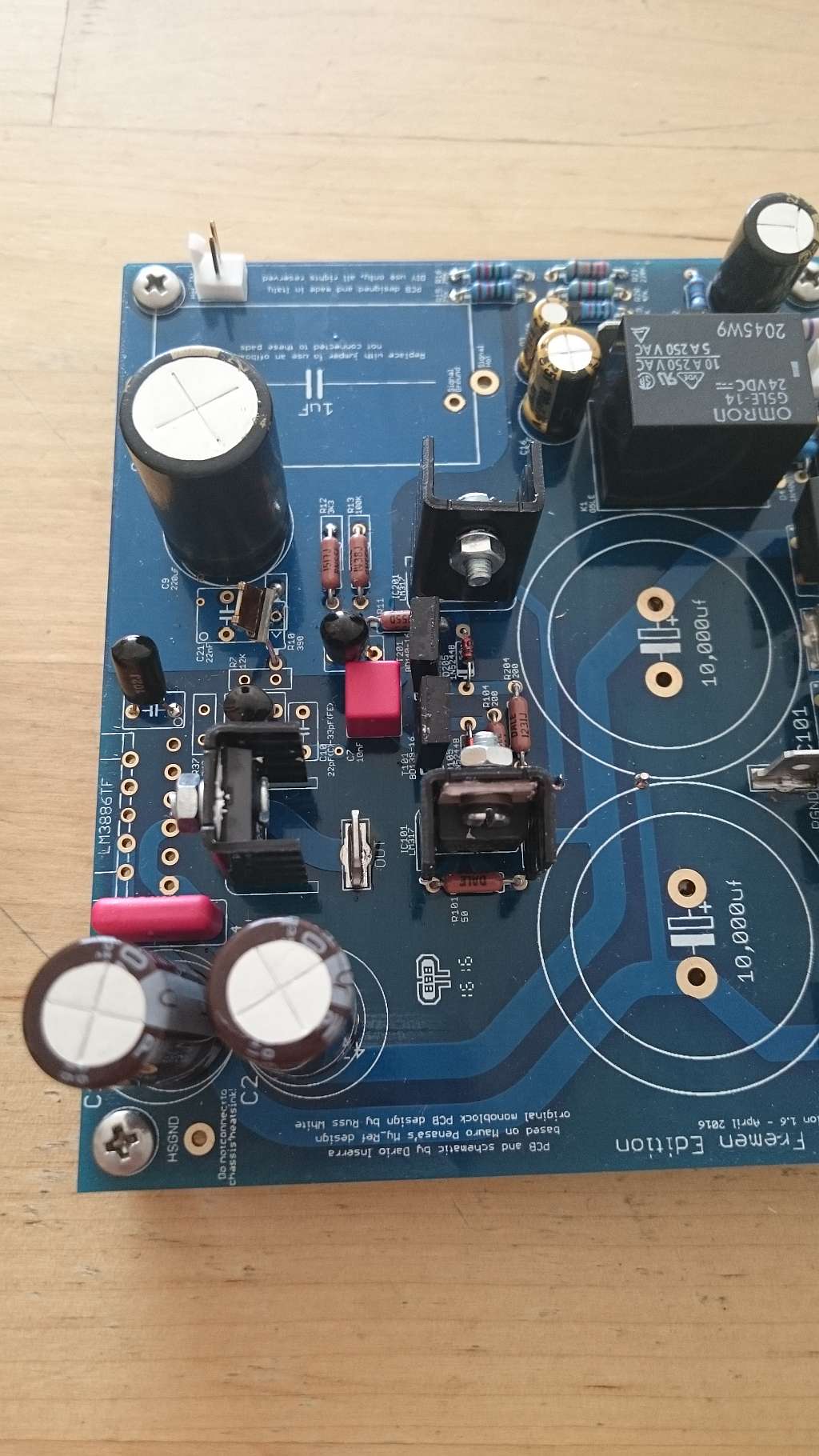

nope, thats what seems strange to me. using an eutetic Sn/Pb/Ag mix.
It's not strange...because those pads are both on a groundplane so an high temperature is actually needed to molt the solder completely.
ok, will try to be patient and wait for the case first *ggg*
As you want but you can do as I wrote, I've had my case 3 years and 3 versions after but soldered LM3886 before that.
tried that already but it seems its not melting on the other side. Didn't dare to apply heat for more than 4-5 seconds at 370° (kinda seems long to me already). Do you think i should try heating longer?
Absolutely... you should try to be quick AFTER solder is molten on both sides of the PCBs... 4/5seconds on those groundplane pads is not enough for sure.
IMHO it's better to raise temperature to 380/390°C and do it quickly than appling 330° for 30 seconds. 😉
Alright, thanks so much for that valuable information. As you can see I don't have a lot of experience. In my last project I never had to apply heat for that long, so I was hesitant... Will try again later 🙂

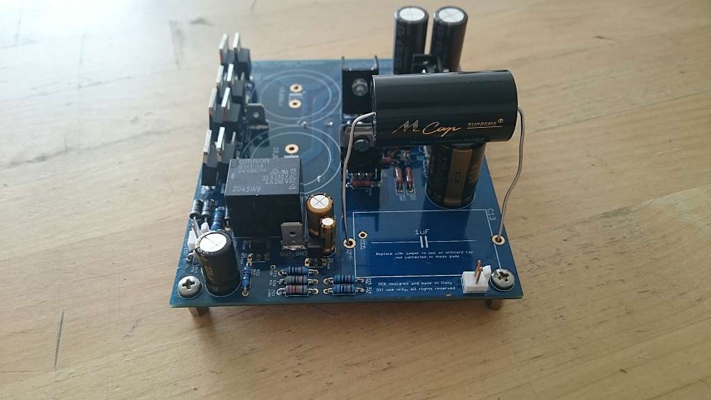

yay, your tips worked perfect 🙂 R11 is fixed. Is the mcacp this way right?
Yes, the the MCAP seems correctly oriented.

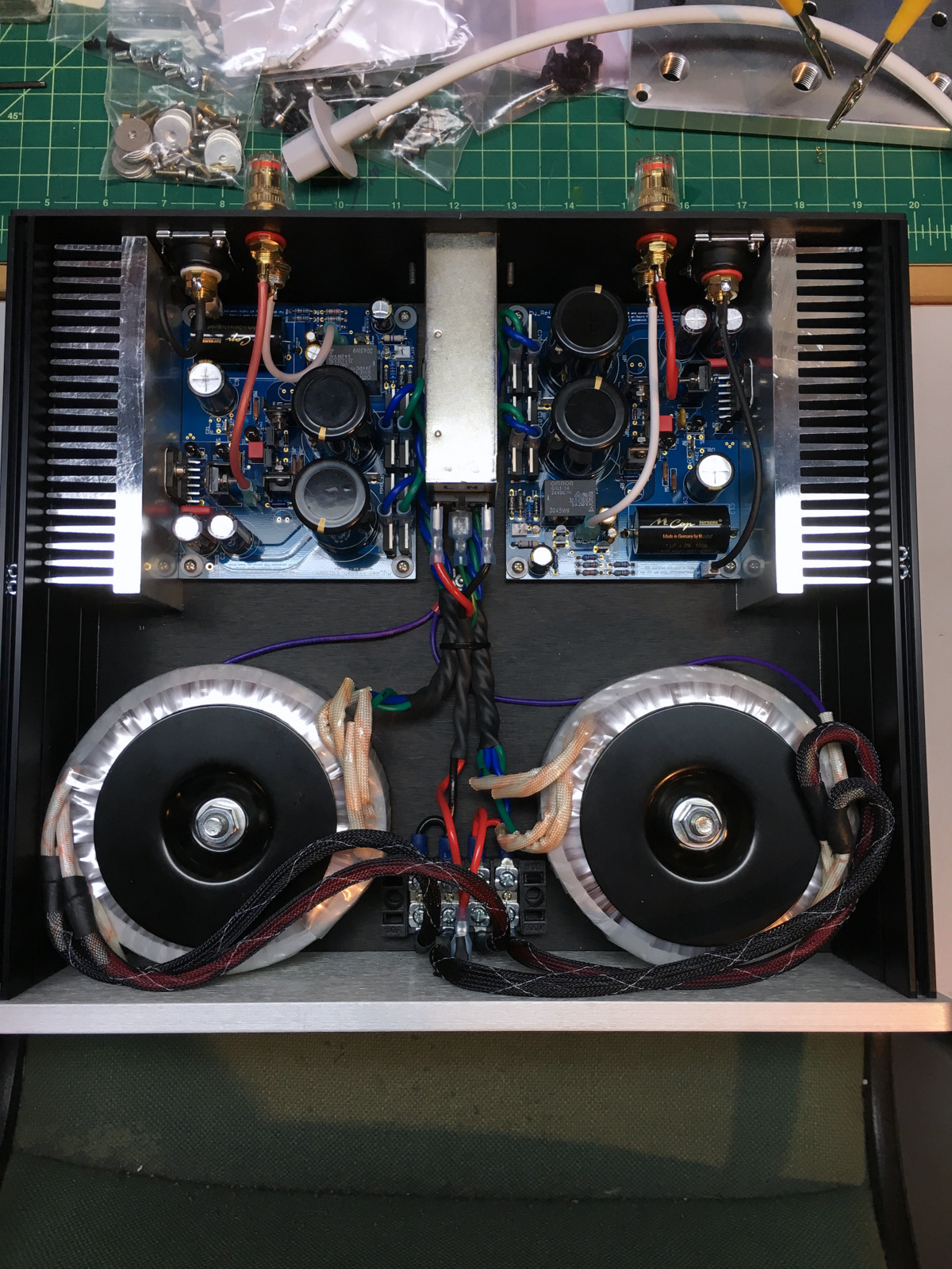

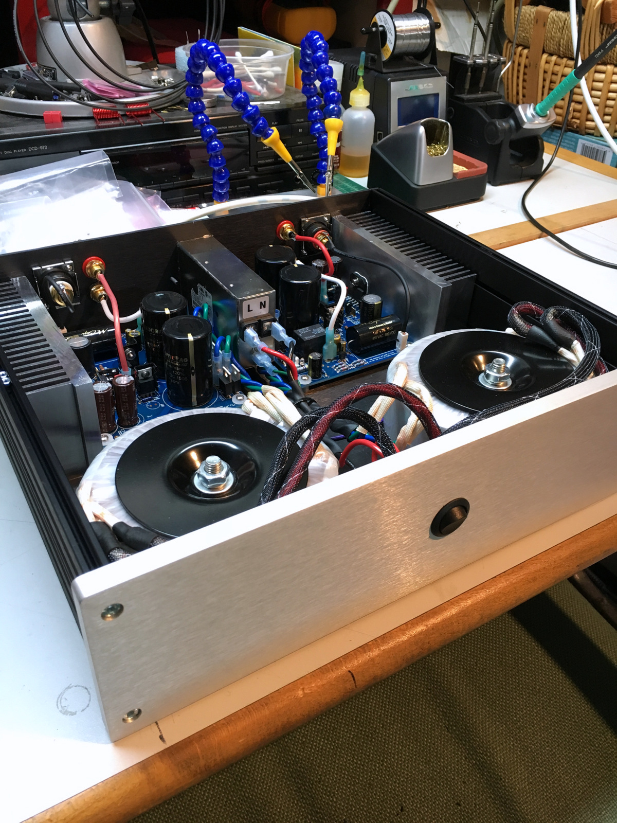

All built up and working great! Sounds wonderful. Lots of gain. Runs cool. DC offset measured at 0.3mV and 2.0mV. I was a little apprehensive about potential hum due to proximity of the 2x 200VA trafos, but all is well and there is NO issue there. Below is my testing setup with 4 (!) recent builds including a Pass M2 Clone. Speakers are diy full range LGK from GR Research. Source is AMB gamma-3 via USB. Will do critical listening after I have some hours on the amp.
Very good, clean and elegant job, BK 😎
Just two notes:
- the sides of your HiFi 2000 case can be used as heatsinks and they're good enough for the FE
- The Nichicon KZ will change a lot with burn-in and it will take forever...

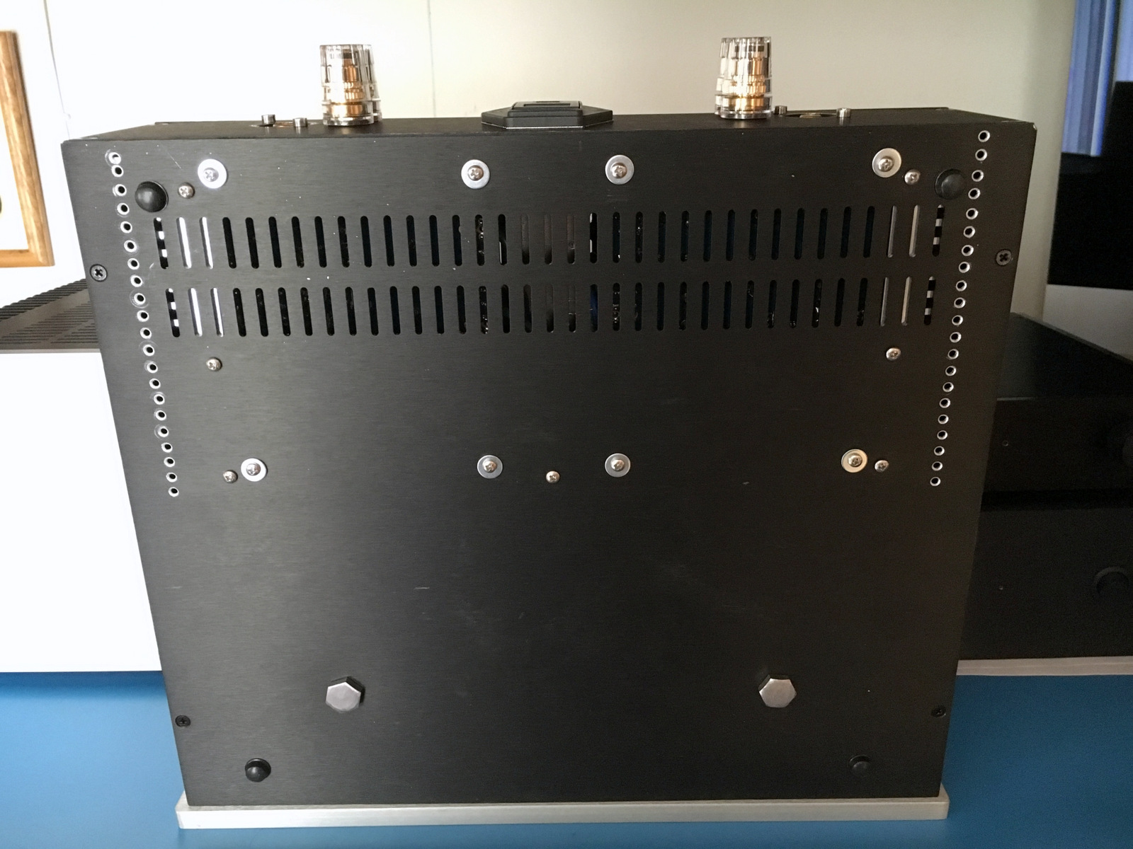

One additional underside pic showing more construction details.
PCB is mounted by the 4x screws with washers. I drilled/tapped the heatsinks and securely screwed them to the case bottom. These are the three screws without washers. I scribed the heatsink pattern on the other side and drilled vent holes between the fins. I know the case walls are sufficient for the chip, but I'm all about the overkill. Heatsinks are the 5.375" profile from HeatsinkUSA and are quite nice/heavy/well made. The large bolts secure the 2x24V 200VA shielded Antek transformers.
The Neutrik RCA connectors are back-mounted after punching holes with a Greenlee 7/8" punch. The IEC is a beefy 5A filter unit from a local surplus place.

Nice work BK, i did wonder why you had the heatsinks mounted inside the case but as my FE's never seem to get very warm i thought it was probably not that important.
Then again you do have a hotter climate than the west coast of Scotland.
