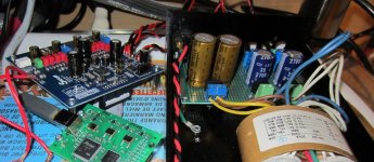

Waiting the tutorial
I'll publish some key pictures and notes for who is building in the next days, since I have yet to start updating the tutorial.

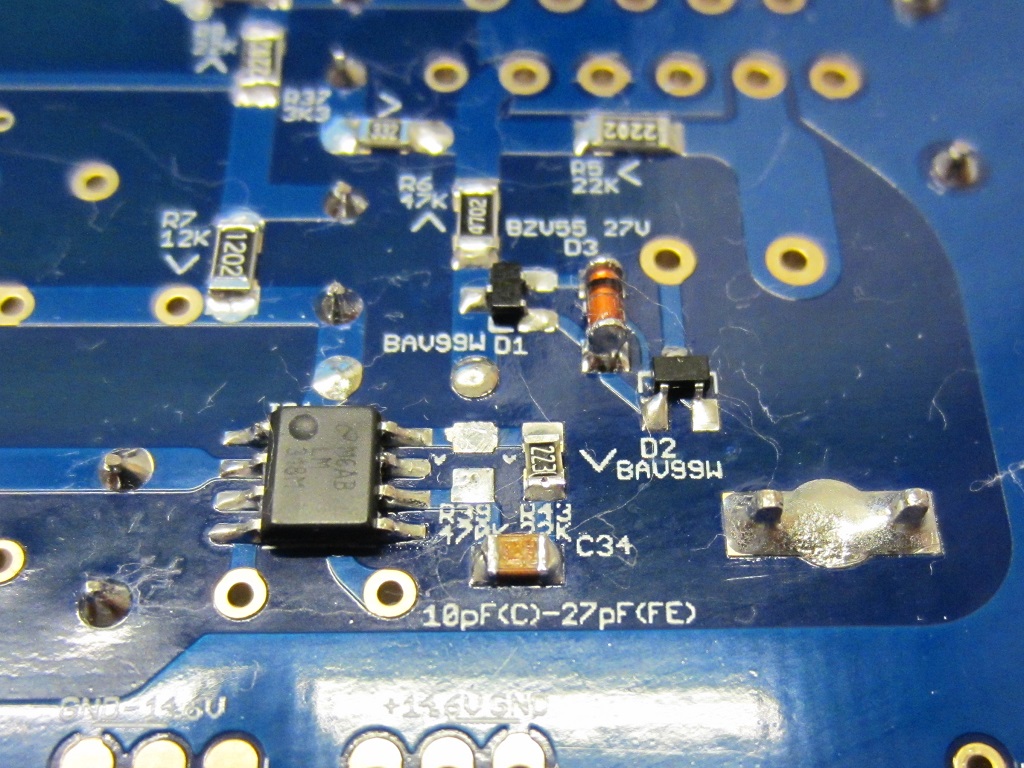

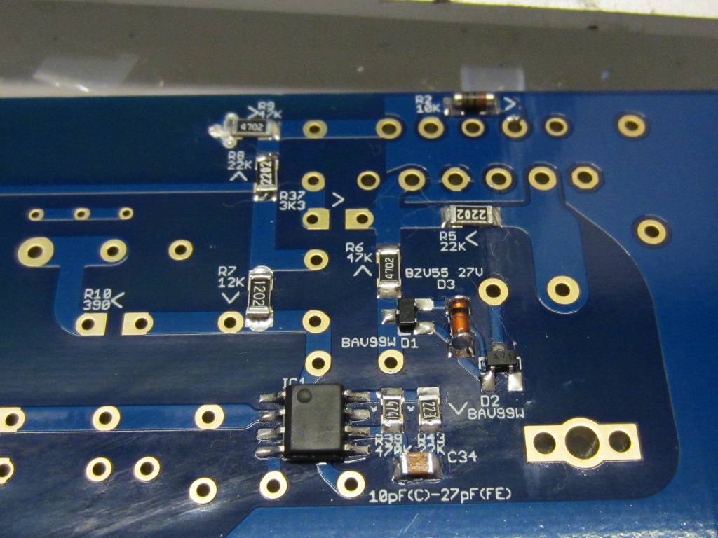

SMD Resitors with correct orientation:
My_Evo Rev A Mod (SMD part)
Wima capacitors can have straight or reversed markings
All Wimas have a small sign, the small ones on one side, the bigger on front/back:
That sign should be on the left side (small) or front (big), otherwise markings are reversed.
The one in the pic is reversed.
If markings are straight they should be on the side where the small empty dot is.

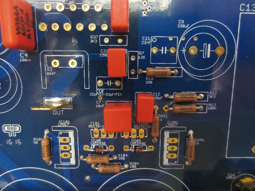

Through hole resistors orientation:
(note: C10 is void, unpopulated since it will be a My_Evo Rev A Mod build)
Indication on PCBs for R11 is wrong, it should be mounted oriented this way (resistor is raised only to compare orientation):

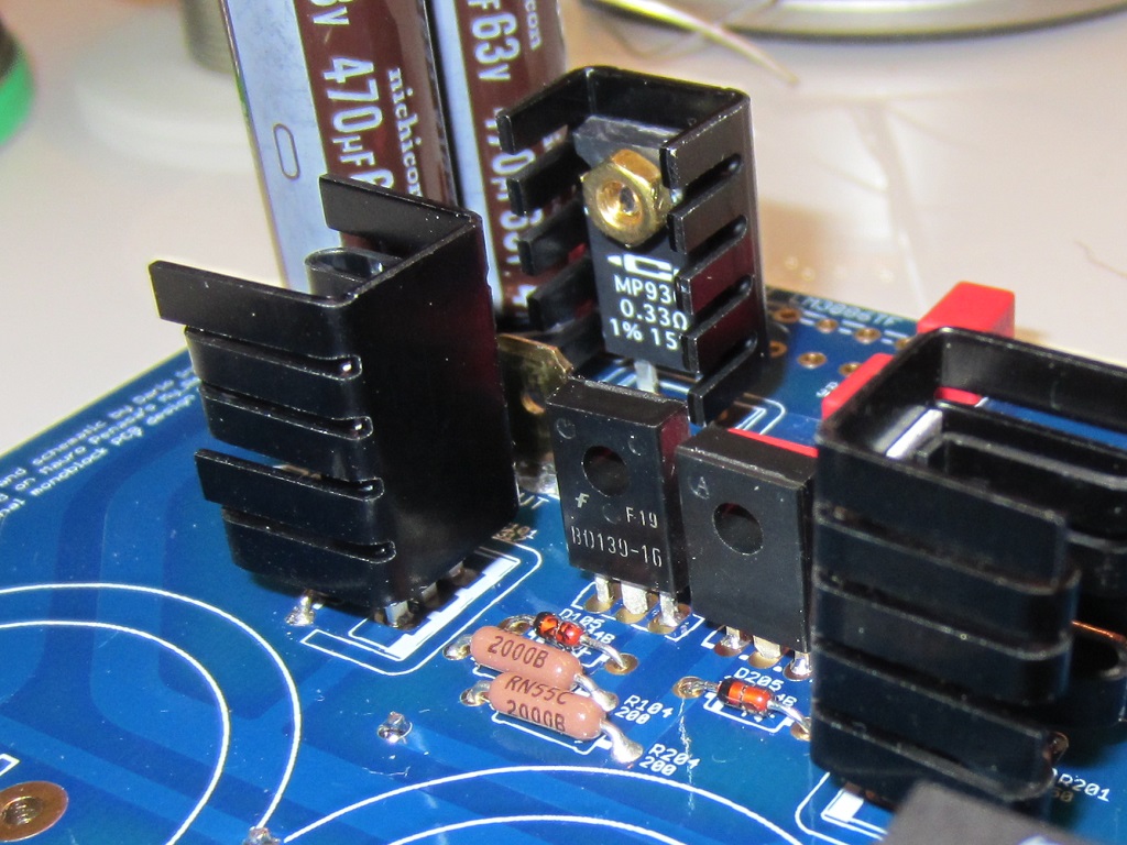

Transistors orientation:
(note: R3 is 0.33R instead of 0.47R since it will be a My_Evo Rev A Mod build)

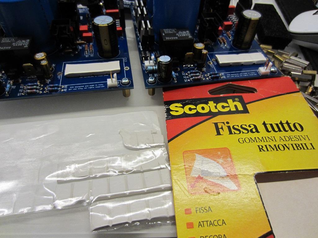

A suggestion before mounting input cap:
That gummy adhesive will dampen vibration on the big input cap and will make easier to solder it since it will kept in place by the adhesive.
You can find it under several brands and names, like 'Blue Tack'

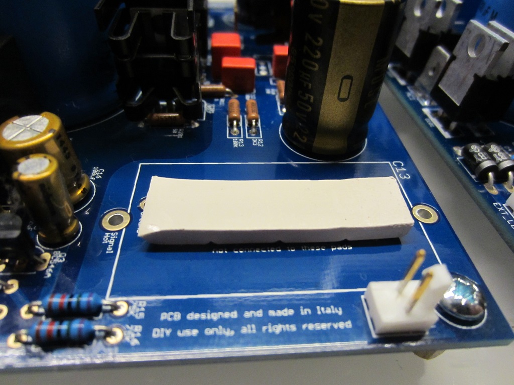

Input cap orientation:

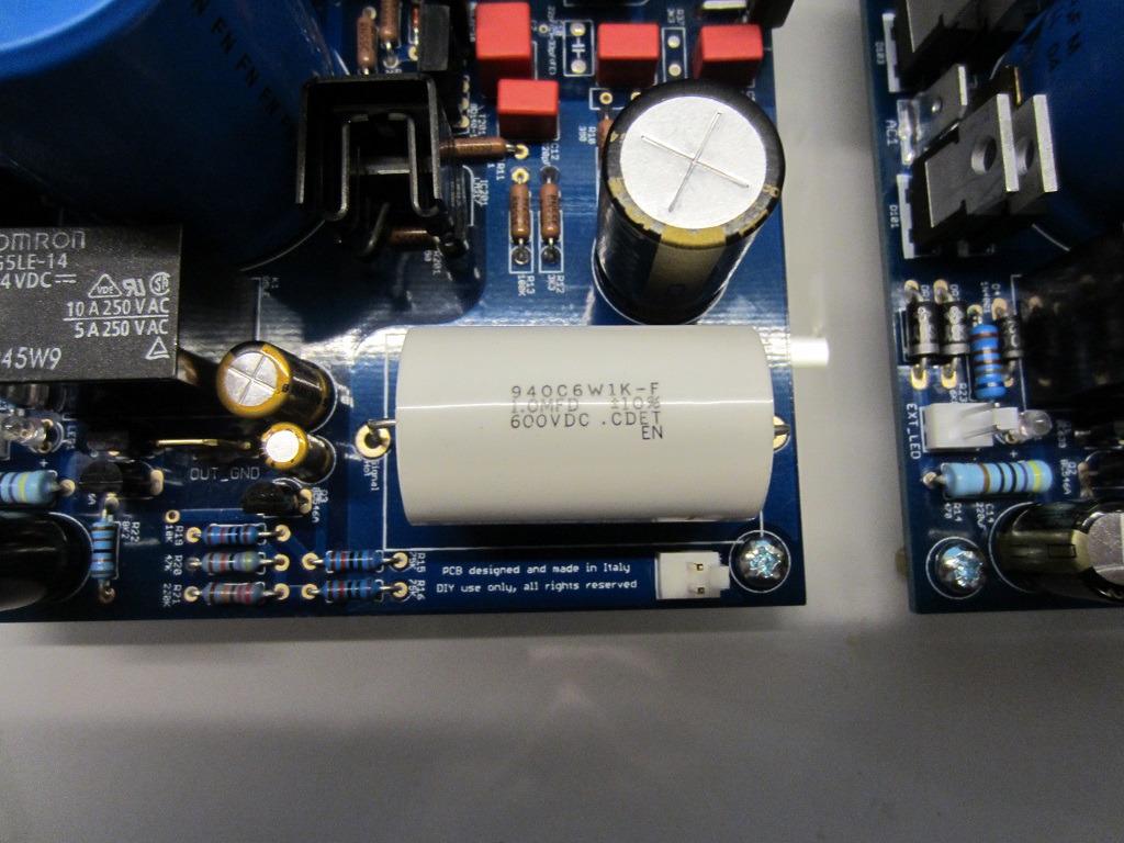

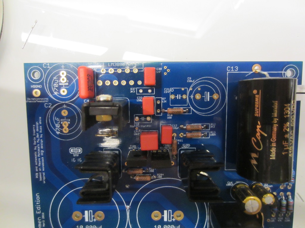

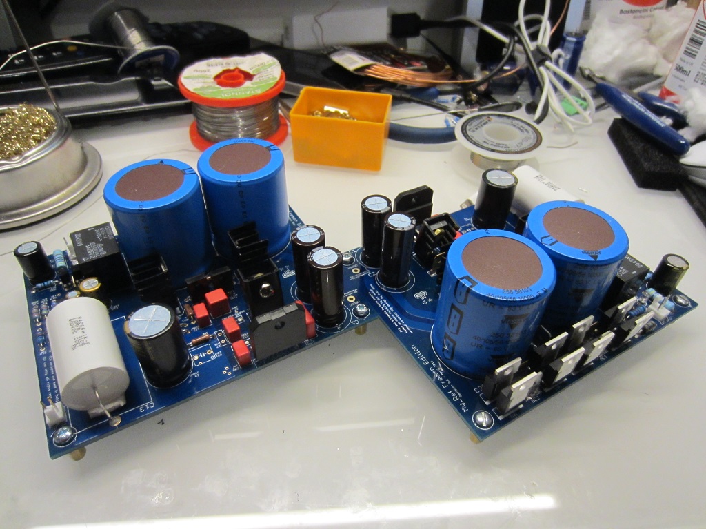

Finished boards with through hole C9 (Nichicon KZ):

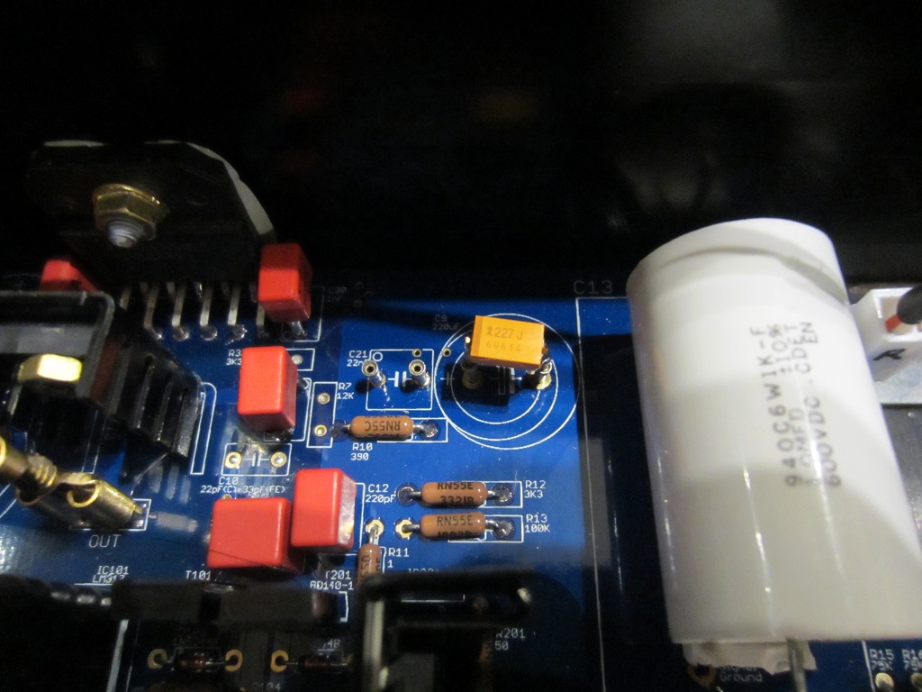

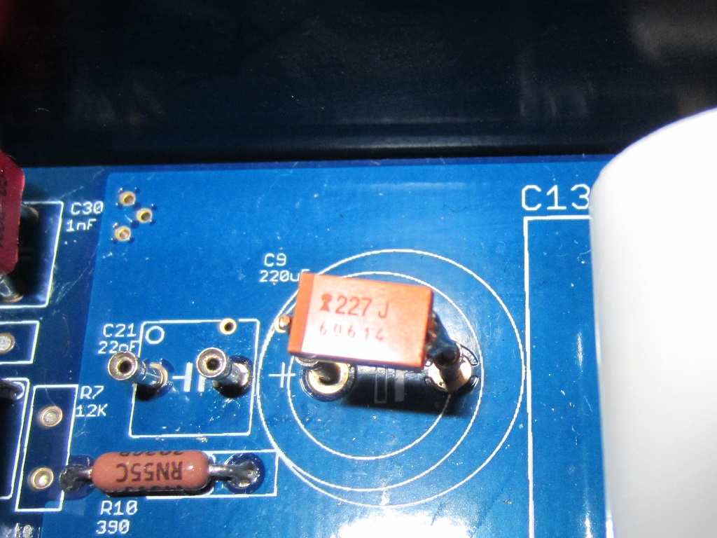

Correct orientation of the possible new C9 (but it should be mounted on the bottom side):

That's a weird world
Today I did a 5 hours Isotek repeated pass and harmonics still are not enough... AVX NOS discarded.
Instead it's possible that the KZ problem was a false one...

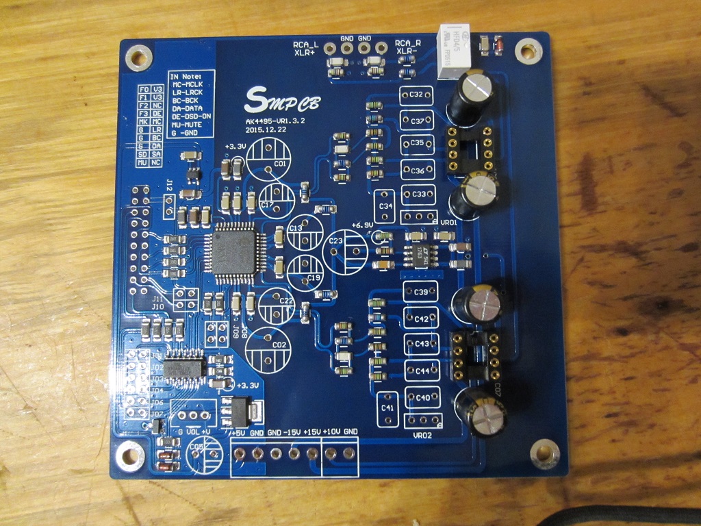

In the last days before populating the 1.6 boards I've changed my DAC with a new better one based on Amanero + AK4495SEQ and I used AD797 as LPF opamp.
Today I've connected again the old DAC, a XMOS+DSD1796+ OPA1652 one, and KZ were again sounding 'right'...mmh
AK4495 again, changed decoupling caps, same problem with KZ, changed opamp, problem apparently disappear.
I've tried OPA627, LT1028, LME49710, NE5534DD, LM318 with all of them KZ seemed to sound right, apparently the problem is only with AD797 and KZ that do not match, somewhat.
Now it's too late to make any critical listening at a high enough volume (1 AM here), tomorrow I'll repeat listening tests and if confirmed KZs will be back in BOM.
So, possibly, a lot of unnecessary confusion...😡

BlackGate PK 102%, Elna Cerafine 100%, BlackGate STD 97%, Nichicon KZ 88%, Silmic 84% and Nichicon FG 75%
I've been so critical because I though, deluding myself, that a cap available from Mouser with full quality was finally found... well, simply this is not the case.
A My_Ref Fremen Edition made with Mouser BOM will sound fantastic and better than previous ones so build with confidence, I'm enjoying it just now 🙂
As it was before suggested upgrades over Mouser BOM will improve performance, timbre, detail and balance further.
A Cerafine for C9 is the first upgrade and I would buy it from the start. 😉
Repeated tests at much higher volume and I can confirm that KZ problem is mostly with AD797 in my DAC.
With other opamps it fares really well but still not as well as Cerafines or Blackgates which are more neutral, refined and involving.
The Mouser cap for C9 has always been a good sounding one but not as good as it could for optimum performance (just for availability from Mouser) and KZs are much better than old BOM's FGs so as before the upgrade to the suggested best part is recommended but this time less stringent.
If I should rate the various alternates for C9 I would say:
Since there are some alternate to choose from I think it's better to rate clearly them.
First choice: Cerafines 220uF 50V or Black Gate PK 220uF 4V (PK slightly better)
Second choice: Black Gate Standard 220uF 16V and up
Outsider: Elna Silmic II 220uF 50V Black/Gold, colored but interesting
So, I'll look for a pair of Cerafines 🙂 I'm not so good at desoldering, so I'm planning to go straight with upgrades.
I've seen many using extra-BOM C13 cap. Any upgrade worth with it? I've been told that Vishays in that place are equal or even better than alternatives.
Fine 😉
I still have to make some critical listening comparison among the CDE in BOM and the Mundorf Supreme.
What I can say so far is that the CDE940 is a really good cap and not much a limit.
The Supreme, though, will let pass more 'emotion', it's more involving but also a bit darker.
Any way desoldering C13 is really easy since holes are really big, a legacy of when the suggested cap was Audyn True Copper.
Most of the good Vishays are no longer stocked by Mouser and BTW the Supreme was clearly better.
