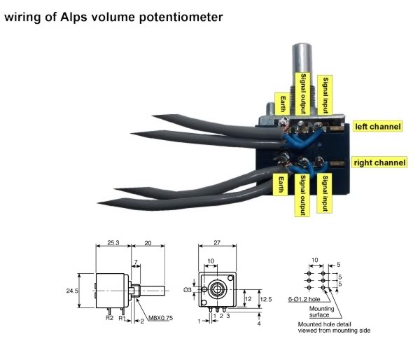

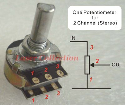

This is a good explaination. Picture #2 is from the eBay pot.

Hi Bill, This is what I think I know. A twisted pair is acknowledged as a method to cancel interference. It is at the heart of high speed copper network cable (the length and angle of each single rotation being critical) and all sorts of audio applications. A form of self shielding.
For a separate/discrete volume pot (and maybe even one inside a chassis) that concept is just extended to include a big bulge that houses a pot along the path/wire pair . The cancelling characteristic of the negative/ground current is just applied to a box and then returns to a twisted pair. The use of a non-conductive knob on the shaft eliminates the psudo-grounding/continuity from the human body.
KSTR and/or Andrew will correct me if I'm mistaken.
If you really want to dig in look HERE
Another way to visualize the concept would be the signal - shield design of standard coax cable. The metal box that houses the pot simply acts like a balloning of the shield over a short distance. That is why a plastic box will not work.
Just to clear things up a bit more, this is not the same thing as the power and signal grounding arrangements on the actual PCB and the associated connections/isolations. This whole discussion probablly should have been over on the JA/JC-2 thread. If needed, we can continue over there. ....My bad.....😱
You are correct - and I was not recommending the use of coax for volume pot wires. I only used coax as a tool to visualize the shielding concept. Maybe a giant python just after it swallowed a water buffalo would have been a better example. 😀😉
Yes, that exactly is the point for efficient electrostatic shielding. Depending on the thickness of the aluminum housing and on how good the electrical contact is along the seamline(s) of the box and the lid(s) this will also afford good magnetic shielding at moderate and high frequencies.
At low frequencies twisting all of the (short) signal lines per channel with the corresponding return (GND) lines does the job (but magnetic coupling is only an issue when the magnetic fields are very strong indeed), but you must take care not to build literal ground loops inside the box (keep the loop area of the GND connection wiring in itself as small as possible, that is, avoid any loops).
For the same reason the GND shall only be connected at one single point -- solder the four lugs of the RCA's together, the RCA barrels will provide the contact to the box.
attachment.php
For the outside world, twist all interconnects together, too, and at the point were you must split between input (source) and output (amps), keep the L and R lines together as much as you can.
Finally, route power cables also along that cable buss, again keeping all cables from/to a device together (interconnects with good shielding properties, and some experimentation is required.
It's all about keeping sending and receiving loop areas as small as possible.:hypno2:
