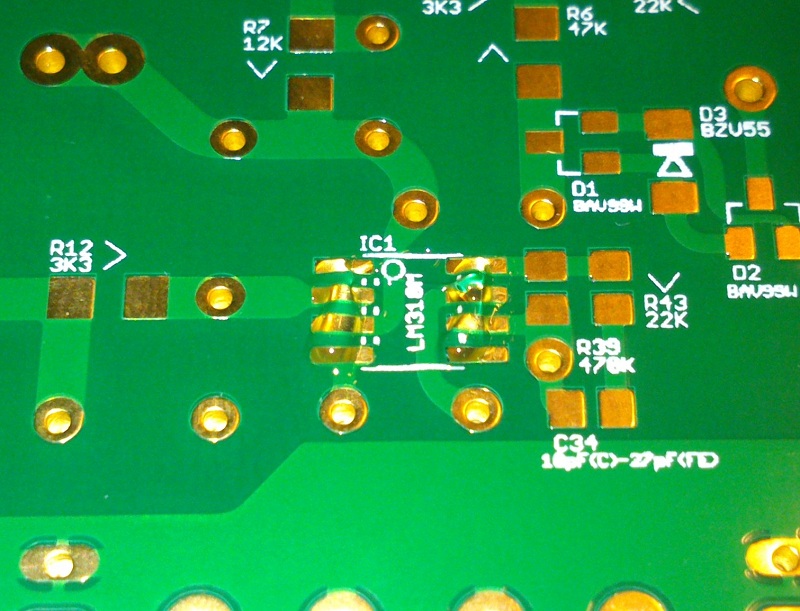

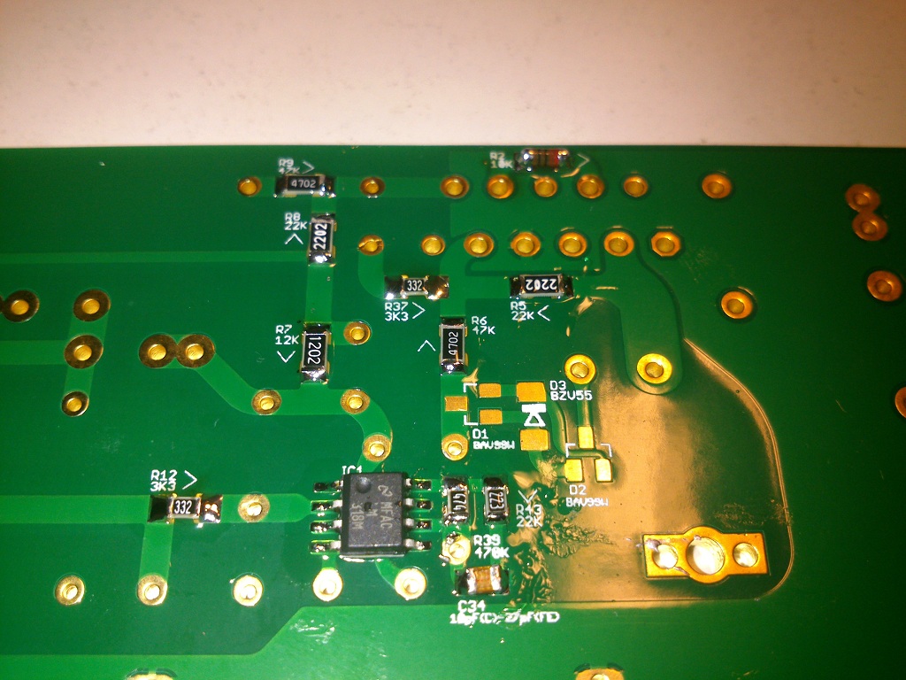

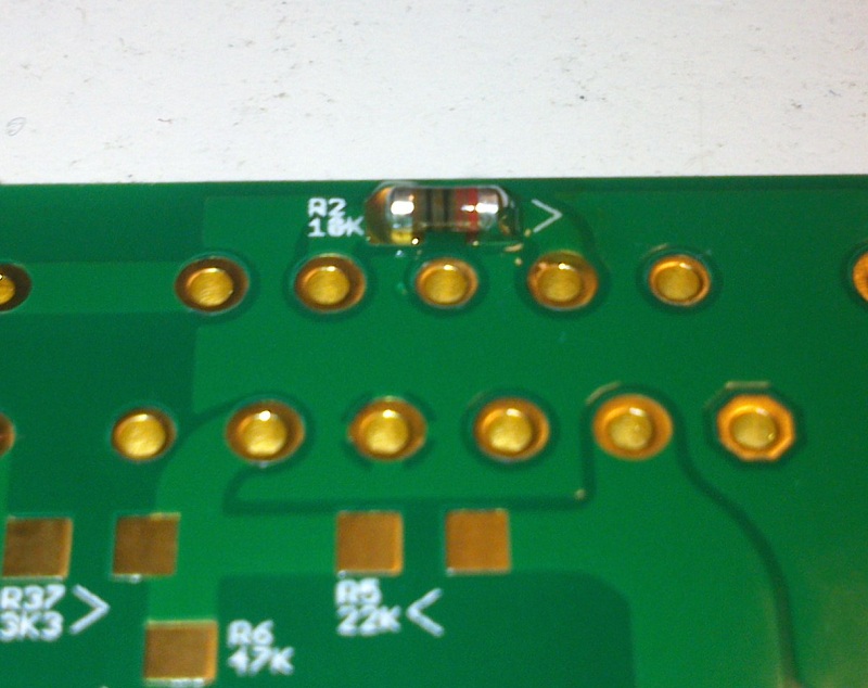

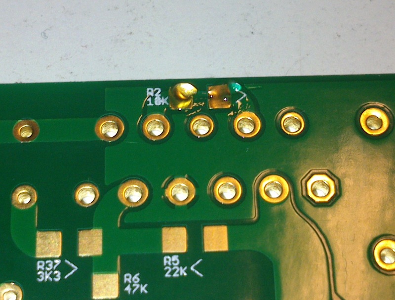

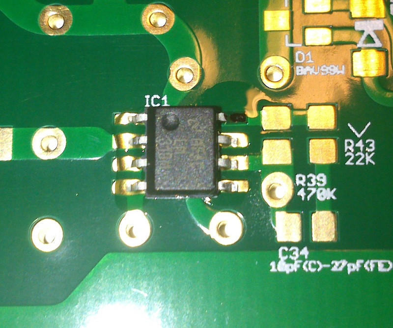

Here some pics of the building process (opamp and SMD passives)
Note:
First flux, than solder.
Note:
O.K. I'll ask. Do all the boards have that fade on the coating ?
Which fade?
Do you mean the yellowish reflex from the lamp?
Wheww ! You had me scared (or is that suckered in 😀) for a moment. Was thinking I might have to soak mine in blueberry juice to get things looking as they should.

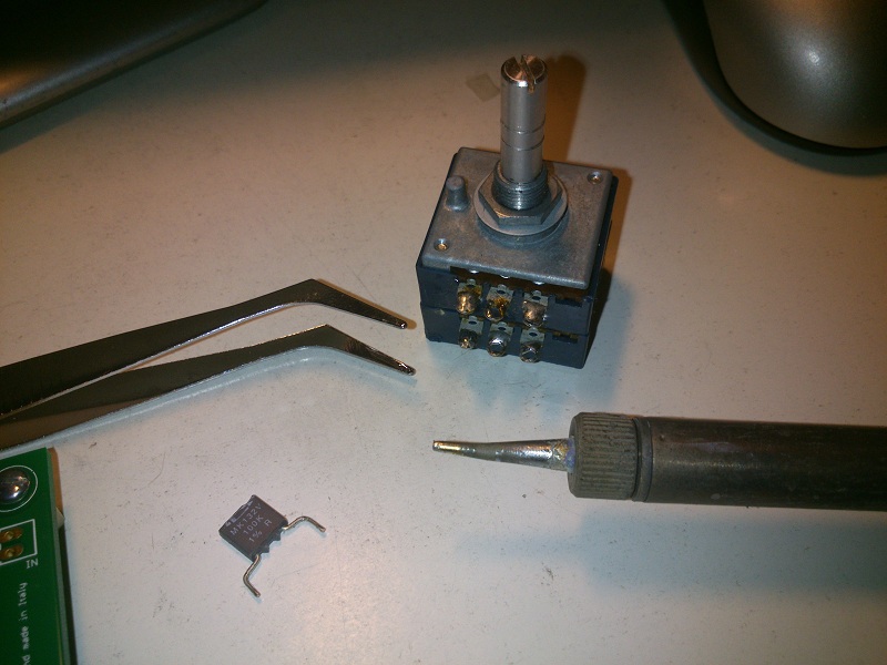

Can/Will you post a picture of the tip you are using?

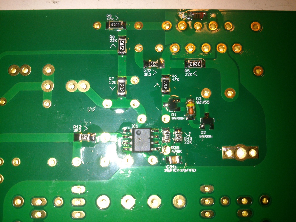

SMD soldering done:
Nice!

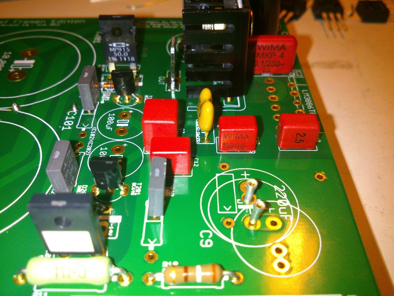

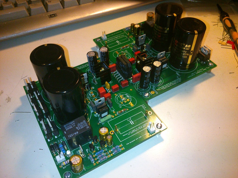

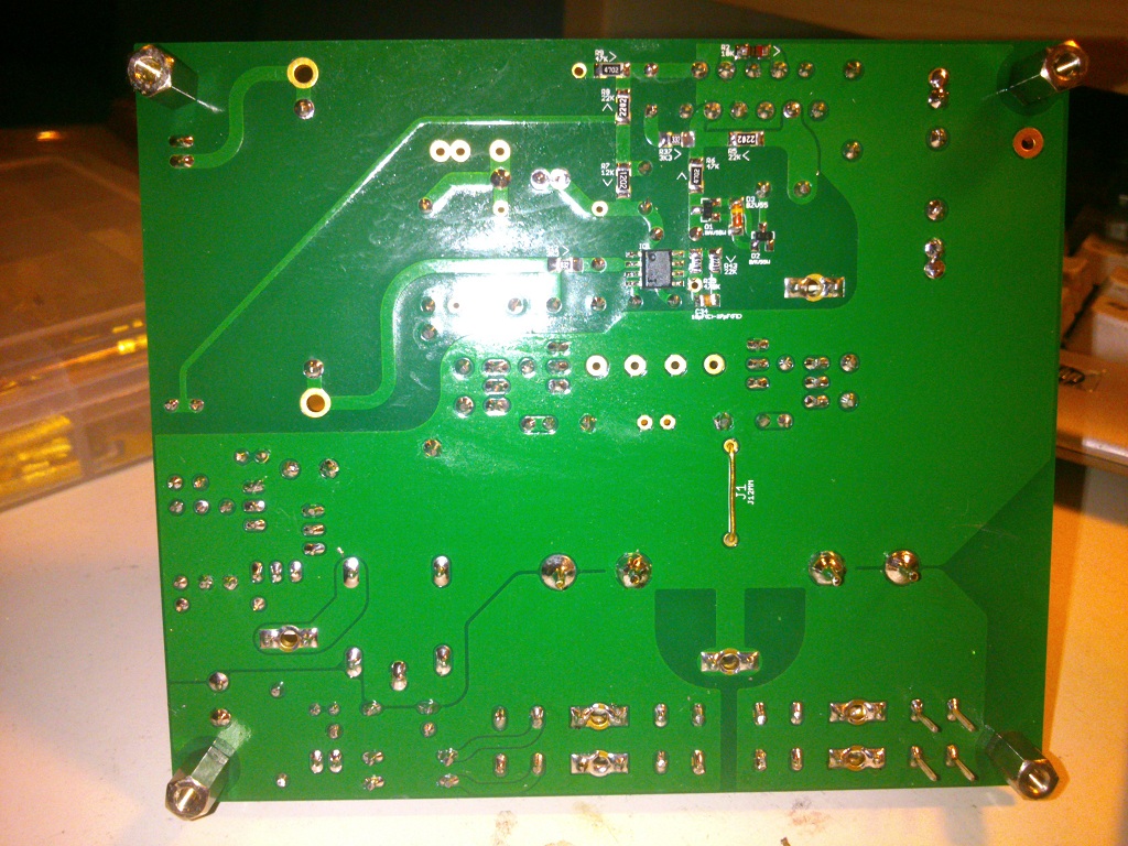

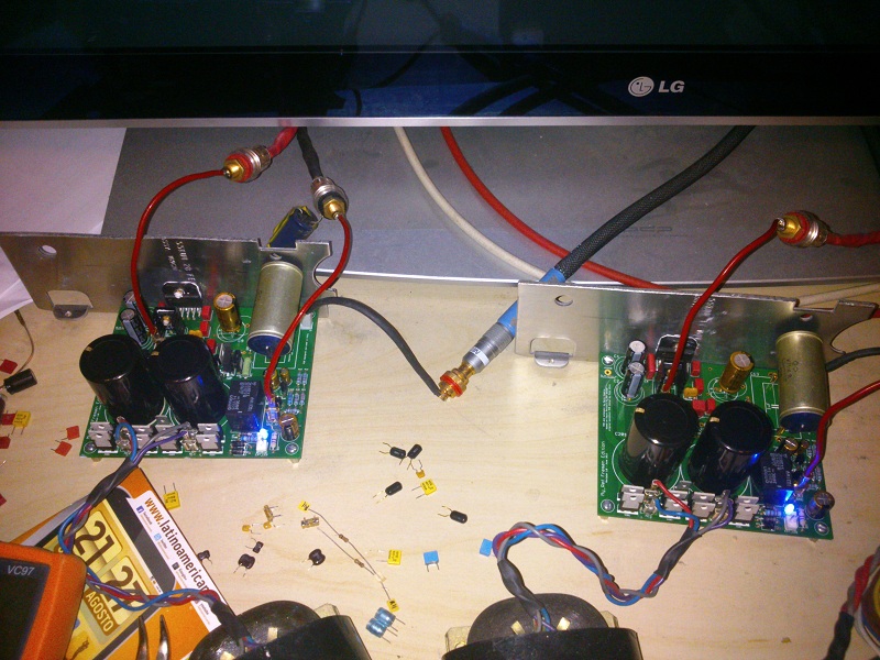

Boards running
They work, and they seem to sound even sweeter than beta boards! 🙂
DC offset is around 30mV, a bit on the high side but not worrying.

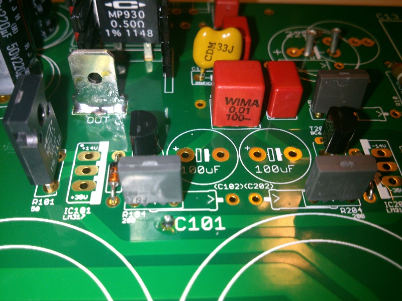

On the preceding image note the solder on the upper side on PCB faston connectors
They're easier to solder than beta boards but on ground plane is always needed a pretty high soldering temperature, on those positions use the tacky flux, it helps a lot.
Don't forget the J1 jumper (visible on picture) or it wont work and damage is possible.

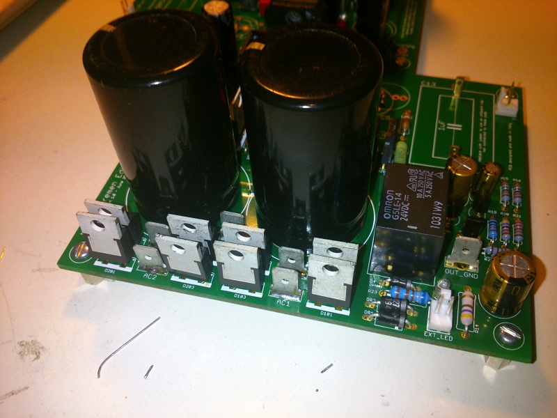

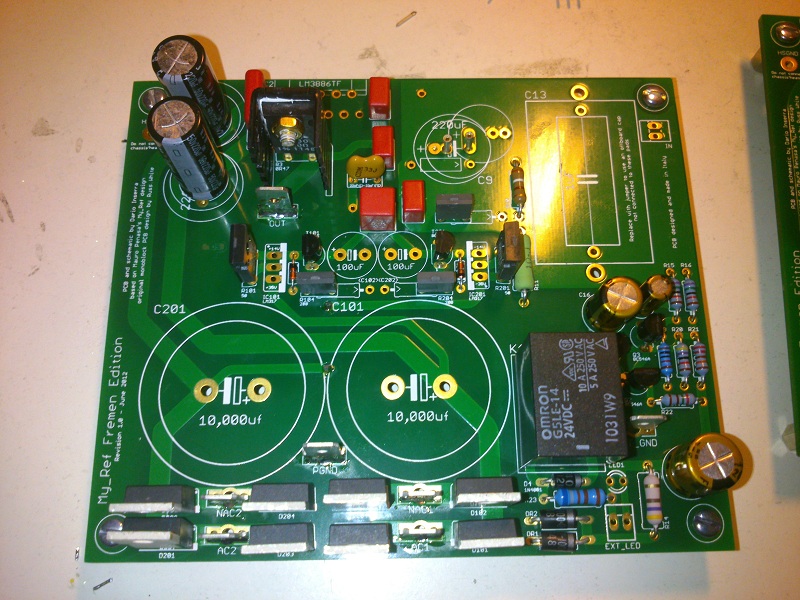

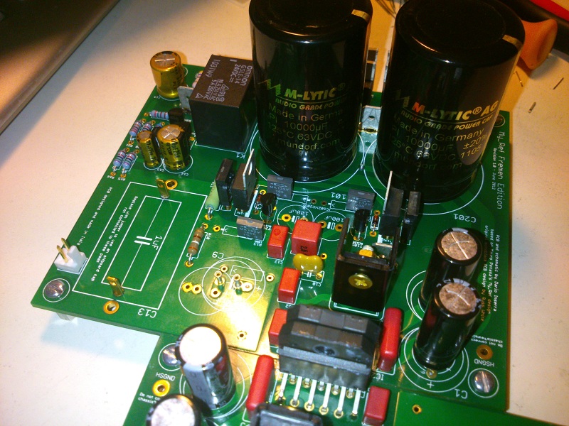

Wow you made quick work of those Dario! They look great!😀
Quite so, it took circa 5 hours.
Yes, they look good but I miss the gorgeous blue of beta boards... 🙁
First packets should ship this saturday.
Dario, What are those posts on C13? I can see using them on many other boards. Also, It appears you installed sockets at C9 only. Is that correct?
You must have been very pumped to build at that speed. I'm impressed.
Simply 2.8mm faston tabs.
Yes
It's my usual time for populating a couple of them, also for beta boards I needed circa same time.
