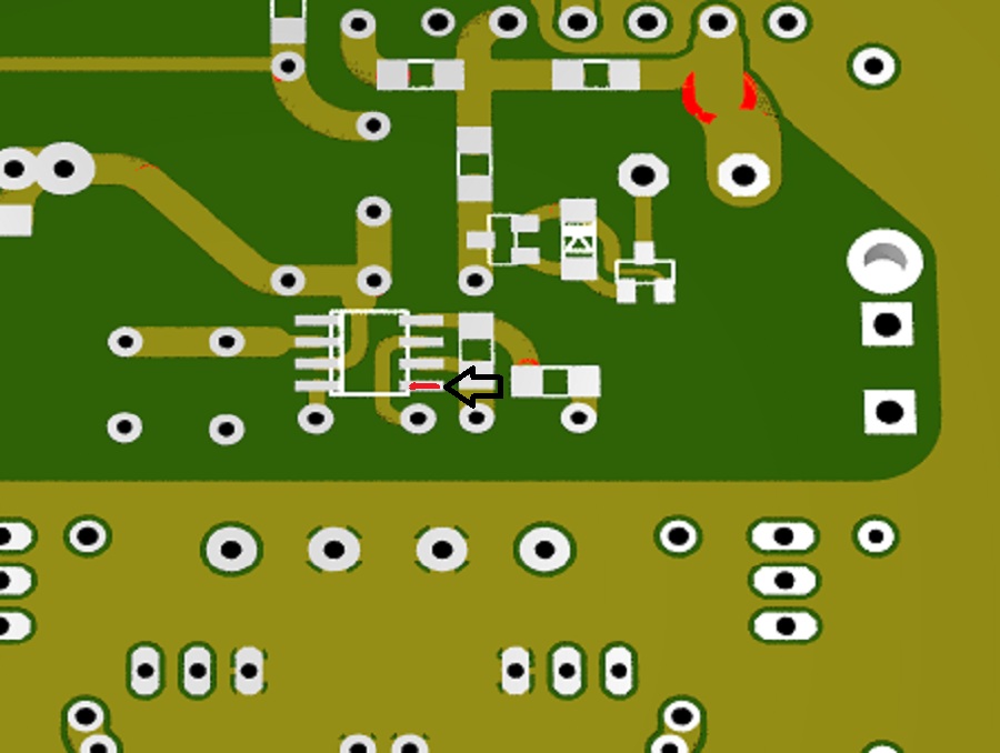

I think the zeners at D105, D205 are in correct direction.
Yes, they are but I thnk Klaus was referring to D3 (27V one between BAV99s).

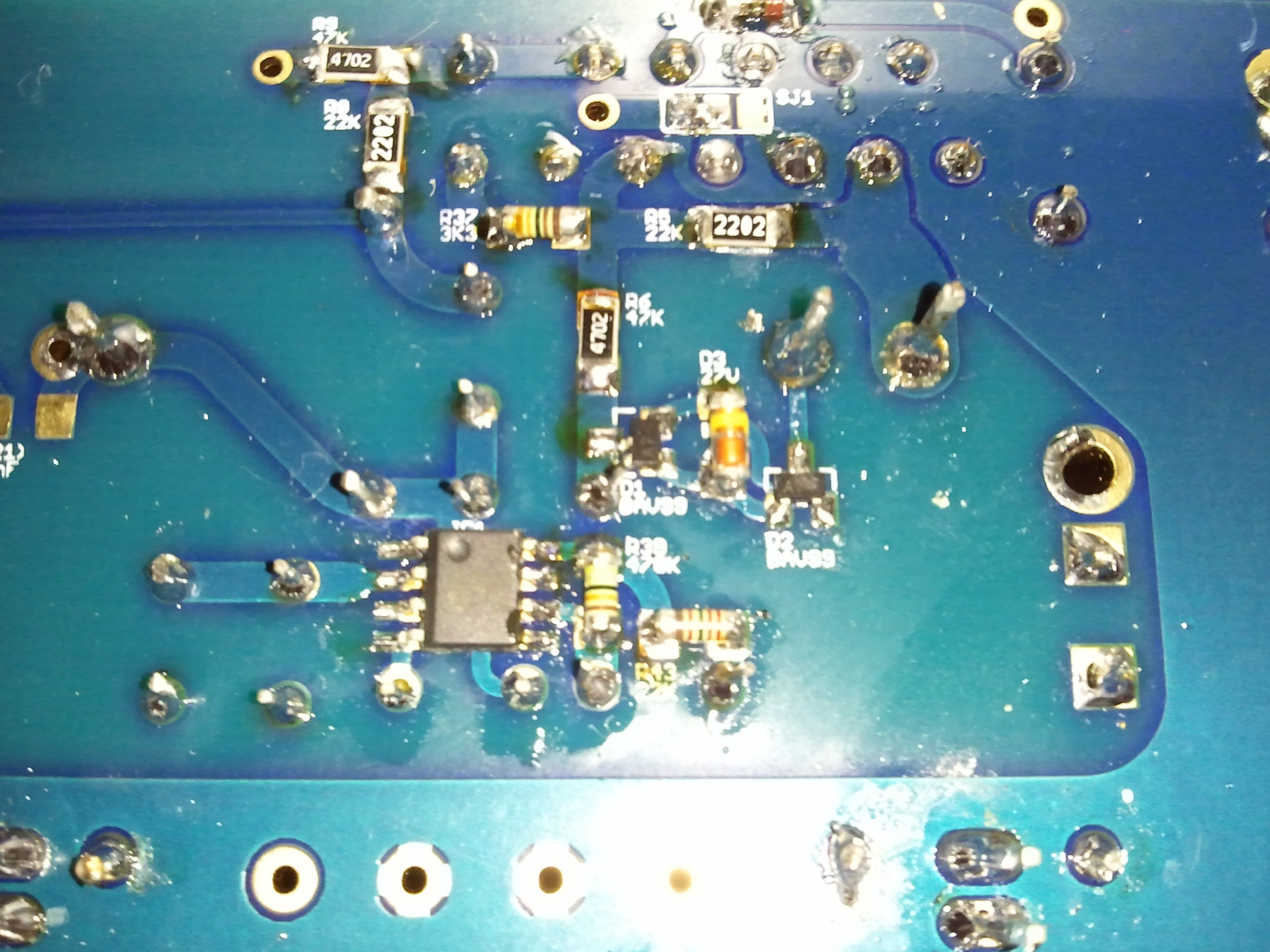

Can you post a clear picture of the bottom of the board?
How DO you guys get such clear pictures of small things ?
Firm hand, a lot of light and macro mode.
Here is a pic of the 27V SMD zener. The stripe is toward the 3886 on both boards. I have not tried to re-flow it yet.
It's correcty oriented.
But I see a lot of possible cold joints and solder bridges.
You probably use a too low temperature with you soldering iron, it should be at least 320°C.
Looking back on it, I'm sure on part of the build it was too cold. I have one of those Stahl variable temp w/ chisel tip from Parts Express. This build was the first time I used it. Now I see that 350C setting gives that 1 second melt we look for.

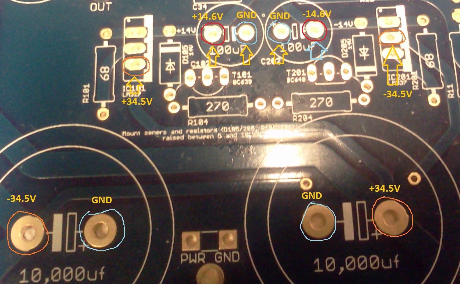

10000uf measures 33.7 and 33.8
100uf measures 14.3 and 14.4
IC101 measures 33.8
IC201 measures 33.8
They seem good measures, a bit on the low side but probably it's the transformer regulation.
