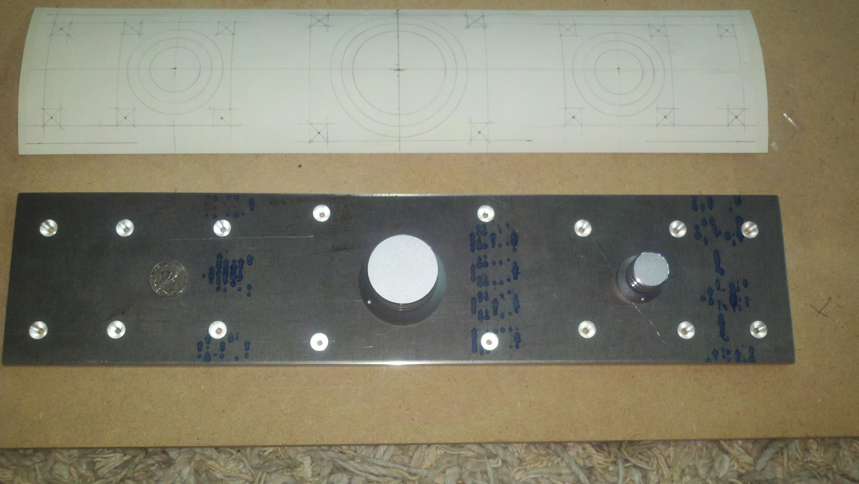

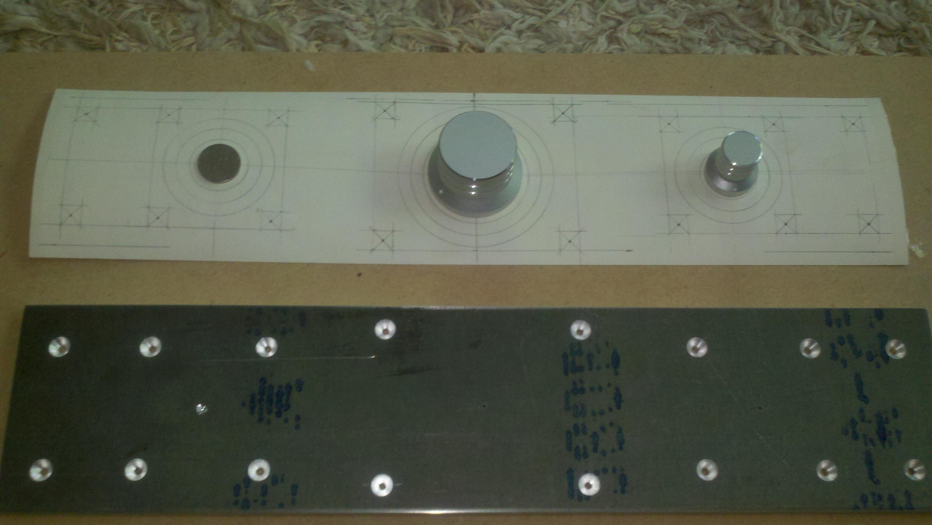

It is spooky how quiet this thread has been lately! Anyway I posted in Bobs JC-2 thread that I had received my kit and my lighter note kit. The lighter note project has begun and I am making good progress on the enclosure. The face plate is almost finished and will incorporate some of the design elements of my 4780 integrated build. I will be making this a single input and triple output device for versatility. It will be simple but I have high hopes.
My package from Uriah also included some other interesting devices, a pair of LDR resistor replacers! I know Bob has used these before with success and I am excited to figure out how to incorporate these into this build. Thanks Uriah!!
Here is a pic of the front panel so far( I am actually further along, I just haven't taken a pic)

I envy your metal craft ability! 🙂

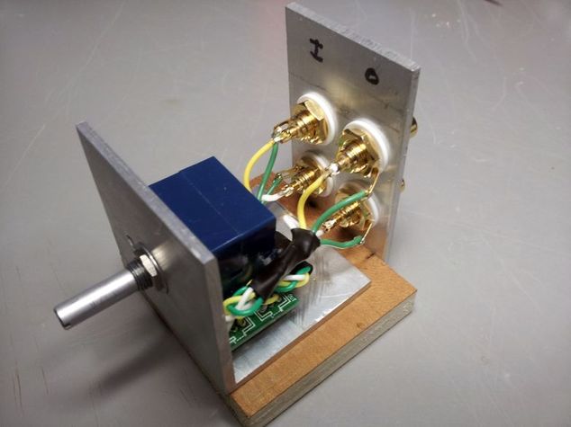

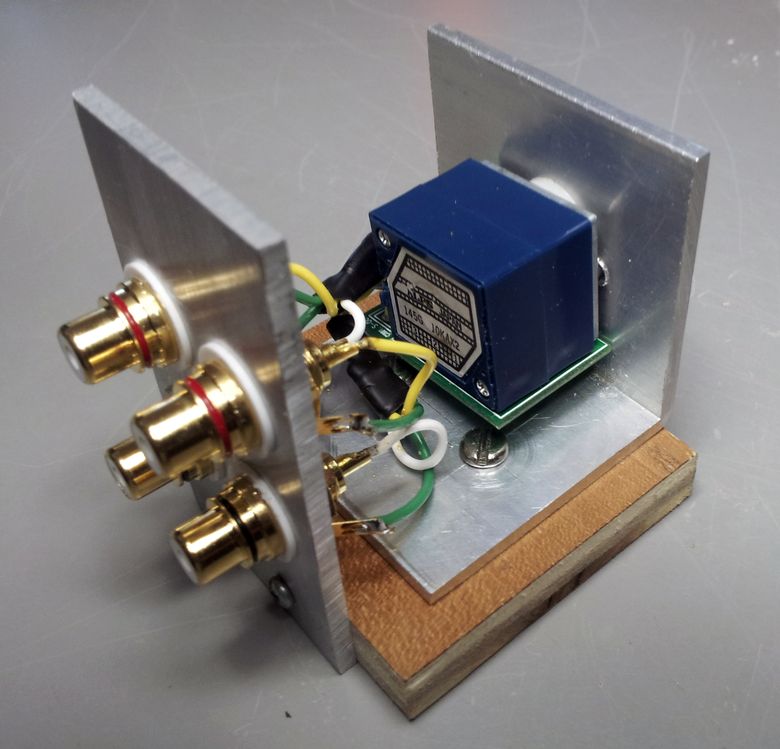

A new rig for volume control gizmo using Bare Alps 27 10K pot. As a side reverence, I went back to the Parasound site and discoverd they are using a 50K Alps for volume. Any ideas?

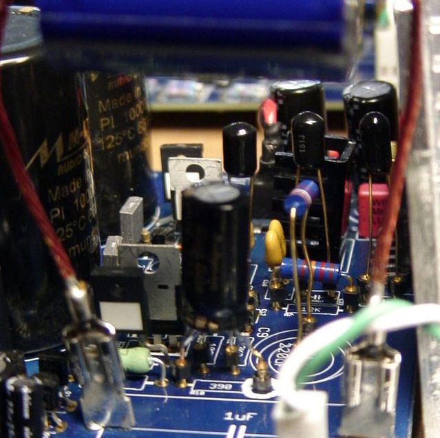

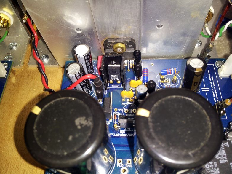

Also, finally trimmed most of the long leads on resistors and caps. I was getting some distortion that could have come from vibrations on the leads. I should mention that the use of sockets requires some mods to several parts. Most of the Caddocks need their leads filed to fit the sockets (Dario's tip) and the Amtrans have very small leads that should be bent a bit to ensure good contact.

10k Alps Blue RK27 is a known-good standard for a passive "preamp". Personally I tend to like the 10k TKD CP2500 better but it also is significantly more expensive.
As usual, good electrostatic shielding (including the pot's metal housing parts) is required for best hum/buzz performance. Again I would recommend non-isolated RCA jacks in a completely closed aluminum box (Hammond), and the knob is best choosen from a non-conductive material.
