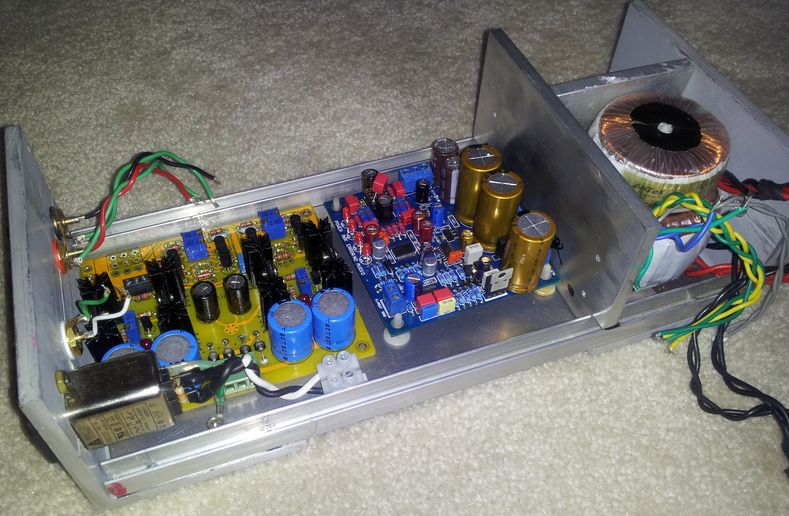

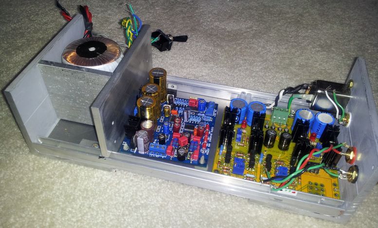

BTW, I couldn't set up the Tube vs FE challenge for this weekend so I'm redoing a rig to test the Mini 2496 DAC and the JC-2 pre in combination to drive the FEs.

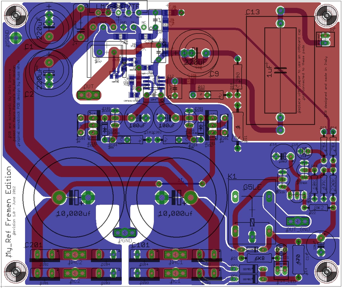

I did some modification to the PCB layout:
  • enlarged by 0.5cm the PCB (same cost for partecipants) so to reposition R10 and R11 like in beta boards.
  • revised the DC protection (thanks to the added space) so to have less interaction between various ground returns.
  • the C14 cut-out is more similar to beta boards
  • added a commodity wirepad to ground the heatsink.
attachment.php
Any opinion, as always, is welcome.
