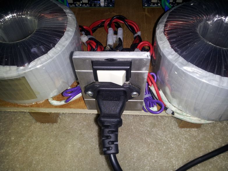

Now that I have the amps back I did the "Atomic Ear" test. with the Mini 2496 dac connected and the bare pot at max, absolutely no sound of any type from the 8" woofer and the two 5" mids. There is a pure airy "S" sound from the tweeter at max pot rotation that completely disappears at normal settings.
With the DAC switched off and FE on, still not a trace of hum and the "S" sound is gone. With nothing attached to the FEs I get a soft Mini-Moog tone appropriate for the sound track for a thriller movie. 😱
Super clean - deadly silent indeed !!

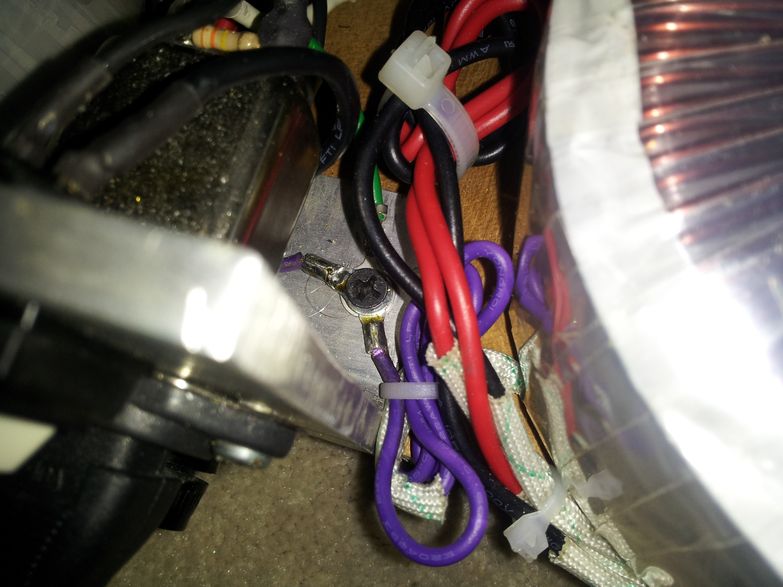

Yes, same results. I'll add that these are the new Antek toroids with the magnetic shield ring and an extra (purple) ground lead. The amps are still on a piece of plywood with the grounds attached to a small piece of aluminum. Don't know if moving to an all metal case is going to effect things.
Also checking to see if I can hear a difference between a standard power cable and the style I made. DIY Belden 83803 Mains Power Cable - Audiophile Power Cord

Suburrra heard a very faint hum with 97dB speakers that can be heard from half a meter from them.
With 92dB ones he had to be at some centimeters (3-5) from the woofer.
With 89 dB ones (like mines) he's not sure he can hear it and with ears in direct contact to the membrane.
BTW, just for comparison, a McIntosh present at the store where the test has been done were much more noisy than the FE... 😀
We will see, thanks to KSTR's measures, how serious is the problem and if it can be solved simply insulating C14 ground return.
Suburra will also try connecting the heatsink to safety ground, a 'trick' that for some My_Refs fixes this sort if problems.

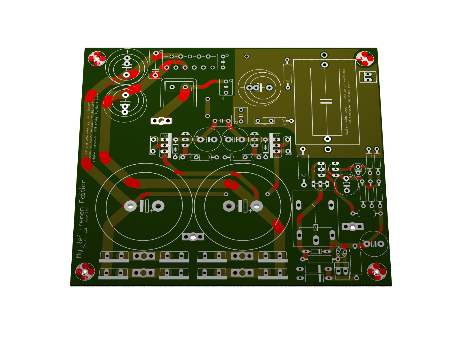

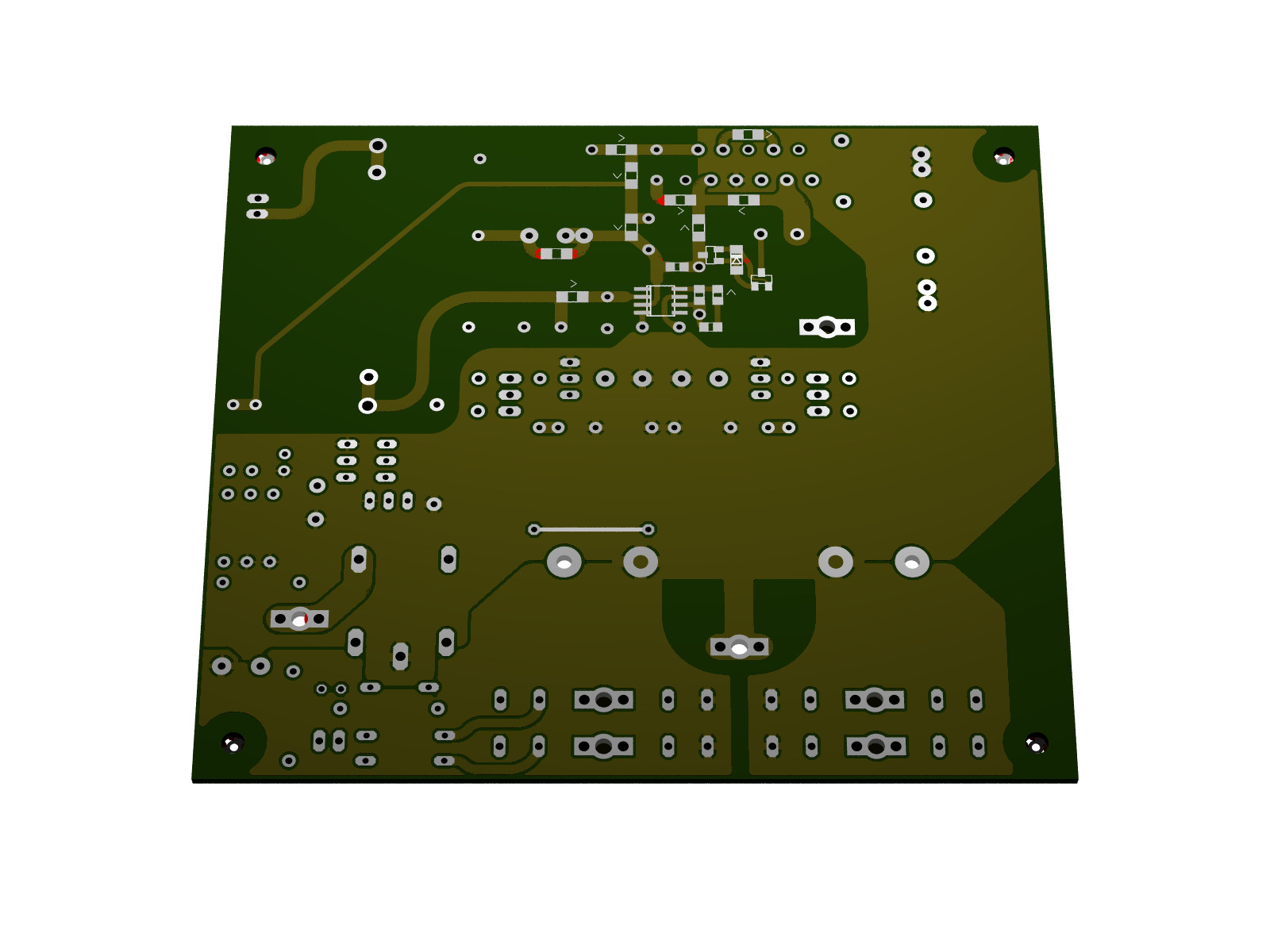

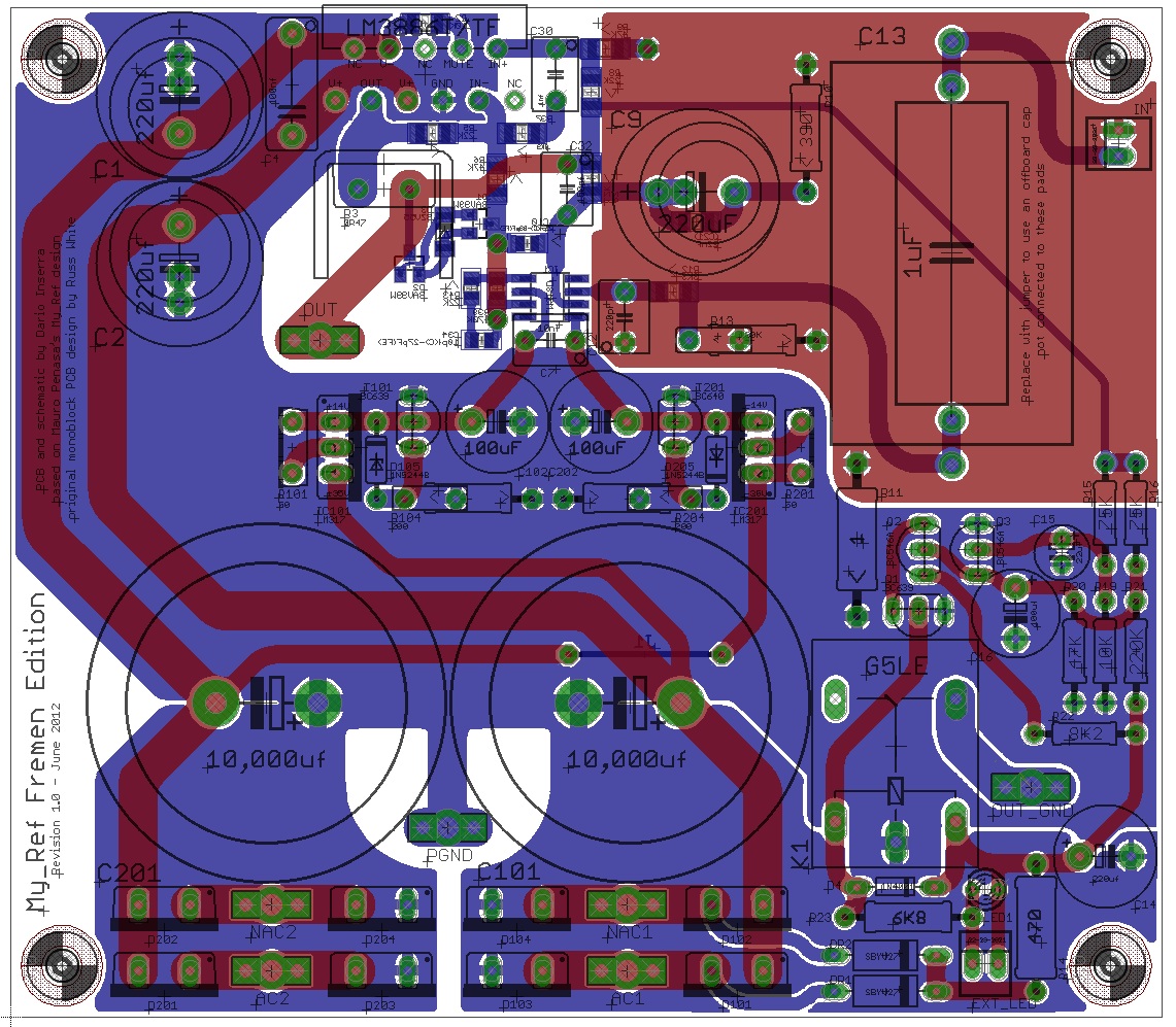

Nevertheless if we can fix it with a simple cutout more on the groundplane... why not? 😉
I've already did the mod to the PCB. it look gorgeous and I don't expect problems with it.
In fact this way is more coherent, also big smoothing caps are alredy separated in the same manner.

PS
The Google folder has been update with the new files.

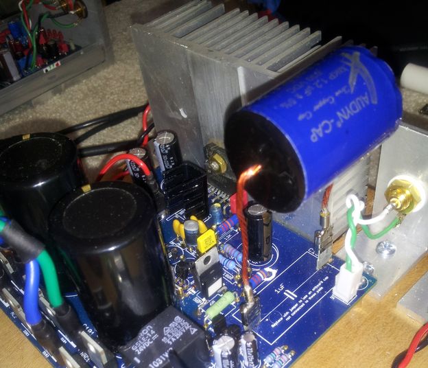

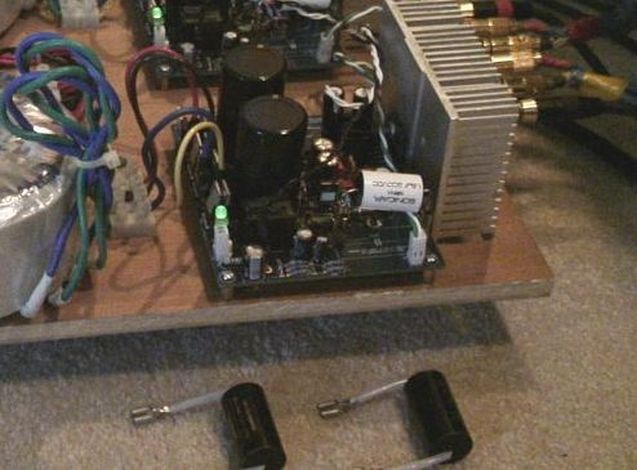

I have received several inquiries about the actual value/quality of the Audyn True Copper caps for C13. Those who have heard them think they are great and well worth the price. The only way to know for sure is to hear what improvement they offer. At $79 for the caps, and another $15 - $20 in shipping/service charges, (I paid a total ~ $97) builders have just cause for reservations on that purchase.
I've made this suggestion often but nobody has posted it - so I will. If several builders in a country go together to get one pair, and swap them around, each person can audition them before making the purchase. This would of course require the use of quick connects, which is safe, convenient and easy to install/uninstall. This also avoids the need for repetitive soldering of the caps. No doubt about that first pair quickly finding a happy home at the end of the process. And remember - the caps just get better the more they are used.
Such an approach could be done by private PMs/eMails, or could be a sub-group buy here on the FE forum.
Just a thought :idea:
Those caps are great quality ones and the best I've auditioned.
Suburra, who's auditioning my FE modules (including the True Copper), find them gorgeous.
Nevertheless don't think the FEs needs them to sound great.
Start with confidence the build with the Vishay/Sprague in BOM, they sound very good for the price.
This is a great idea so that builders can upgrade their modules after actually auditioning the True Copper. 😎
No doubt the BOM will sound great. In fact my second choice (for my style of music & my system) is the flat out best value Sonicap Gen I @ ~ $8. Price is not always the determinative factor.
IMHO, many similar choices must also be made with consideration of the capabilities of the speakers used. The sub-group buy idea just reduces the "gamble" aspect of buying higher priced components. 😉
