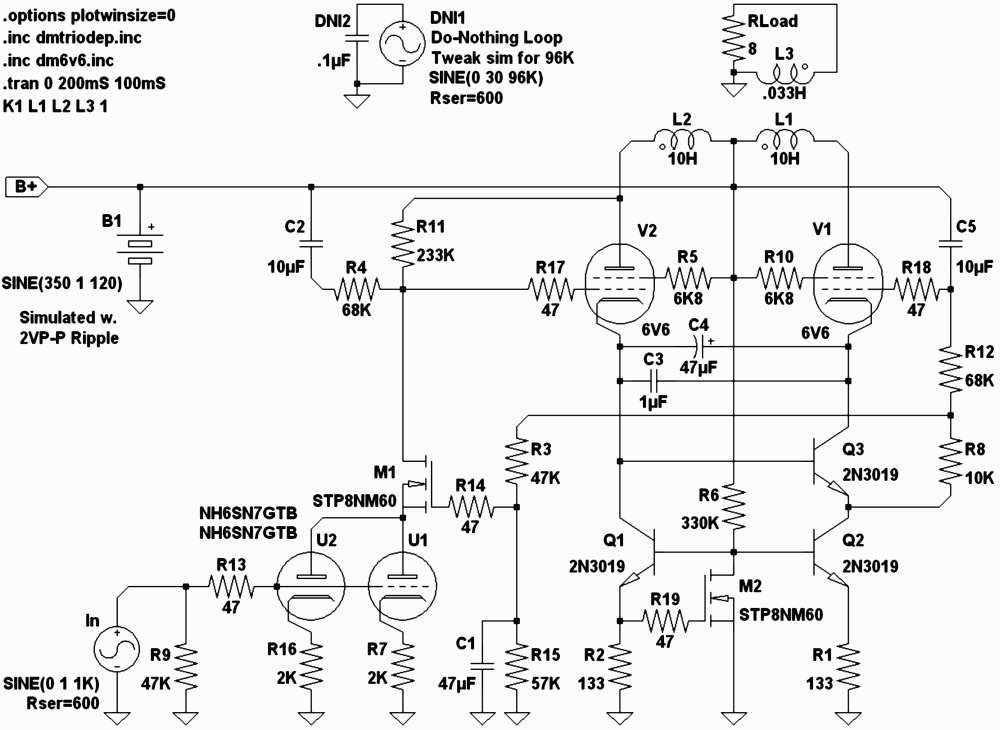

As a little speculation, I was thinking, what would happen if one built a 3 stage P-P amp this way.
Starting with Shoog's configuration as the driver/splitter (resistor loads instead of OT, or interstage xfmr), then a subsequent output stage with a similar Schaded triode and anti-triode into the OT.
Ie, use the first Schaded triode/anti-triode as a new type of splitter/driver stage. Curios as to the effect of such a splitter on a conventional P-P output stage too.

We seem to be concluding that if the gm is equal, it's not an anti-triode...
I don't think it's strictly a matter of equal or not equal gm. I do see how the gm
nonlinearity of 2 identical tubes will cancel. And I suppose that a pentode
slaved to a triode can cancel a lot, if not all, of the triode's nonlinearity.
But I also suspect if a slave device is operated at relatively constant gm but
equal to the master device gm (for example by using a MOSFET with the
appropriate unbypassed Rs), some triode character will show at the output.
Ken; I have thought about but not yet tried the FET-pentode cascode. I
thought about using it for a selfsplit drive stage and as an output anti-triode
along with an 807 in series mode (think 1200V B+😱) but the IXGH6N170 calls.
Don; how about a 2 stage amp with self-splitting pentode/antipentode driver
and push-pull Schadeode outputs? How about an input stage that gives the
amp a push-pull signature when driven with a balanced signal and a SE signature
when driven with a SE signal?

Re: Michael
Yes, I see what you are saying. I think you mean to say SE character here, not just triode. Equal non-linearities lead to a P-P sort of dist. cancellation. A near constant gm in the anti device would eliminate this cancellation. Using a high gm device also achieves the same effect by operation over a smaller portion of its non-linear transfer.
"how about a 2 stage amp with self-splitting pentode/antipentode driver
when driven with a SE signal?"
Lets see, could we just duplicate Shoog's setup for both output tubes, providing two inputs. Seems that if both sides are identical we will just end up with the equal non-linearities case, leading to a P-P signature regardless of which input is driven. Unless one input to each device (cathode versus grid) can be more linear than the other. Some asymmetry in the Schade feedback perhaps? Seems like it affects both input terminals similarly.
How about duplicated but opposite dissimilar (each t/anti-t setup with unmatched gm's, but on opposite sides, and only one input driven to each setup) "triode"/anti-triode stages. Then sum the outputs. Complicated. Some way to simplify?
Maybe parallel devices on each side of just one t/anti-t setup, and each input only drives one of the parallel devices on each side? Each input then has less gm than the anti-side taken together in parallel. Wild speculation here no doubt. Some problems driving only one of a bunch of followers, this would need some cathode summing/degen. resistors likely.
"I wish I understood just half of what you guys are on about!"
I'm not sure we really know what we're talking about here either. A strange new landscape. Lots of hand waving theory, fortunately Lars and others put some real data onto the table periodically. But when there's no map, well .....

This toroidals transformers is the part I like most in Shoog's circuit, actually the whole circuit is a masterpiece indeed. Who says there is not much progress in the tube amp design ???
Other things came into my mind when I read Shoog's circuits.
1, Baby Huey amp (Yves, Gingertube), has similar partial feedback circuit.. it is a "voltage feedback"..the partial feedback can also be implemented by pentode loaded with CCS or Gyrator,which is "current feedback" (I/V convertion).. Broskie's 300B amp is a good referrence in DC and AC calculation.
2. Triodington, (OldEurope), anti-triode circuit. again, very similar concept.
I find it hard to understand concepts discussed in this thread.. a good learning though..
Triodlington is a triode booster, curved just like the triode.
Not an anti-triode, which would be curved "the other way".
But they do play nice together...

Elegant solutions are not always superior to brute force.
I would say adding more of filtering capacitance is an elegant solutions. It lowers PS's dynamic resistance as well, lowering parasitic feedbacks, that is good for the amp.
The elegant solution would have used smaller caps and abuse the output stage
(cathodes) as its own (negative) regulators or cap multipliers or whatever....
This is one design (properly implemented) that shouldn't have cared how noisy
the power rail might be, within reason...
Well, at least brute force clean power you won't have a residual IMD of hum.
Can't swear that my solution to float away the hum would have been totally
free of IMD side effects.
No rule saying you can't combine both brute force and elegant techniques.
I suspect the benefits would be cumulative.

I just saw the EL86 spec sheet (Mullard), actual suggested application is SEPP!
I guess you picked the right part for it. Though, I still havn't found a spice model.

Agh... And I'd already redone with 6V6 last night...
Well, quite a few PSRR mods here to chew on. Comments???
The biggest problem (for me) in getting full cancellation turned
out to be screen currents. I ended up ditching the pentode up
front and gone to cascode. Hybrid, but only cause the voltage
I had to work with (for direct coupling) wants to be quite low.
There is still quite a bit of IMD when hum (2VPP Simmd) is present.
So, Shoog's solution is still the better one. But you can do both.

Making up (the balance?) for driver current, I'm not. Its a goof I may need to address.
One could fidget with the emitter resistors in the mirror I suppose...
If its single ended in behavior, then we might even want the quiescent to be off the
center. That the opt might be better centered saturationwise at full signal... But this
is no excuse, I simply missed it.
I did deliberately imbalance the cathode voltages. That only one polarized cap might
be needed in the bridge... Feedback biasing inspired by something I saw Waveborn do.
