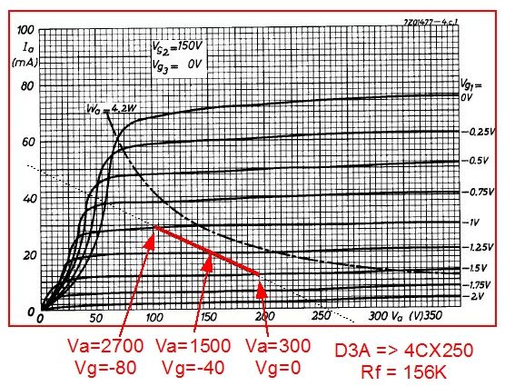

I would go with a gyrator loaded pentode, as a V/I converter.
Wonder if that will work IRL? Maybe I missed something. The bigger Rgen(in which Ra and Rí is parallelled) is, the lower the gain. So with Ra and Ri going towards infinity, gain will diminish.
"Have you really done the maths?"
Ehhh, no. But looking at the 6AU6 curves, a .7K load sure would be making distortion in the input pentode. The feedback is linearizing the output stage and killing the input stage by loading. At least 100K needed for R12, even more would be better.
With the Gyrator type loads, they should actually free up a little extra current from the V to I input pentode for driving the feedback loading. No current waisted in the 14K Ra load. But not nearly enough fix-up to clean up the 6AU6 non-linearity problem. The cathode resistor may need increasing to 250 Ohms or more, which will require a cap on the input for biasing then. A higher gm tube than the 6AU6 would be helpful here.
Oooops, wrong maths by me😱. Had the wrong OPT impedance in my spreadsheet, higher OPT primary impedance means lower Rin. My figures where for 5k OPT.

But the 14k Ra is needed as it is part of the feedback, as I see it, just a CCS wont work.

Exactly.
As I said before, 6AU6 is a good tube, but not for this particular application.
Jueic, that plate resistor was/is part of the partial feedback divider network,
necessary to Schade the output Pentode into a Triode emu. You can still do that
with Gyrator or AntiTriode drive plus series resistor. I don't see the benefit.
Lars, if abusing a Triode for drive, and trying for low (but still very flat)
plate resisatnce, might make sense to bypass the cathode as you said. But on
the other hand, low plate resistance makes this style of drive susceptible to
very poor PSRR.
Mu follower style drive might be OK, but you are gonna need to inject hum/mu
to the cathode to fake a power noise at the plate common with the top rail...
Even with hum so cancelled, unless triode Mu was exceptionally linear, you
will still have residual IMD of cancelled hum to deal with.
It is for the above reasons, I feel that high impedance pentode (and/or sand)
drive are the right and best tools. To flip the drive signal (as pure current)
common with voltage noise of the high rail.
Cathode resistance will only further help increase the impedance of the plate.
If we are going for high Z drive, increase here is a good thing.
Now Shoog also complains of too much voltage gain from his 6AU6. Since voltage
gain in this high Z circuit is purely a function of resistance, increasing the
cathode resistor should bring his gain down. As he requested, and with benefit
for PSRR and drive linearity as bonus. He need only make a parallel bypass of
pure high impedance current (jfet CCS?) to maintain the bias of his cathode.

Thanks all for the input.
Hum is not a major issue at the moment so C5 probably isn't a major concern. I will try pulling it just to see if hum drops further.
Would you believe that I hadn't taken into account the paralleled output transformer as part of the load
I will try increasing the feedback resistor to 82K, but the only reason why I dropped it to 41K was to drop the gain.
kenpeter i like the idea of increasing the cathode resistor to drop the gain. I have used a simple CCS to boost current in an LED in the past, but others experience suggests that an appropriate resistor from +B does just as good a job.
Unfortunately this build is not an easy one to work on so I am not looking forward to tracking this problem down. I will pull C5, then increase the feedback resistor, and if things are sounding better i will try the extra cathode resistance.

I'm not expecting hum to decrease unless you also bypass the right pentode's grid to B+.
Only then, everything needing to float with hum maybe is floating... I could have missed
something.
something.
Hmm, not sure why you guys are wanting R11 (the 14K) loading for the pentode case (instead of a CCS or Gyrator etc).
The R12 Schade resistor is just like a feedback resistor for an Op. Amp., it presents an impedance at the input that a V to I converter can drive directly. Just have to recalc the resistors a bit to get the same gain. As long as the 6AU6 output Zo is high (and it is, approx. 1 Meg Ohm) , there is no cross referencing between ground and B+ to cause PSRR problems.
A Gyrator or CCS load would maintain high Zo at the 6AU6 plate.
The anti-triode should actually do the same, despite its "triode" connotation. It just keeps the sum of upper and lower device currents constant. If the bottom device were a triode, then its Zo is low too. But if the bottom device is a pentode its Zo is high. One might want to rearrange the design of the ususal follower type anti-triode to have a drain output instead of a source output for optimal HF/HiZo reasons.

Feedback to 6AU6 cathode only complicates the PSRR situation.
Unless you are going for the full Loftin White treatment...
(Don't bother, I've already spent weeks on it. You can cancel
the hum this way in this application, but never the IMD...)
My be OT for this thread, but I'm interested in hearing more.
Sheldon
Loftin treatment?? Float both the output pentodes on the CCS.
Reference screen and gate bypasses to B+. The pentode on the
right now not only behaves as an Anti-Triode, but also becomes
your "ultrapath", cap multiplier circuit...
CHB and all that crud: You can go from the top rail strictly for
cancelling the hum. Or the full Darius, take CHB from the output
cathodes, PFB scaled to cancel both hum and drive cathode NFB...
You are putting 1/Mu hum to the cathode, and 1/Mu PFB to
exactly cancel the NFB, leaving zero feedback (if you believe
in that theory, I'm not sure that I do.) And the effect of the
anti-triode on the right tail also greatly lessens the PFB you
would otherwise see with CHB in a real SE Loftin White...
I had too much Mu (6dj8) to consider giving it the full Darius...
Split the difference, and took half my CHB from the top rail.
This still left me with some small cathode degenerated NFB.
Anyways, I could get rid the hum. But not the IMD of the hum.
I think maybe 6dj8 was not the most linear driver I could have
chosen, and my Anti-triode on the right was a MOSFET. Maybe
too dissimilar of the triode strapped 6L6 in the middle position
to duplicate the remaining effects of hum.
Anyways, I sincerely wish I hadn't wasted the effort on Triodes.
If I'd abused Pentode plate to plate triode emulation as Shoog
has, I wouldn't need feed anything to the cathode of my driver
for PSRR... Its a gimme, so don't sabotage it. IE: don't get in
a rut thinking a triode is always best way to emulate a triode.
Shoog's all pentode topology is a masterpiece for this application.

I think one reduction of the design is a pentode loaded entirely by the feedback
resistor (AC loading) using a CCS, gyrator, or choke, or the feedback resistor
itself for the DC.
I think that the reason for a parallel load is to decrease the amount of feedback.
With a V/I converter balanced against the Rf, the output Rp is approximately
1/gm. The fixed anode load resistor makes a shunt feedback divider. I think
it's roughly equivalent in concept to the triode series anode load shown by
ReVintage.
The effective mu is determined by the gm of the pentode driver (which is

Personally, I say why not have Rp ~= 1/gm but maybe less feedback sounds
better. (an aside, is it what they mean by "partial" feedback?)
In my own designs I just draw the load line the driver is operating on based on
the Rf multiplied by the anode swing, i.e. what's the equivalent load?
My current favorite driver for this is a high-gm pentode. Here is a D3A driving
a high-gm output tube with Rf=156K, giving an effective load of about 5K ohms.
This uses a cathode resistor to reduce the input sensitivity from 0.5V P-P to
5.6V P-P (2VRMS). My plan is to shift operating points to optimize the small
signal harmonic distortion profile.
What it comes down to is:
Find the optimum load for the driver pentode.
Find the optimum feedback for the output pentode.

Lars series compensation resistor for the pentode is interesting. Might have to run a sim to see if it actually improves the pentode linearity notice-ably. Seems like the pentode wouldn't care a whole lot how far it's plate voltage swings except for its very high pentode Mu effect. I think the un-bypassed cathode resistor will still be the main pentode V to I linearizer.
