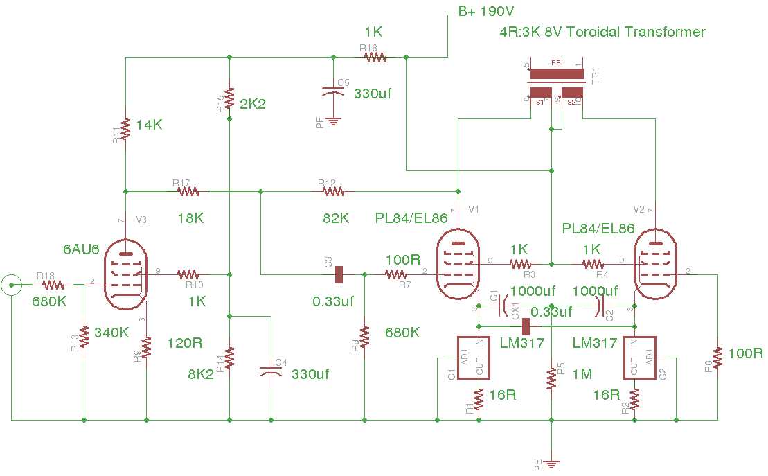

Umm, yes the Zo is halved since both tubes are effectively in parallel compared to a single SE tube.
Don
Hmm, will it?
When the right tube is run in pentode mode it will have a very high Rp compared to the left one which is acting more like a triode with low(ish) Rp.

But when the right tube is current-slaved to the triode, the Zo of the stage
is 1/2 that of the triode alone (and the Po is 2X), assuming equal operating points.
IOW, the slave tube is forced to provide equal signal current swing to the
master tube, and the feedback is from the output (both tubes) to the grid
of the master tube (triode or Schadeode, doesn't matter).
I have validated it through measurement of prototype amplifiers also.

A minor comment on the amplifier anti-triode aspect. To get SE sound out of this thing, the right PL84 output tube should have higher gm than the left one. As it stands, its a self splitting balanced P-P class A "triode" amp. It either needs doubling up the right side tube (and cut DC idle for each) or use a bigger tube or a Mosfet to get to SE sound (.....if that's the goal).
Hey Don,
Did a sim using two 6GW8 models vs. one 6GW8 and one DN2540 and can confirm this. The SE signature is lost using a Schaded pentode together with a pentode. But it still acts like a PP triode.
I did a few mods yesterday. Firstly i took out cap C5, which just confirmed that that was a bad idea as now it has quite a bit of hum. It has at least confirmed that the +B could do with a bit more filtering which I will try.
I then inserted a 18K resistor between the 6AU6 plate and the feedback resistor and coupling cap. I also increased the feedback resistor to 82K. All hint of the harshness has gone now so it was obviously a problem of overloaded driver.
My next steps are to try reversing the polarity of the OT to see if that cleans up the sound a tad. I have decided the easiest way to deal with the excessive gain is to voltage divide down the input - which I will do today.

Hey Don,
Interesting. I suppose the gm nonlinearities of the 2 similar tubes cancel each
other out through the common cathode signal voltage.
Lars, can I get a copy of your .asc to play with this?
Thanks!
Michael
Loftin treatment?? Float both the output pentodes on the CCS.
Thanks. I wasn't sure if you were originally referring to a triode LF topology generating high levels of IM distortion. I hadn't seen that with my 6SN7/801 version. I see now that it was applied to something different.
Sheldon
Its a great idea, but not by itself. Won't do any good until both sides float
the same hum. If grid of pentode on the right remains ground ref'd, hum will
only be aggrivated, exactly as you observed.
If you re-utilize your C5, to bypass G1 of rightmost pentode up to B+ hum...
Now you got a situation where hum can be fully balanced and cancelled.
I may try that, as there is a slight amount of residual clean power supply hum left. At this stage I have things working well and am reluctant to mess about to much as this usually cascades into multiple other problems (you should see it in there - not a lot of room).
I will draw up a revised schematic for completeness sake. After that anyone who wants to place improved versions for discussion would be more than welcome. At the moment the design is still elegantly simple and performing well so I am happy.

So heres the revised and corrected schematic.
Thanks for all the valuable input and I hope the information is of use to some of you.
Shoog

Don't know how things work out, as applied to an amp like this. But, in my regular SE LF, the feedback is at least close to zero. I didn't do careful measurements, but I could hear no difference in volume level when I clipped in or out the connection from output to input cathode.
Sheldon
Yeah, about what I thought. LW's ultrapath dominates over the cathode to
cathode Pfeedback... Can't cancel out input cathode resistor's Nfeedback
this way. Not much different than sampling hum directly from the top rail...
Gonna be even more the case here... With anti-triode as an ultrapath cap
multiplier. The node between output cathodes should closely follow the high
rail hum in terms of a voltage swing. And the input signal in terms of current
swing.
Anyways, CHB shouldn't be necessary once all real triodes are out of the
picture... High plate impedance flips the hum to the high rail, and no need
to do an injection at the cathode.
Not sure if you're talking about a Schadeode here, but if you are, won't the
plate-grid feedback impose equivalent AC current from B+ ripple as the low Ri
of a real triode would?
Remember, your plate to plate Schade network is folding back to the top rail
(assuming C5 wasn't there). And thats why we want to let the entire output
stage float on that same hum...
The output stage cathodes sitting on CCS won't mind...
And its easy enough to bypass the Anti-Triode's grid to that same B+ noise.
To be clear, the Loftin White PSRR treatment only applies if the input stage is
a Triode with low plate impedance. I am suggesting it is more trouble than its
worth to fix the Triode's PSRR probs. A pentode simply works better here.
