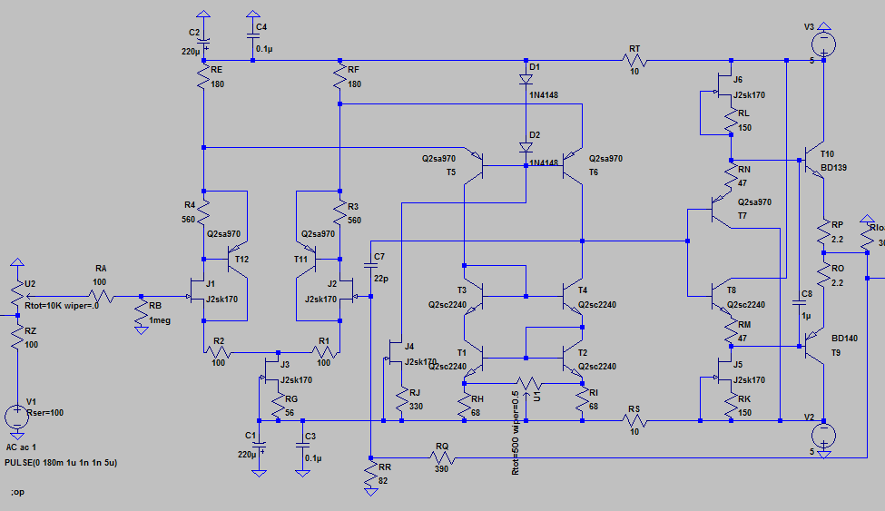

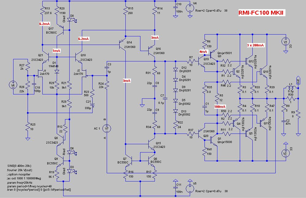

My update lin topology
the dual transistor multiplier allows temperature compensation of the output stage bias currents by monitoring both the pre-driver temperature and the output temperature.
The effect of driver Vbe changes with temperature do not need compensation.
My update amplifier.
Opinions?
the complementary pair are not suitable for driver duty.
They are excellent for VAS duty and for pre-driver duty.
Choose a higher power, higher current pair for driver duty. Try between 20W to 60W AND between 1A to 4A
The 1360 is only 5W and 50mA
