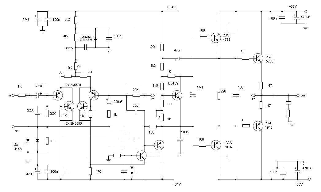

an interesting very low distortion (in sim) design using some of this threads concepts:
http://www.diyaudio.com/forums/solid-state/134604-hi-loop-gain-amp.html#post1680729
In my point of view the schematic in post 26 is fine too

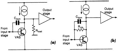

I have tried both VAS circuits.... the two stage unit gave me more bass, more power, more controlled bass.....but i missed the loosen bass i had with the single stage VAS.
I have not tried to load the VAS.... and Hugh told me,once and a long time ago, to give a try on it... a capacitor and a resistance to ground...loading the VAS output... this may change the harmonic spectrum a little.
Those parts can go in series or in parallel...i would prefer series not to disarrange the VAS operating dc current...to load to AC only.

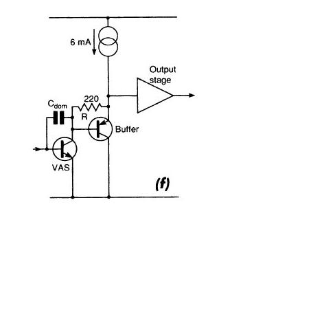

Here VAS + Buffer and buffer +VAS + buffer.
A triple has the same buffering effect. Only 10uA VAS load at 500W / 2R.
By DX - I have not tried to load the VAS
By using a triple , all that is left for a load is one that is passive (r or r/c) , I do use 100k - 220k to passively load my VAS'es and one can tweak the "sound" (purely subjective) by just changing the value. A far larger change to the sound is to cascode the VAS.
OS

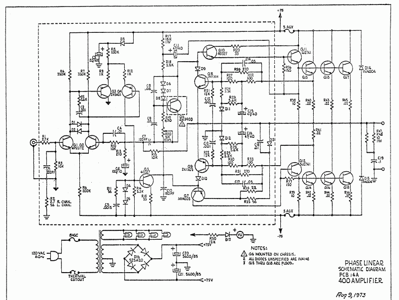

Stevens says of the Phase Linear PL400
"I think the main reason for connecting C11 to the emitter of the driver is that this emitter voltage follows the AC signal on the collector of Q5 much better than the output does, so the voltage across R18 is kept more constant and the collector impedance of Q5 becomes higher and more linear. I think even harmonic distortion is lower because the half wave rectified (class B) non linearity of the voltage across emitter resistors R40, 43, 45 is not fed back."

GErin,
My vote: I like the buffer + VAS, this was where TGM was headed. It allows some interesting options with Cdom and it simulates very nicely. I believe it has the possibility to retain the Bootstrap sound that is key.
I hope you will try the experiment and build this kind of VAS as I have little time these days and have been interested in trying it out for ages
Joined 2009
Hi Bigun.
Thanks for you reply. I have litle time also. I will try your recommendation.
Your vote is: CFP input + buffer - VAS + CFP driver + EF output?
Guillermo
Yes !

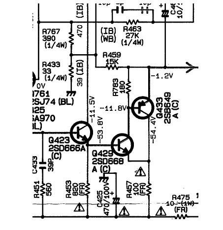

Actually, I'm also quite interested in CFP for the power output, but I have mixed feelings on this and I'm still reading and learning about the use of CFP in the output. My thinking is that CFP is the ultimate configuration but it works better in Class A. By using it for the driver stage you operate it in Class A and get lots of benefits.
