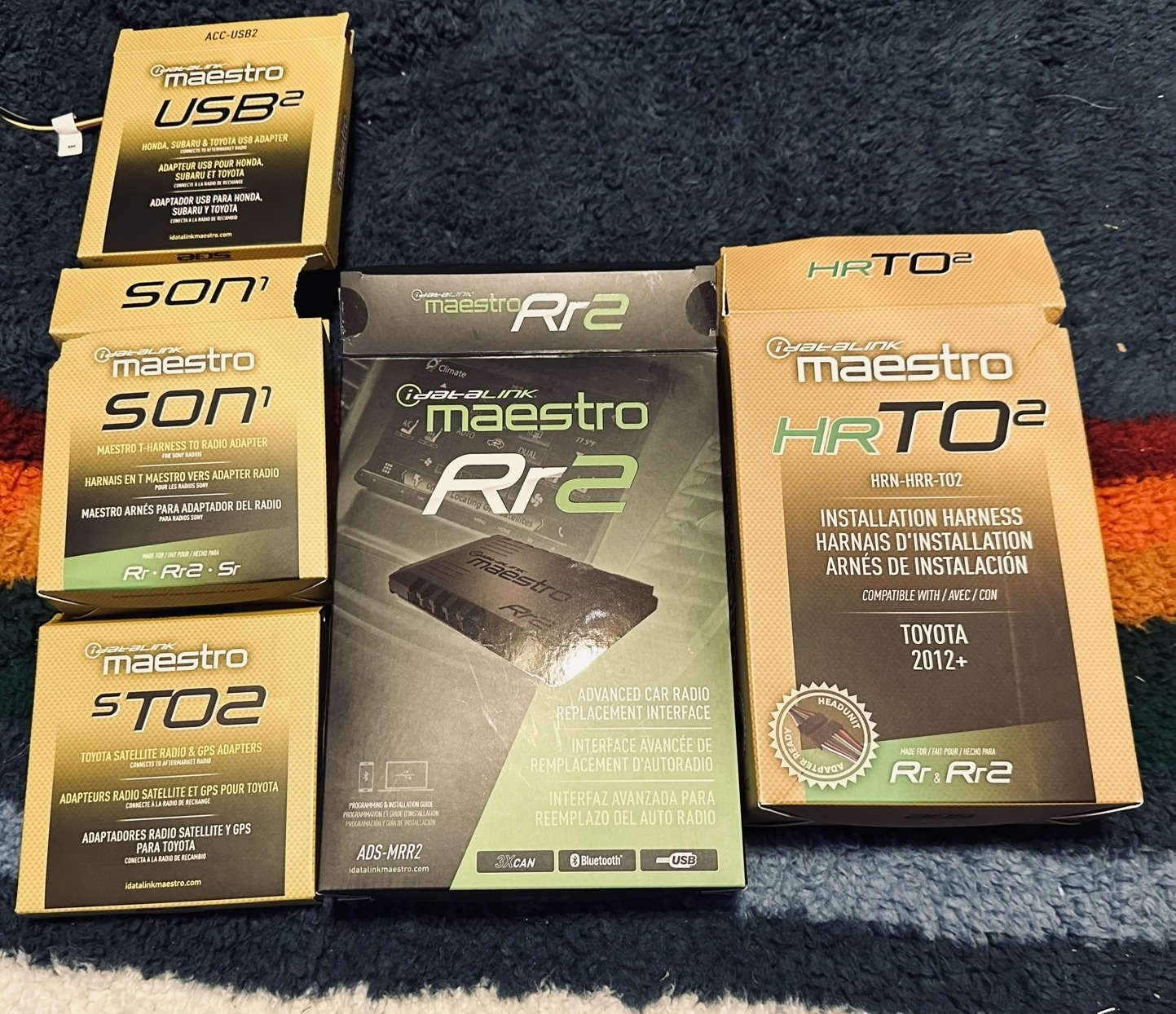

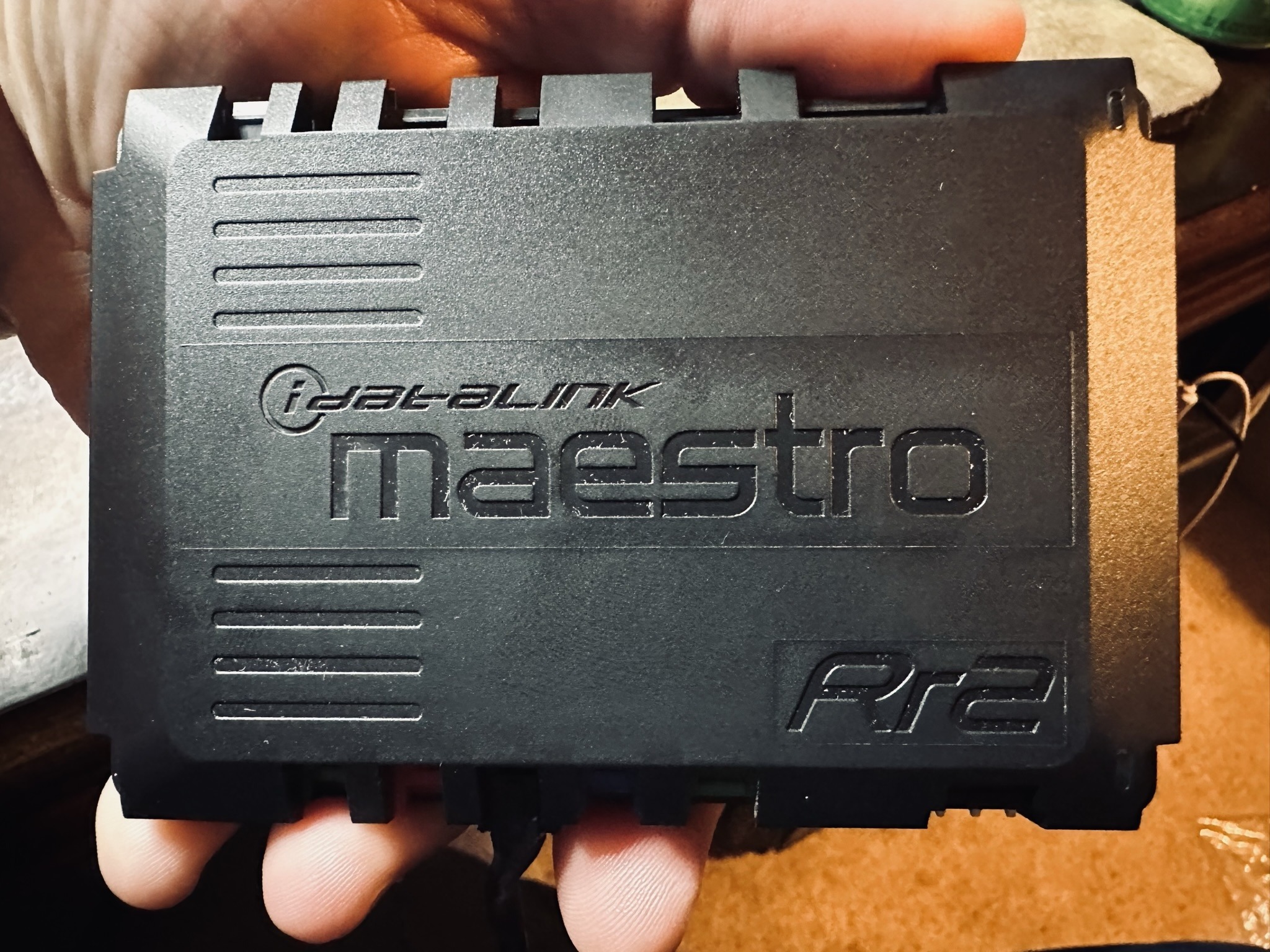

So what about the Maestro RR2 having the ability to program outputs to relays? What is that all about? Are they controlled with the radio? I'm not sure I understand what the deal is with that.

That's the way I have them set up. There are three outputs on the RR2 Module that can be programmed to send a signal, latch a signal, or pulse the signal with the ability to set the time on the pulse. Since the Tundra doesn't have enough room to add aditional switches for everything I wanted to control, this was a solution. Basically you go to the screen in Kenwood that controls the outputs, the outputs latch on the relay signal input, and the relay handles the heavy load to turn on the back work lights, or turn on the compressor, or the radar detector.
This is from Crutchfield's site:
Command center​
The ADS-MRR2 features three programmable outputs which allow you to control relay-driven aftermarket accessories from an iDatalink Serial Port-compatible Kenwood, JVC, Alpine, Sony, or Pioneer in-dash receiver. These outputs can be individually configured to Latch, Toggle, Follow a CAN signal in the car (firmware dependent), or have a custom output configuration, as well as setting Delay On and Delay Off times for each output. You can also assign a steering wheel control button from the vehicle to control one of these outputs. The ADS-MRR2 also features a dedicated port for radar detector integration that allows you to connect to select Escort radar detectors (sold separately).
And here is a clip explaining how it works.
www.youtube.com/watch?v=GKZ5cr5Gymw
The Sony unit is able to perform this with the RR2 attached also. What's really nice about it is each output (3) can also be programmed to the steering wheel buttons allowing you to control each of the outputs with the steering wheel or the head unit.

Okay. Thanks for the info. I didn't know anything about that. I just ran a switch to some LED lights that I have mounted in an aftermarket bumper that I installed a while back. Finding a space to install the switch was certainly limited. I want to install some bed lighting pretty soon so that is a feature that might come in handy. Most people just splice into the interior lights that come on when the door is opened but I want to be able to turn on the lights without having to open the door so maybe that will work.

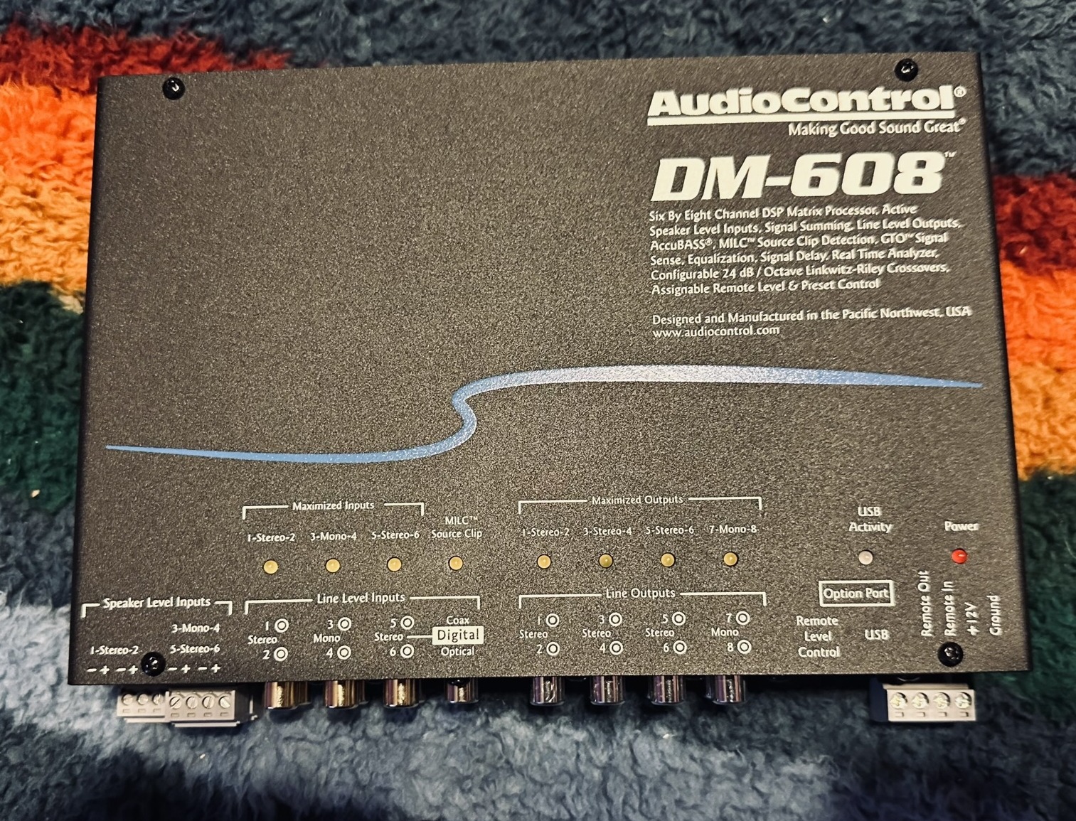

I've also decided to change the DSP unit out. I'm replacing the little Dayton Audio for a Audio Control DM-608 with 6 in and 8 out DSP Matrix Processor that I also picked up off of Ebay for $380.00 new open box. So I got a good deal on this as well. This should all be arriving by Friday and Saturday.

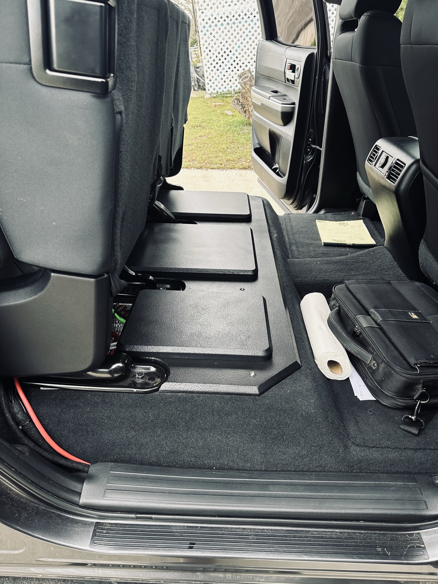

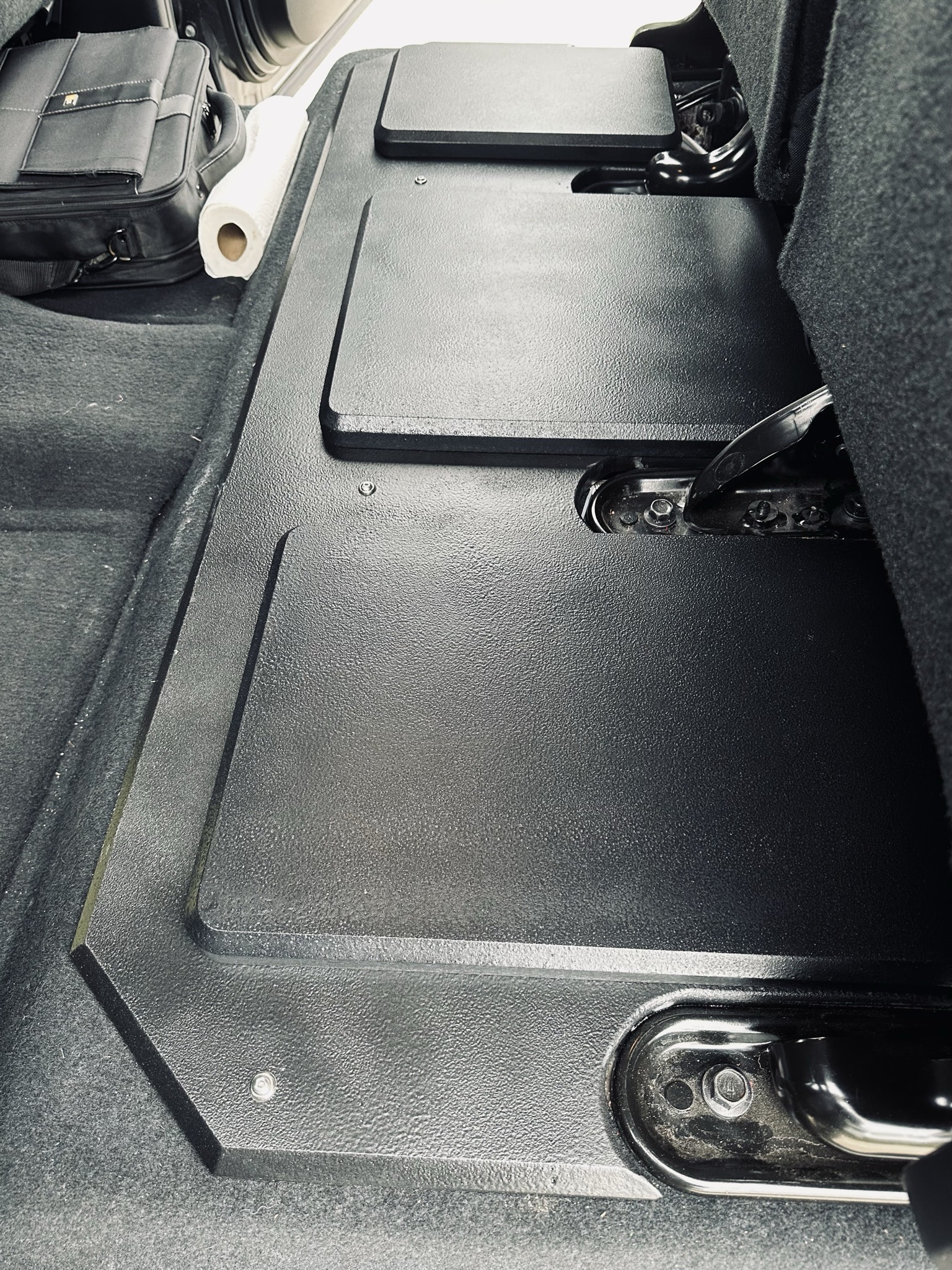

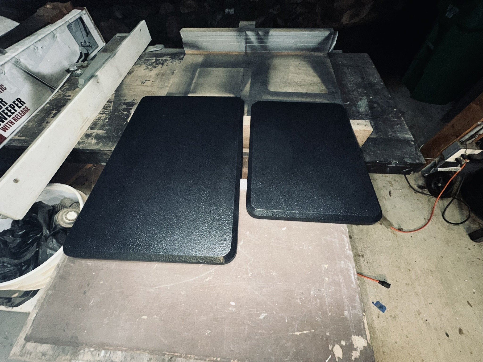

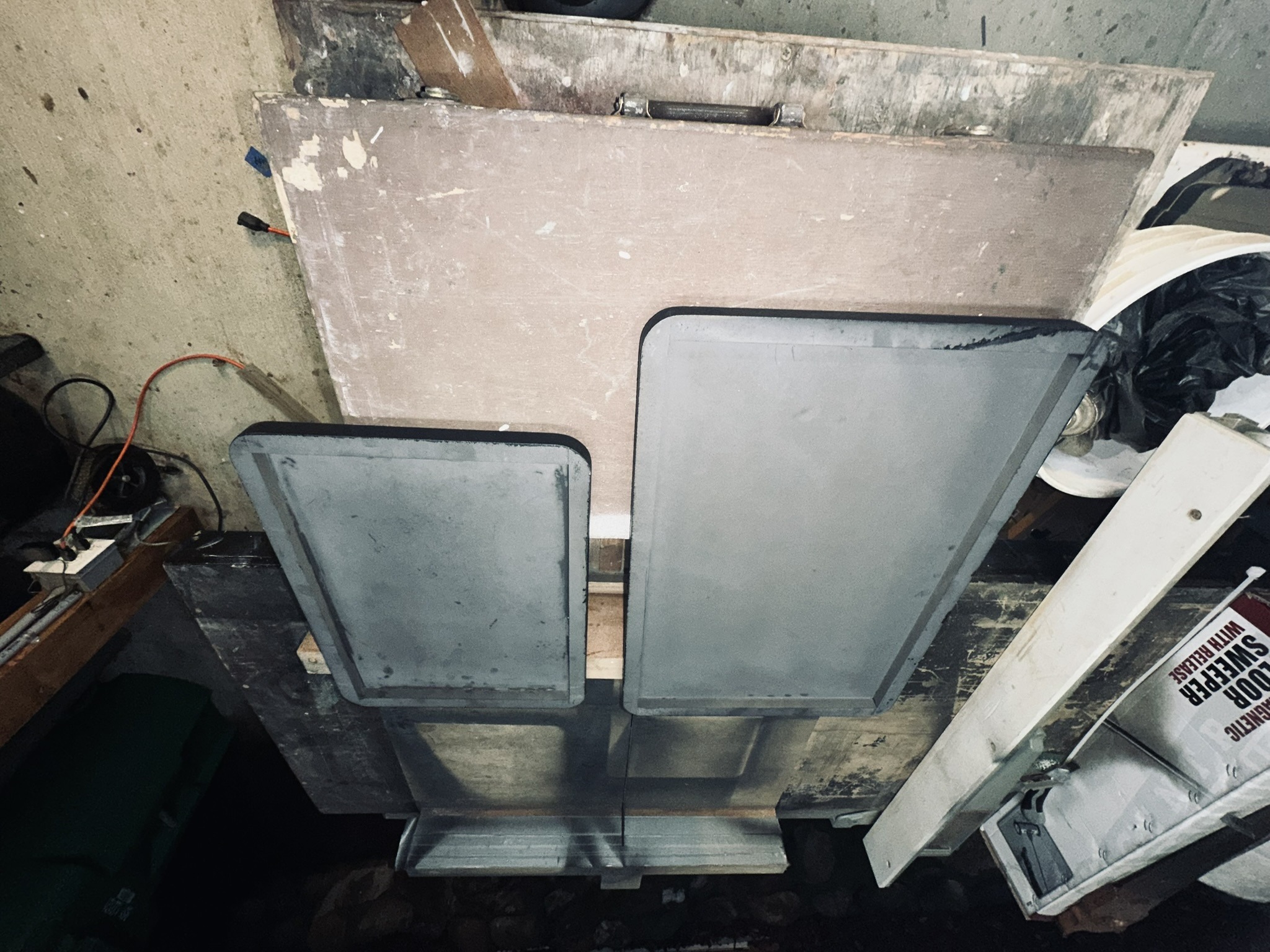

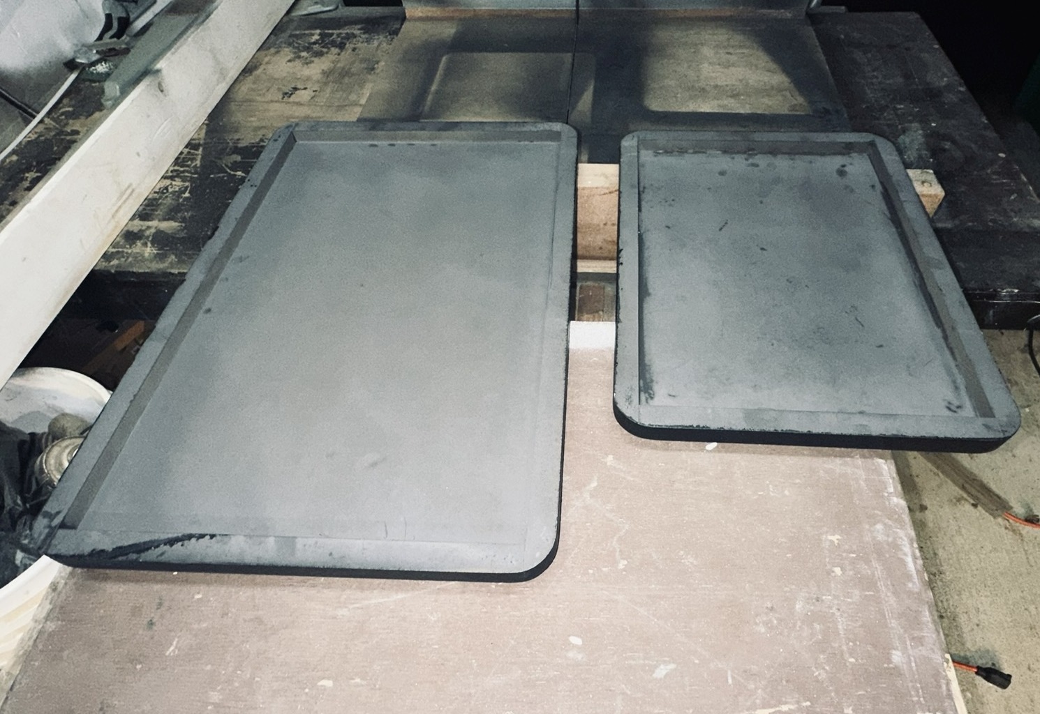

So I had a few things left to button up still on the install besides the head unit such as covers for the "amp wells" I guess you can call them. So I made those.
I still need to get some inserts or "T" nuts and some stainless steal machine screws to attach the covers but that is what it will look like when its done. I still have to tuck those wires under the carpet there so you don't see them as well. I will probably do that in the morning.
I have to say that for the fact that the subs are in such a small sealed box I wasn't really expecting to get the sub extension that I am getting right now. Those two shallow mount 12's are putting out a pretty decent amount of base and they are playing pretty low too. Granted if they where in an optimal ported enclosure I think they would really shine but I'm more then happy with the way they are performing right now. I'm really impressed by them to be honest. They are 4ohm DVC so the two of them running parallel are running at 1ohm which drives about a thousand watts out of that JP8 class D amp I've got them hooked up to and after driving them hard for over an hour playing some pretty base heavy material neither the amp or the subs peeked much above 85 degrease F. Barley warm to the touch. So I would say that I am equally impressed with the Down4Sound amplifiers that I chose to use. I took a chance with a brand that I had never used before and so far they are delivering. I can't wait to get the Sony and the Audio Control put into the system so I can finally break out the microphone and the RTA start doing some tuning. Once that happens I will do a break down of the different components of the system and do a review on each one.

The covers look good. What are the snaps for?

You may want to use a fastener (like the two-piece ball and socket connectors used for speaker grills) that will allow you to quickly remove the covers. in case one amp fails or there is another problem. Even with fuses, amplifiers can flame up when they fail.
I didn't see any fan cooling. Even class D amplifiers can run hot. Centrifugal fans are low-profile and can move a lot of air.

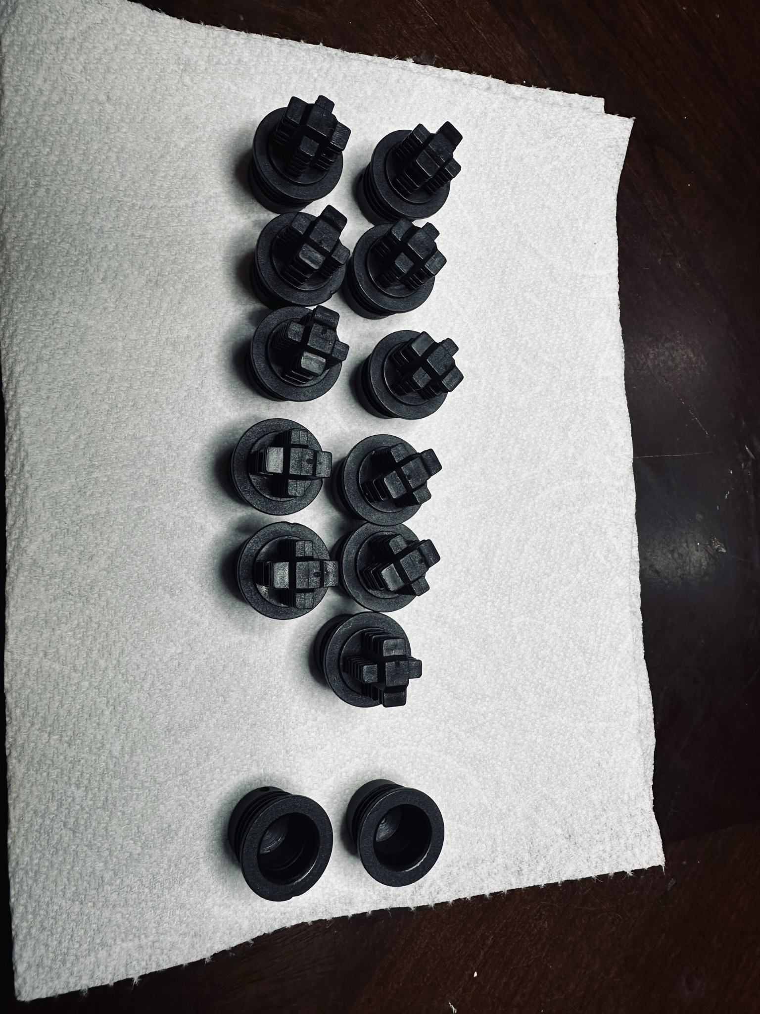

Thanks. Snaps? Oh those aren't snaps. Those are a dish shaped washer (commonly used in marine applications) with a machine head screw. I drilled and tapped the steal channel that the seats are mounted to so I could secure everything down.
1000 watts is just right for the subs. They won't use it all. The subs are rated at 450 watts I think x 2 and I always like to have a little headroom. Due to the small air volume in the sealed sub box you need to have a lot of power going to them to get strong low base output.
Those attachments for holding speaker grills on speakers is actually a pretty good idea. I hadn't even considered that. I think I might just do that. Thanks for the suggestion.
As for fans, they won't be needed. I put the system through a pretty hard torcher test a couple days ago. I ran it for about an hour and a half at about 80% output with the covers in place. The tracks I was playing where pretty base heavy and compressed (loud). I was trying to put the system through the trials to make sure it would be bullet proof. After playing hard for an hour and a half nothing even broke 85 degrease F. The amps never got hot nor did the speakers.

The Audio Control DM-608 DSP. With this DSP I will gain more control of the sound then I am currently getting with the Dayton Audio unit. Plus this one will be completely silent where as the Dayton not so much and it is just a better DSP all together. The Sony has some pretty high end DSP capabilities built into the head unit but it has limited channels otherwise I could just use it.
The idatalink Maestro RR2. Unlike the Android radio that I'm replacing the Sony needs an external module to communicate with the trucks CAN bus so I can retain the functionality and features that are part of the stock radio such as steering wheel controls. This particular version being the RR2 as opposed to the original RR has three programable assignments that can be used to switch up to three external devices such as fog lights or winches. These can be assigned to any one of the steering wheel buttons or buttons on the radio and they can also be triggered by any number of other things such as turning on your head lights or shifting into a gear such as reverse. There isn't much room on the Tundra's dash to accommodate toggle switches so this can be a very useful feature.
Here are all of the different harnesses and adaptors that I takes to hook up the Maestro to the Sony and the Tundra. Figuring out everything I needed was kind of a pain in the butt because their web site doesn't explain things very well. They will list three different harnesses that are compatible with my truck but won't tell you anything about them or the differences between them. You have to really dig around to find that info. I found most of it over on their forum reading through the different threads. But I figured it out.

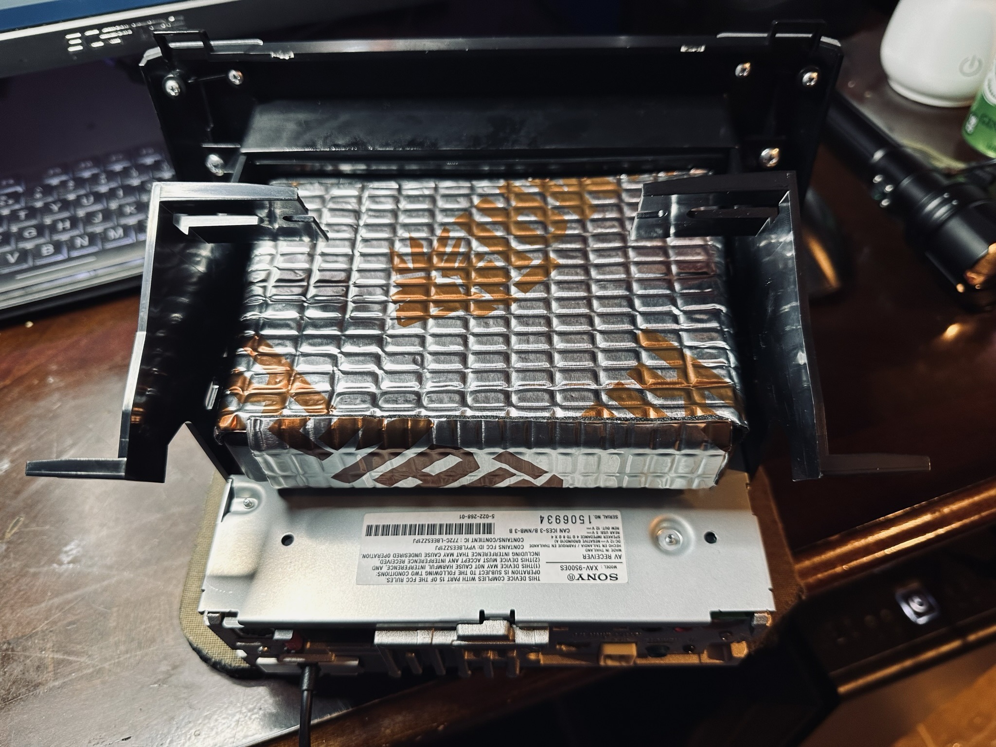

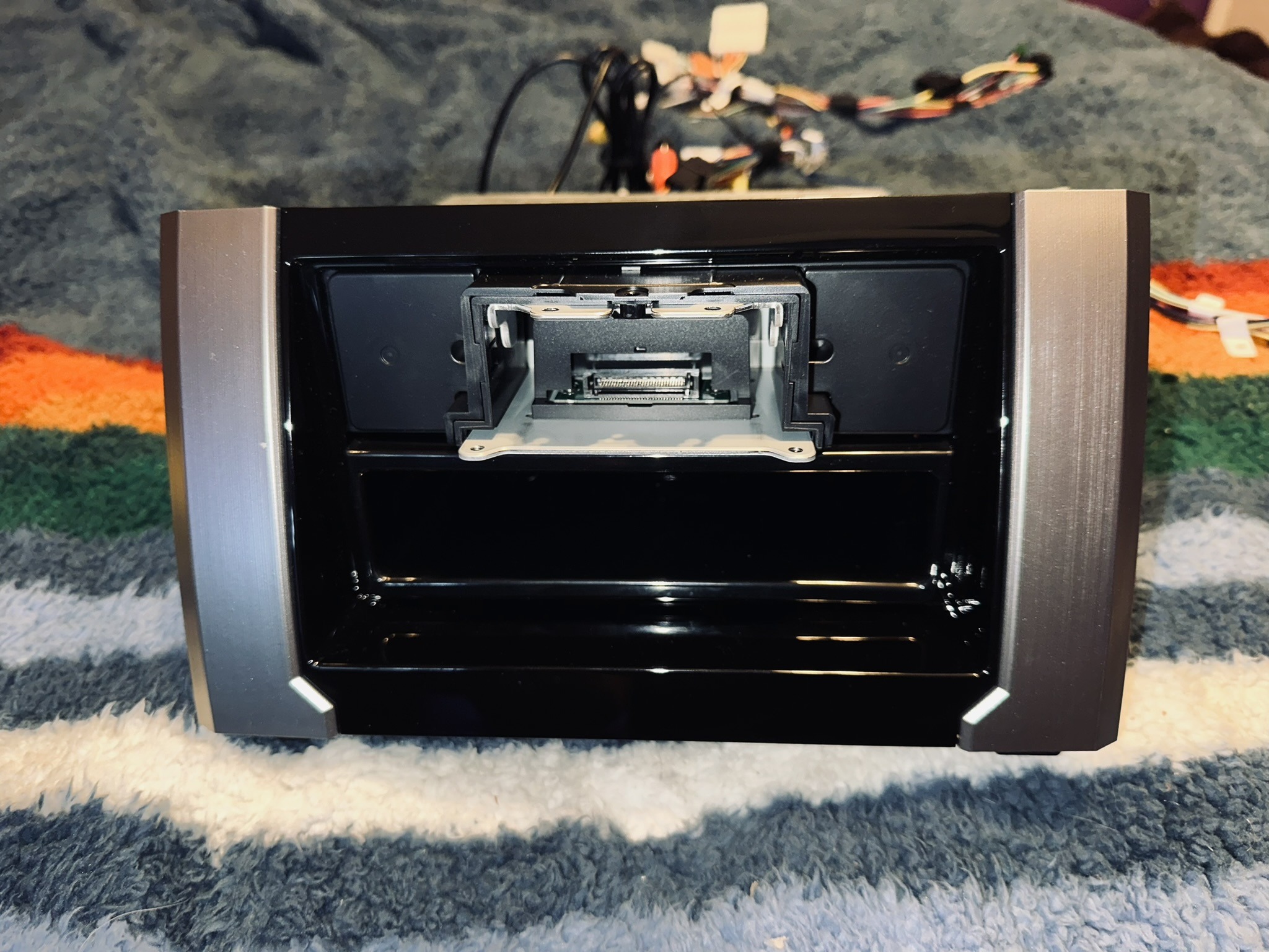

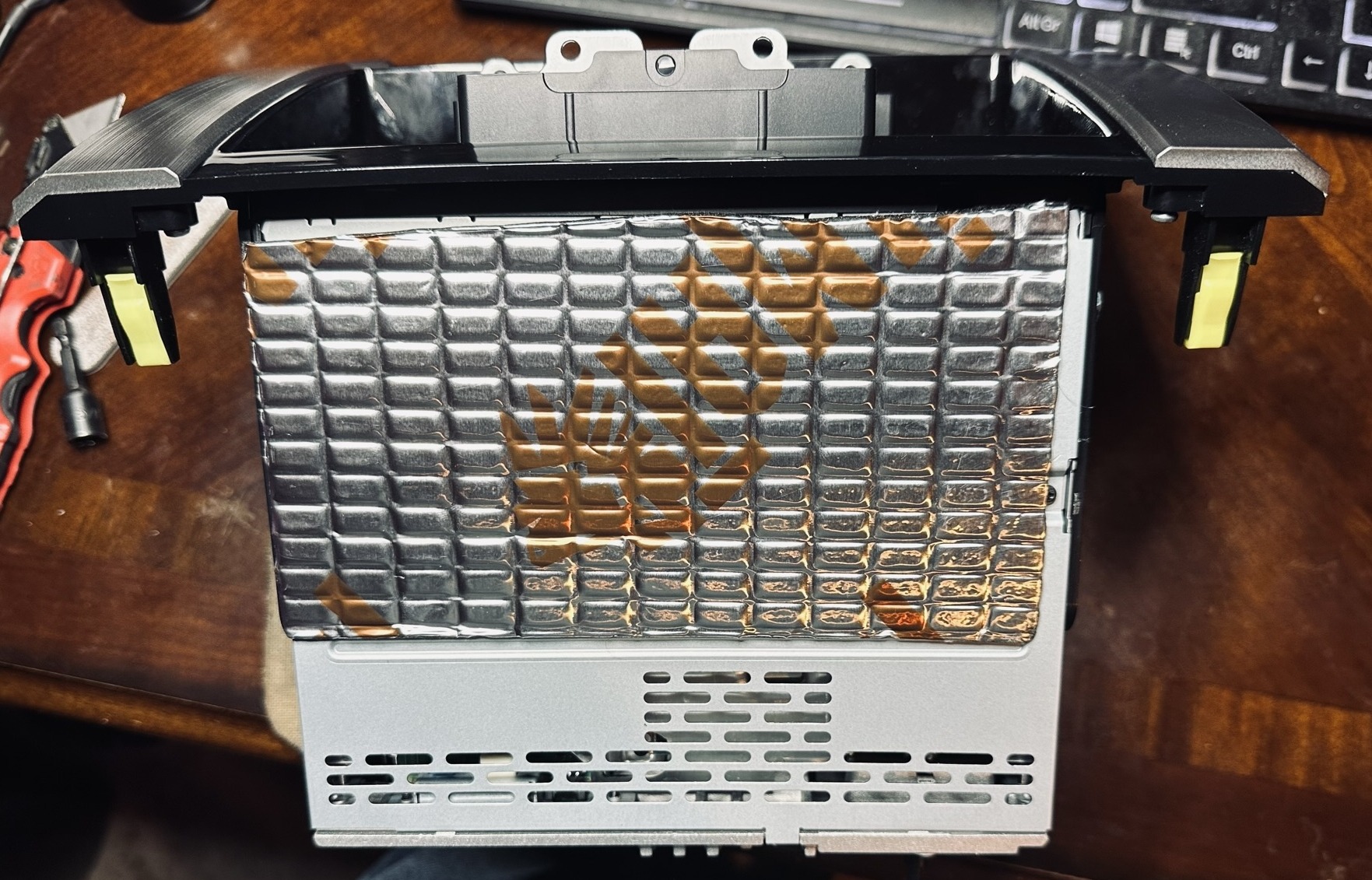

This is the head unit without the screen attached mounted in the Metra 99-8252 dash kit for the Tundra 2014 thru 2021. It can be used to mount single and double din radios. It looks decent but it is a bit plasticy.
To make sure that the dash kit doesn't rattle I applied some killmat to it. It's much better now.
So that's what I got to replace the Android unit and hopefully get rid of the unbearable noise that made the Android unacceptable. I took some video of the noise coming from the unit to show Phoenix Automotive what the problem I was having sounded like. Maybe later I will upload them to youtube and post the links here so everyone can hear how bad it was. That radio goes back today. It's all boxed up and ready to go. I just need to take it to UPS.
I also picked me up some of these to attach the covers on the amp bays. Should work nicely but they sent me to many of the female ones and shorted me a male so I'm going to need to get more because I'm short one set this way.
