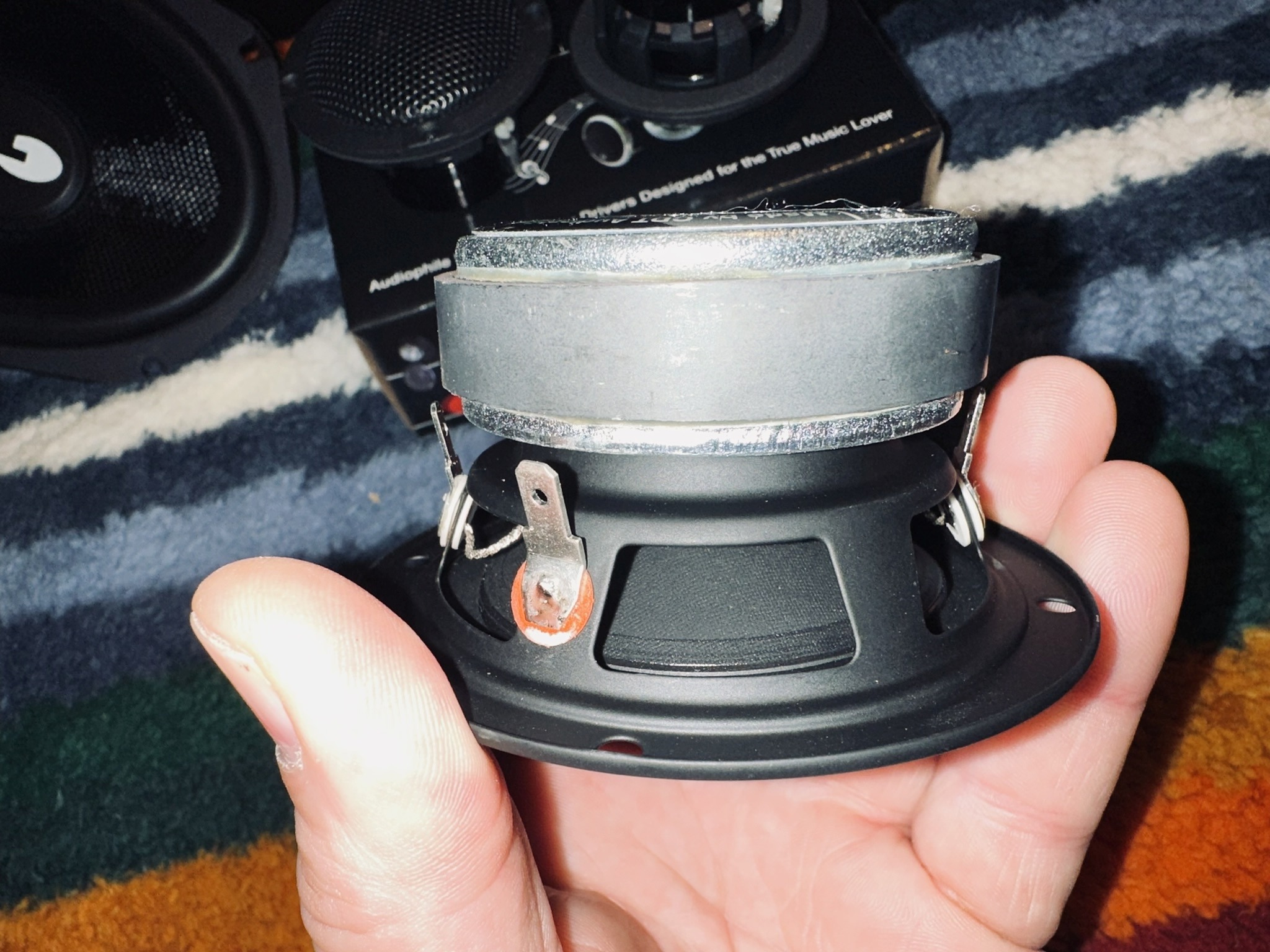

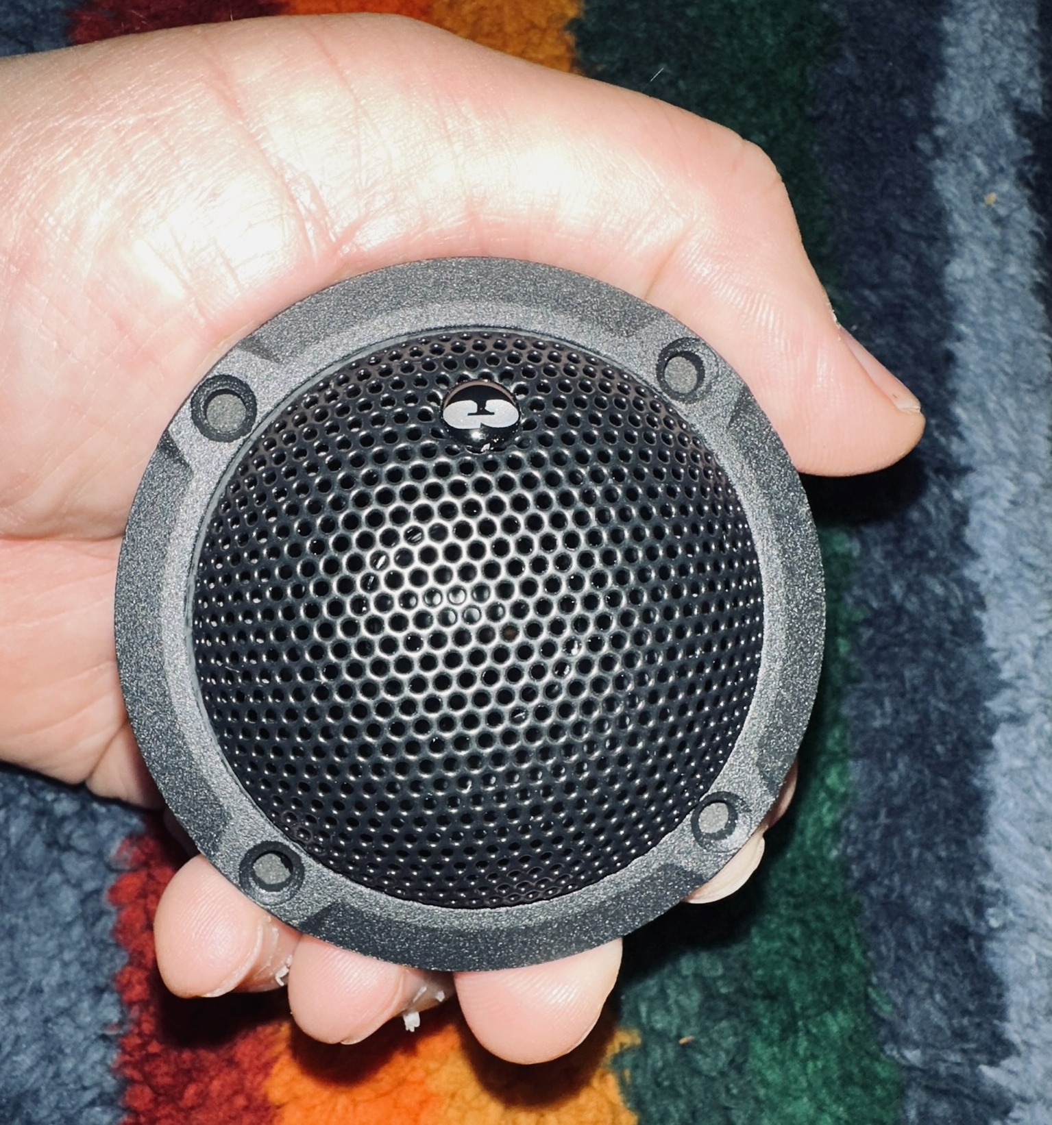

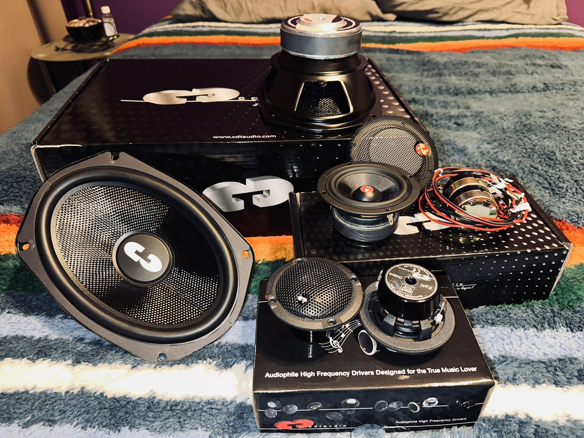

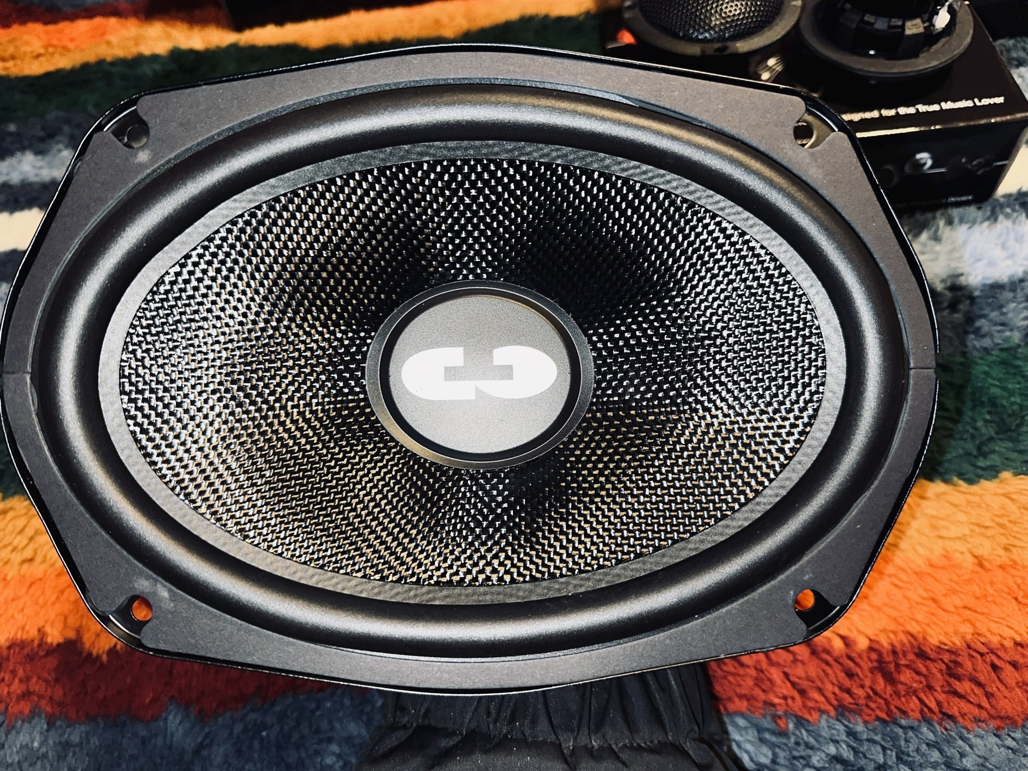

I will be starting a system install today. I have been acquiring the components for it over the past couple of months now and I finally have what I need to start the install and the rest will be coming today or Monday.
There will be some tricky parts to this install especially with the subs since there is little room for them. I'm debating whether I should cram a narrow wedge box behind the rear seats like so many other Tundra installs I have seen on youtube that leave the subs pressed right up against the back of the seat or do a more serious involved custom install that requires me to cut into the factory installed foam floor riser under the rear seats and use fiberglass to build boxes for the subs between the raised mounting sections of the trucks floor. This would give me upward firing subs under the rear seats that won't be smashed right up against the seat but it will require quite a bit more work and it forever alters the "stockness" of the truck. The subs I have chosen for this install are two JL Audio 12TW3 shallow mount drivers. These are some very nice drivers and are nothing like what I expected from a shallow mount driver. These things are going to bump. They should be quite musical too as JL Audio gear is always top notch and that is the reason I went with them. I hadn't heard any of the many different manufactures shallow mount subs before so i have no idea how any of them sound but I do know how JL Audio subs in general sound so I figured if I'm going to pull the trigger on something as expensive as subs I better have a general understanding of how they are going to sound before buying them so I went with what I know. At this point I'm leaning toward installing them in the floor but that might change.
My goal for today is to get the back seats out and start applying the sound deadener to the rear wall and possibly the rear doors as well. I have some very nice set of CDT ES-6CX coaxial drivers coming today or Monday for the rear doors plus I will likely put a small tweeter up in the door panels where there is one now as part of the stock system.
If anyone else has installed a system in a second gen Tundra I'd like to hear what you have to say on the subject. I'll update this as I progress with pics.
