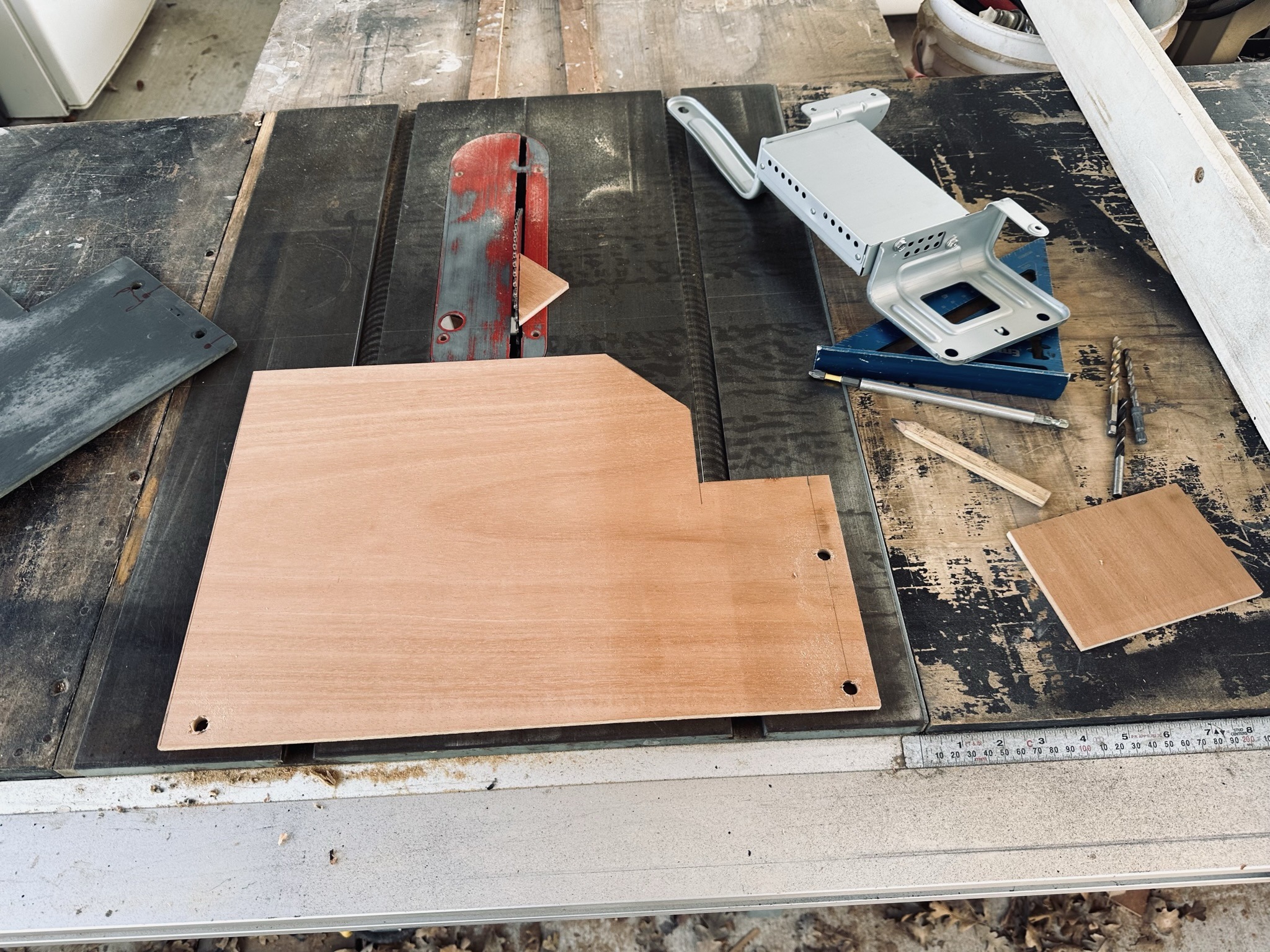

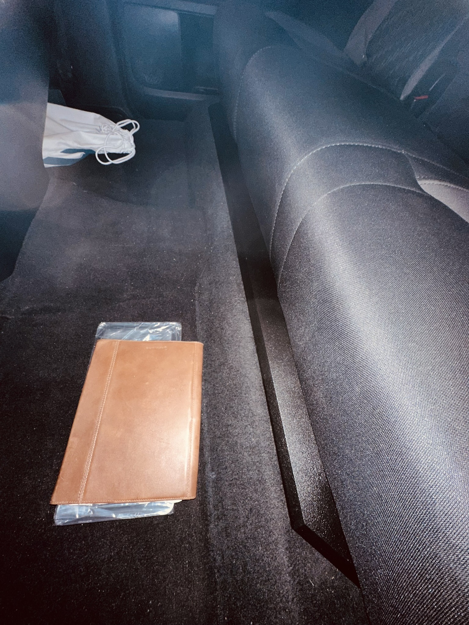

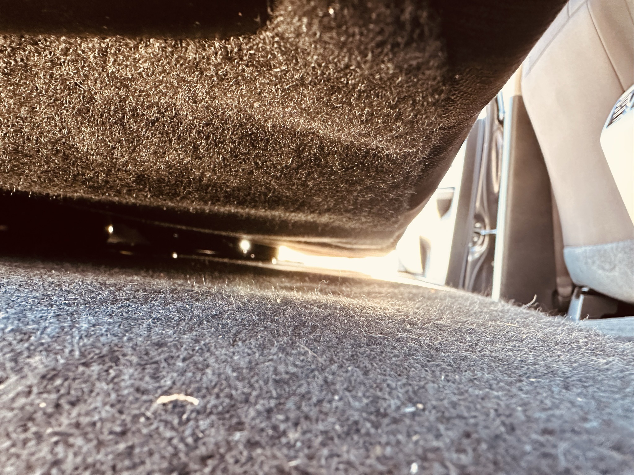

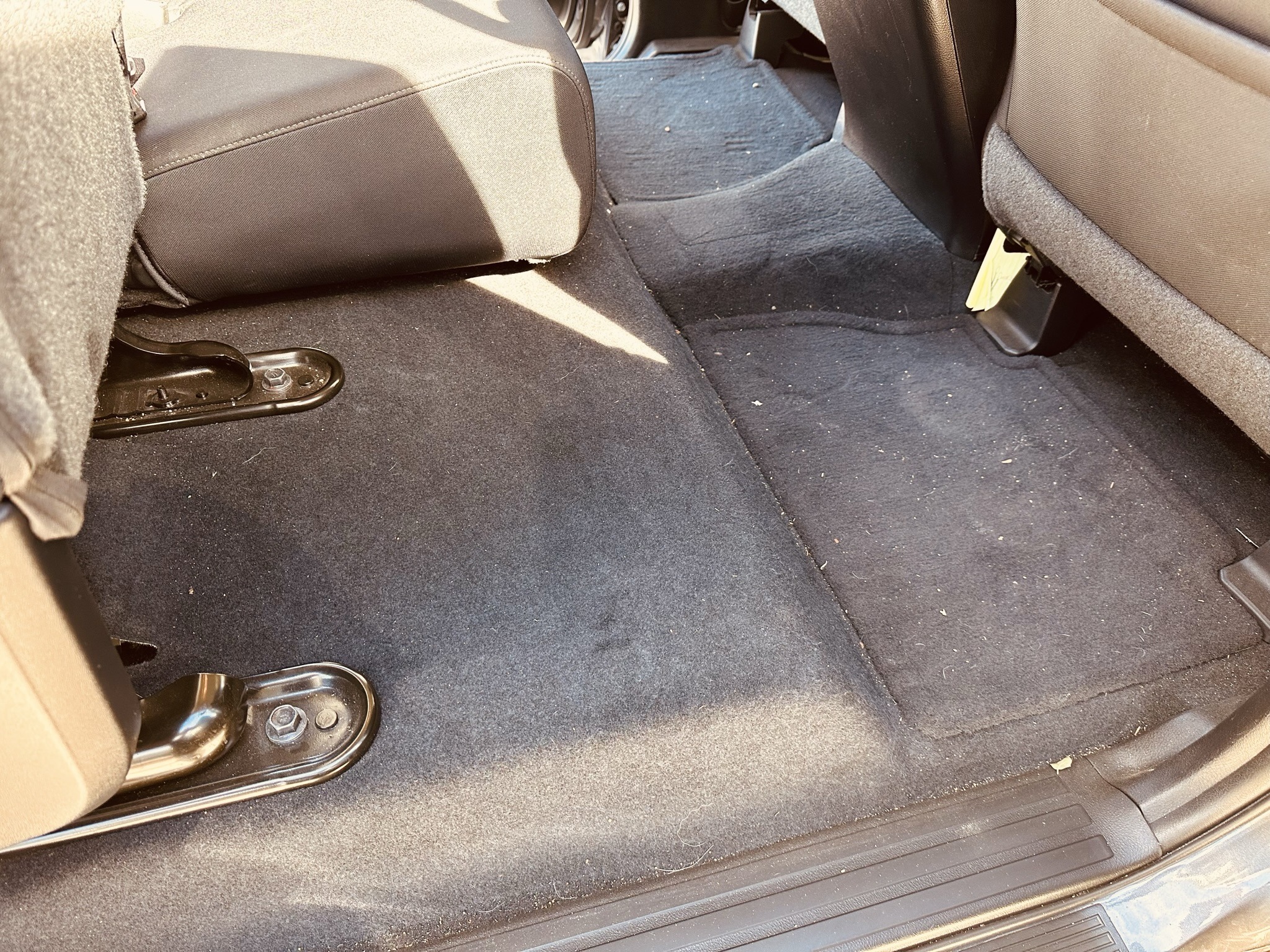

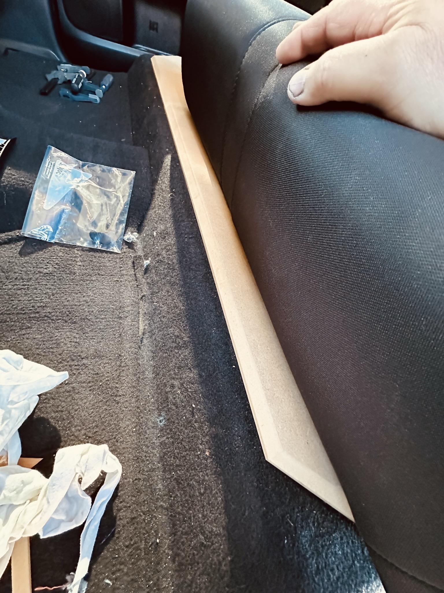

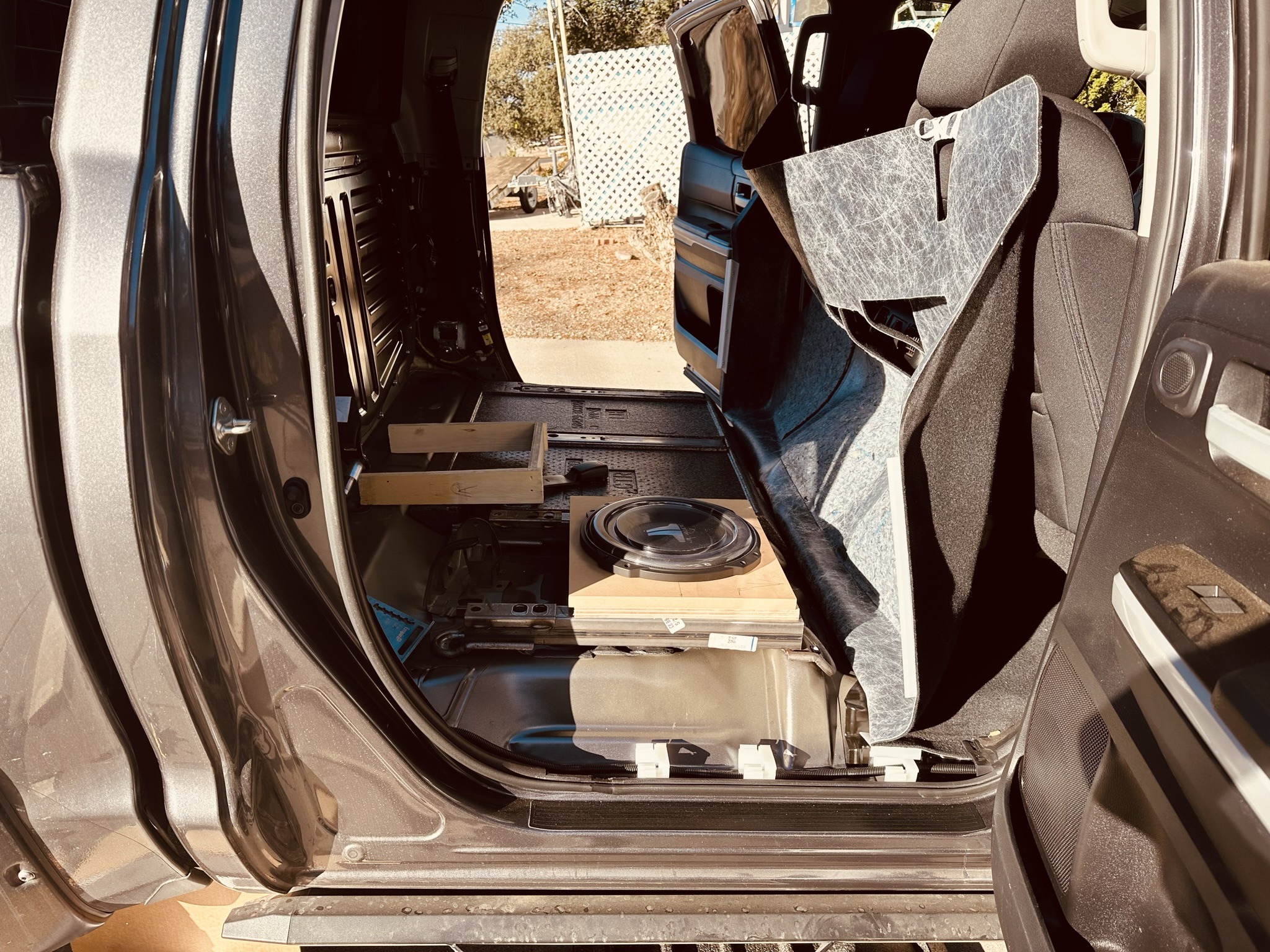

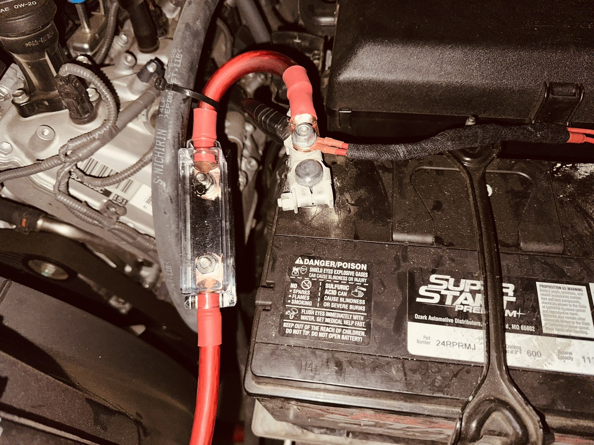

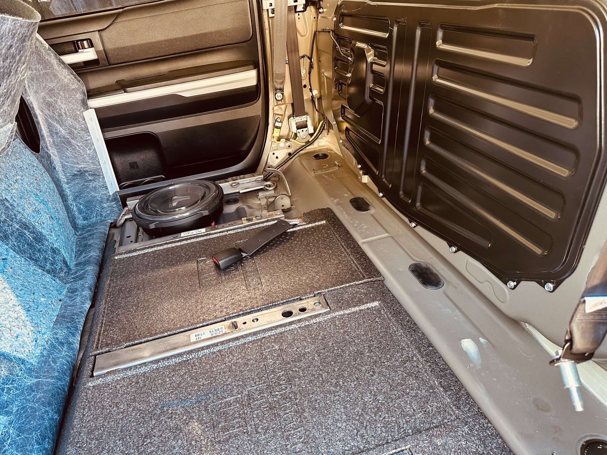

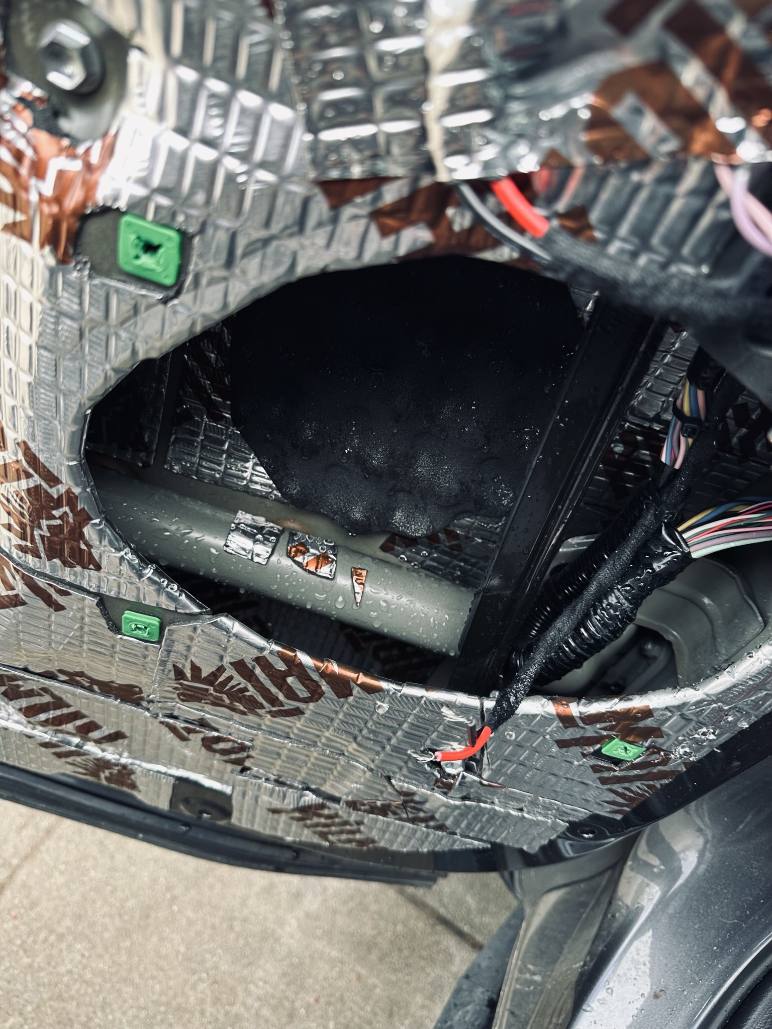

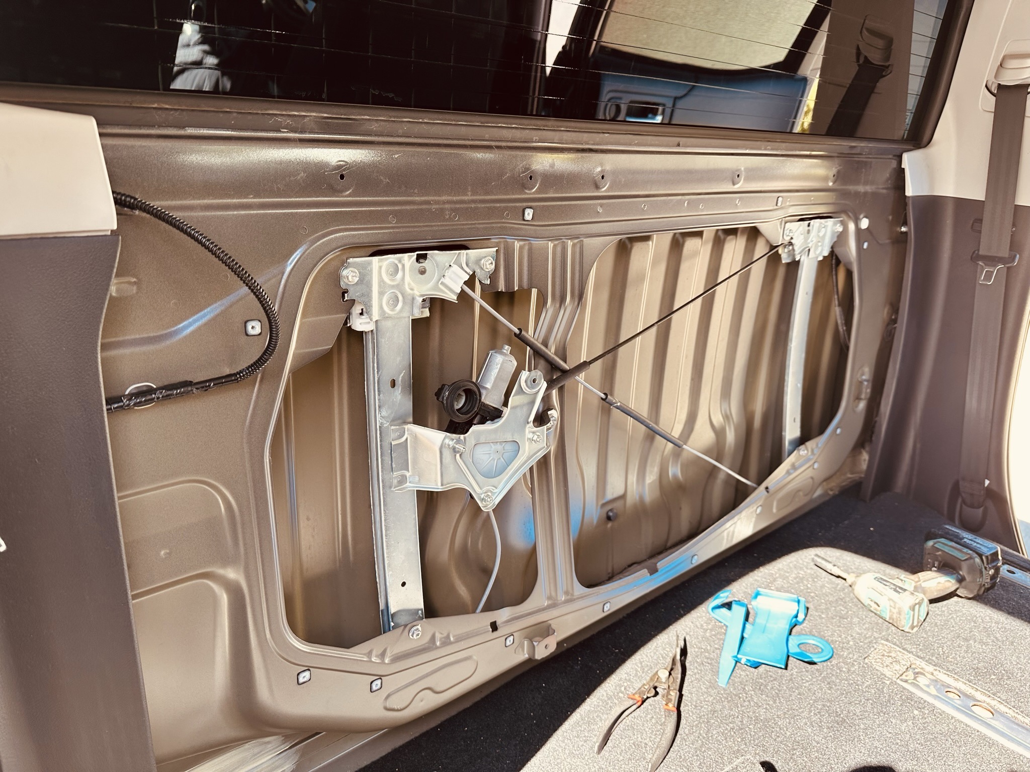

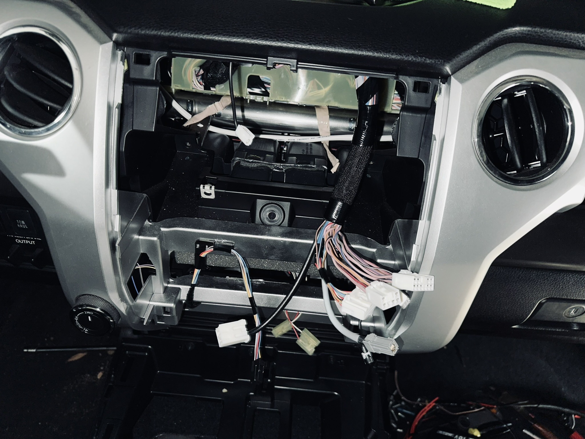

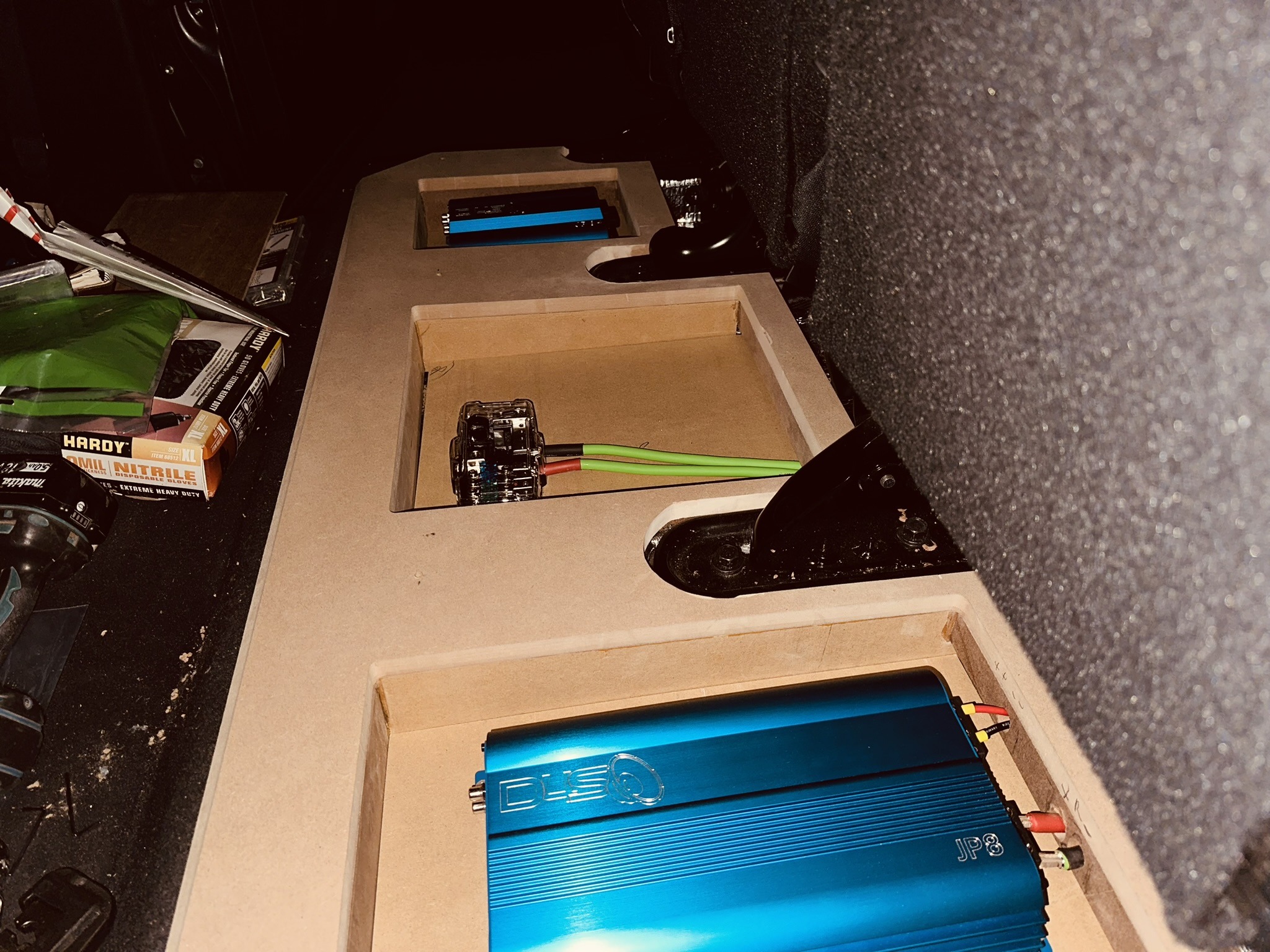

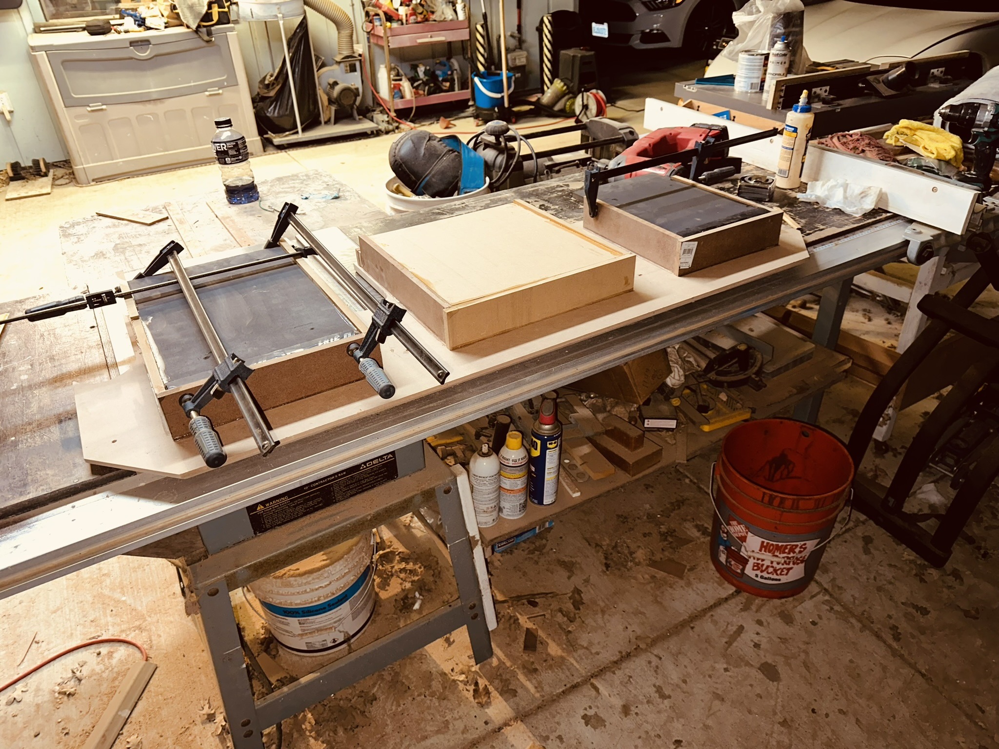

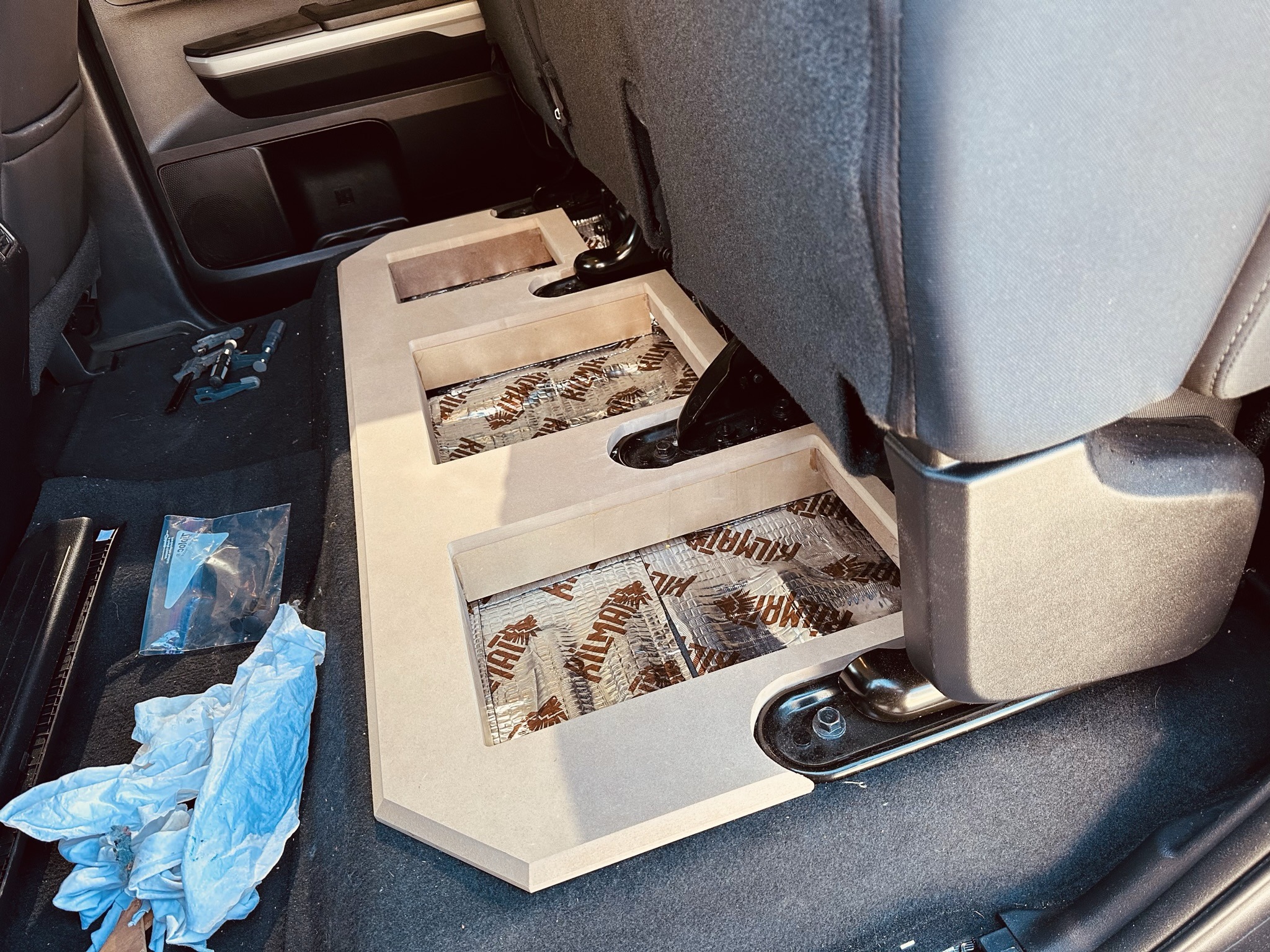

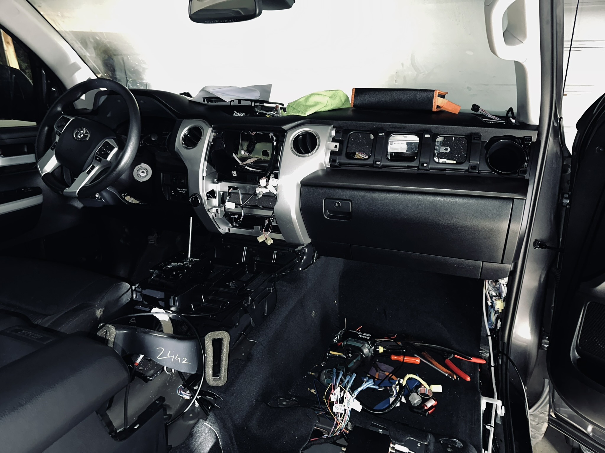

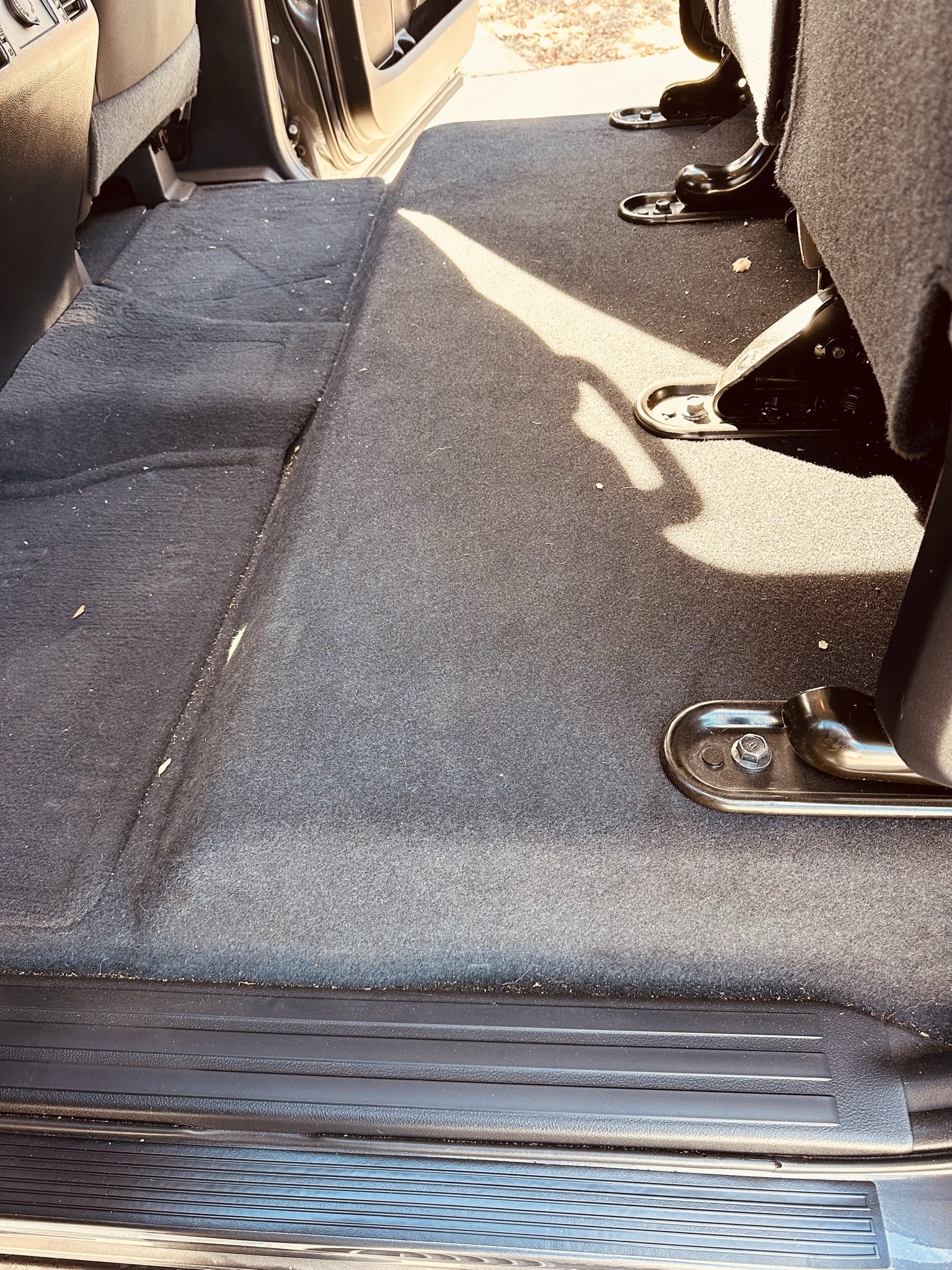

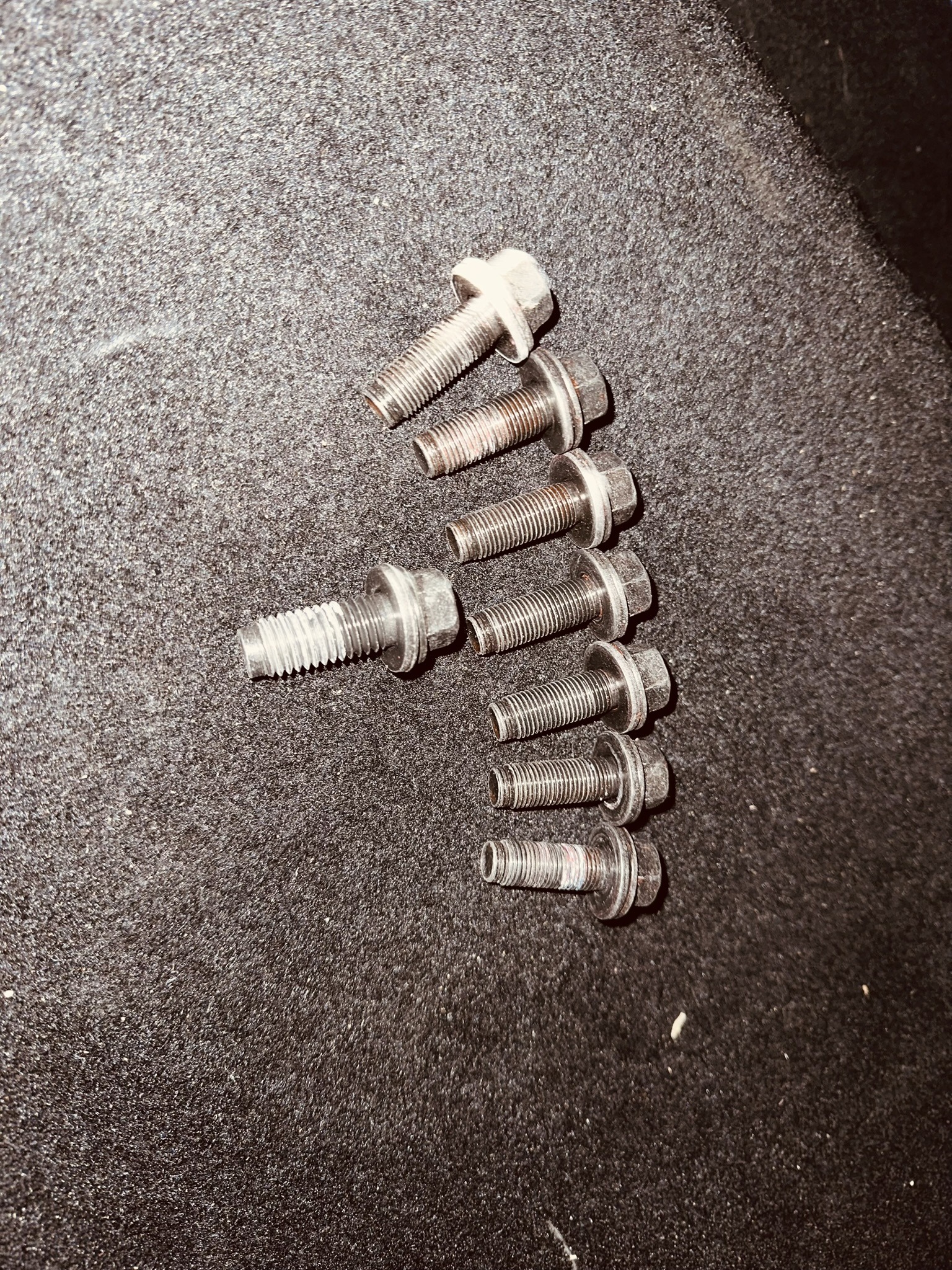

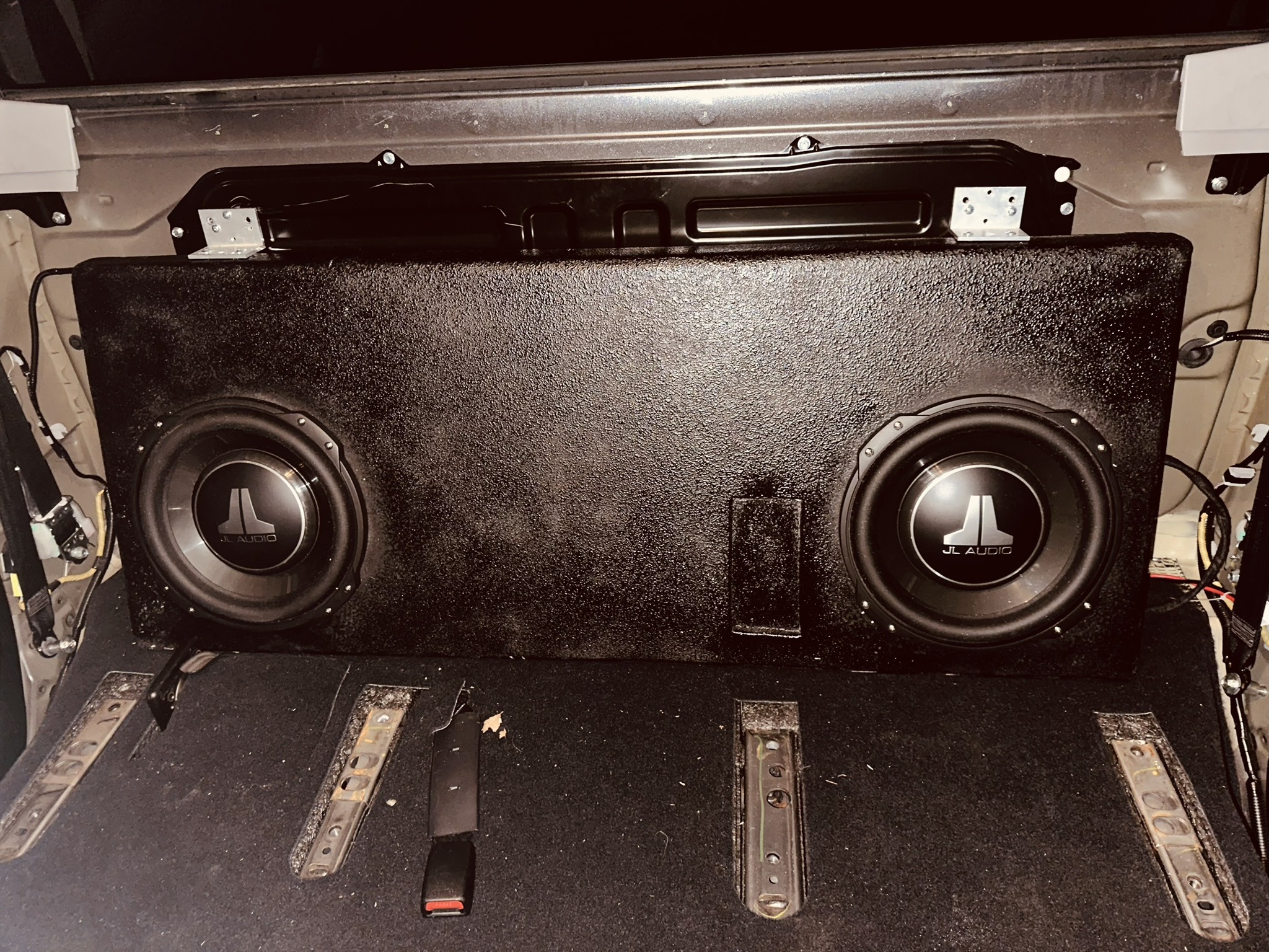

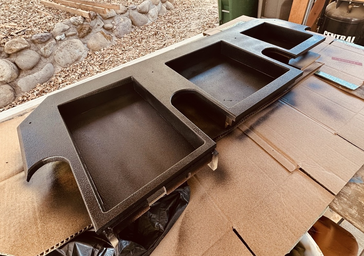

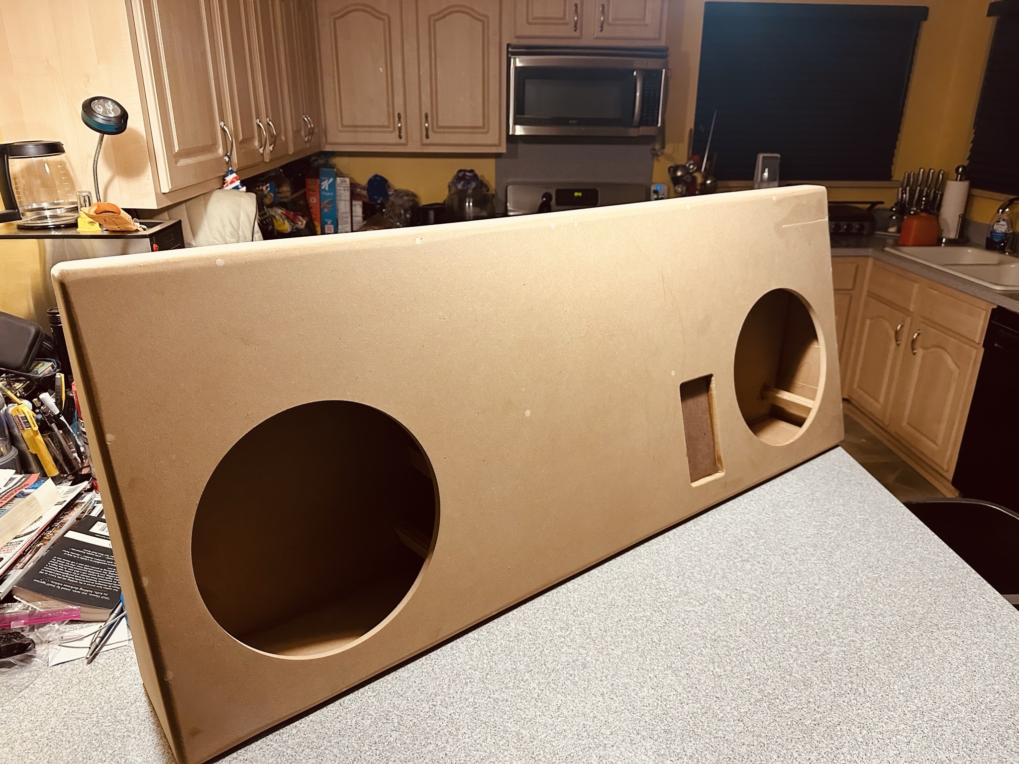

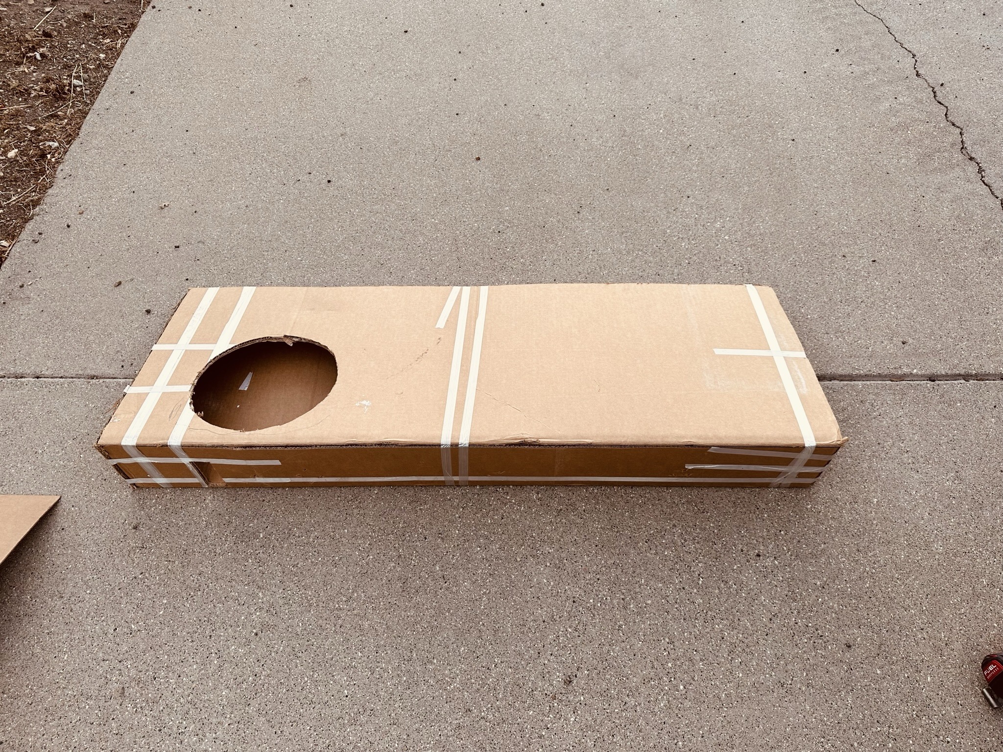

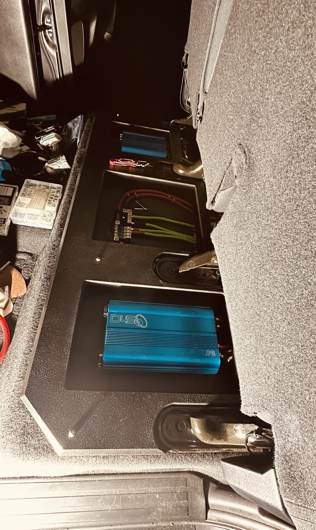

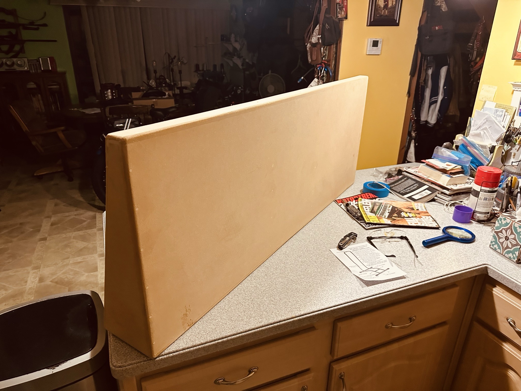

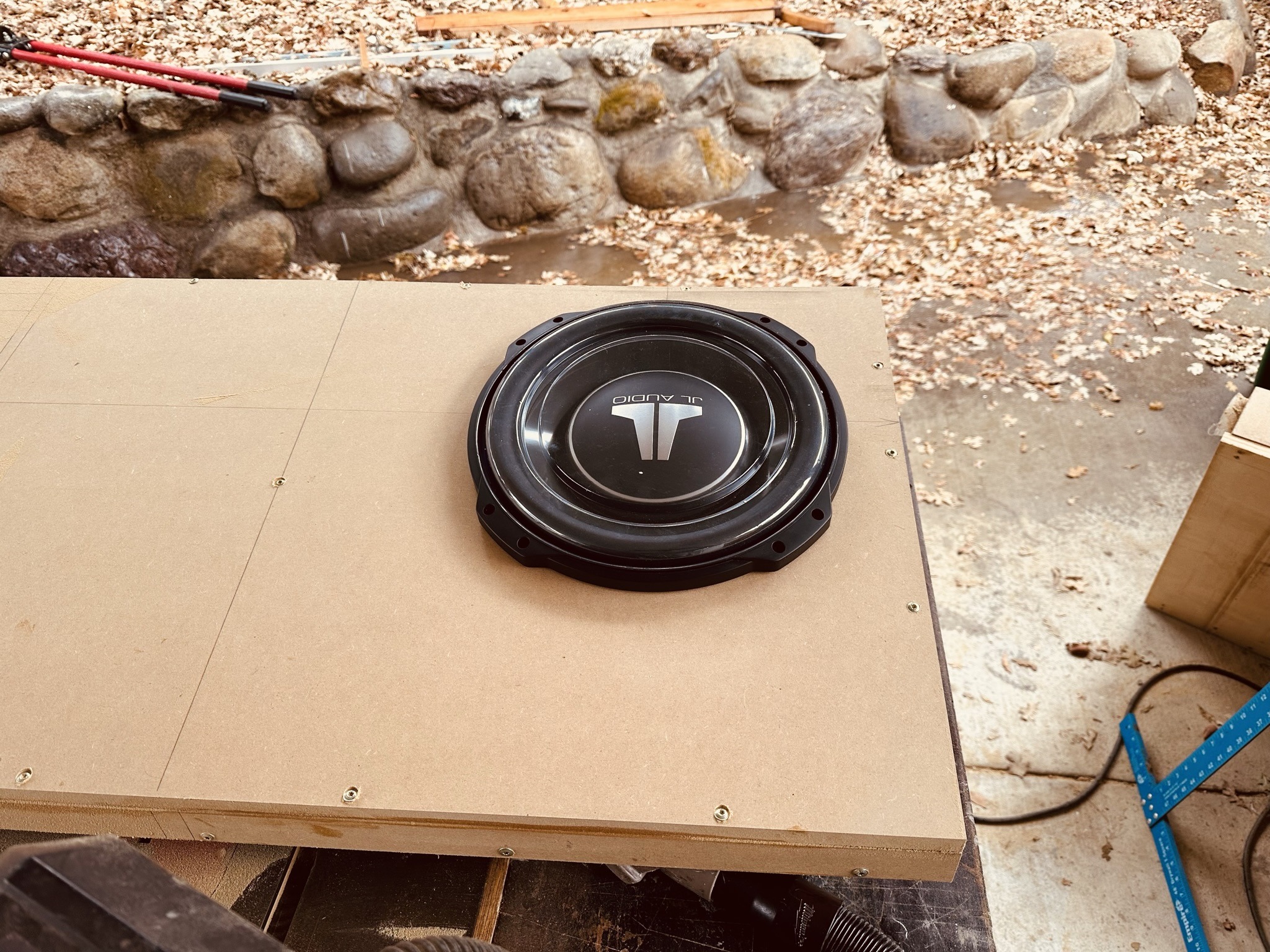

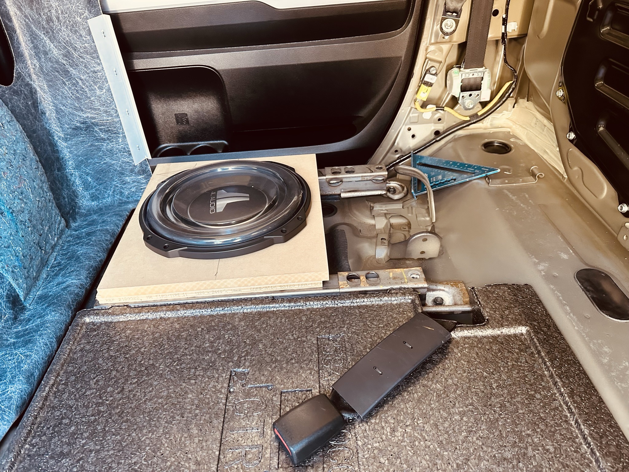

I will be starting a system install today. I have been acquiring the components for it over the past couple of months now and I finally have what I need to start the install and the rest will be coming today or Monday.

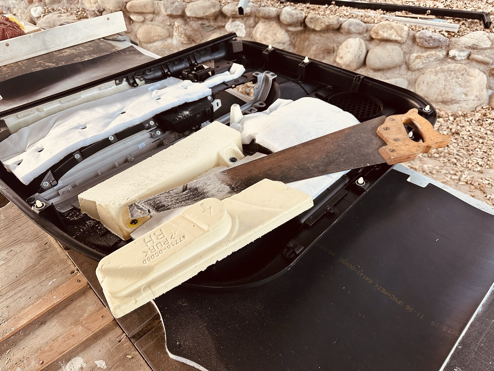

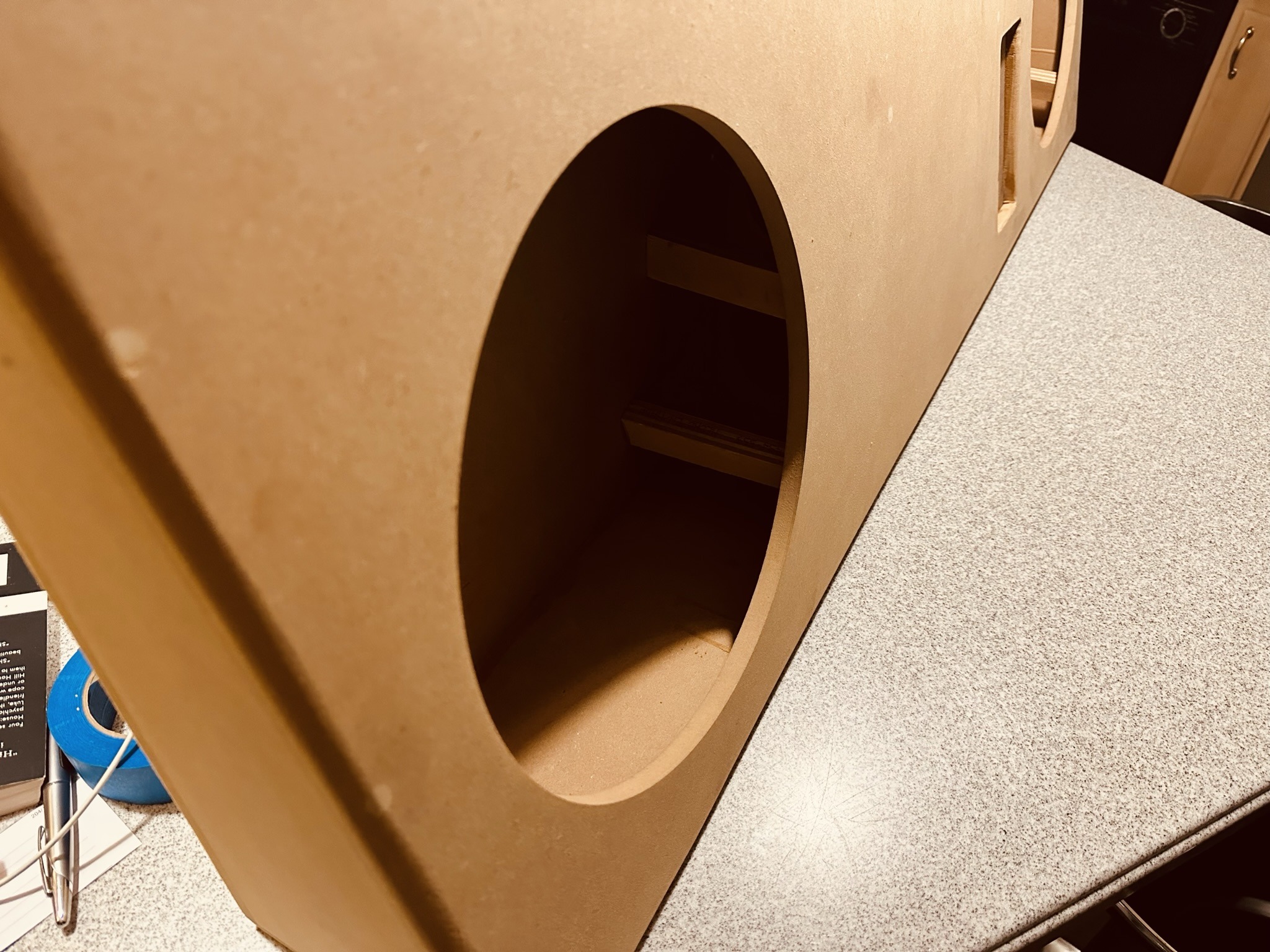

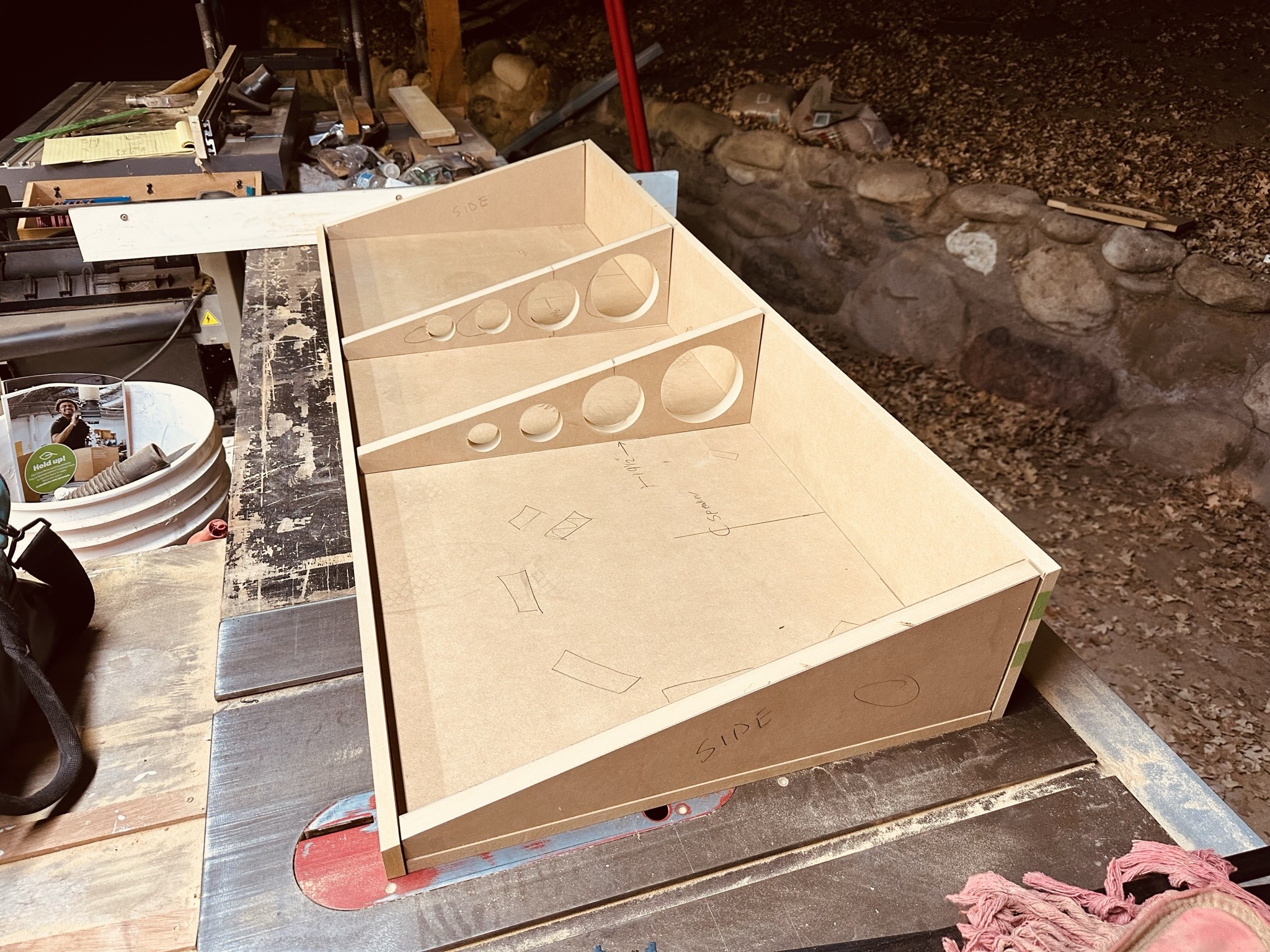

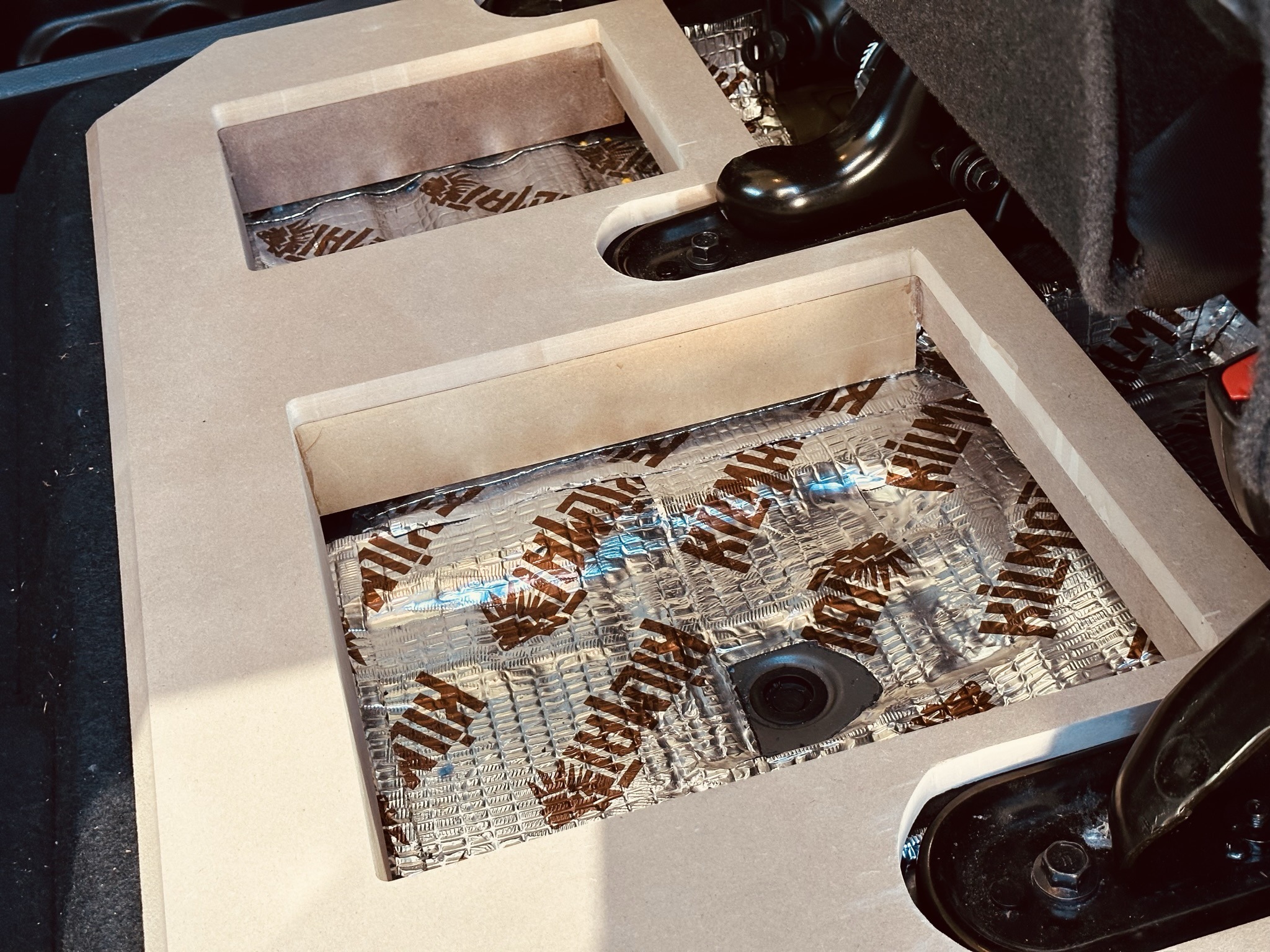

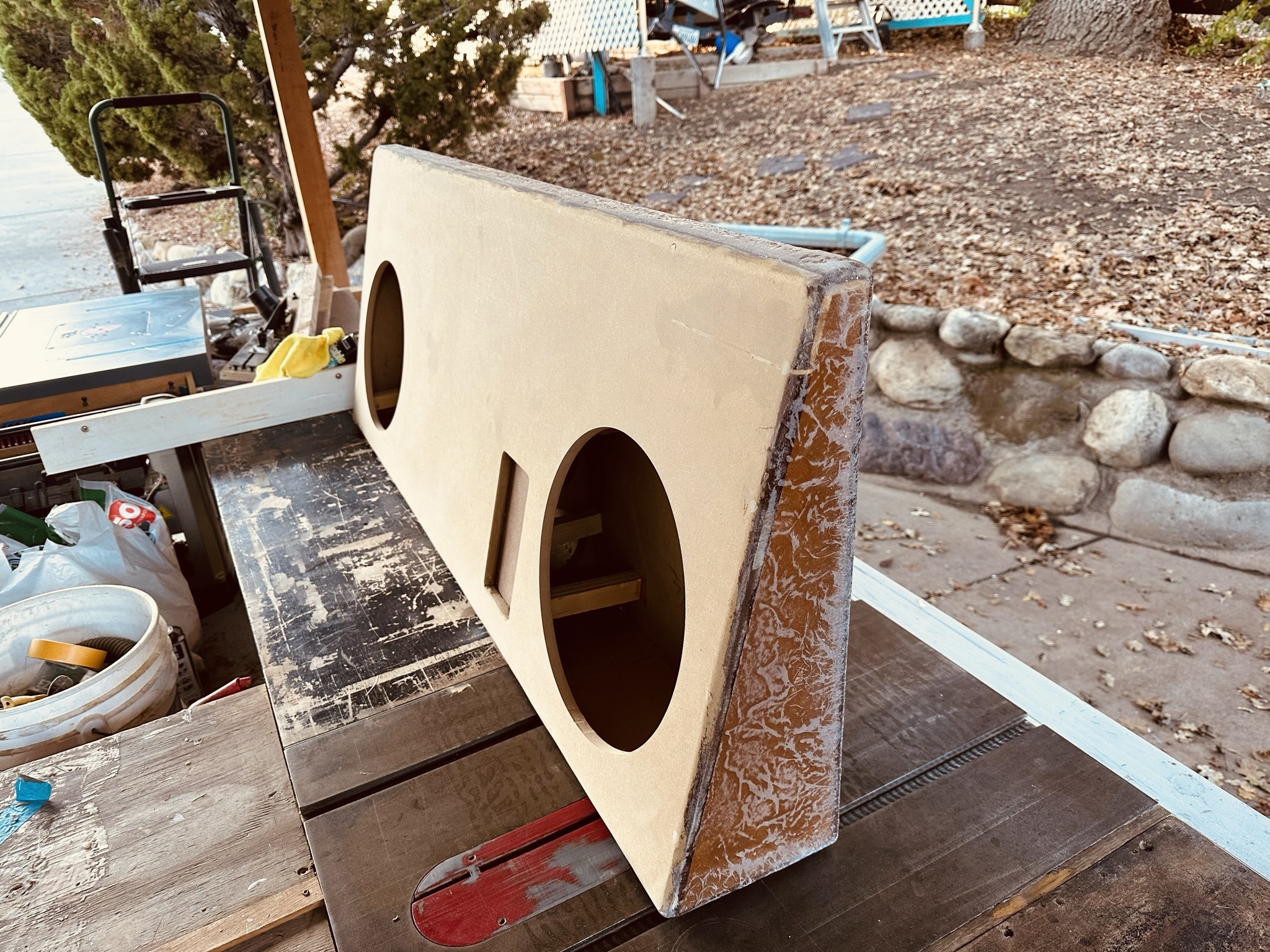

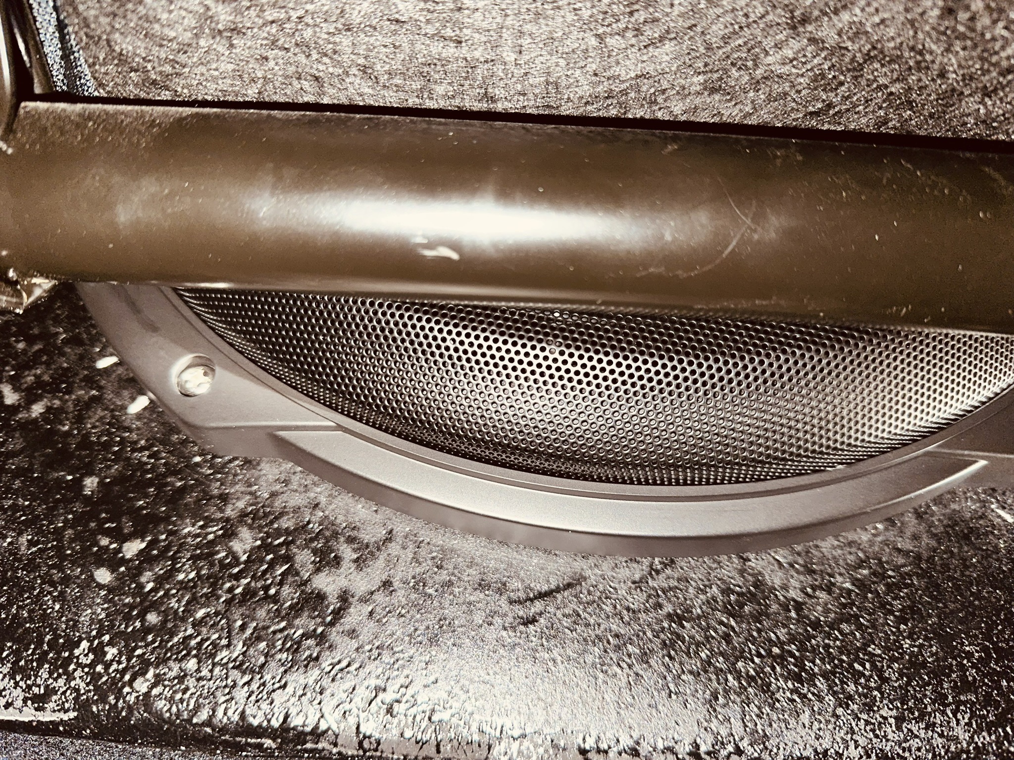

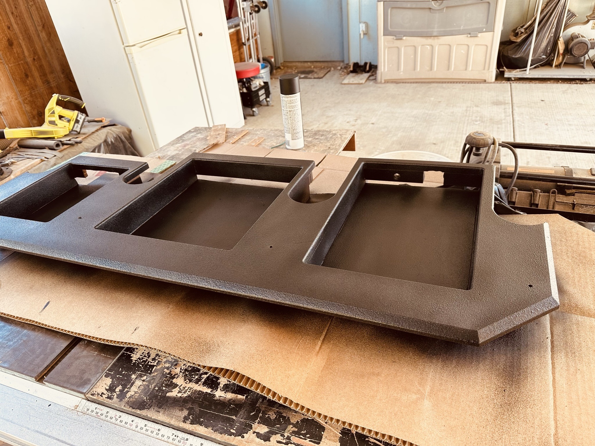

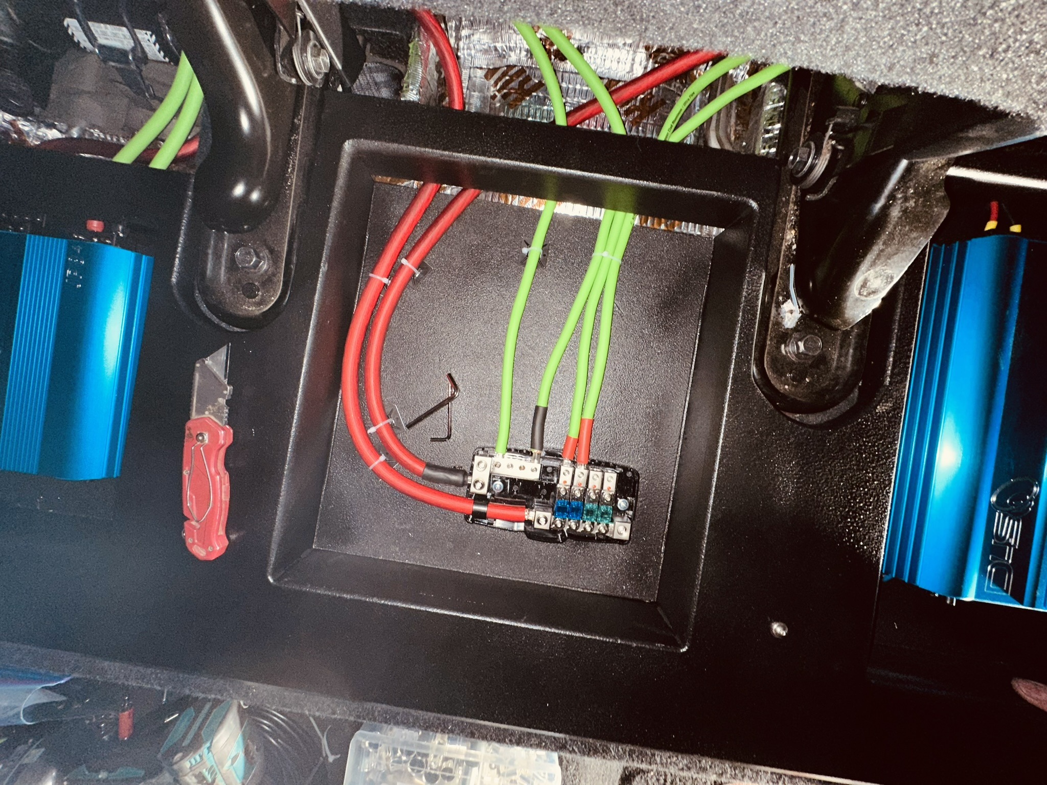

There will be some tricky parts to this install especially with the subs since there is little room for them. I'm debating whether I should cram a narrow wedge box behind the rear seats like so many other Tundra installs I have seen on youtube that leave the subs pressed right up against the back of the seat or do a more serious involved custom install that requires me to cut into the factory installed foam floor riser under the rear seats and use fiberglass to build boxes for the subs between the raised mounting sections of the trucks floor. This would give me upward firing subs under the rear seats that won't be smashed right up against the seat but it will require quite a bit more work and it forever alters the "stockness" of the truck. The subs I have chosen for this install are two JL Audio 12TW3 shallow mount drivers. These are some very nice drivers and are nothing like what I expected from a shallow mount driver. These things are going to bump. They should be quite musical too as JL Audio gear is always top notch and that is the reason I went with them. I hadn't heard any of the many different manufactures shallow mount subs before so i have no idea how any of them sound but I do know how JL Audio subs in general sound so I figured if I'm going to pull the trigger on something as expensive as subs I better have a general understanding of how they are going to sound before buying them so I went with what I know. At this point I'm leaning toward installing them in the floor but that might change.

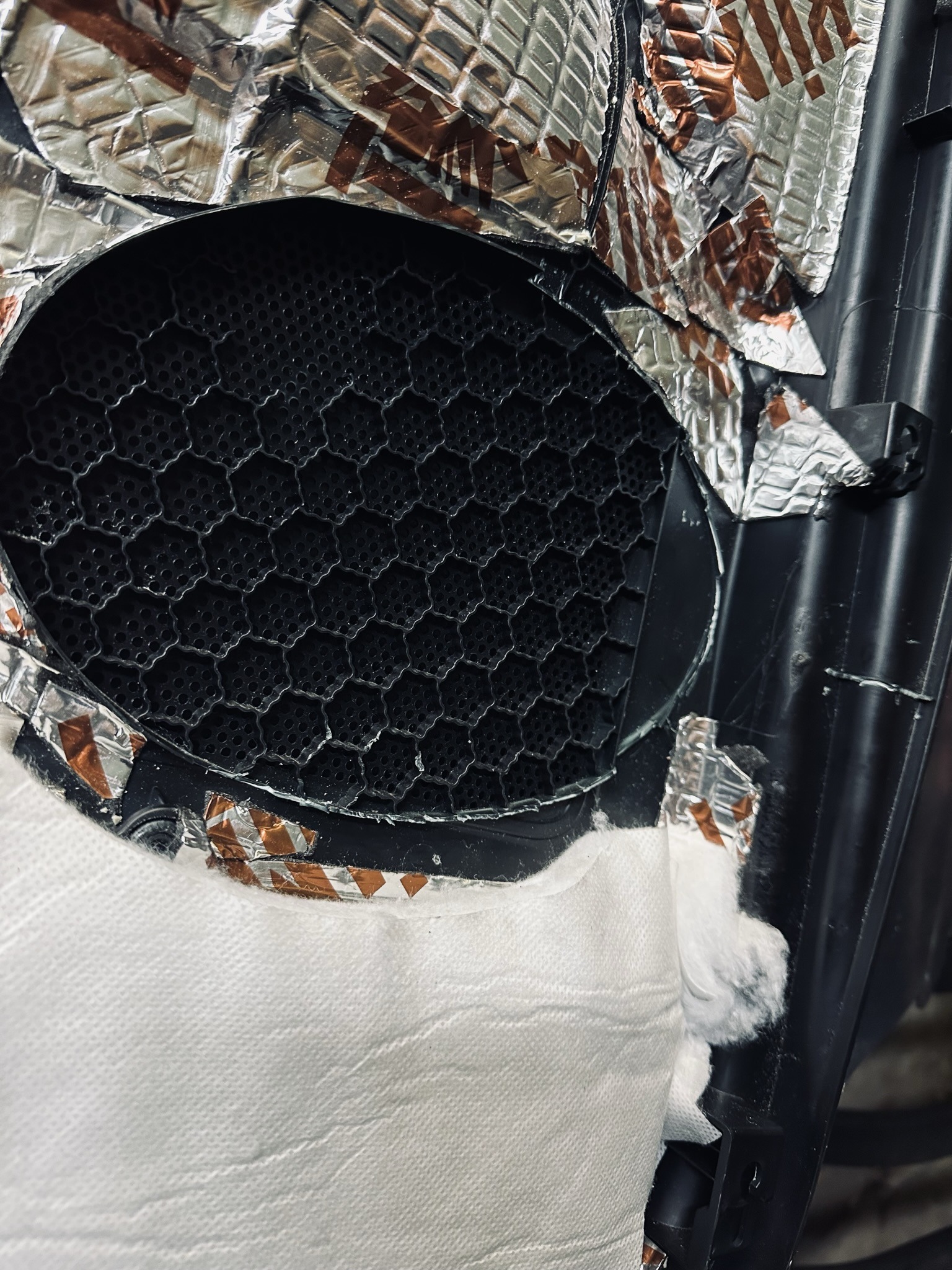

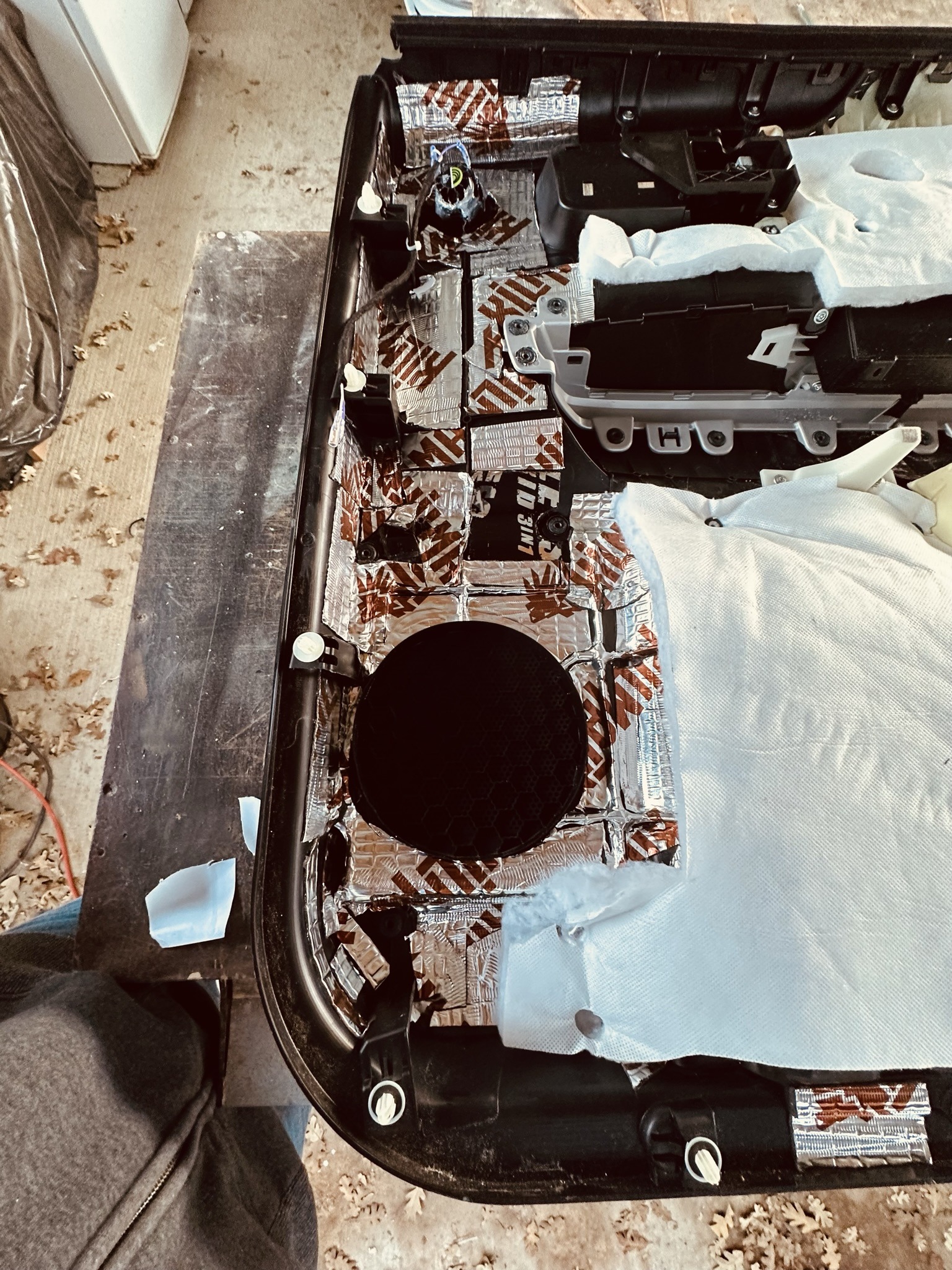

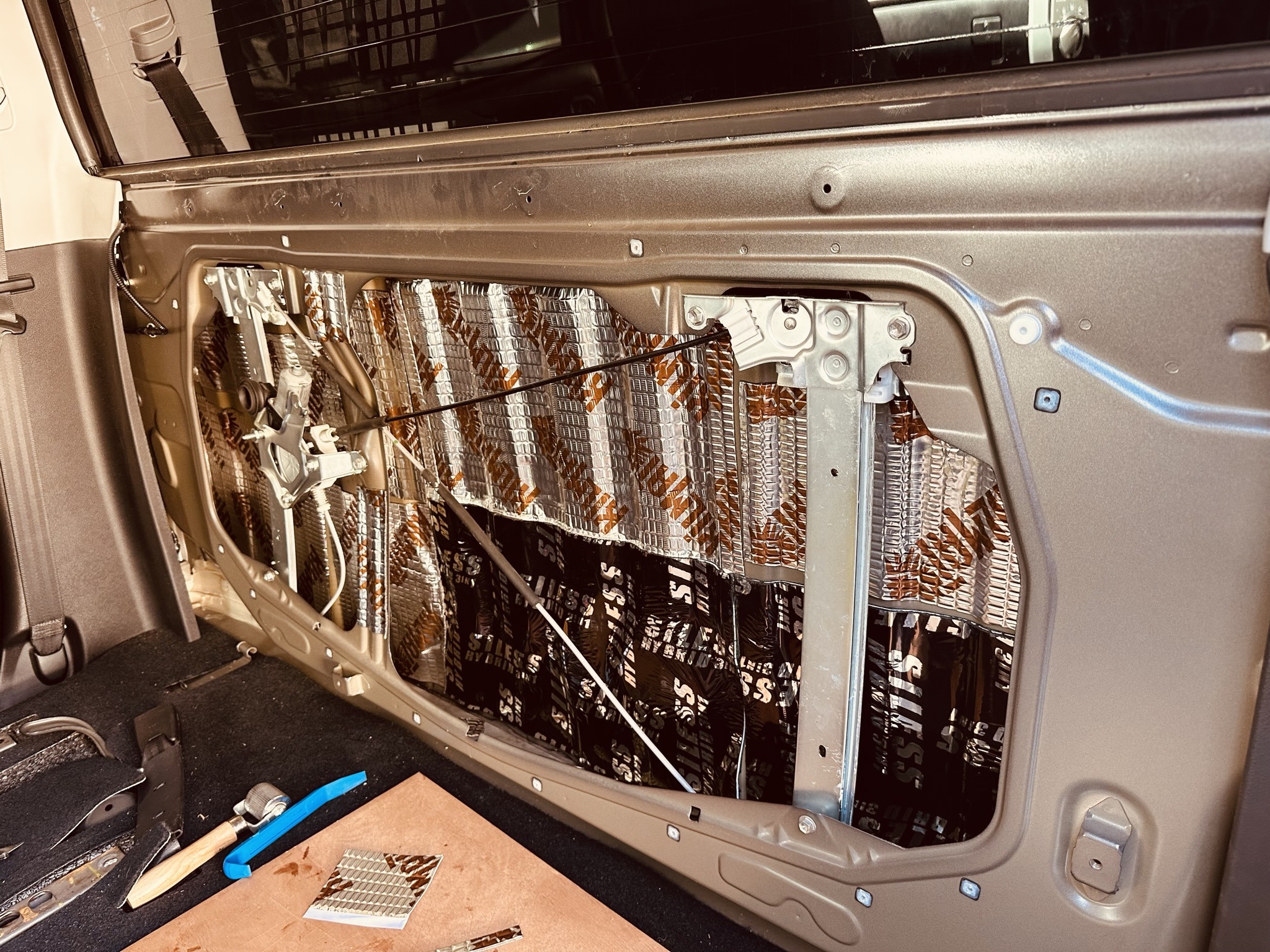

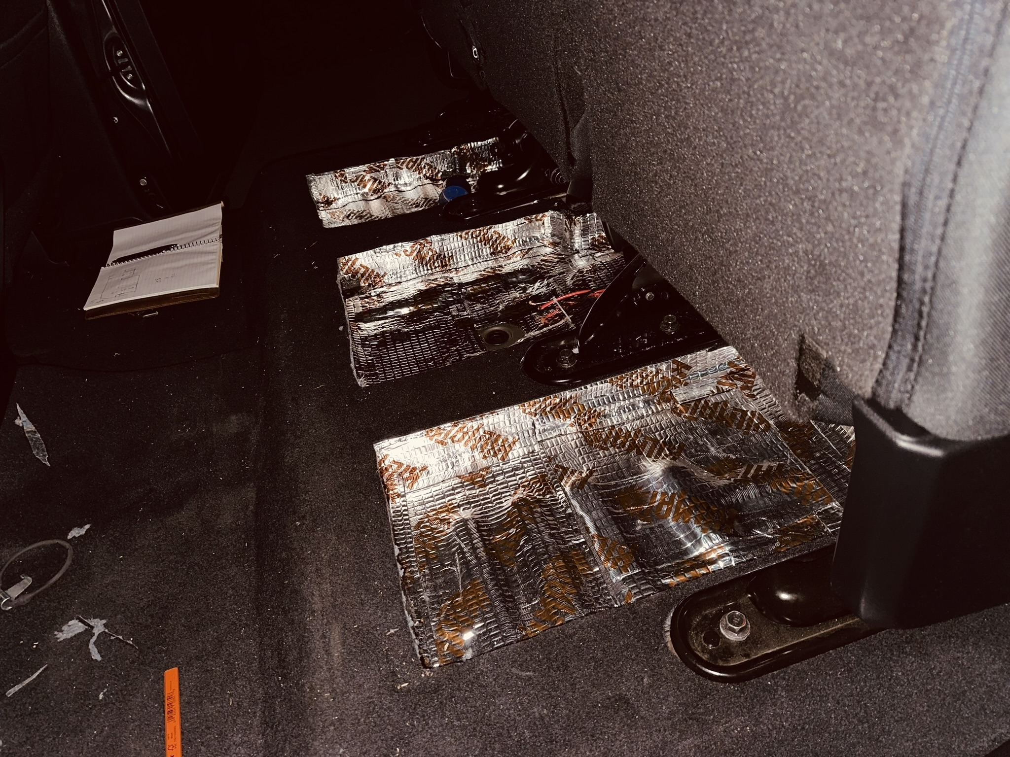

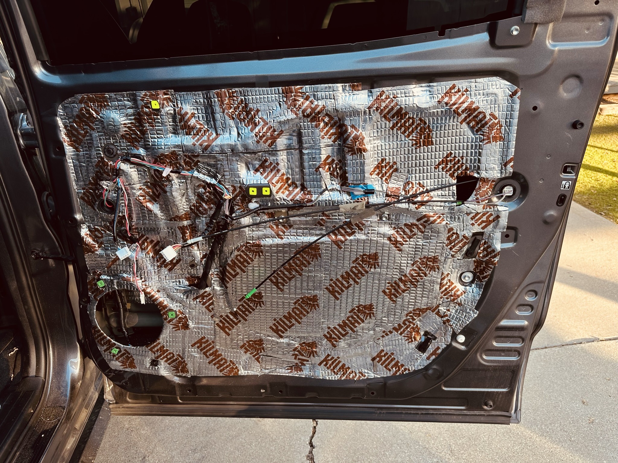

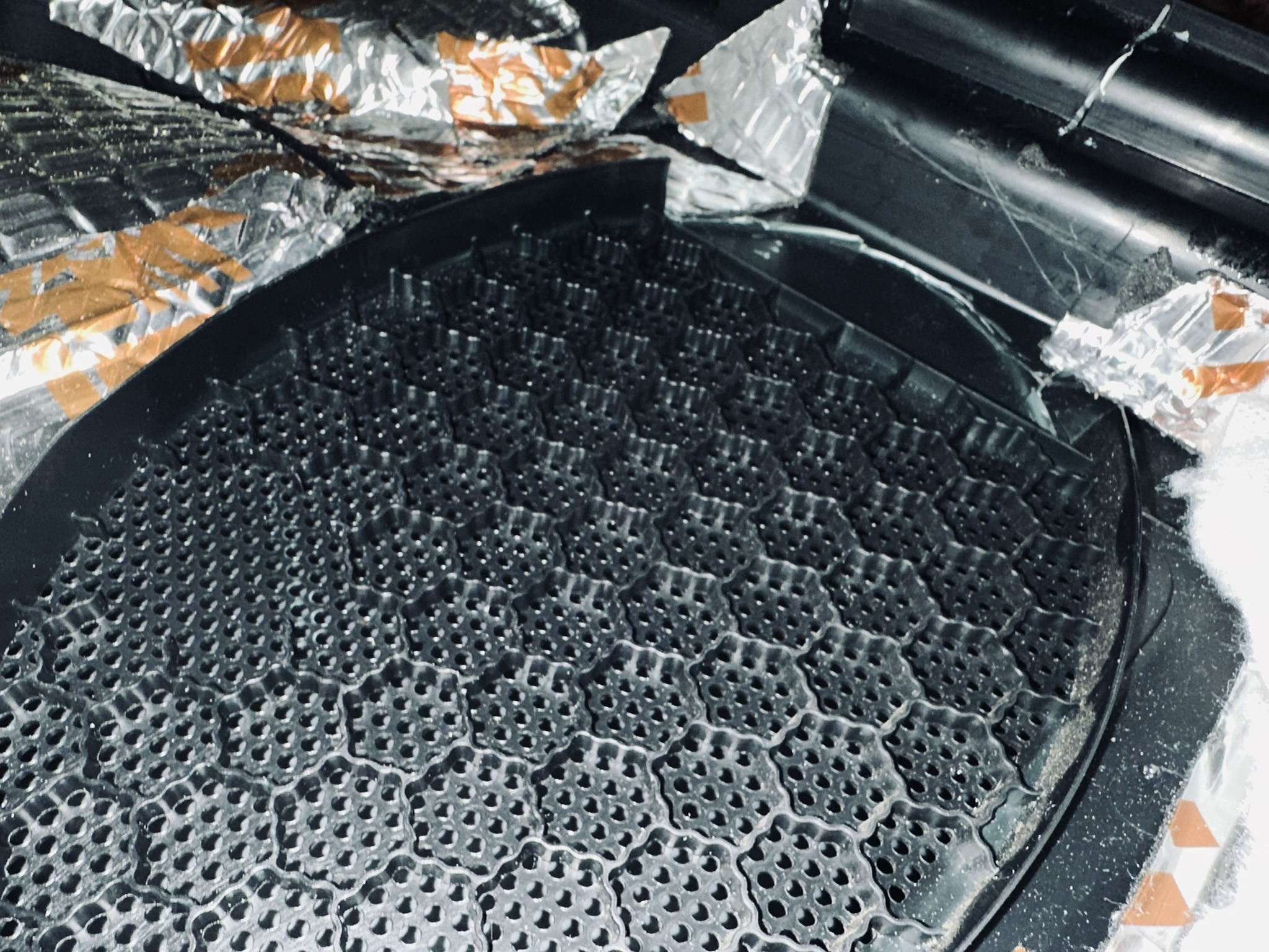

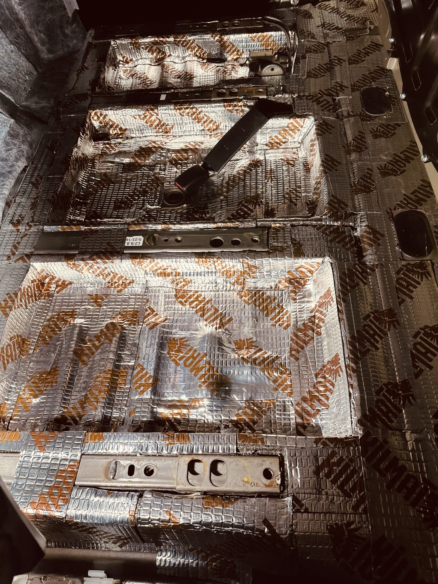

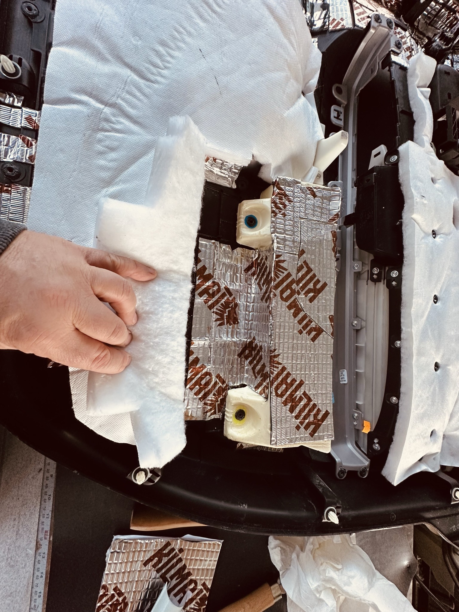

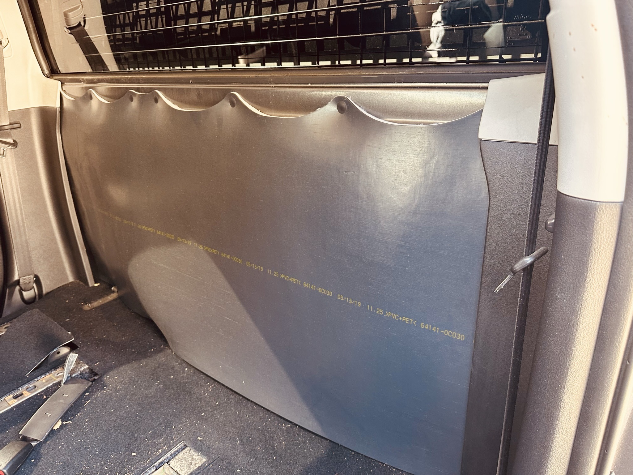

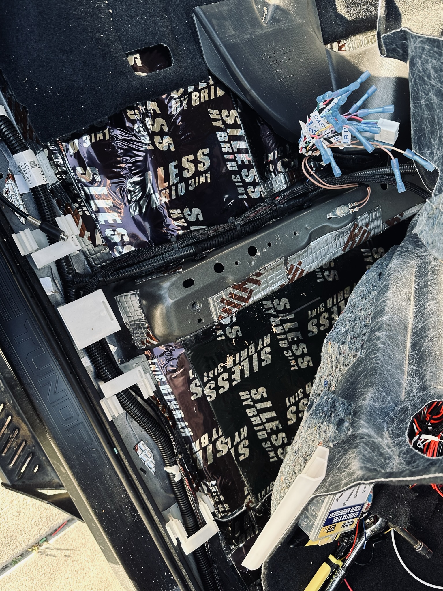

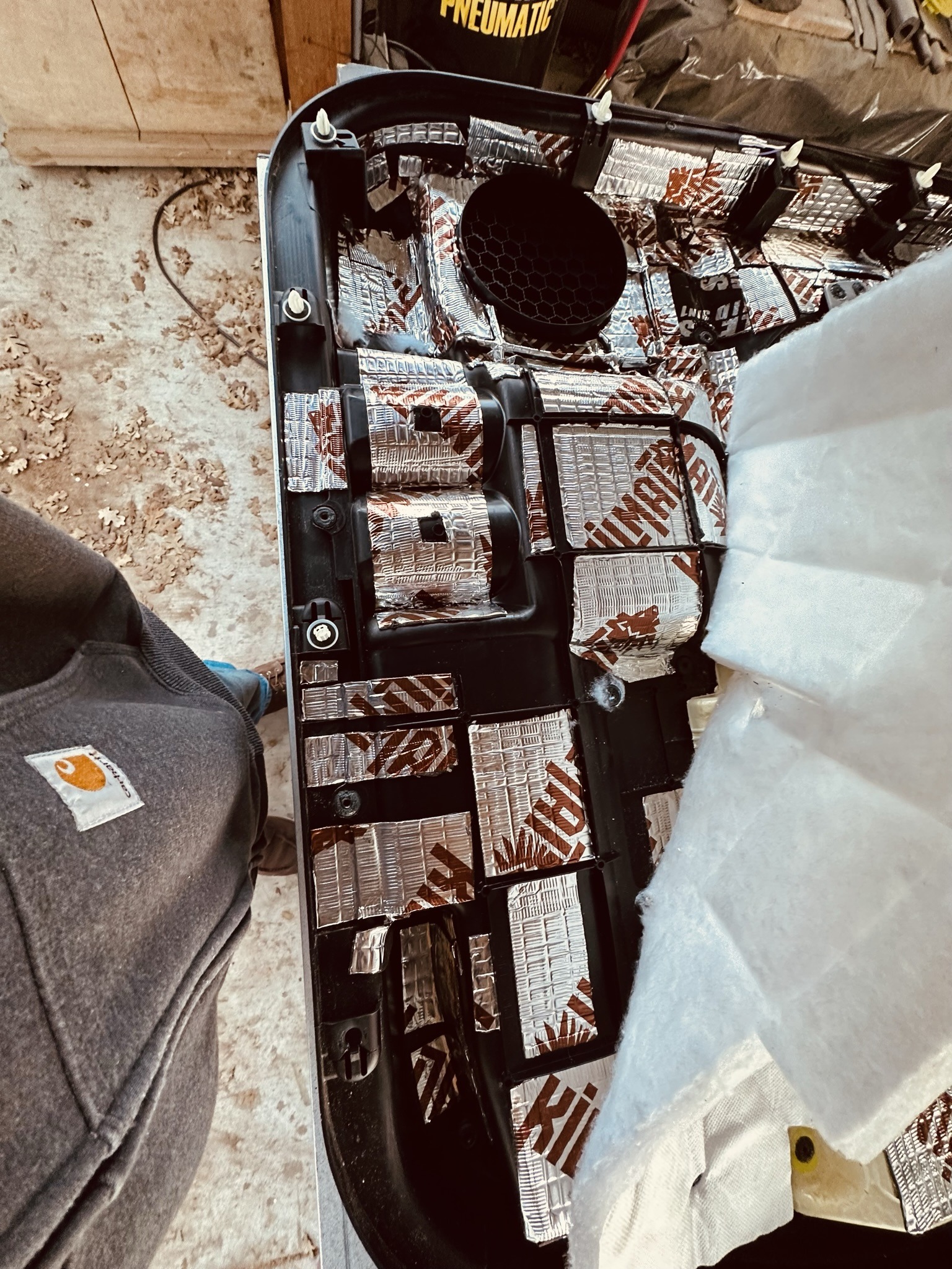

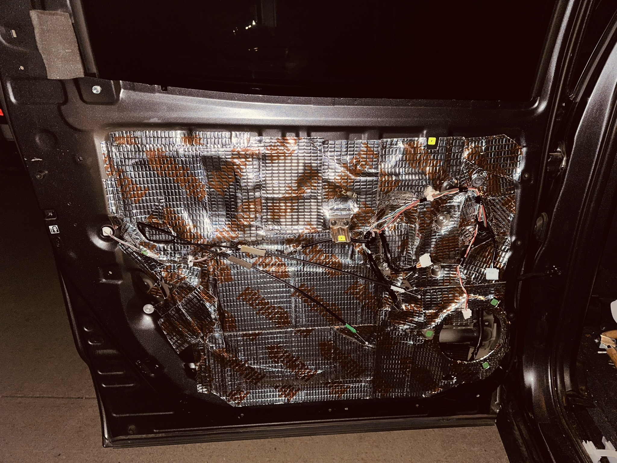

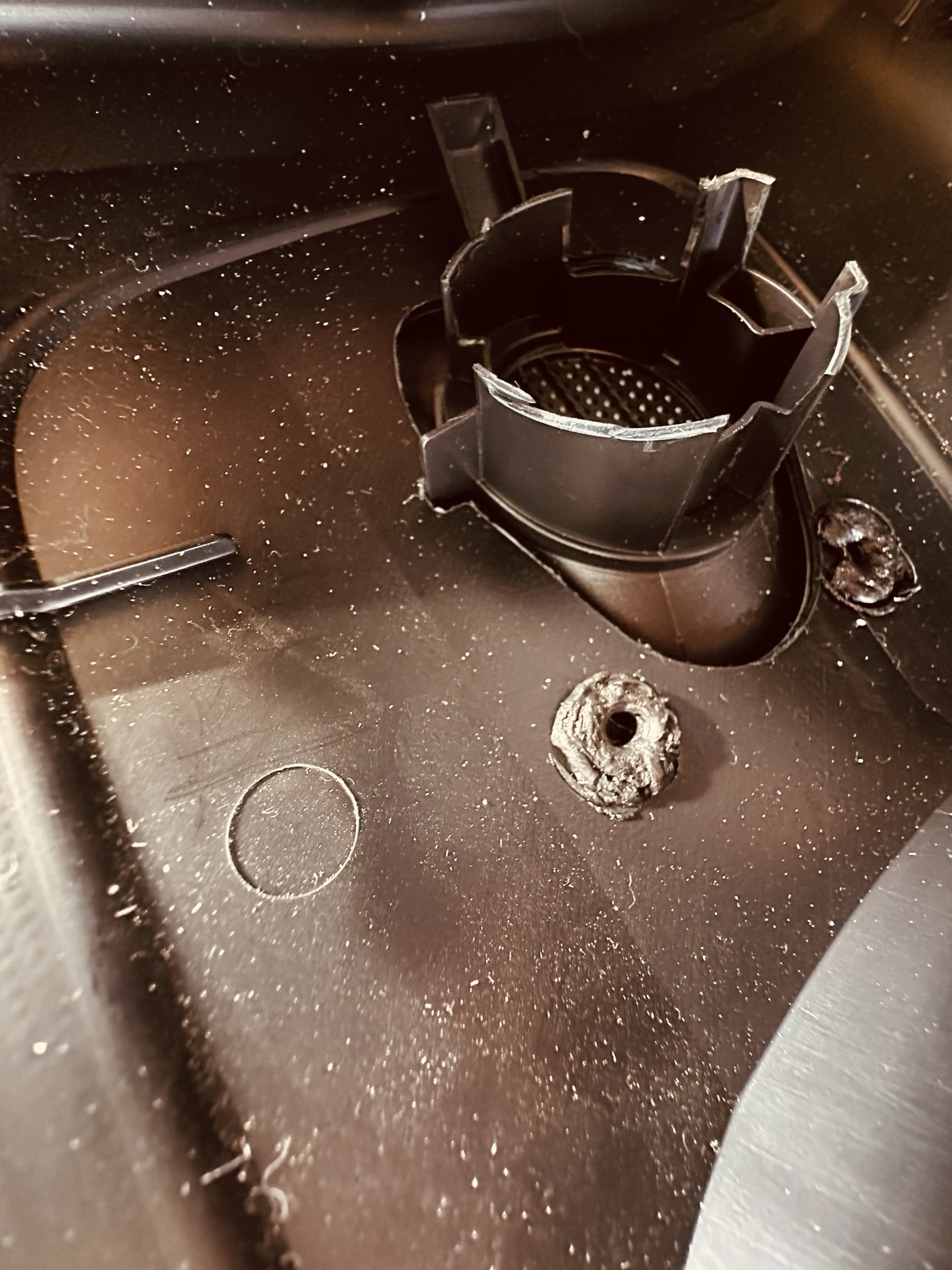

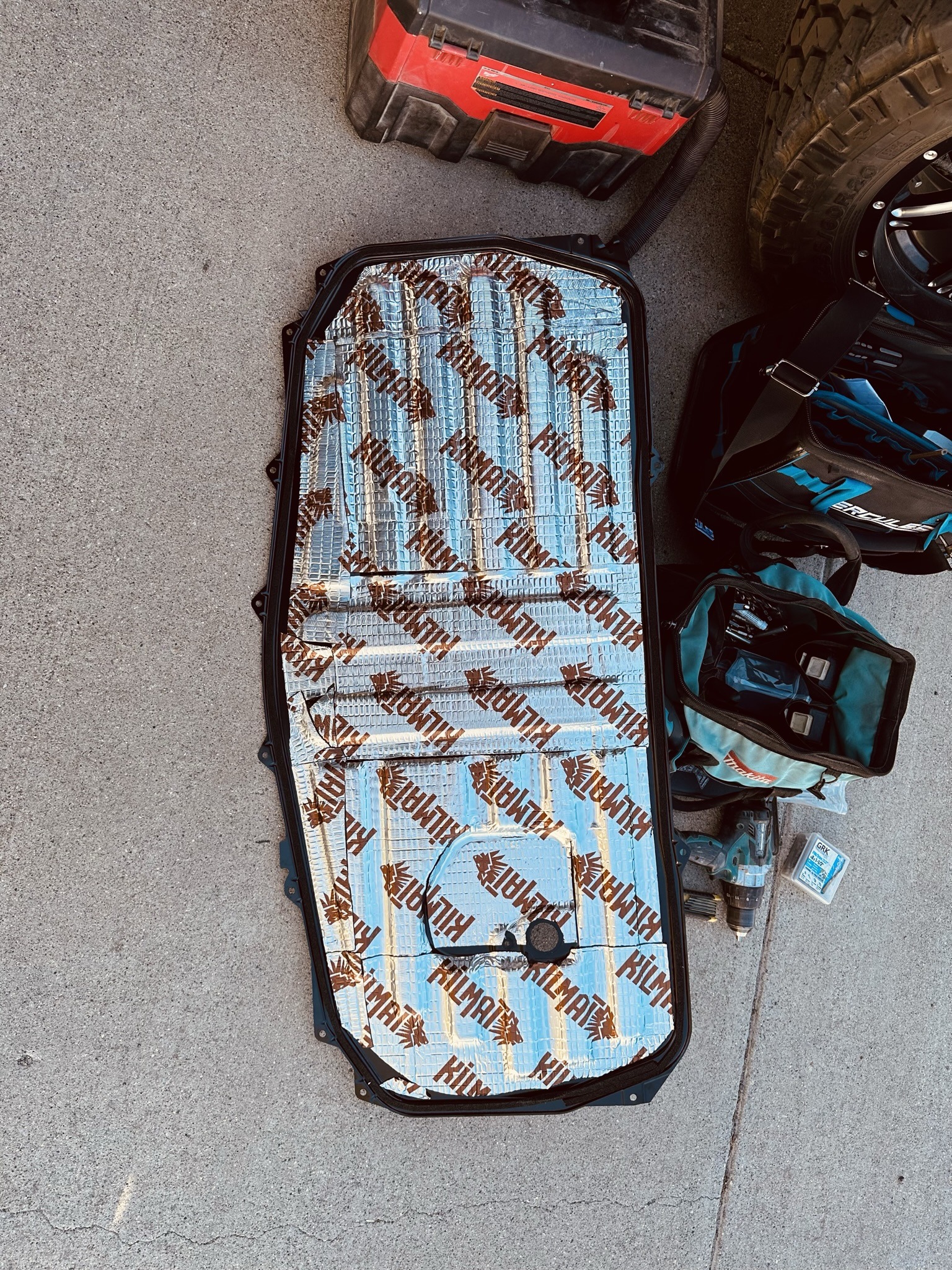

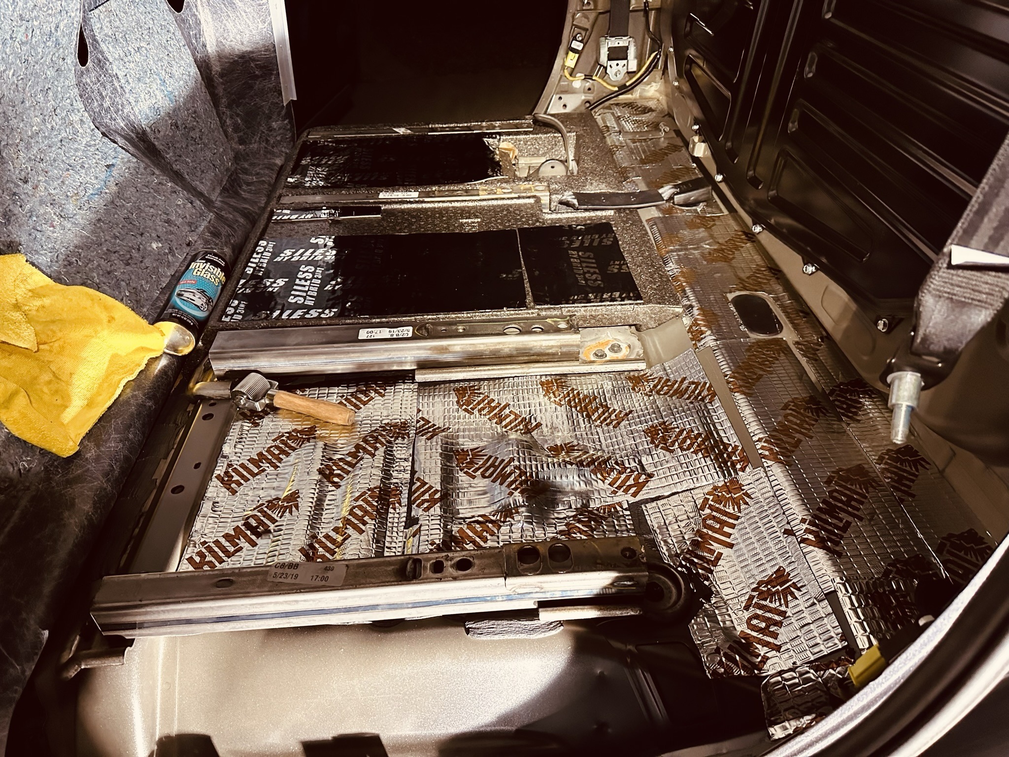

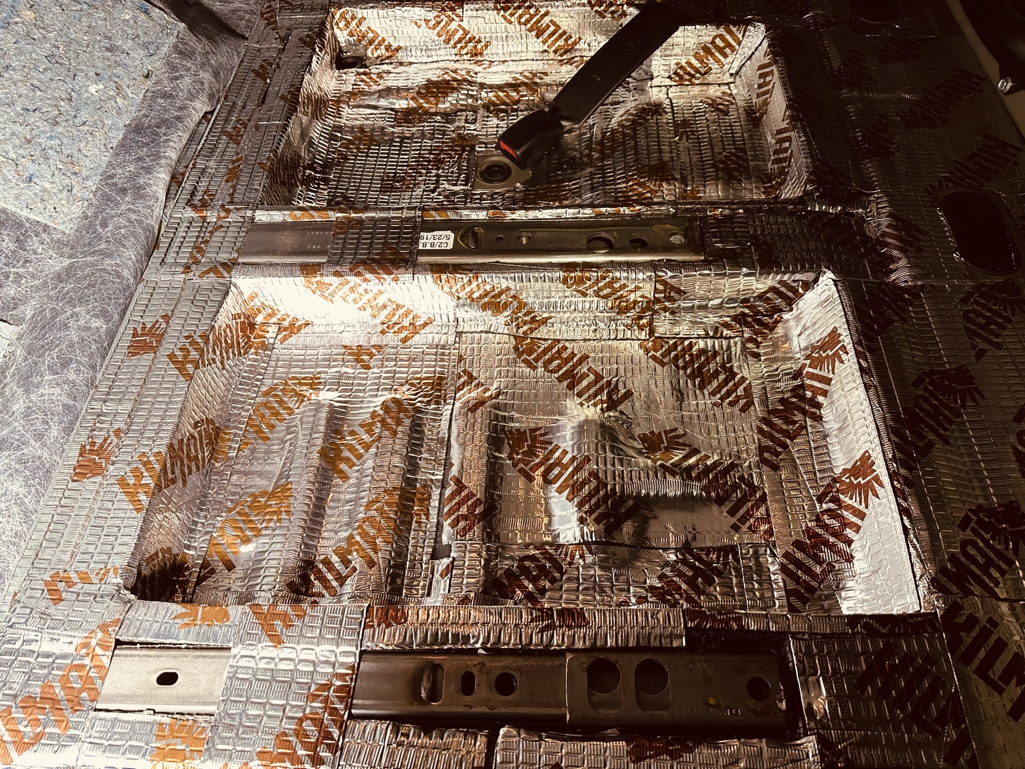

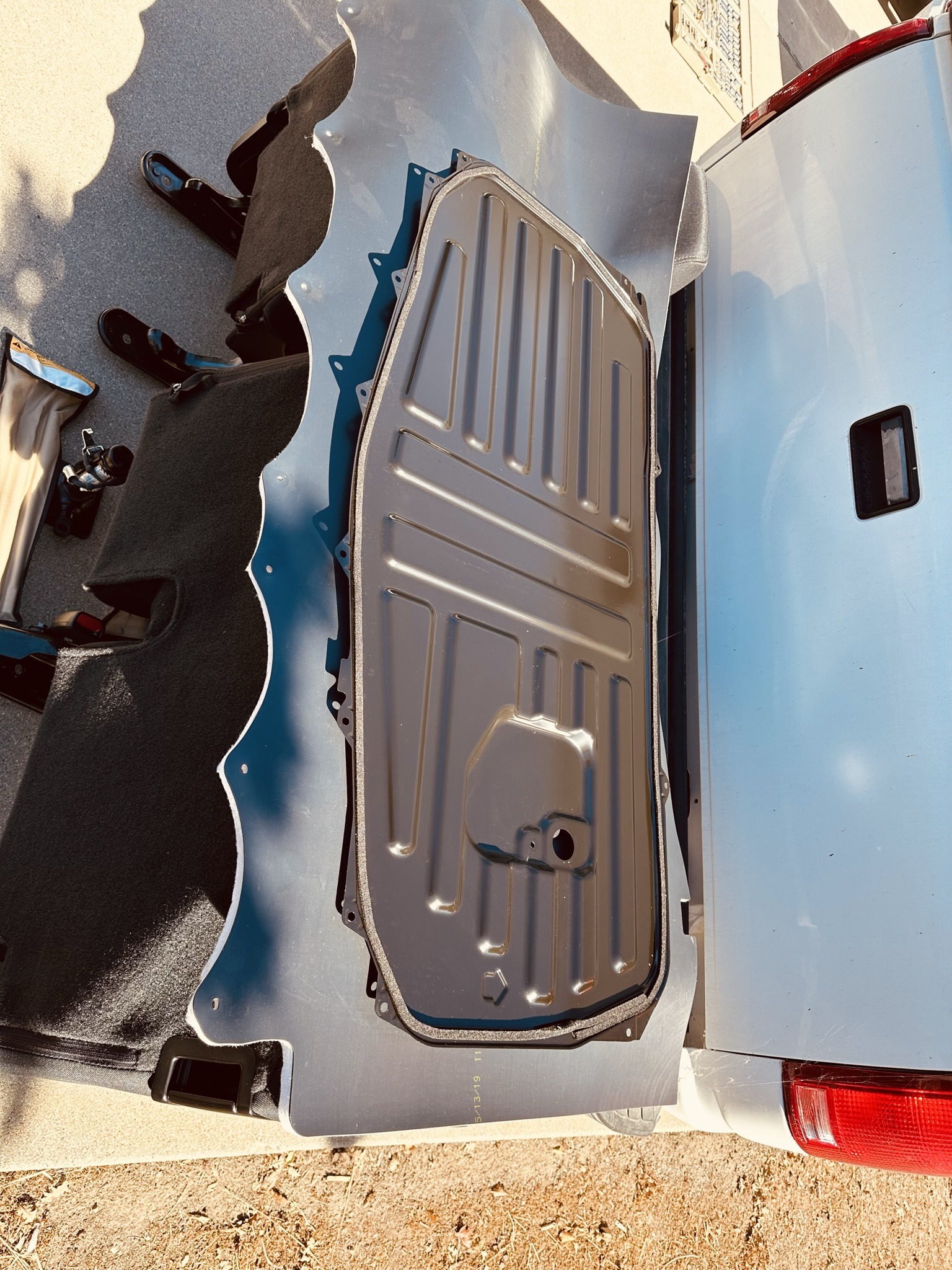

My goal for today is to get the back seats out and start applying the sound deadener to the rear wall and possibly the rear doors as well. I have some very nice set of CDT ES-6CX coaxial drivers coming today or Monday for the rear doors plus I will likely put a small tweeter up in the door panels where there is one now as part of the stock system.
If anyone else has installed a system in a second gen Tundra I'd like to hear what you have to say on the subject. I'll update this as I progress with pics.

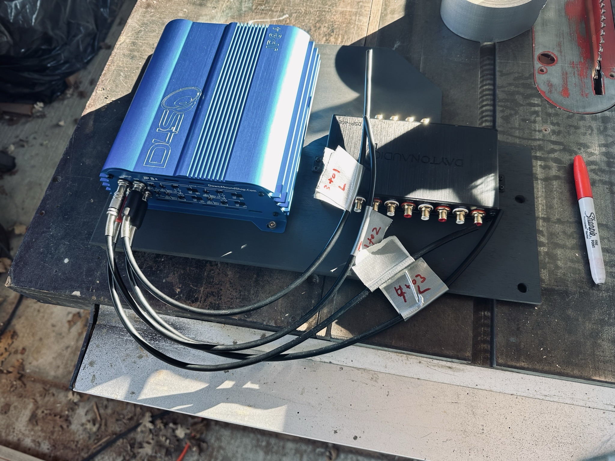

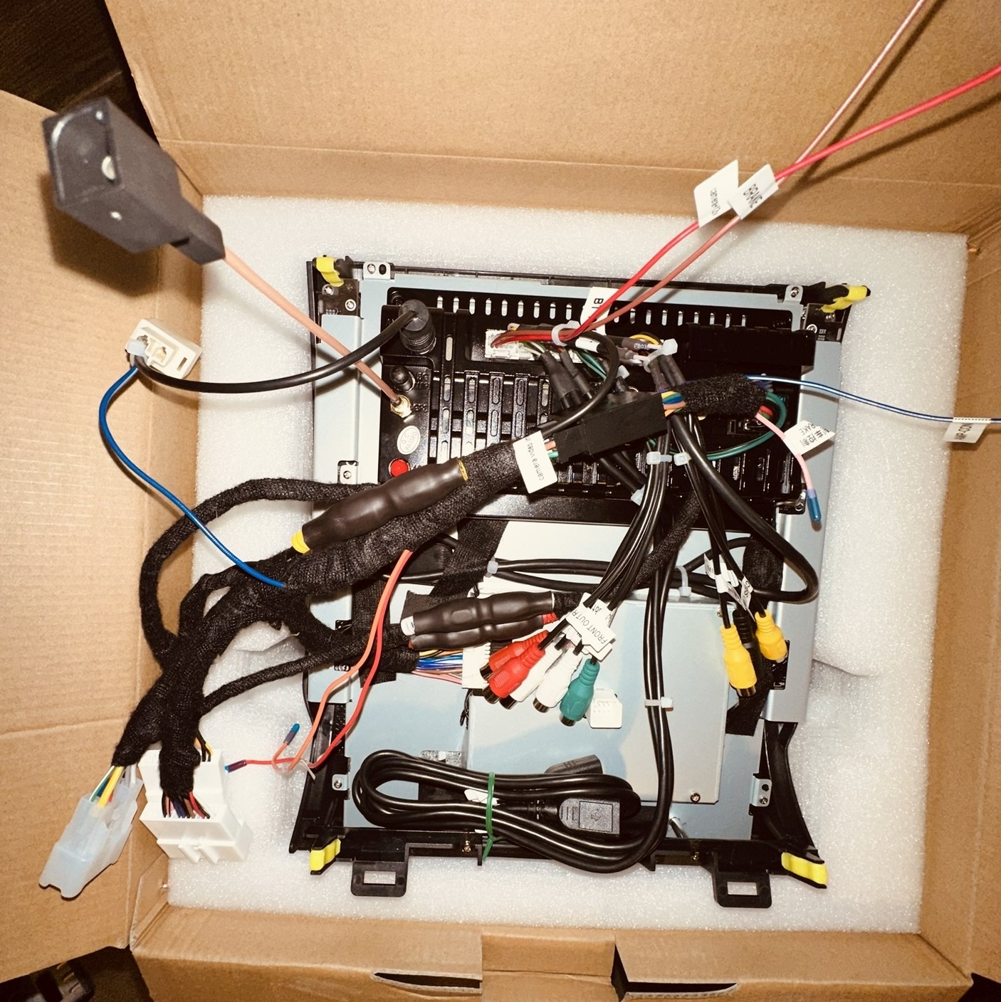

Got it figured out!

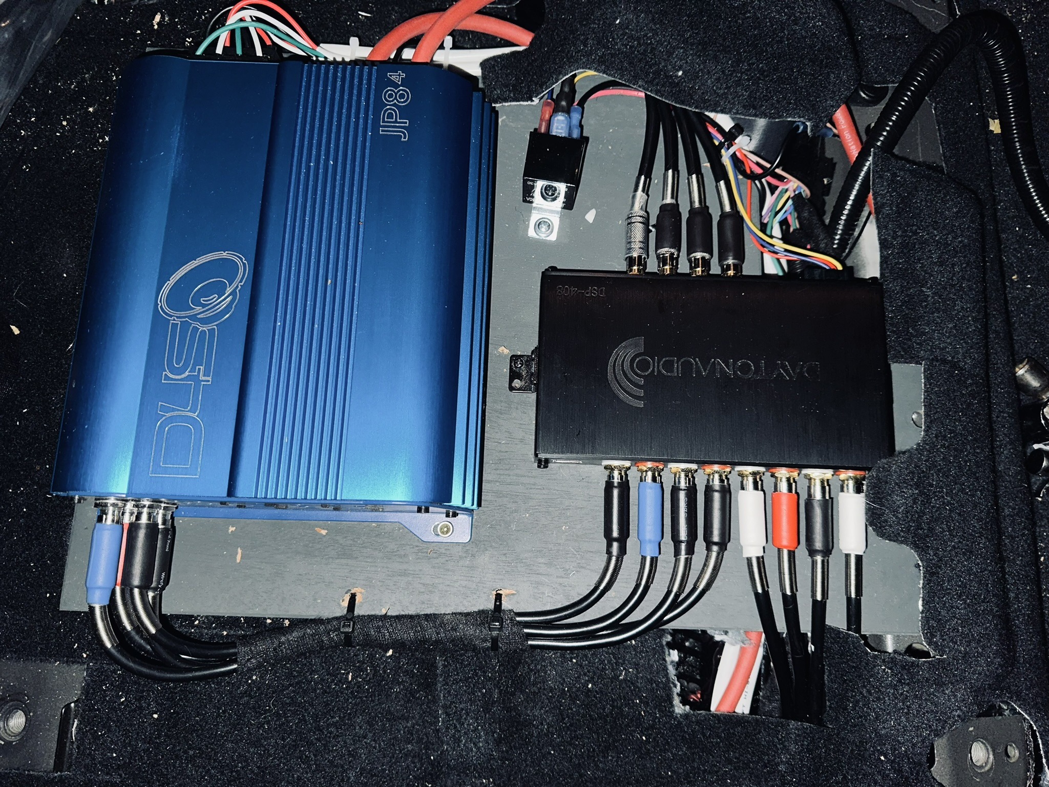

So I grounded the head unit chassis to the truck and that helped a little bit but didn't fix the problem. So my next step was to yank the Dayton Audio DSP out and install the Audio Control DM-608 DSP. Due to differences in size and layout this required that I make all new RCA cables because the old ones weren't long enough. I like to make all of my own interconnects. This way I don't have to roll up and store a bunch of unneeded extra cable you get when you buy ready made cables that are always longer then you need. I want the cables to be exactly long enough and no longer. So anyways, all new RCA cables.
So after making the new cables and installing the new DSP I was so happy when I turned it on and no more NOIZE. YAY! So that problem is solved. No more noise coming from the secondary AIP into the system through the Dayton Audio DSP. Now I just need to move a few of the cables around to different channels because I have a couple of them in the wrong place. Easy fix, not a problem. After that I need to set up the DSP. I've got to set the X-overs and then it is time to break out the old testing mic and RTA and do some final tuning and after that if I'm happy with it, call it done. But judging by the way things sound already I'm thinking that there will likely need to be some rear fill. I might end up putting some 4" midranges in enclosures up at the rear corners at the head liner.

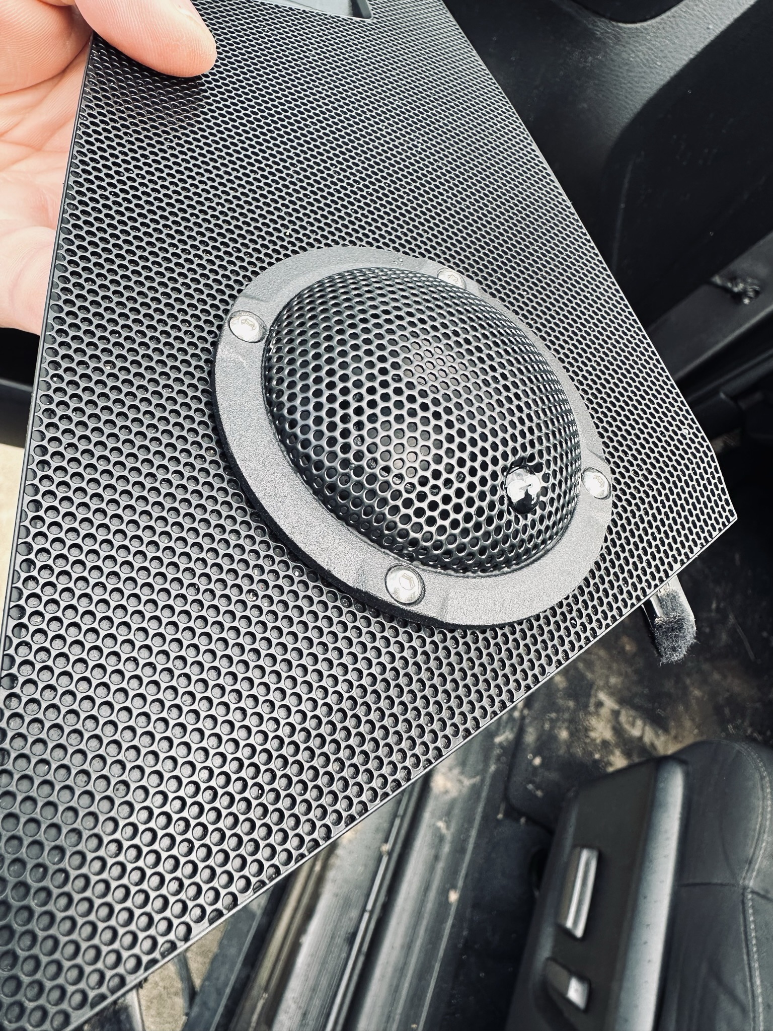

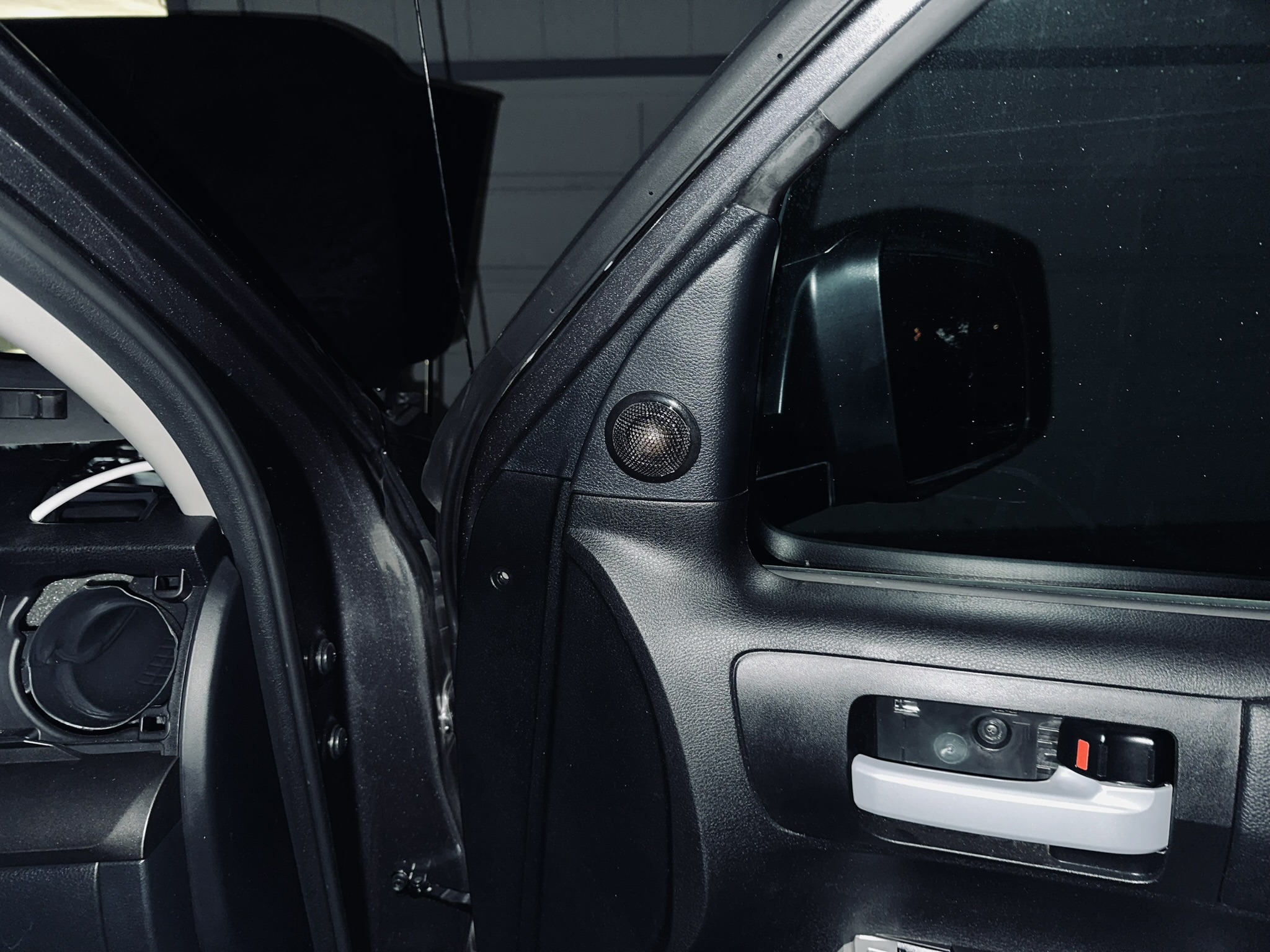

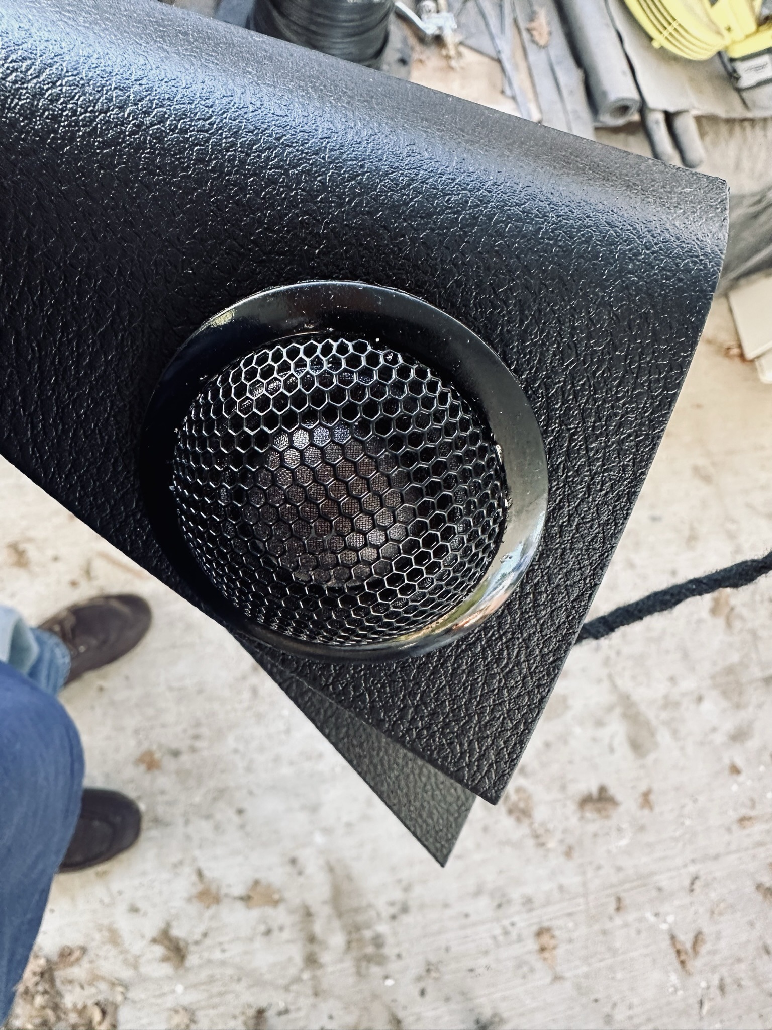

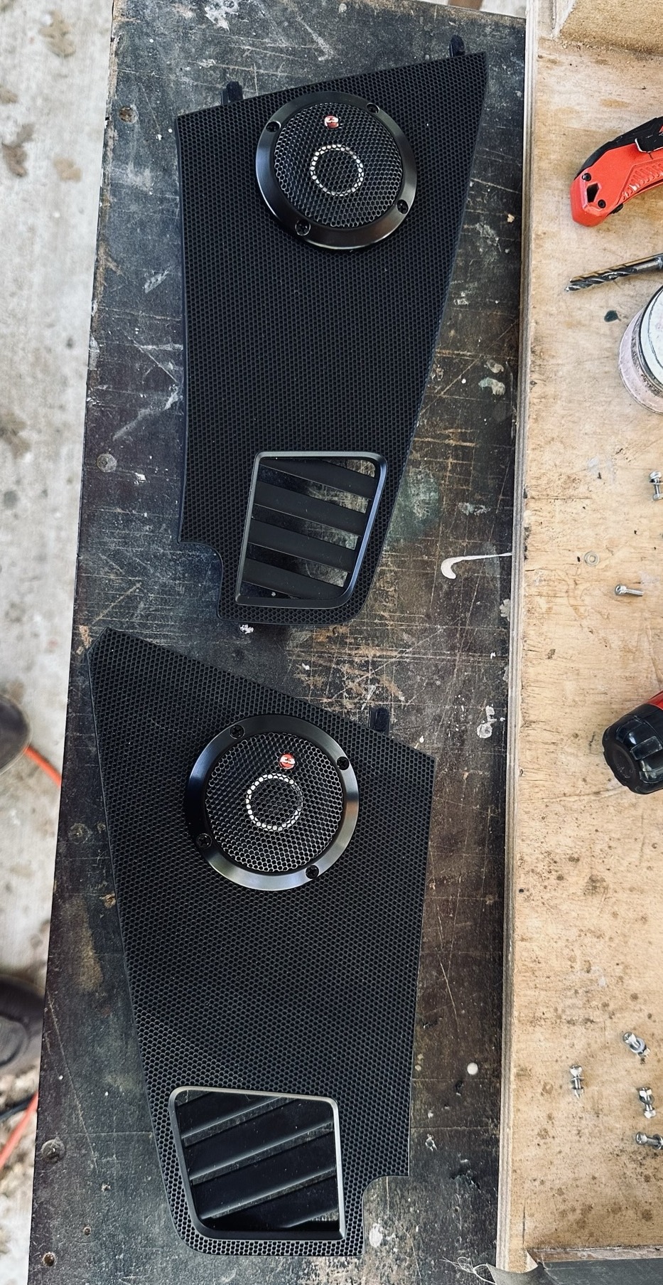

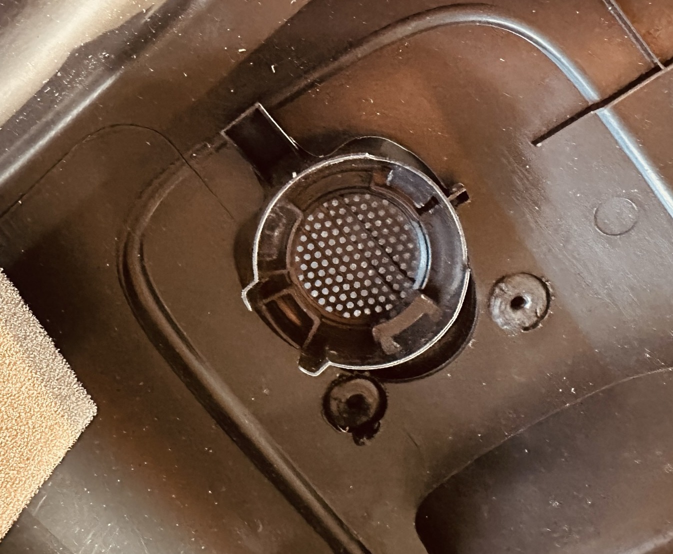

Up front I still have those two tweeters in the sail panels that need to be hooked up. I've been procrastinating because I am not looking forward to having to run speaker wire for them down and through the doors into the cab. Getting wire through the rubber boot between the door and the cab is a real pain in the *** but I should probably do it before I get to carried away with tuning everything.

Another thing that you will need to take special care of is the sound treatment. These trucks use a lot of plastic in the interior and for the most part Toyota did a pretty good job making sure that the interior panels and dash don't rattle but they aren't designed to go up against sub woofers. So you will need to make sure you pay special attention to damping down anything that has the potential to rattle. I used Killmat that I bought from Amazon. It was relatively inexpensive and it worked quite well. I can recommend it. Take your time and apply it to the outer and inner skins of the doors as well as to the door card or panel. I am very happy with the way my truck sounds and the reason for part of that is because nothing inside my truck is rattling, well except for one thing that I will be taking care of here in the next day or two and that is the rear view mirror. Rear view mirrors are always hard to silence in cars with subwoofers and sometimes you just have to live with it or remove them but that isn't really an option for most people due to all of the features that the mirrors incorporate these days plus it is a safety feature and in some places removing them may be against the law.
If you have any questions that I can help you with don't be afraid to ask. I will help if I can.

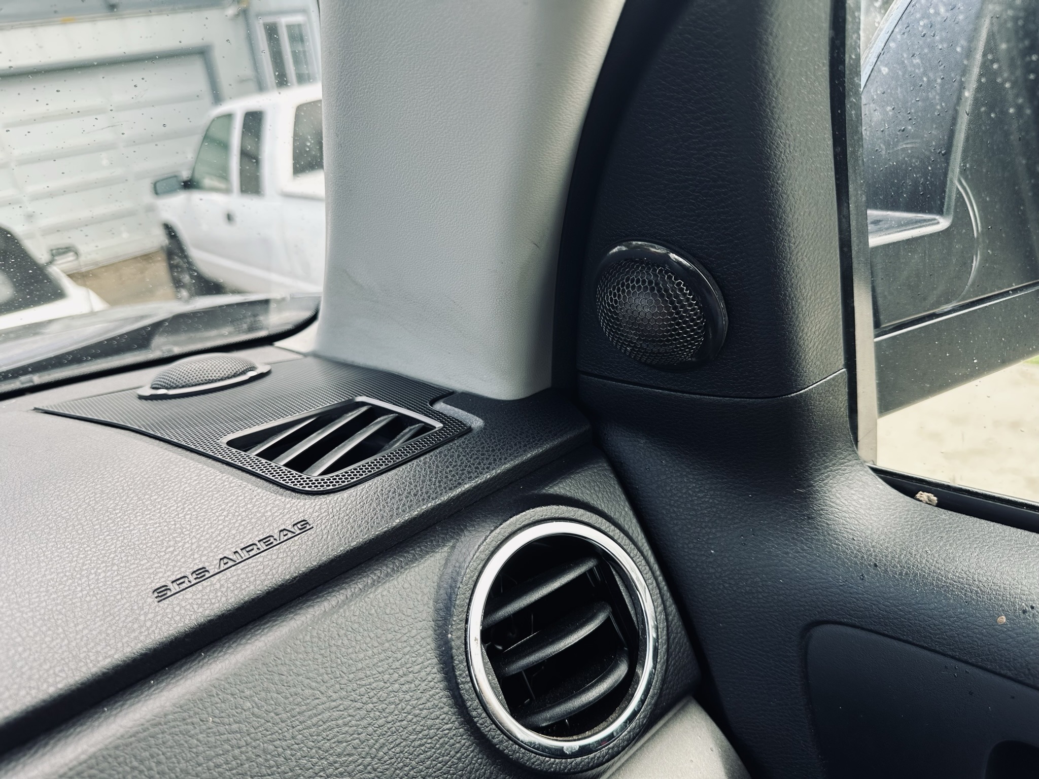

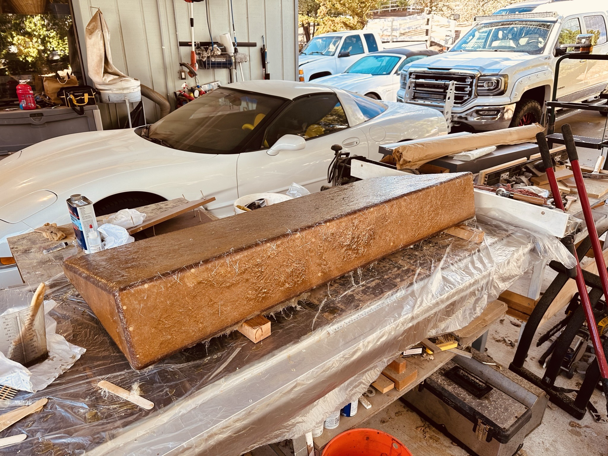

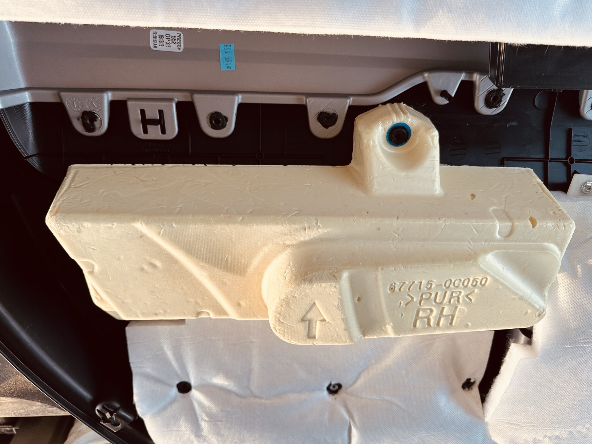

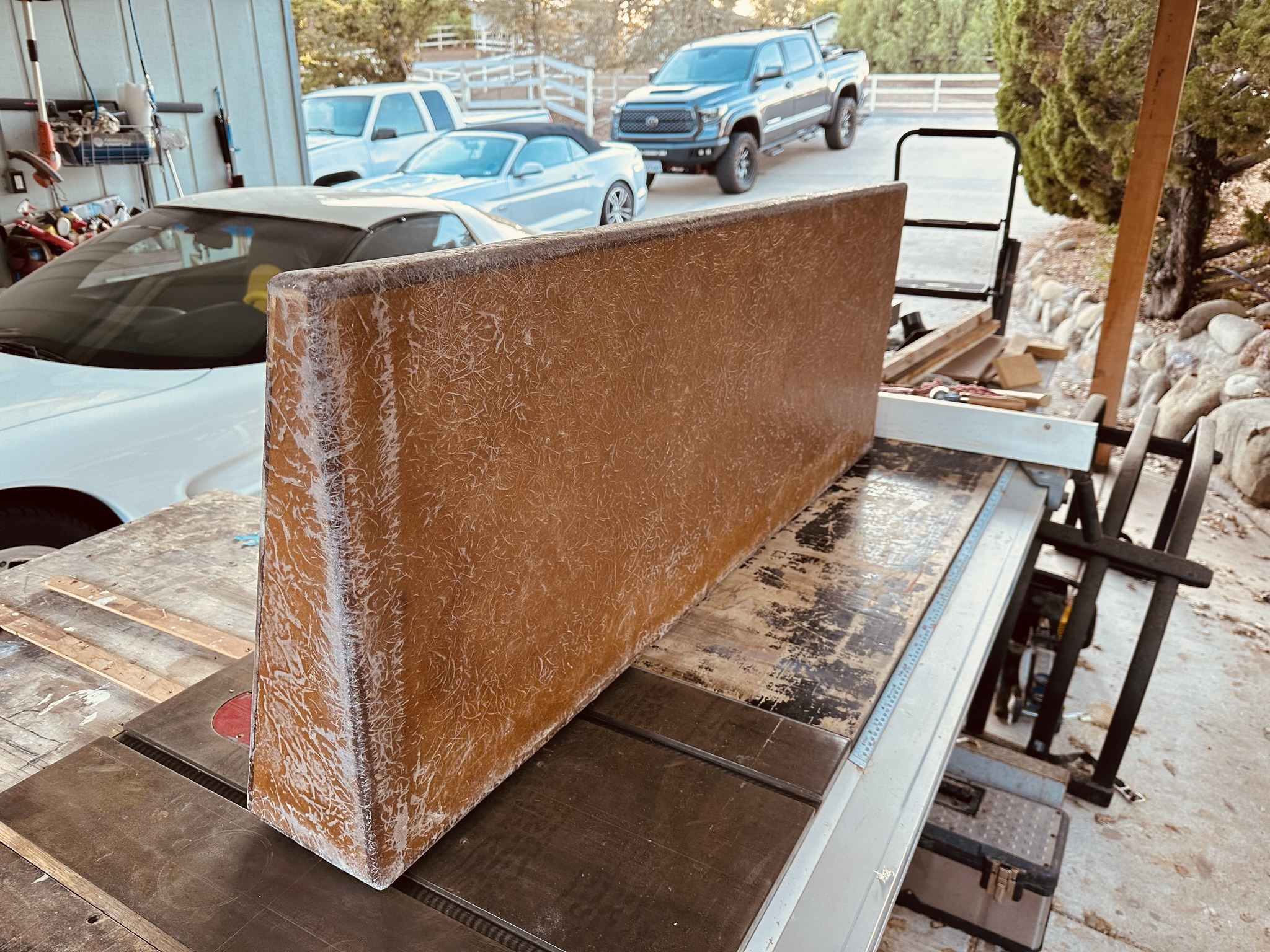

I have found that poly cutting boards can make for very effective door reinforcement material. Many small wafer-head screws are used to attach to thin sheet metal doors. The 3/8” thick boards conform to slight surface variations.

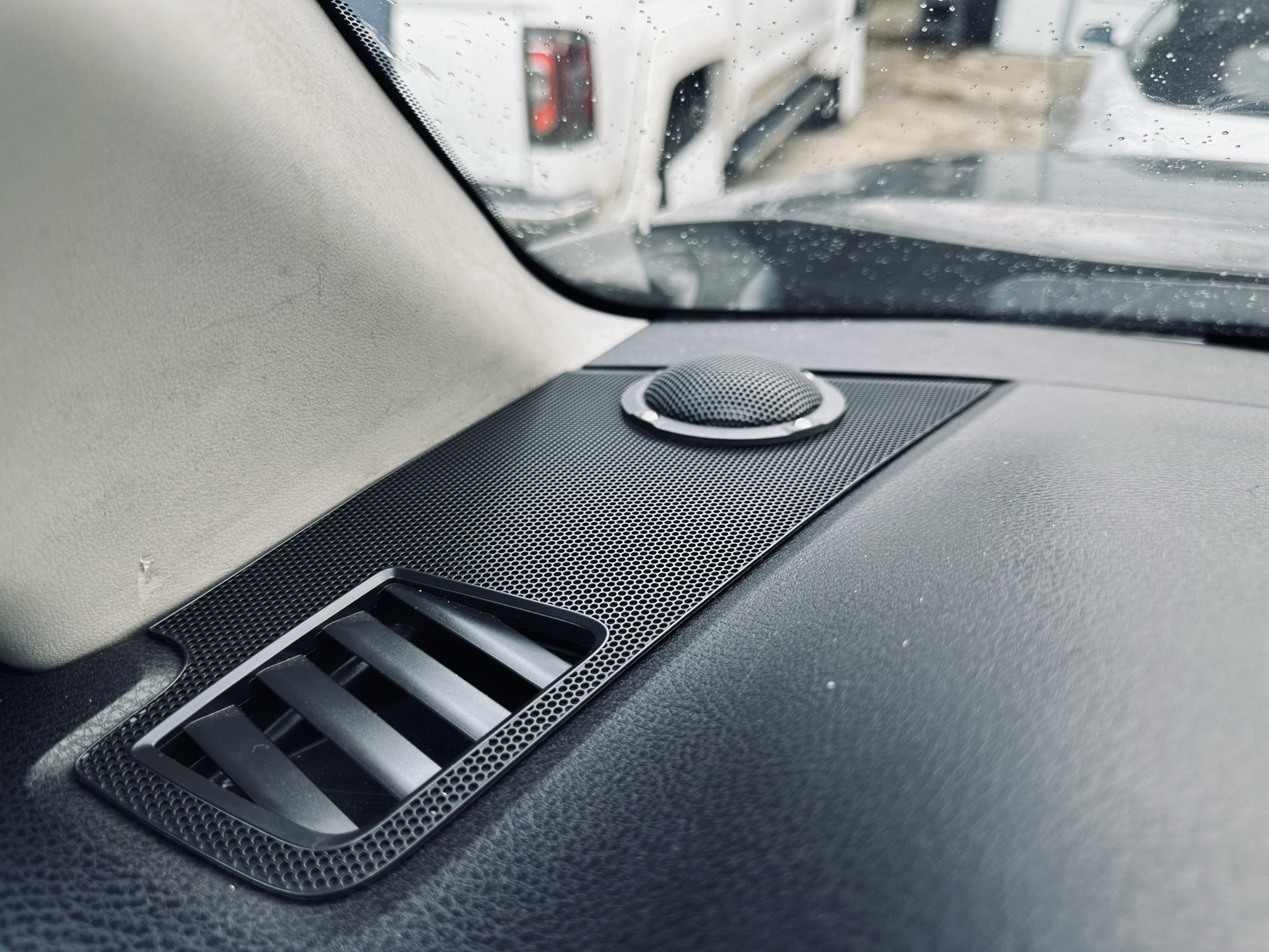

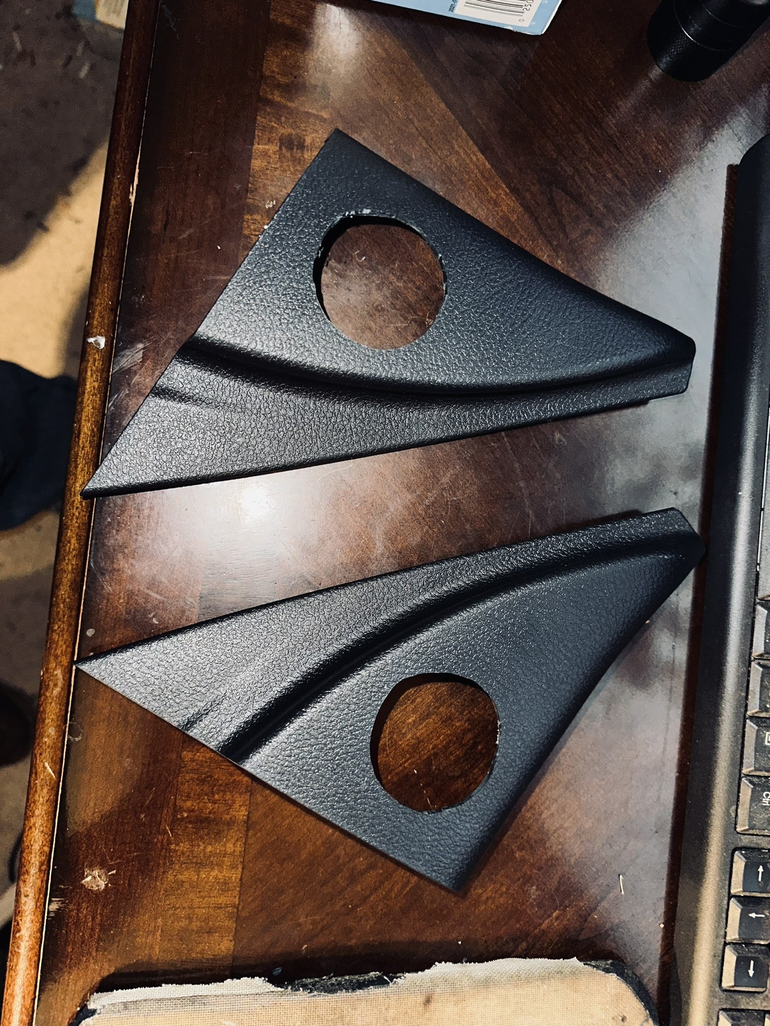

Was going to mention that in dash tweeters can provide a great soundstage, but it looks like you’re taking advantage of that.
Nice installation!
Nice installation!
Thanks man.I have found that poly cutting boards can make for very effective door reinforcement material. Many small wafer-head screws are used to attach to thin sheet metal doors. The 3/8” thick boards conform to slight surface variations.
Nice installation!

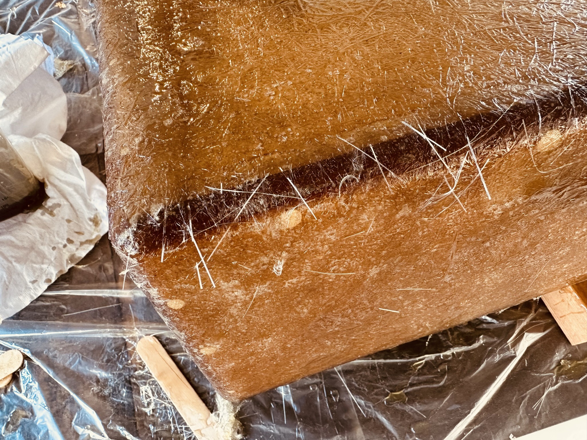

Another thing that works well is 3/16" sheet lead. It will conform to any surface geometry and it can also be used to fiberglass over to make air tight custom fit panels.

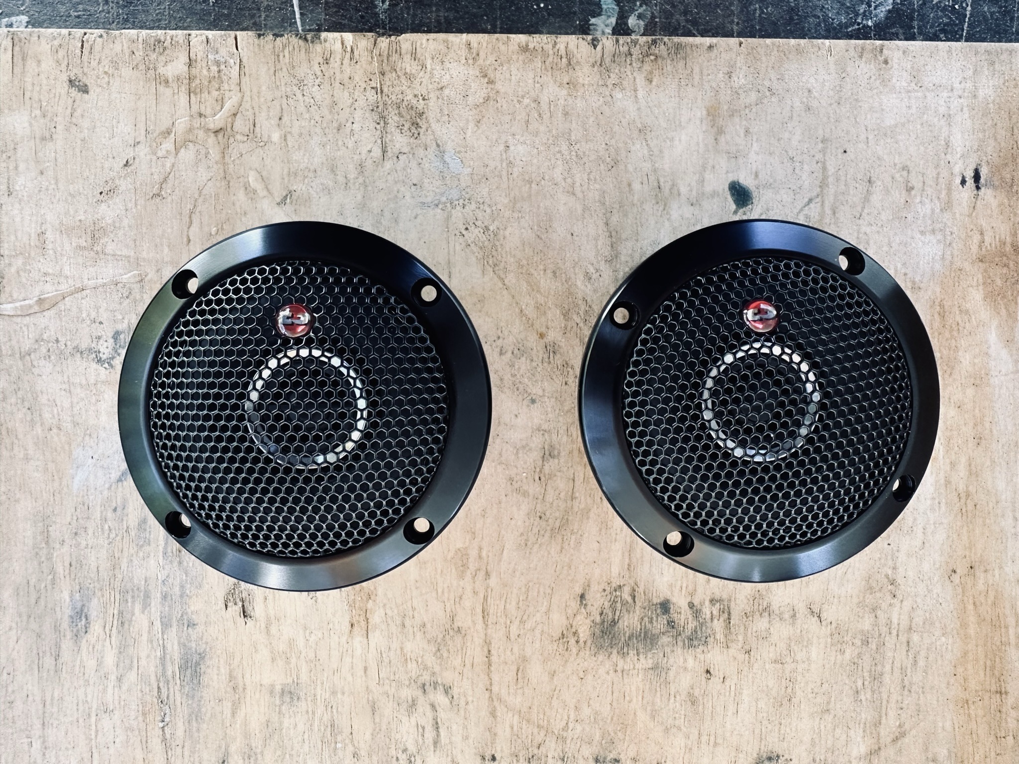

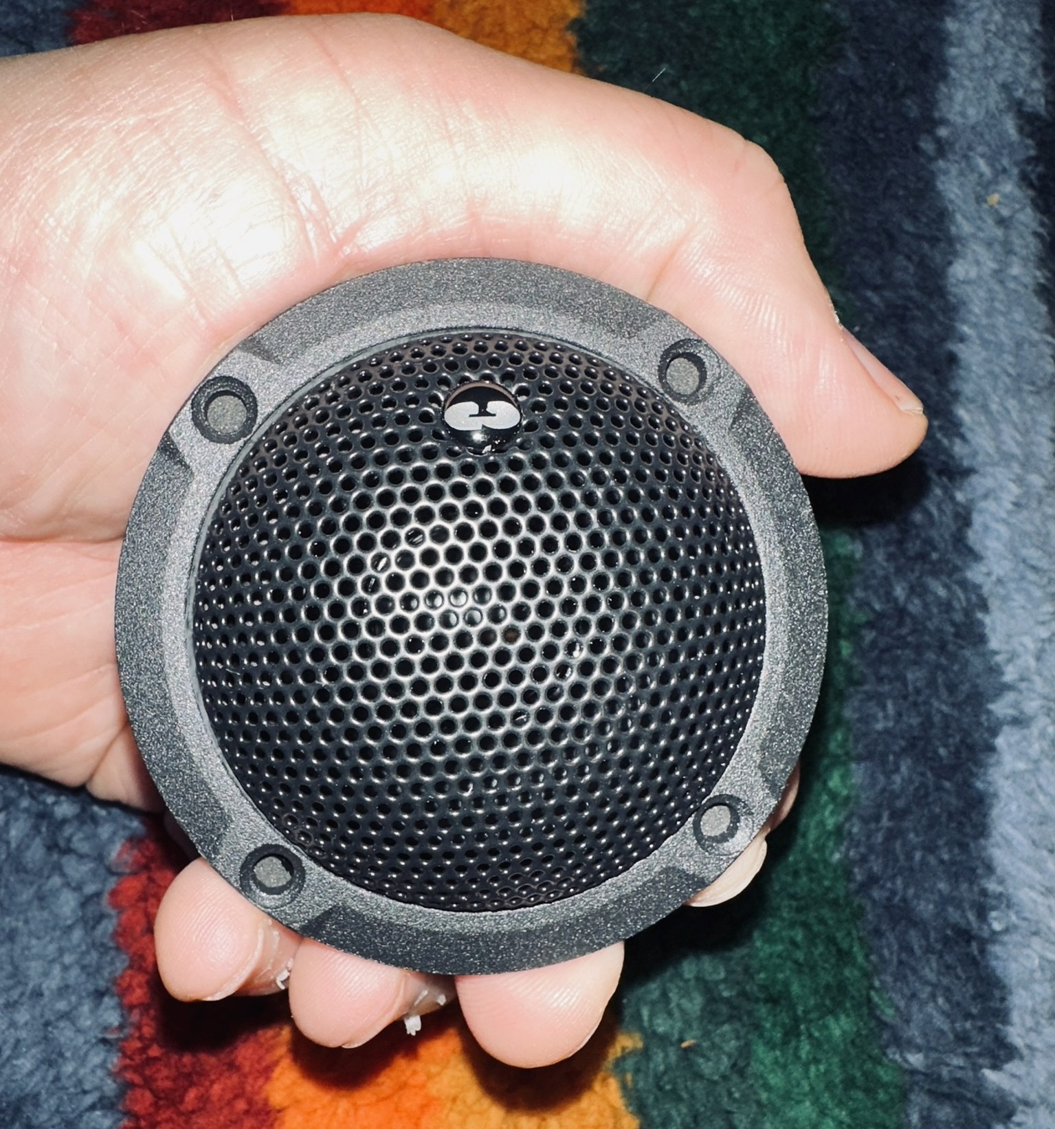

The CDT Unity 8.0 2" wideband drivers that I have in there now sound great. I highly recommend them for use in the Tundra's

I remember when I did a box for 1 12" sub in a 08 behind the back seat it was 2.2cu.ft at 33hz I think it did 133 or 135db in the upper 38ish hz range . I love those trucks but I hate the wiring nightmare JBL does to them lol. If your still getting road noise try putting a cap on your HU power supply as well as some supper caps between your front bat and your back bat/amps that should clean up that death humm

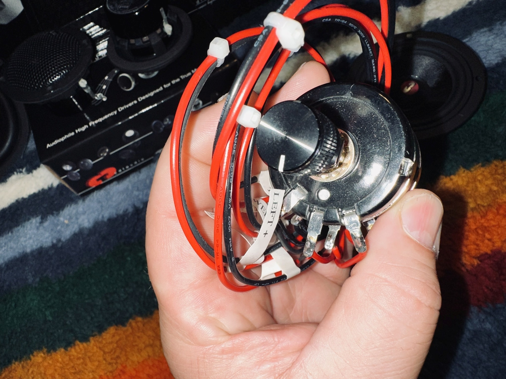

Jack, I was wondering if you can explain how you wired your front corner dash and center channel speakers. I saw that the center channel is wired to the radio but I wasn't sure about the corner dash speakers. Also what crossovers did you use for this application.Update. Rain and more rain. Nothing else to report on other then I got the replacement drivers for the front stage and they are:

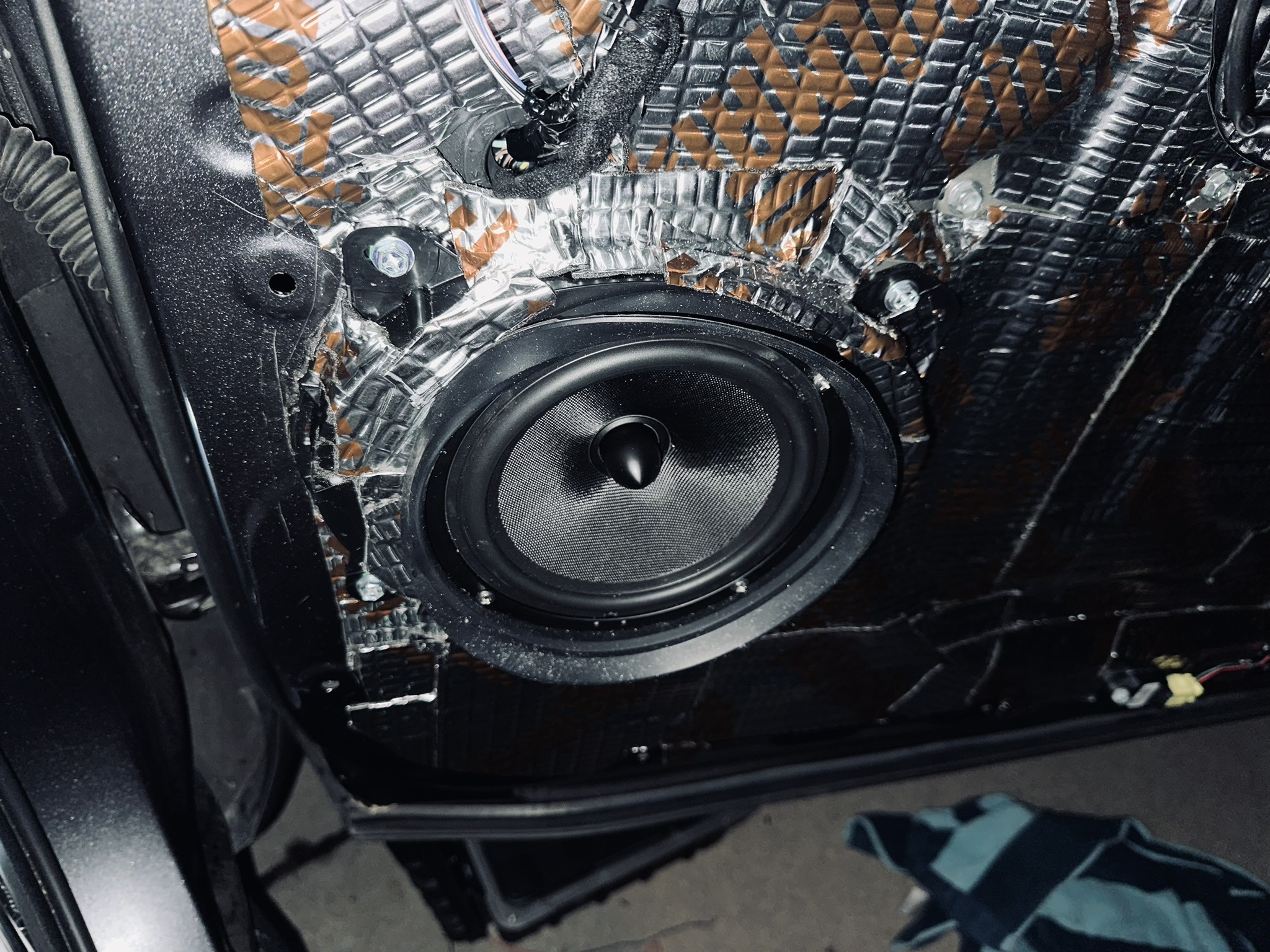

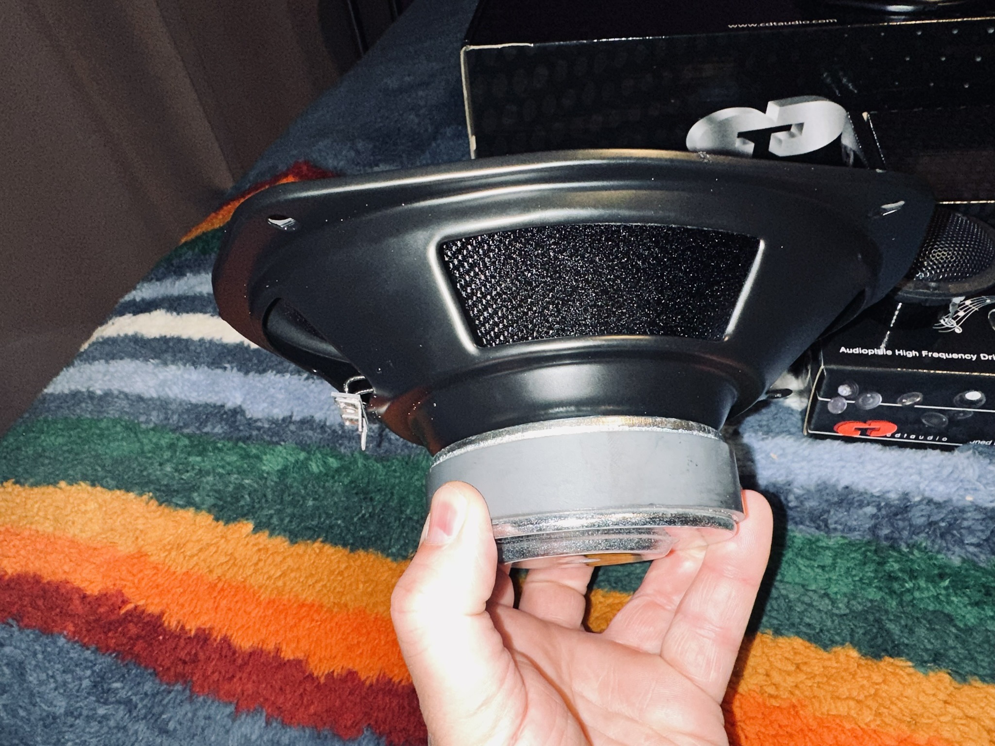

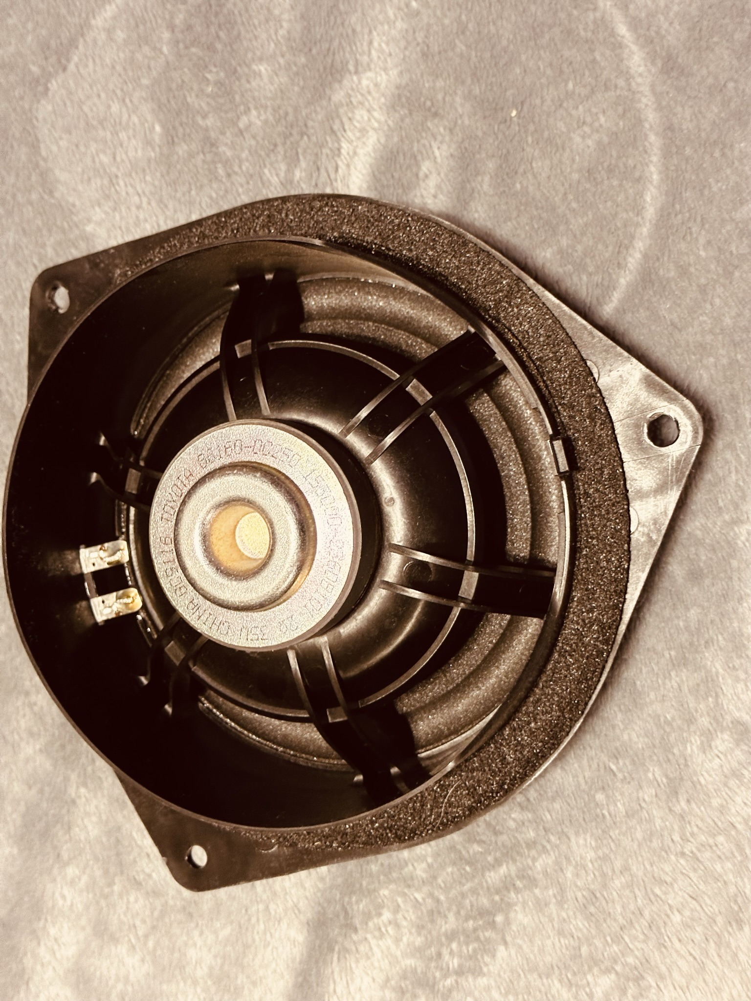

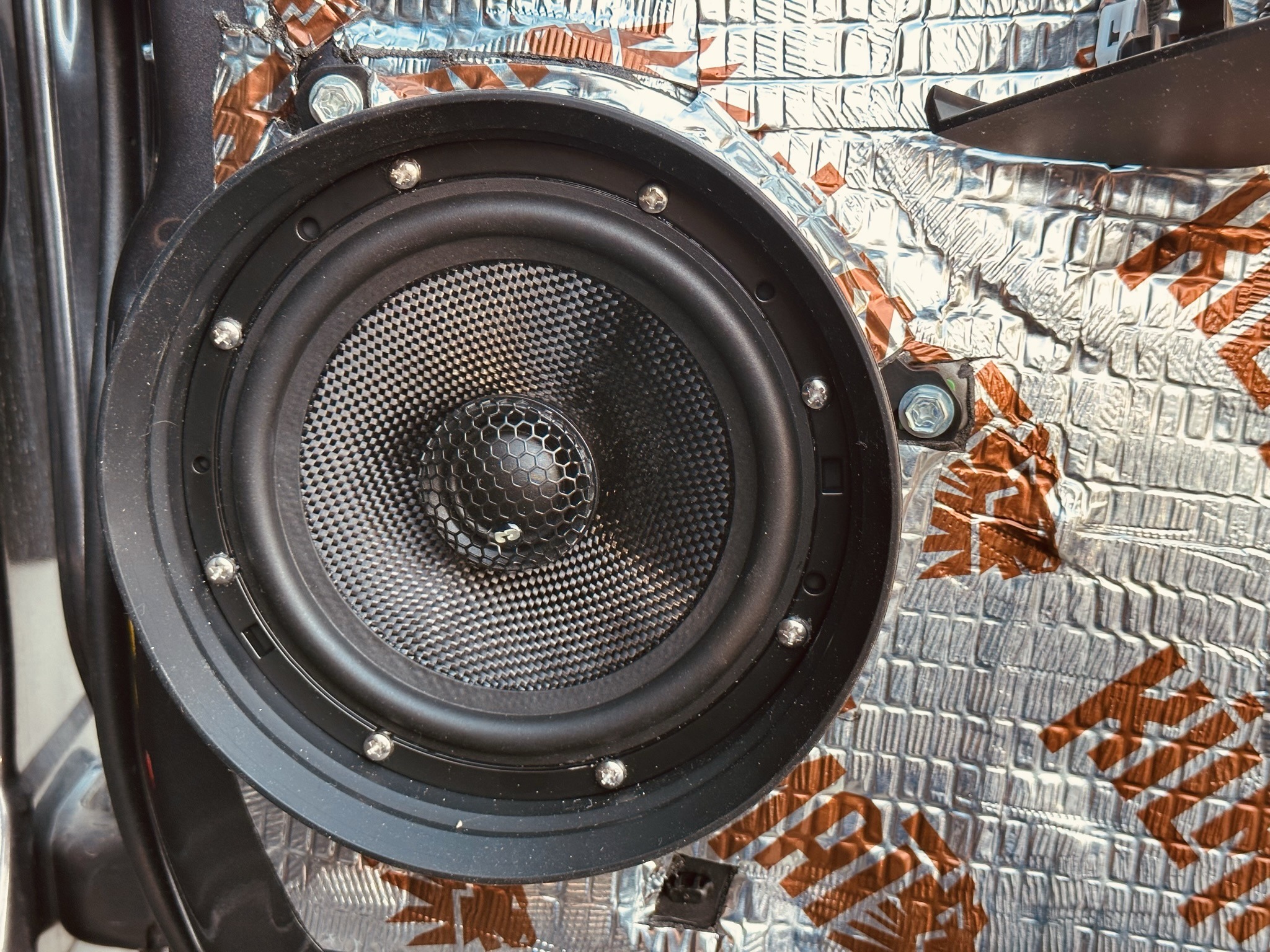

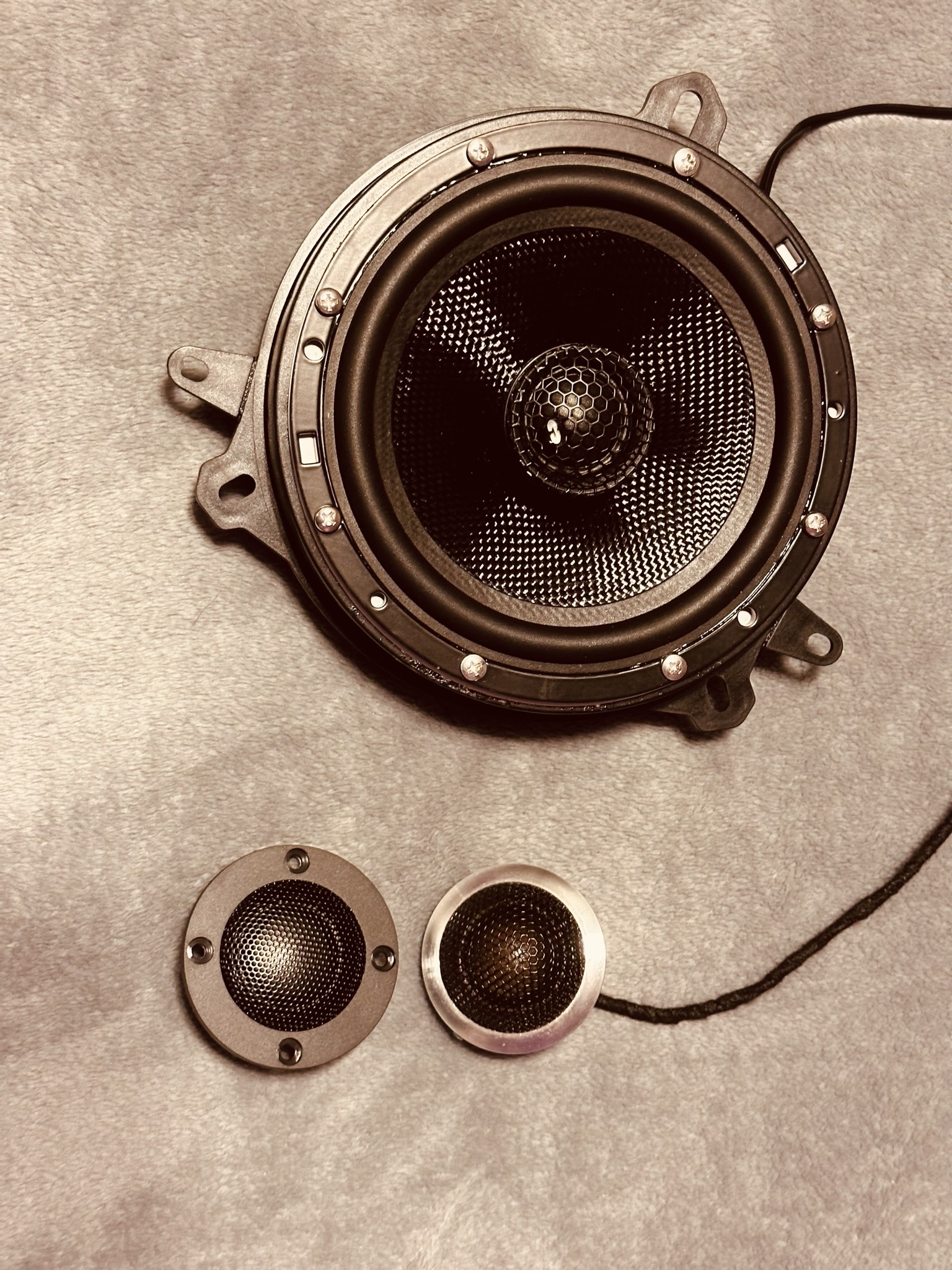

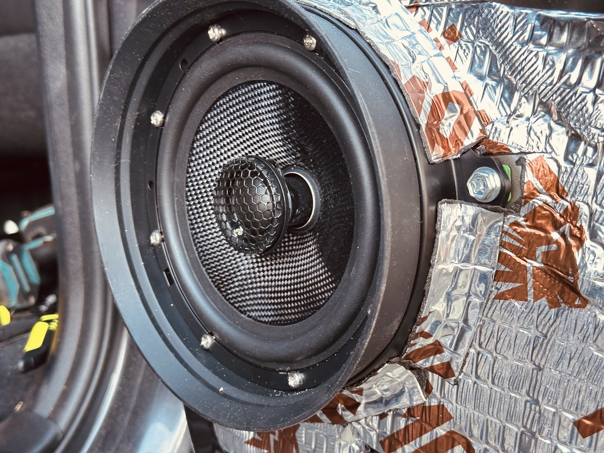

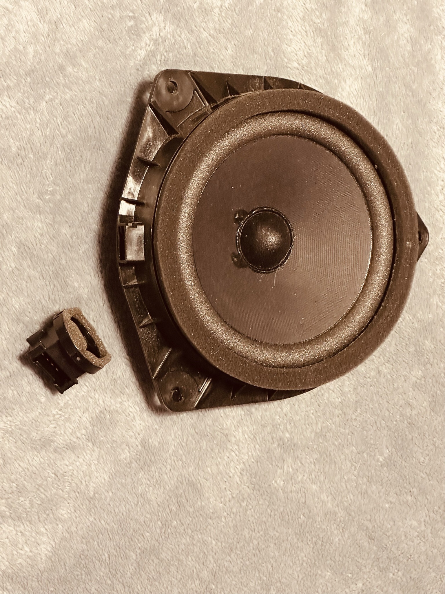

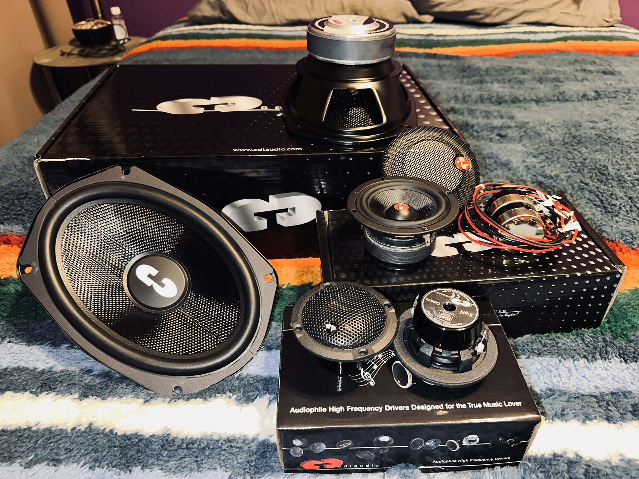

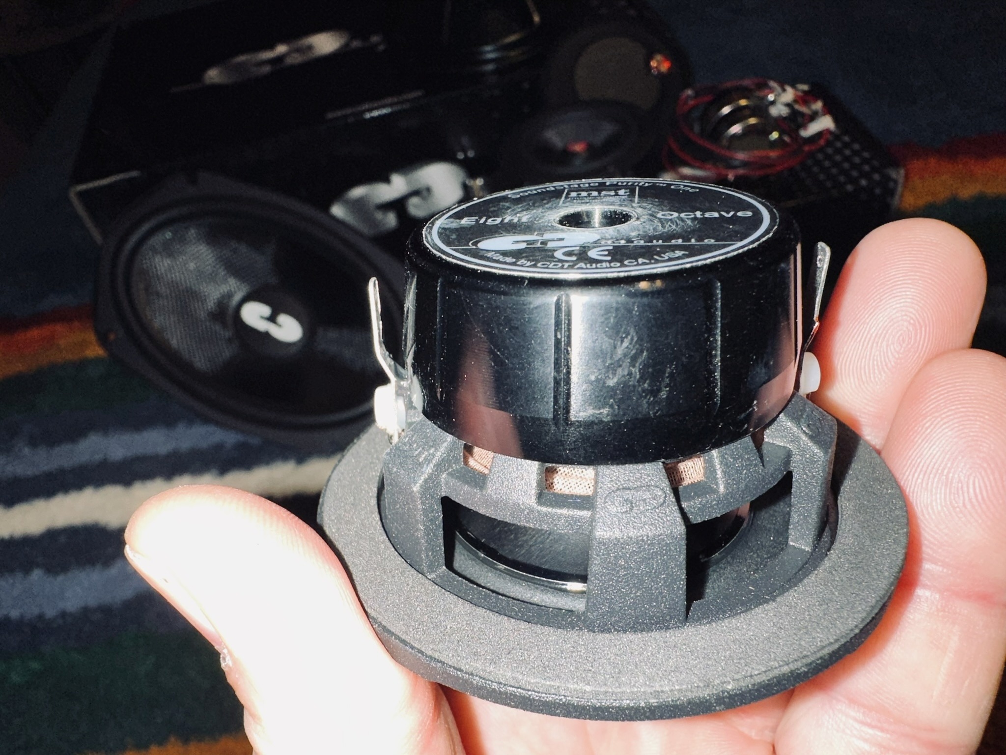

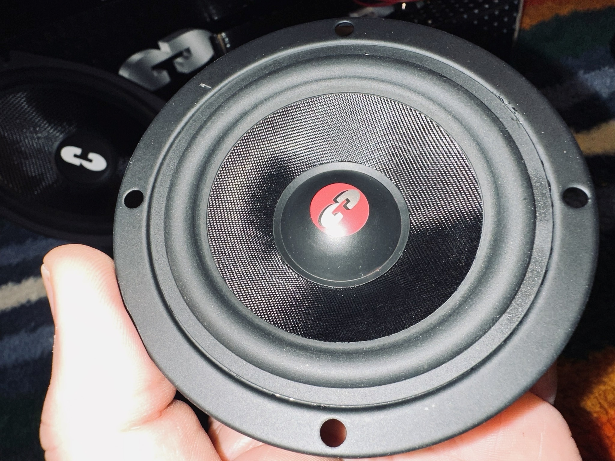

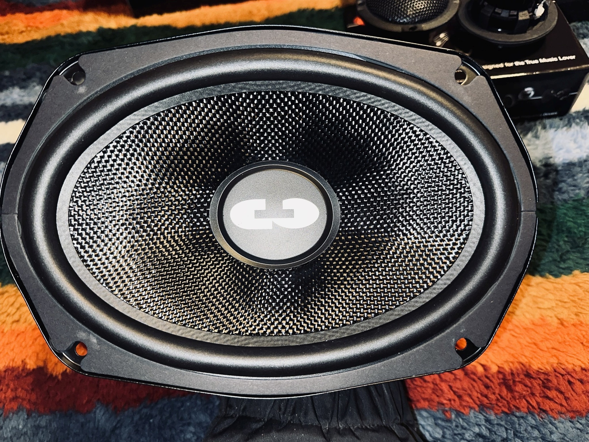

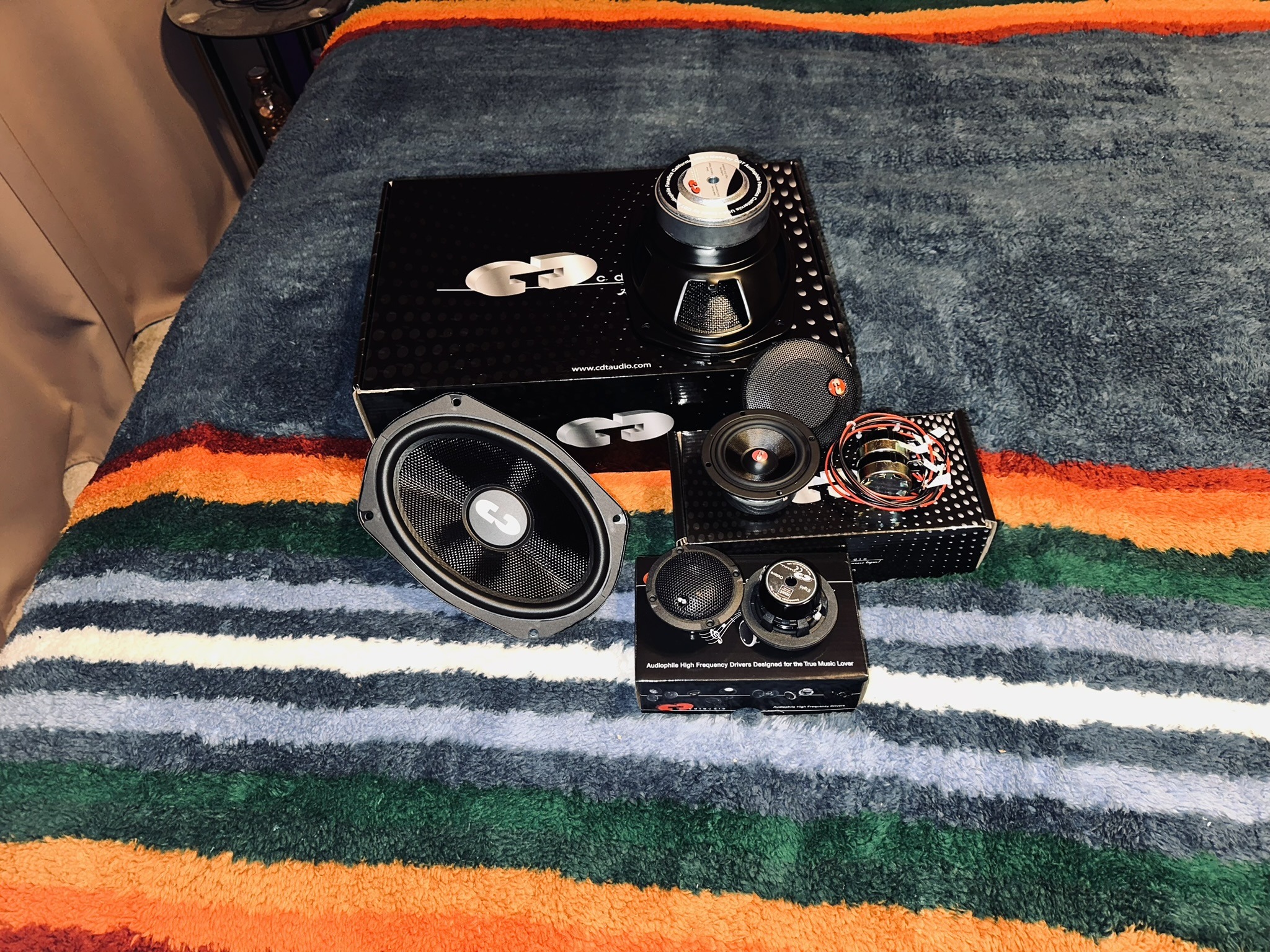

CDT Audio HD-690CF 6x9's for the doors

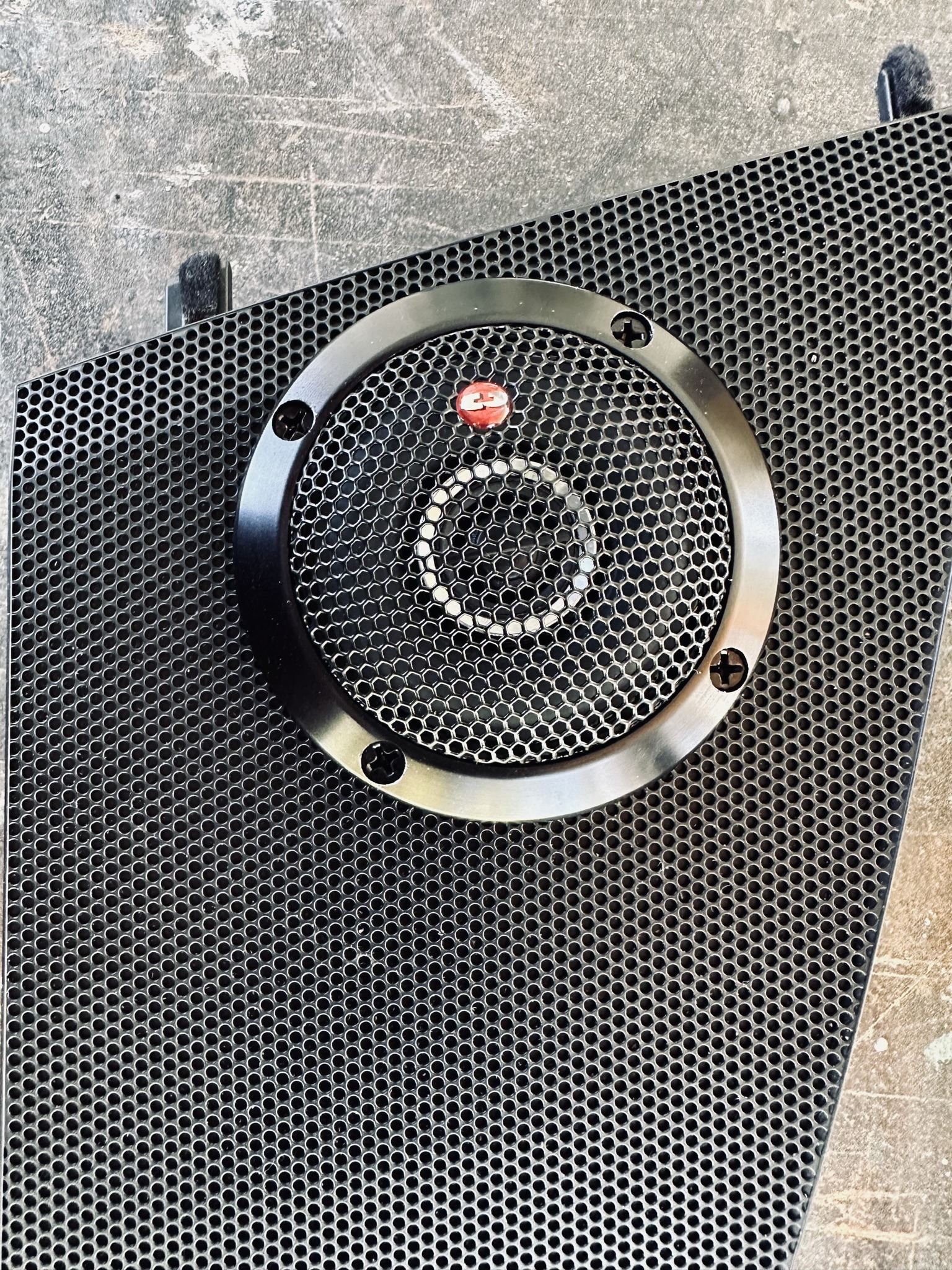

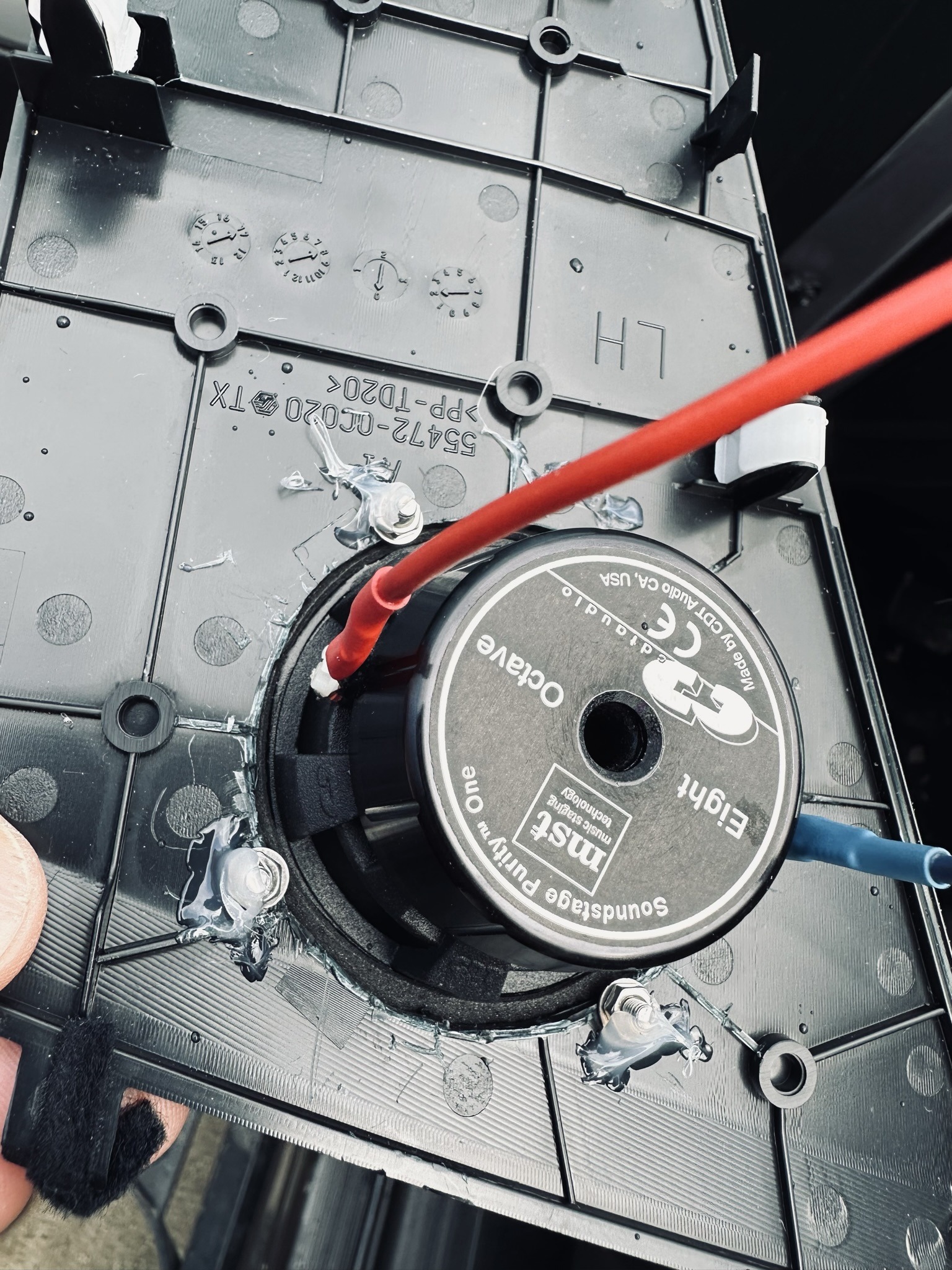

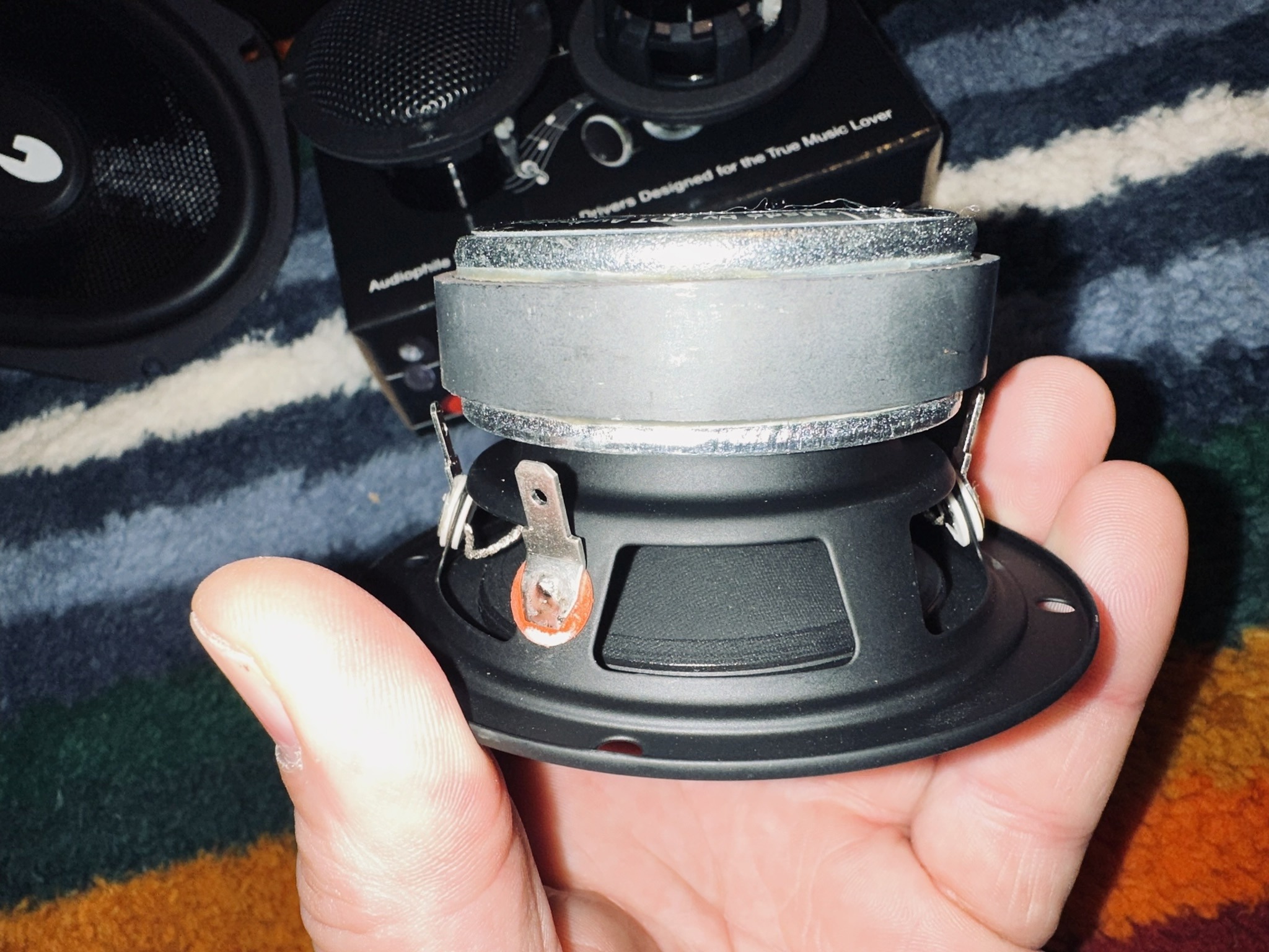

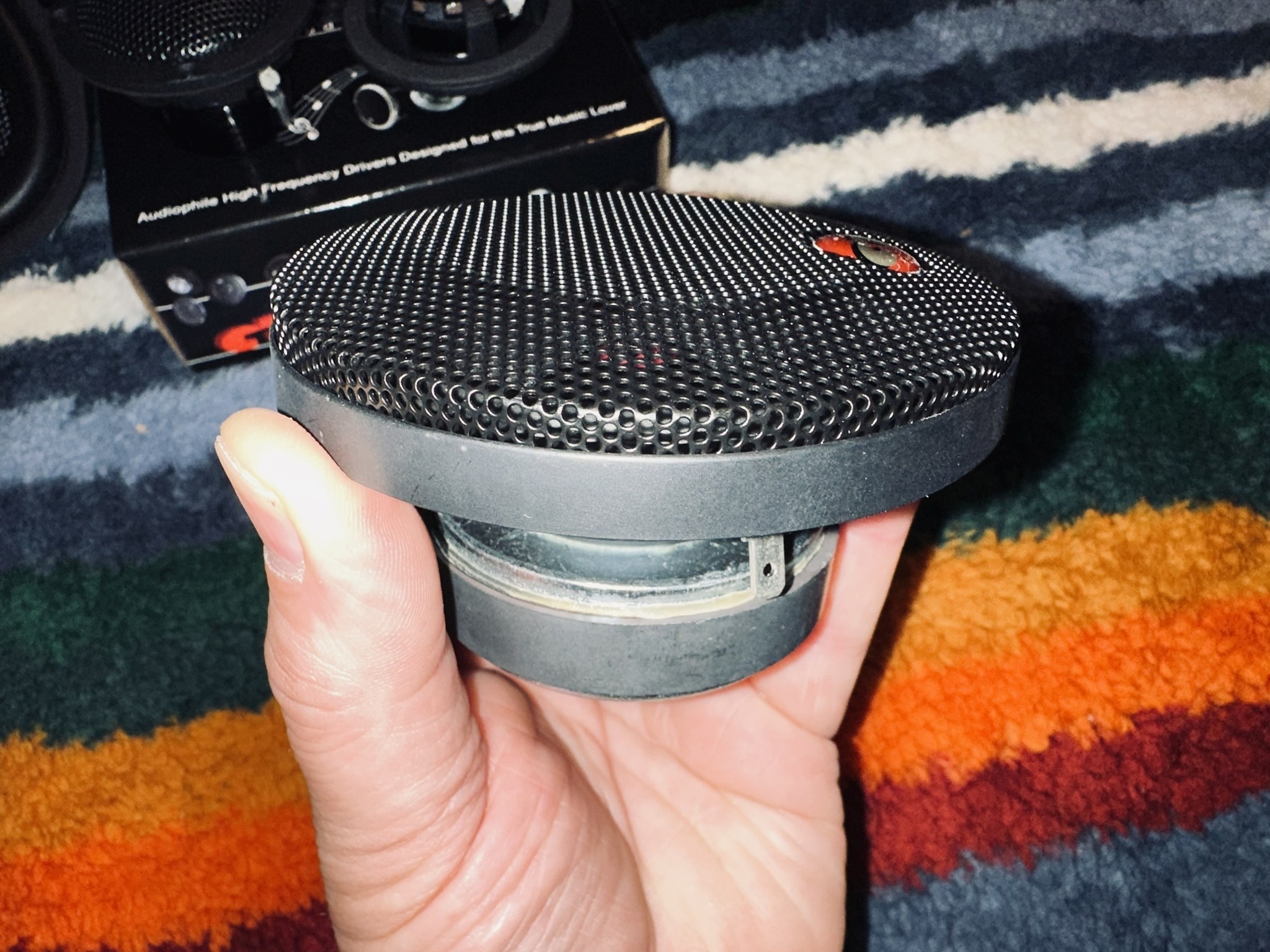

CDT Audio Unity 8.0Plus 2" wide band mid/tweeters for up on the dash replacing the coaxial units. They have the exact same footprint so swapping them out will be easy.

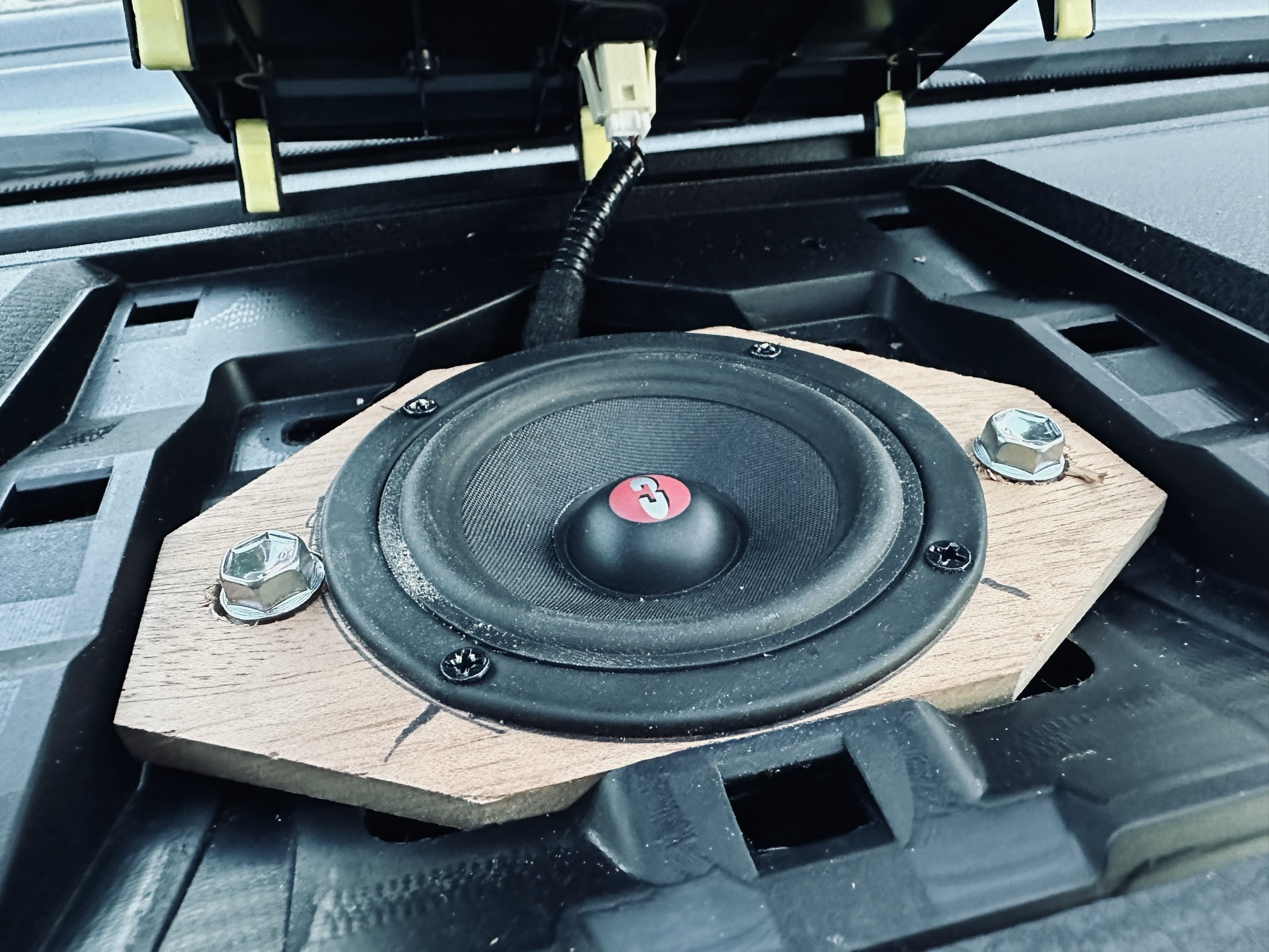

CDT Audio CF-3 center fill driver. This is to replace the stock center fill driver. It is a dual voice coil driver that will have right and left channels attached through a variable L-pad and likely passive x_overs.
There is nothing wrong with the drivers I'm replacing per say. There is just a tonality difference between the front and rear stages and I prefer the way the rear stage sounds over the front plus I need to get more bass up front and more sound coming out of the front doors. The 6x9's that are replacing the 6-1/2" up front are from the same line as the rears and have the same woven carbon fiber cone material so they should carry the tonality of the rear to the front. Being that they are 6x9's and have larger cones they should be able to out put more base up front which I need because at this point there is to much space between the subs in the rear and the front sound stage coming mostly from the dash and I need to bridge the two and tie them back together because right now they are somewhat incoherent. My solution is to put more of the low frequencies up front and possibly put some mid fill's up in the head liner in the back of the cab. This should hopefully solve my problem. The 6x9's are also 2 ohm drivers as apposed to the 4 ohm drivers that they will be replacing giving me more power from the amp that is needed to drive them louder.
The Unity 8.0Plus drivers will be replacing a pair of CDT wide band coaxial's that I put in but decided they don't work with what I'm trying to put together. Again there isn't anything wrong with them per say they just don't work with my system. I got a call tonight from CDT and they informed me that my order was full filled and I could come down and pick them up instead of having them delivered and saving me the $55.00 delivery fee to which I replied, "I will be there in half an hour." While I was there the owner invited me to listen to the Unity 8.0Plus drivers installed in a listening room and I was some what blown away because these things sounded much better then I was anticipating. These little 2" drivers are doing double duty and they are doing it well. I think the choice to replace the newly installed coaxial's up front with these Unity drivers was the right choice to make. This also frees up two channels on the DSP and two channels on the amplifier that I will probably use to drive the rear fills should I decide to install them.

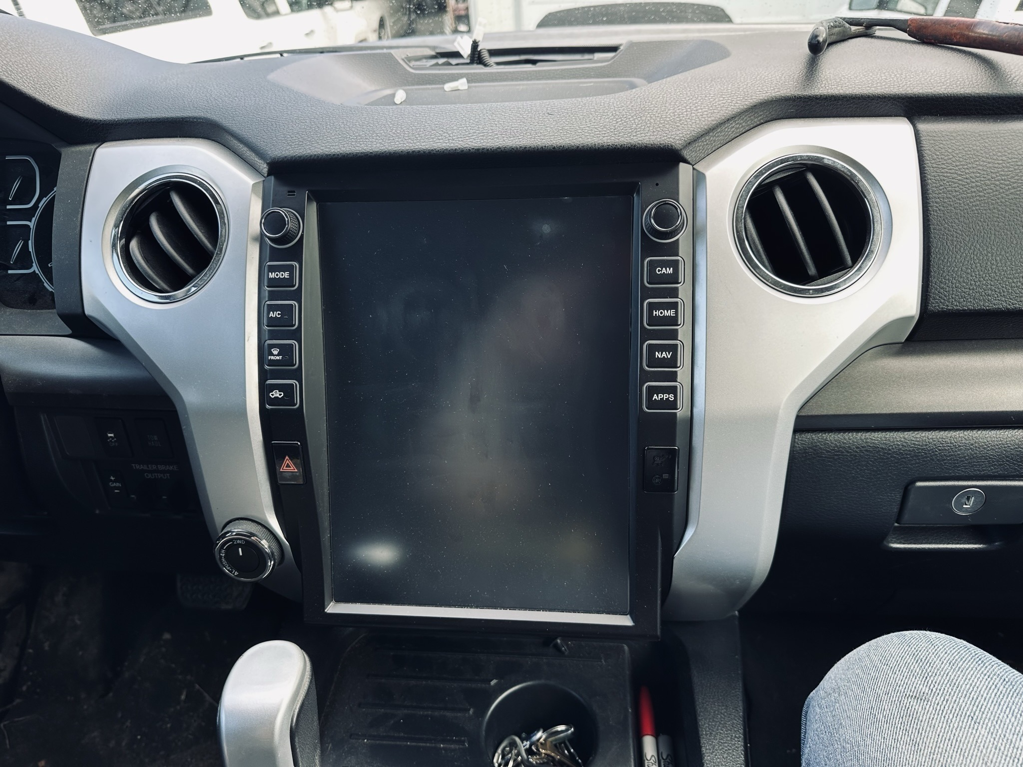

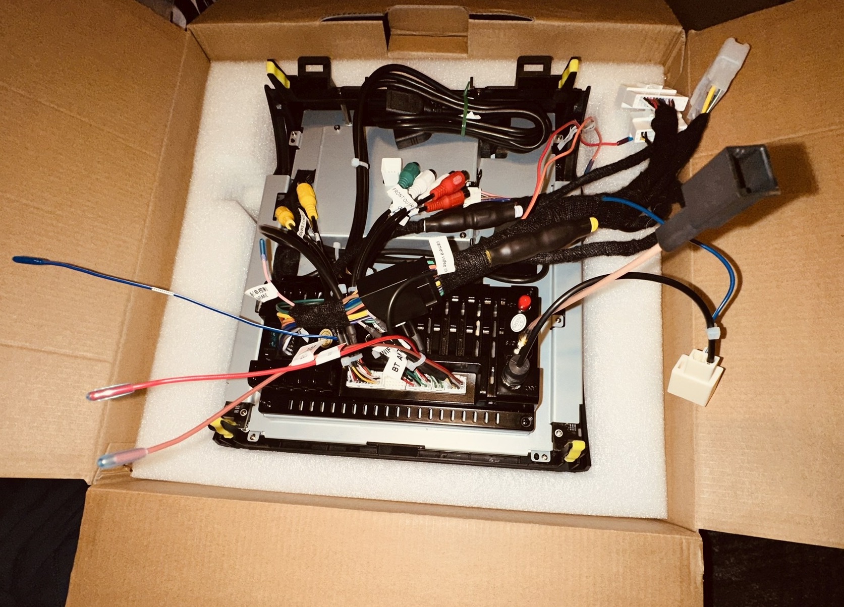

More on the center channel later. I need to explain Toyotas methodology with their stock stereo install in this truck and probably on other vehicles but that is more then I want to get into at the moment because I'm tired and want to go to bed. So until I return here are some pics to enjoy.
