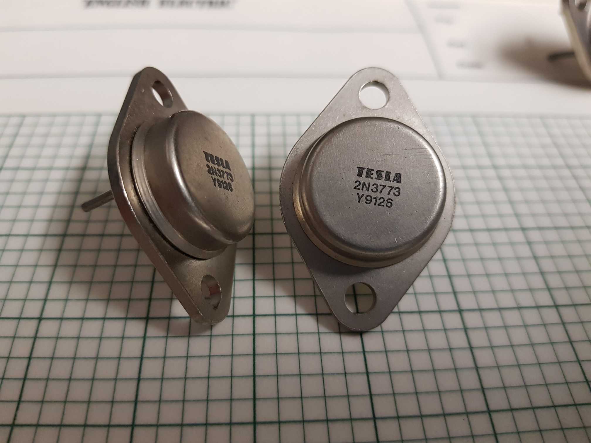

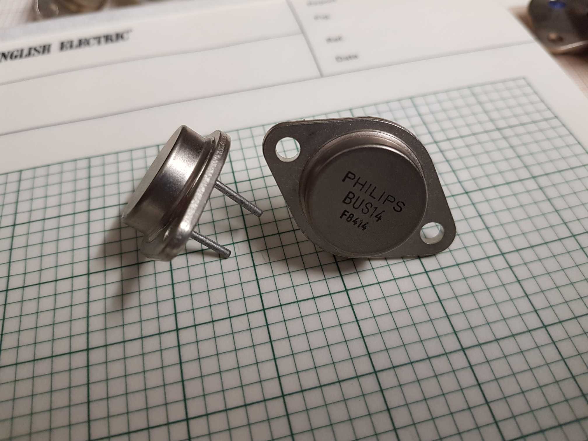

Some to3
Here in attached photos are some to3.
Philip's from the 80s (BUS14) extremely thick heavy case, slightly oversize.
Tesla branded 2N3773 from the early 90s, again, heavy case.
Motorola branded 2N3773 from the late 90s, lighter gauge case and pins
The picture I forgot to take was the other Phillips BUS14 I have, with cheap looking case, like the Motorola. (I think some of those Phil's, are fakes - it may be the motorola though, I'd need to test again to refresh my memory.)

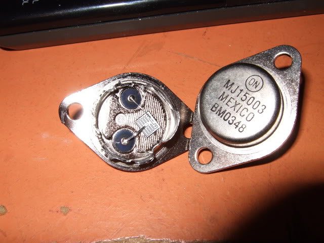

How to open? Grip the top hat with a pair of channellocks and give it a good solid squeeze. If the top pops open immediately, the transistor is fake - period. If all you do is dent the can, use a hacksaw or grinder. F you want to keep it intact for further inspection, just open up a hole and peel the cover back. It may take a while.

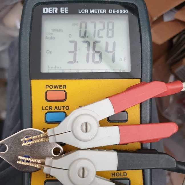

Real 15003/4 will have an input capacitance (base-emitter) of at least 4500 pF. Older ones from the 1980’s process may be as low as 3000, but ANYTHING running since the 90’s uses the improved epi-base process which has higher capacitance (and more consistently high low-current hFE - fT remained pretty constant, but ruggedness improved). If it’s a steel can it will have the higher capacitance. I have a bunch of 2N6609’s from Motorola that came from one of the last “runs” ever produced, 1990 date code, from Mouser originally. They measure EXACTLY as modern MJ15004’s, and all my older 1980’s units (mostly aluminum, almost all pulls from equipment) have the lower input capacitance - about 3500 pF. Factor of two difference in 1mA hFE, too. “Second source” 2N6609’s from Mospec (Muticomp, from Newark) measure like the 80’s units from Motorola.
If the lettering comes off, it’s a fake. The $64000 question is what do you have.
The first one would be typical of a 1980’s device, with the domed top hat and the old “M” logo - a little low for this type with a 90’s date code or newer. Possible, but not likely. It would at least warrant an SOA test before destroying it to see inside. Well, you can always check to see if the top hat just pops off. The last one would either be a fake, or perhaps a real MJ15015. Send it to the Pit of Despair.
