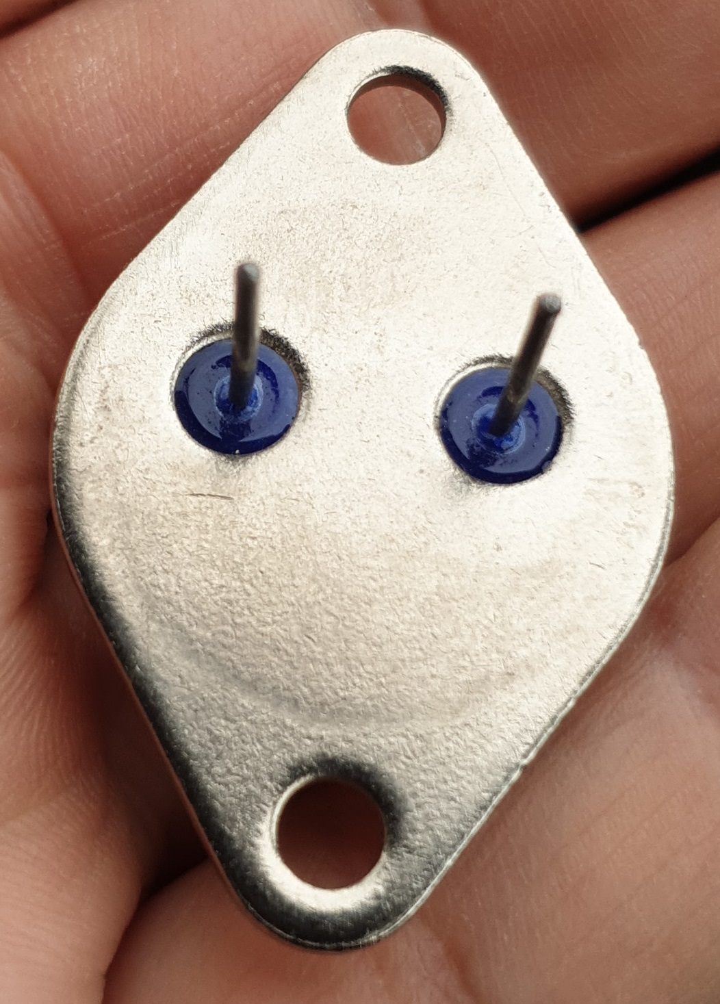

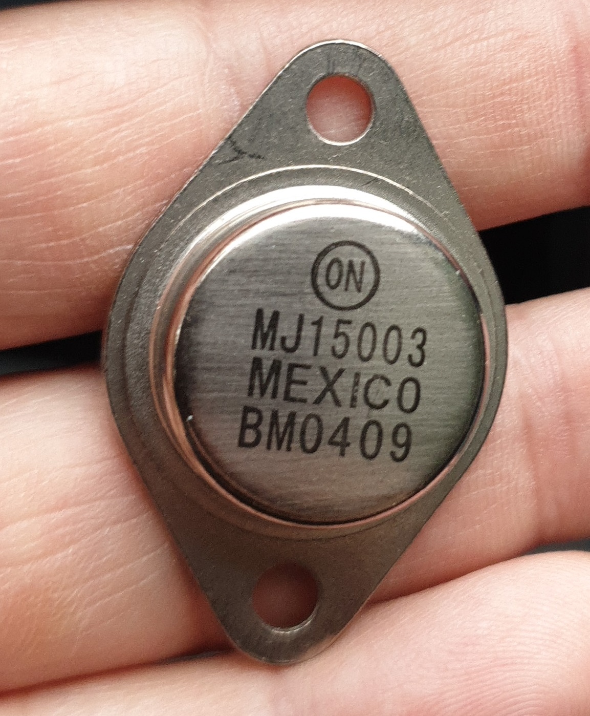

it seems to me to be fake:
MEXICO - should be MEX
The blue insulation "fell" inside
at the bottom visible round outline of the top cover.

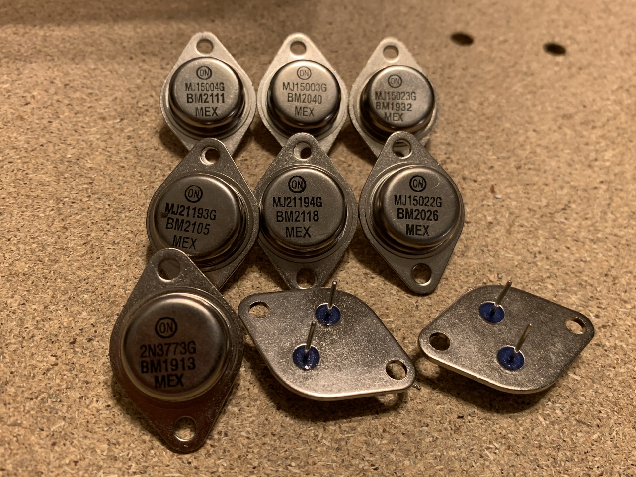

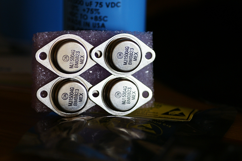

see attached picture - originals from digikey (the marking are sometimes not exactly in the center ...)
Those do not appear to be real - sorry. Yes, you can see the sanding marks on top,and the bottom finish is completely wrong, as are the lead insulators.
The question now becomes, are they reasonably fakes or not? Can you measure the capacitance E-B and C-B? Compare to measurements earlier in the thread. Or, you can pop the top off one to see what it really is.

Base-emitter capacitance will be at least 4500 pF with these types. Any “real” transistor, even a 2N3055 will be hard for you to pop the top off of. If it comes off easy it’s no good. Even if the die were ok, there could be contamination issues which could cause early failure. That’s why they put on the white goop, but it’s only partially effective. The visible ring from the bottom is a giveaway that the seal is probably not done properly. Some manufacturers parts DO look like that from the bottom, but ON (and older Motorola) never did. Even then, the tops would not just pop off with a pair of pliers.
The only real ones labeled “MEXICO” instead of “MEX” are some early Motorola ones - with the domed top hats from the late 1980’s. I wonder why you don’t see any of those being passed off as fakes. I do buy old vintage Motorola types when I can find them cheap. But never gotten burned by an older style package - so far they’ve all turned out to be real. Mostly the aluminum ones before they started using an origin code. And of course I always test purchase first. I have seen some spec fall outs in a batch (low Hfe, leaky, etc) but look just like the good ones inside.

Hi.I have measured my Original MJ15004 and it is 11,85grammes and this fake looking MJ15003 measures 11,8grammes with my precision weight scaler.
And i have DER EE DE5000 LCR meter.Can i measure with this?At which frequency?Thanks

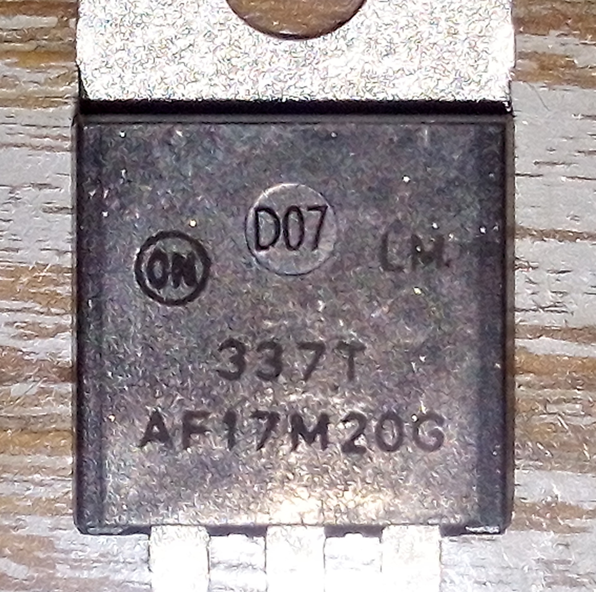

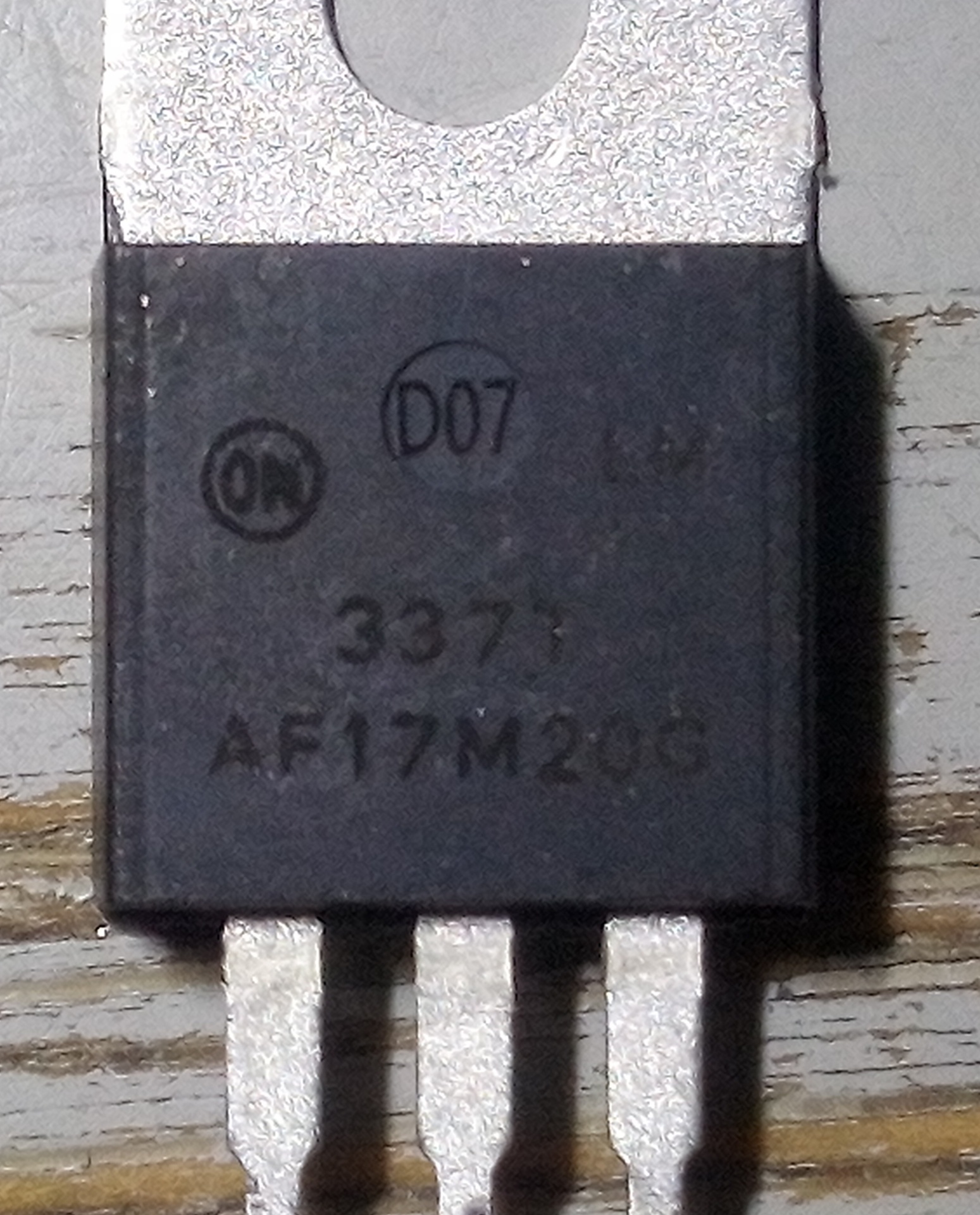

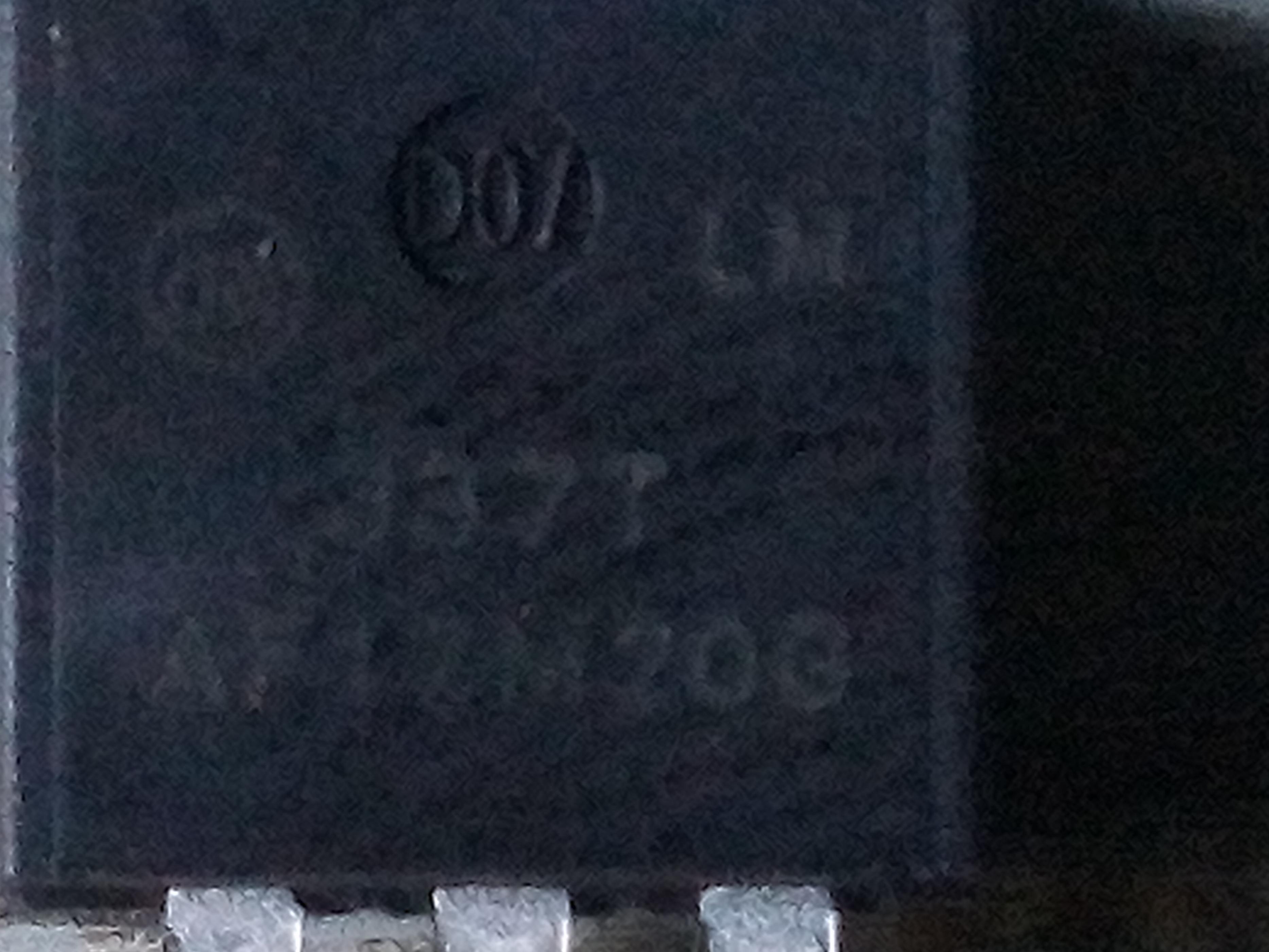

Not a transistor but a voltage regulator. On many transistors I know at what I have to look at but at this one I'm not sure. I've got this one in a regular kit but when I examined it closer I got some doubts if it's genuine or not.
I've made a few pictures of it but it is hard to see on them what makes me suspicious,
the surface looks not flat but seems to have waves on it. It feels flat though. To show it more clearly, I've edited the last picture. I know, maybe I'm just paranoid right now but I'd like to be sure because a replacement from china would take too long for my project (preamp) if I had to order possibly damaged parts on the preamp.
