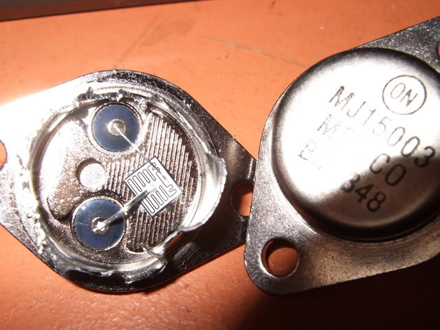

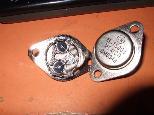

Hi.I have found this on a local store a few hundred pcs.Are they genuine?Regards
These are genuine samples delivered from OmiSemi about 15 years ago
The MEX bit wrt it being MEXICO is not an indication of fakeness. :)
That one actually still worked. It was a pull from a PCB, with the leads trimmed too short to use with a heat sink. So it was expendable. It is just sitting on a black heat sink for contrast in the photo.
The die inside is exactly the same as that 15003. Test conditions are different, and some guaranteed ratings, but it’s really the same part. What really struck me as odd was the one fake MJ15024 I’ve run into that had that same die inside. I wonder where the Chinese got *that*.
Those old aluminum case are harder to get apart than the steel ones (even real ones). They all require some cutting. I’ve never run into a fake aluminum TO-3 yet. I guess the fakes just weren’t common in the 80’s. Which is good, because I couldn’t afford full price for power transistors back then.
