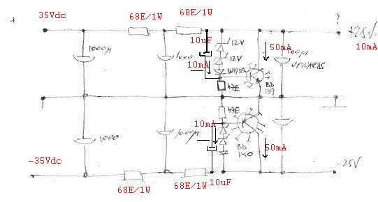

ok,results:
start-we need stiff 35VDC MINIMUM at input
both series resistors are 100 ohms ,1W is OK
1000uF between them
zenner string -just two 12V/1W3 ,without 1N400x and WITHOUT caps across zenner string or base resistor
base resistor 100 ohms too, 1/4W OK
any darlington you have in drawer (2N6039 and cousin in mine )
2200uF on output
even better if you have place for some 100.000uF in box
current summ for 35V input is 45mA ,approx 10mA through zenners and 10mA through load (2K5); rest through shunt Xistor
better looking and measuring at 40V input,current is also bigger through Xistor -only;
all I can see on scope is just breadbord induced (read mess implementation) noise,but I can't see any residual hum or anything simillar
all caps can be bridged with some ceramics (22n good enough)
uh-yes-25V7 on output
read text looking at this picture
1000uF between them
2200uF on output

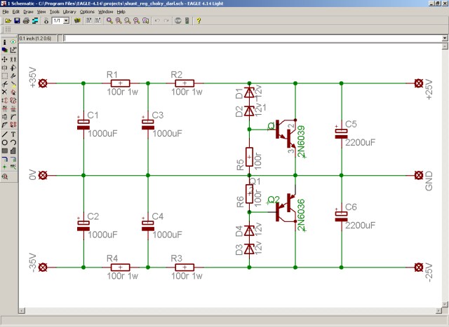

I didnt have any plans, until you posted the next proposal🙂 I dont even have a darlington in my inventory (I think) I will try it, but it will propably be a few days before its finished, when I need to order parts🙂 Thanks for your work on this, Choky😉let me know what are your plans,and mebbe I'll fire my solder at last
Steen🙂
Edit, I still dont quite understand the other shunt reg has that slight buzz. Can it be a defective rectifier diode or something??
I will not use any of it, when I build a new one
steenoe said:I didnt have any plans, until you posted the next proposal🙂 I dont even have a darlington in my inventory (I think) I will try it, but it will propably be a few days before its finished, when I need to order parts🙂 Thanks for your work on this, Choky😉
just try without darlingtons (plain BDs ) and with that 1n400x in place

can be ,but you can only try to swap something,or see with 'scope....
I didn't tried that shunt reg on anything this evening,but I'll maybe tomorrow
hehe-mebbe I even make one quickie Choky Mono NS10 Clone just for testing of psu
No, and this is not the first time I need onehave you 'scope?
Steen🙂
Edit, I just checked the psu board within the edit time😉 If the pads for the outputcaps are moved a bit away from the BD's, I think its good🙂 If you find the time to post a pdf Russ, I will give it a shot😎
steenoe said:Is this the darlington reg you had in mind, Choky? I fiddled around in Eagle to see if I could clean up the schematic a little bit🙂 This is without any 1n4xxx's.
Steen🙂
yup.
put 22n in para with all 'lytics
