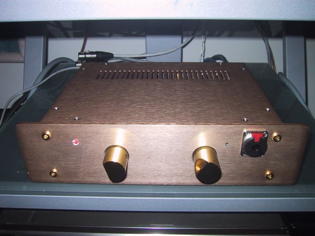

Sorry Russ, I missed your post at first. You can be proud allright, the layout is working just great🙂 Thanks a lot🙂 Here is a pic, if you care, of the little champagne-coloured wonder😀I kinda feel like a proud uncle or something seeing those PCBs in there.

Very nice layout! It looks as if there's a volume pot, a source selector and a control I'm not sure about. Is that a power switch?

Nope, thats a Neutrik socket for headphones😀 The powerswitch is placed on the rear.Is that a power switch?
I had to take out the headphoneamp, to make room for the NS10.
I am thinking about, how to get the headphoneamp, back in, though😉 Will probably have to stack the boards, somehow.

Which attenuator are you using Steen?

I had to take out the Elma, and replaced it with a std. 22k audiotaper potWhich attenuator are you using Steen?

I get that a lot, Jacco😀 But not from my girlfriend😀 😀 The knops are actually the same as Jrsun offers! I bought mine directly from Taiwan, though! Also the nice Champagne chassis is from Taiwan. I looked over Jrsun's shoulder to check his prices!! They are totally okay!! You cant even import the stuff cheaper yourself🙂 The knops are solid brass, I think Jrsun listed them as something else! Only trouble with them is, that the hole is not centered correctly! It wobbles in the hole, god darn...... I cant have that.-....😀 😀you are mighty fast

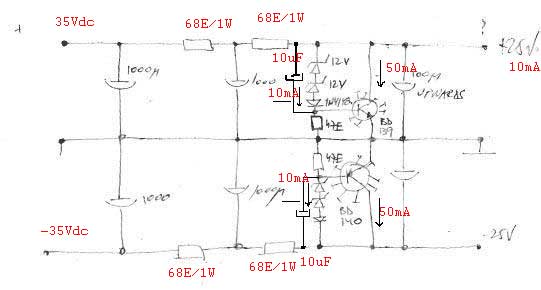

He-he Choky-boy😀 I just meausered 10ma's from the positive rail to ground and also 10ma from the negative rail to ground! Well 10+10 is 20 isnt it😀 Well there you have it, do with the figures as you please, Choky🙂 I kind of like the idea of a shunt reg preceded by a CCS as you said earlier! Hope you will come up with something.hehe-but-how,on earth, you calculate 20 mA when you have 10mA from + to - (or vice versa )?

here it is-takin' in account that you have 2x25VAC iron;
there is also some space for tweaks (feel free to put somewhere few little plastic caps , mebbe even in paralel to 47E ( ?!) .
with more volts than just 35DC,you'll have more ripple rejection
hehe- with more volts on input-I can even recalculate for shunting some 110mA , not just 60......
ps-regarding CCS -mebbe just some old good LM317HV (LM337HV) ,wired for 70mA ,but you then need few volts more ,too.................

Wow, thanks Choky! Thats fast delivery😀 I will try and mod the supply as you suggest! When we have this psu perfected, I hope Ross'ie-boy will make a lill nice pcb for it😀 Just to keep it in the Choky language😀here it is
On a seriuos note, Choky. That shunt reg supply worked wonders! What a difference! The singing just came through🙂

that is approximation of sig in my outgoing mail messages;
according to that - you really need bigger xformer (read my lips
- more volts ) and then you'll have full power of shunt reg in action
then you can also xperiment with last cap in chain,or you can go Gainclone route -with minima of uFs......

I can quote that, and yes I know you told us so allready😉 Shunt reg it is. I dont know why it never occured to me before?? I will try and test it on other preamps also😀 HMMMM not to use that hifimumblejumble kind of language😀 😀 But the shunt reg is really great! I cant tell what it is excactly, the music just comes straight out of the bag😀.............................................................

btw -shunt reg is (in world of regs) exact pandan to class A amp stage (in world of amp stages)
series reg is kind a AB (?!) or B class stage......

Choky, do you mean it would sound better with even more volts on the trafo's secondaries? I have 2x25 before rectification at this point! I have a 2x30v trafo also, if that should be better? But thats a 160VA, so its a bit bigger

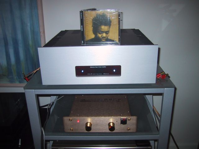

about heatsinking the BD's then? Okay, here is the last pic for today😀 The champagne wonder playing Tracy Chapman right now🙂
