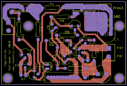

Positive rail pcb layout finished again and done from scratch after the schematic was modified; please have a look and comment. Double layer, 3x2 inches, pads, GND and power traces on both sides, signal traces only on copper side.
You will see the V+out connector is right next to the mosfet, which will interfere with using those tiny wrap-around heat sinks. The idea is to have the distance between M1 drain to the V+out connector as short as possible. A flat heat sink that extends from M2 to M1 will be best for this; another possibility is the case side wall. The mosfets can also be mounted horizontally and attached to the bottom of the case.
There are thick traces where it matters, and a blob for GND. There is no ground in and ground out. The best here is to run a thick wire from the regulator ground to star ground.
The negative layer needs to be done from scratch. Argh 🙁
Hello Iko, Dont you think its better for the mounting hole to be at the corner? Meanwhile, is the ground colored black?
It would look nicer, but the board would have to be longer, or taller. If it'd be taller, then it would be impossible to mount the mosfets to a large adjacent heat sink. If it would be longer, it would increase the distance on the V+out side to the load. To me it's better to have these technical advantages with a few points lost on good looks or symmetry.
