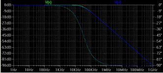

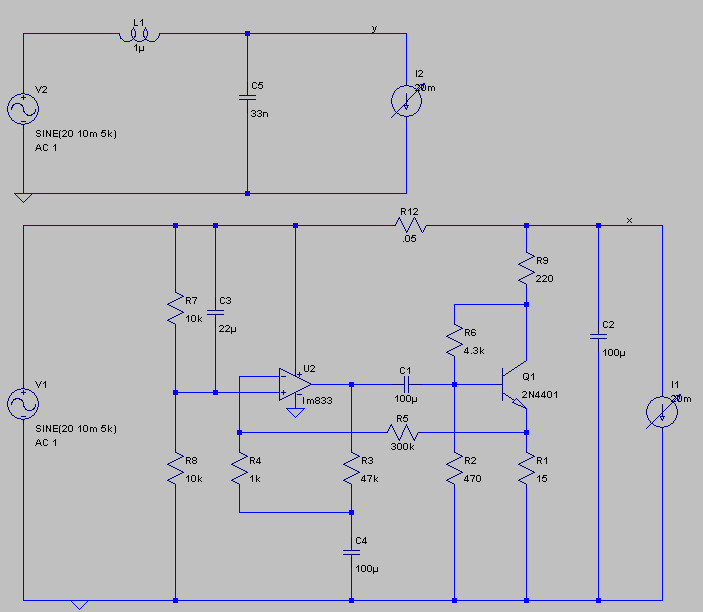

Here's something to ponder. Any friend of google who looked for regulators must have come across the Wenzel finesse voltage regulator. Yes, it's as old as Nefertiti but never embalmed. Do not take this lightly, because these are serious people, with patents. So go and read about the Wenzel finesse voltage regulator at this link.
Finesse Voltage Regulator Noise!
Recently this kind of regulator has been used by top engineers in certain restricted venues.
My first attachment is the finesse regulator next to a noname LC low pass filter. The LC low pass filter is sloppily built, with magnet wire that sucks (150 ohms series resistance).

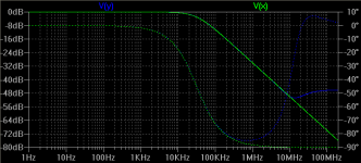

The second attachment is the simulated frequency response of both circuits. V(x) is the finesse, and V👍 is the LC filter. Up to 10MHz they are almost identical in psrr.
"Hey!" -- you'll say -- "Buddy! -- look beyond 10MHz, the finesse reg keeps on decreasing psrr. Your stupid LC filter sucks beyond 10MHz."
Too true... only too true...
Too true... only too true...![]()

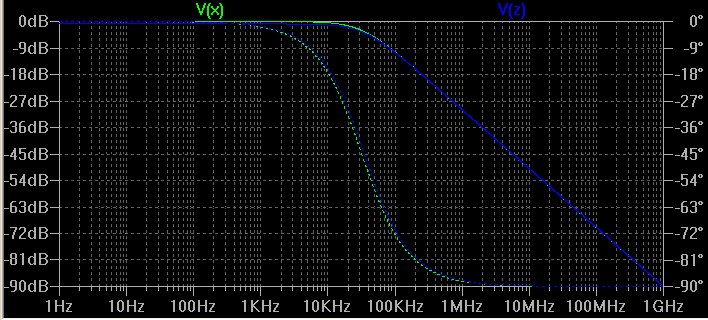

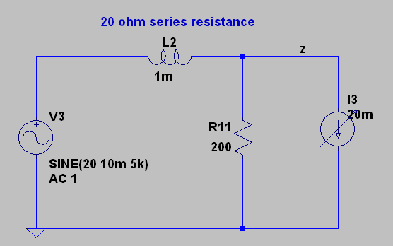

Alright, the LC filter sucks beyond 10Mhz when compared to the finesse reg? What to do? Let's replace the cap with a resistor. It's cheaper anyway. V(x) is again the finesse regulator psrr, V(z) is the LR low-pass filter psrr. It's difficult to see any difference, really, as they're almost identical.
Yet, the finesse regulator exists and is preferred to a simple LR filter. Does any of you know why that is?
Noooo, it's a perfect choke 🙂 What do you suggest?
But then again, I didn't add trace and other parasitic properties of the finesse regulator either.
